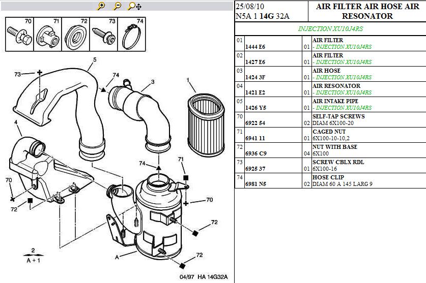

cold air feed

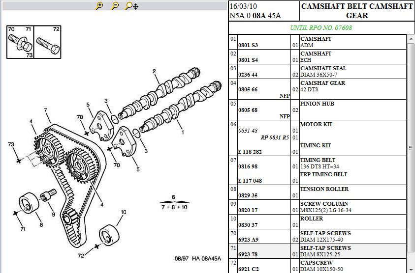

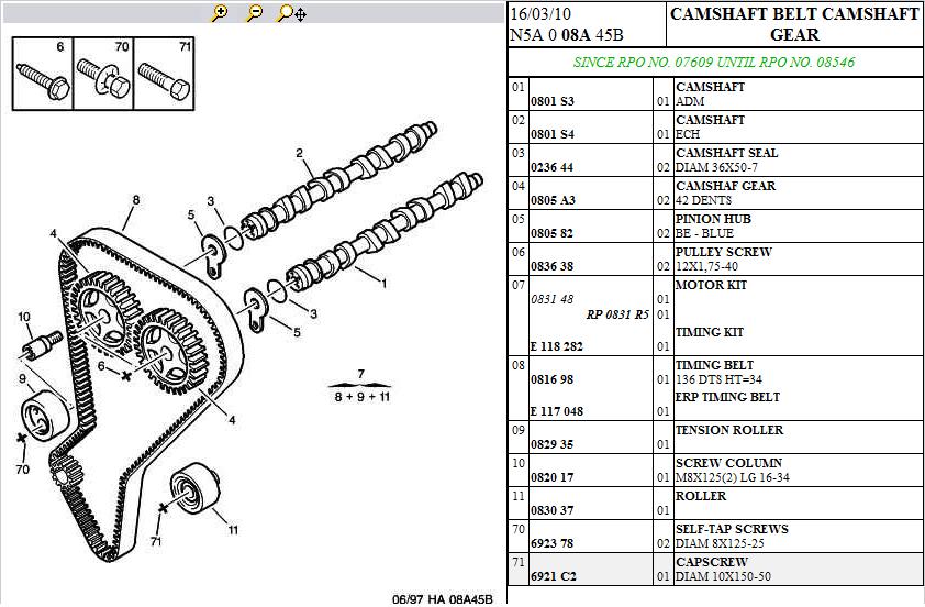

136 cambelt

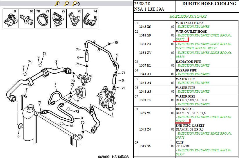

Gti6 bottom rad hose
1351 X9 WTR OUTLET HOSE - INJECTION XU10J4RS UNTIL RPO No. 07972
1351 Z3 - INJECTION XU10J4RS SINCE RPO No. 07973 UNTIL RPO No. 08357
1351 ZV - INJECTION XU10J4RS SINCE RPO No. 08358
1343 Z4 - later type bottom hose seal ring + top hose seal ring to thermostat housing

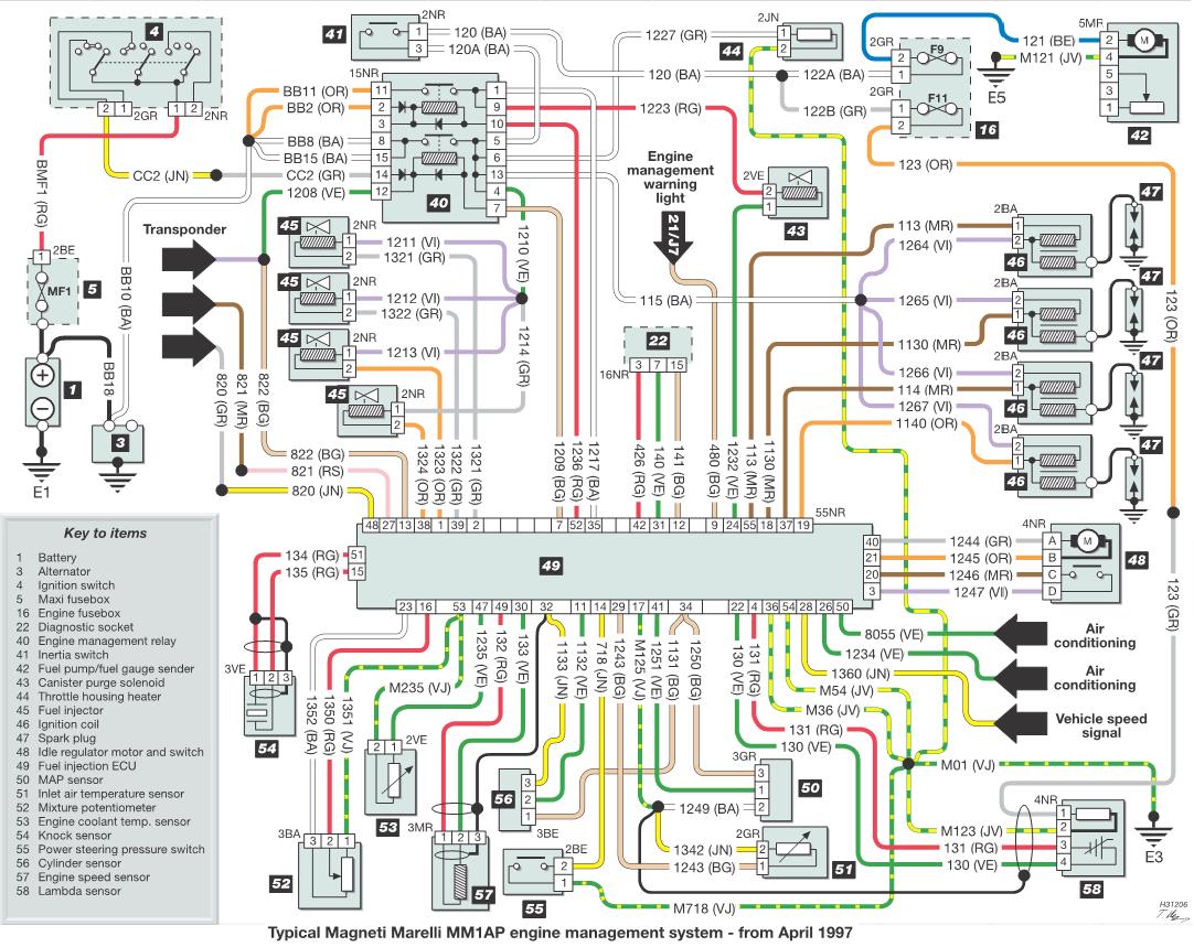

soft unlock ecu
disconnet ecu with engine running then cut the transponder wires cut them at the small engine loom plug on the inner wing cut the 3 wires 820,821,822

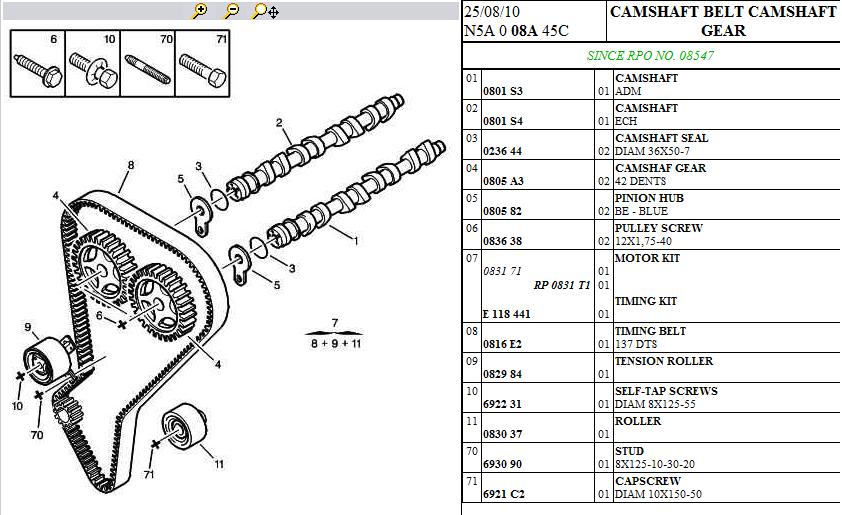

Timing Belt Kit 98.98 GBP
Peugeot DISTRIBUTION MOTOR KIT  0831 48  RP 0831 R5
Timing Belt  42.14 GBP
Peugeot TIMING BELT 136 DTS HT=34  0816 98
peugeot TIMING TENSION ROLLER 0829 35  53.33 GBP
Bolt GEAR-BOX HOUSING COLUMN SCREW M8X125(2) LG 16-34 0820 17
Bolt SELF LOCKING SELF-TAP SCREWS DIAM 8X125-25  6923 78
Peugeot RETRACTOR ROLLER  0830 37 RP 0830 63  27.44 GBP
Bolt HEX HEAD CAPSCREW DIAM 10X150-50 6921 C2  RP 6921 91

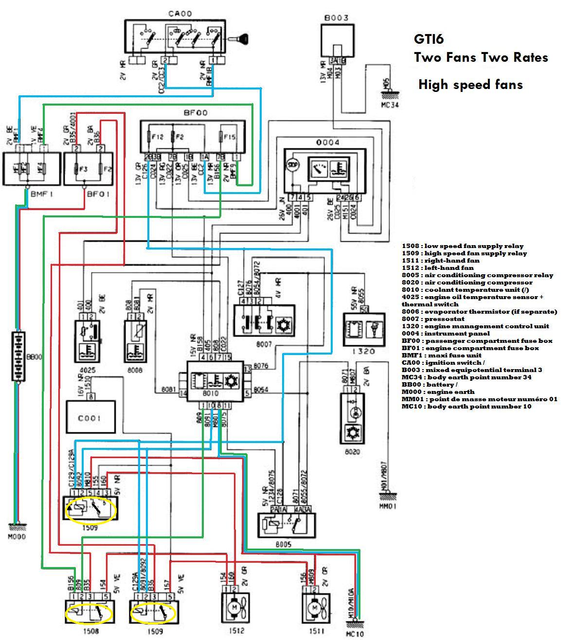

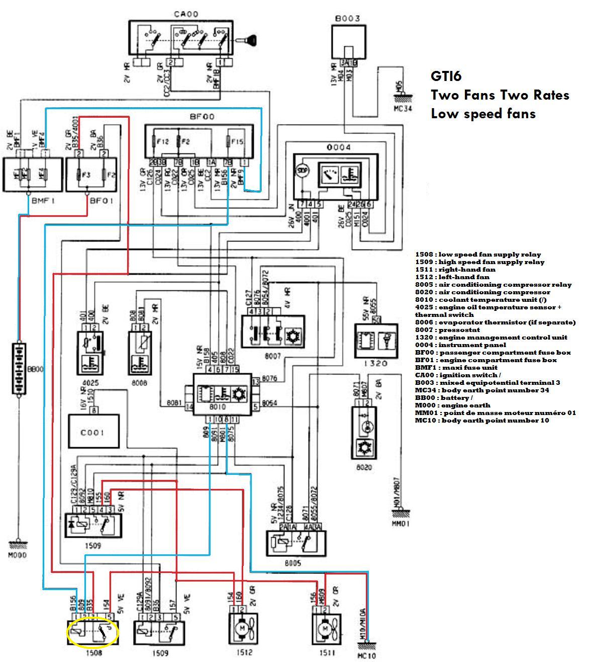

Fan "Bitron" control box's
G. CARTIER 60 299 007/60 336 101 80 triggers (PV) low speed fans at 90 ° C.
G. CARTIER 60 299 008/60 336 102 80 triggers (PV) low speed fans at 96 ° C.
Accuracy: start-up in low-speed (PV) motor fans after turning off the ignition (petrol or diesel) is part of the Post-ventilation function.
This function is active when the temperature unit 8010 is supplied with + 12V permanent its pin 4. Thus, to cut off + Contact at pin 15, during and only during the 6 minutes after the ignition is switched off: the microcontroller comparing the resistance seen at the terminals of the thermistor 8008 brown (pins 7 and 14) to a value corresponding to the temperature of 105 degrees Celsius, or about 3075 ohms (+/- 25 ohms).
If this resistance (which increases with temperature = CTP) reaches or exceeds the value corresponding to de105 degrees threshold, the microcontroller applies a high level at its terminal 10 for a fixed duration of 6 minutes, causing the set to the potential of Masse Pin 1 of the housing and therefore the starting of the motorized fan PV.
In short: from the first second after switching off the ignition and up to 6 minutes later, a temperature of at least 105 degrees causes the PV start-up of fan units for 6 minutes, whatever the variation in this temperature during this time.
On the Diesel 2.1 (XUD11) the post-cooling is controlled by a thermal switch placed on the radiator and beyond the above description.
Note: the delivery of contact during this time of 6 minutes replace the housing in its normal operating configuration. Other behavior of the cooling system should be considered abnormal.

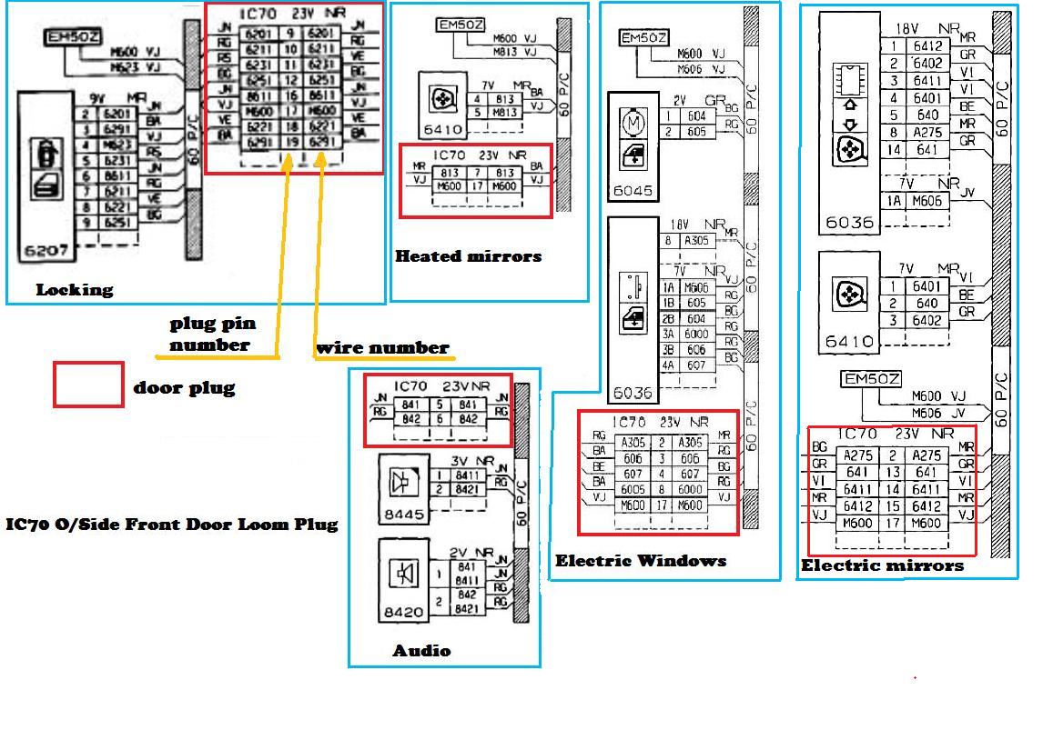

Front door loom plugs PH3

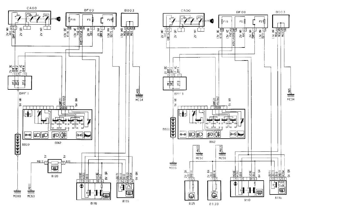

clock temp display

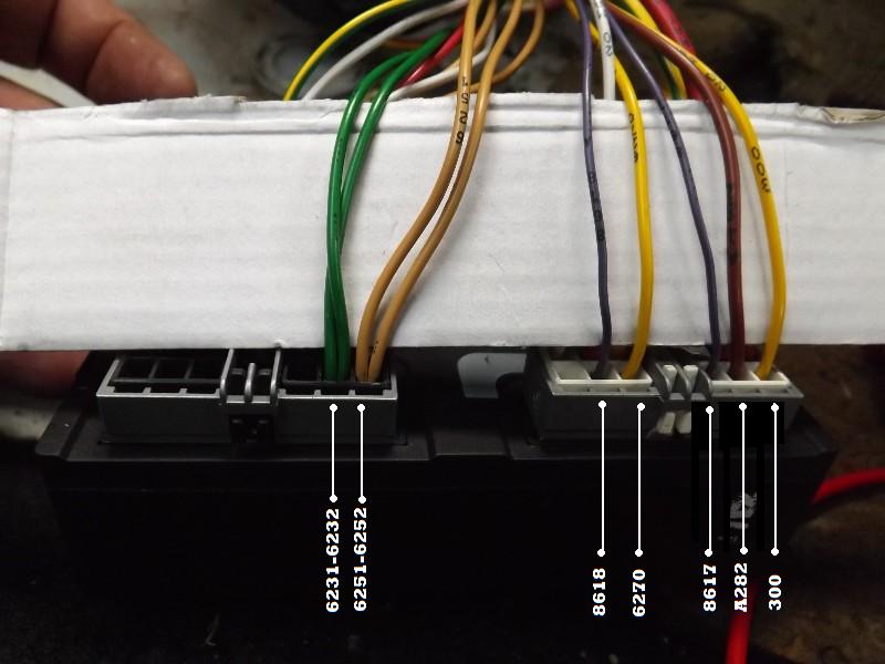

alarm and central locking PH2
central locking box under rear bench
alarm box behind B panel above drivers seatbelt real
*8600 : Dipped headlight relay command
*8603 : Theft protection alarm cut-off command
*8605 : Theft protection alarm siren info
*8617 : Connection to central locking controller
*8619 : Interior protection neutralisation info
*8611 : Left-hand front door open info
*8618 : Connection to central locking controller
*8612 : Right-hand front door open info
*8604 : anti-theft alarm siren control
*8602 : Theft protection alarm command
*8601 : Bonnet open info
*M860 : Ground/Earth
*8606 : L Ultrasonic sensor
*8607 : L Ultrasonic sensor
*8608 : R Ultrasonic sensor
*8609 : R Ultrasonic sensor
*2335 : rear right direction indicator
*2345 : rear left direction indicator
*C033 : ACC 12v IGN
*B142 : 12v

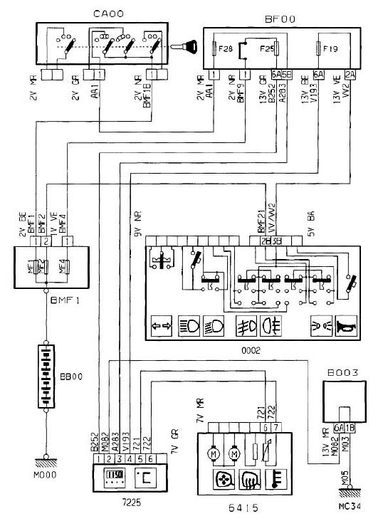

Is earth MC34 the one under the fuse box, point 9 in the earth point PDF?
possibly yes that point runs to a common link plug block behind the fuse board somewhere
