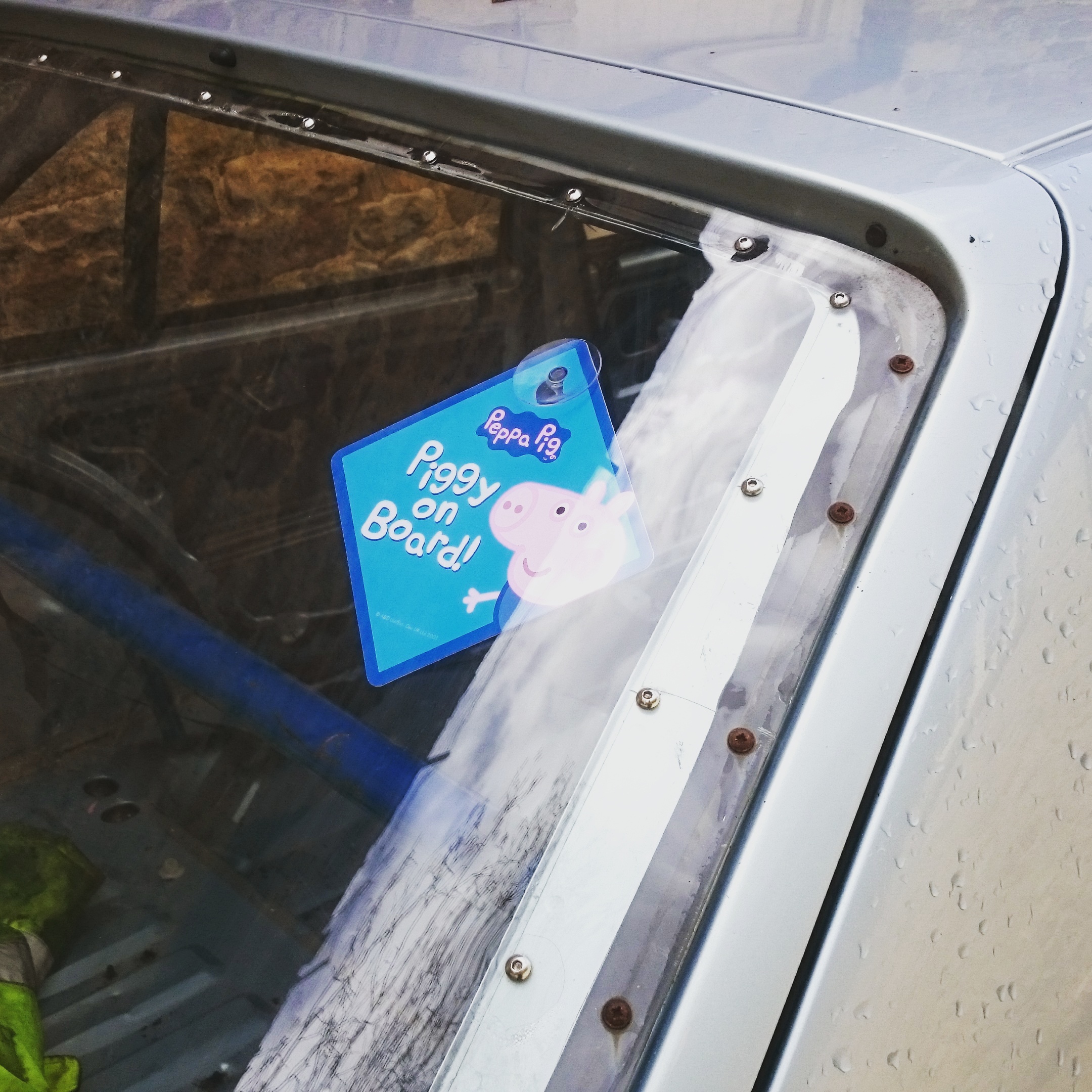

Feel bad for car.
Has turned into shed on wheels.
(14-03-2016, 08:11 PM)Piggy Wrote: Feel bad for car.
Turned into? Itwasntme
