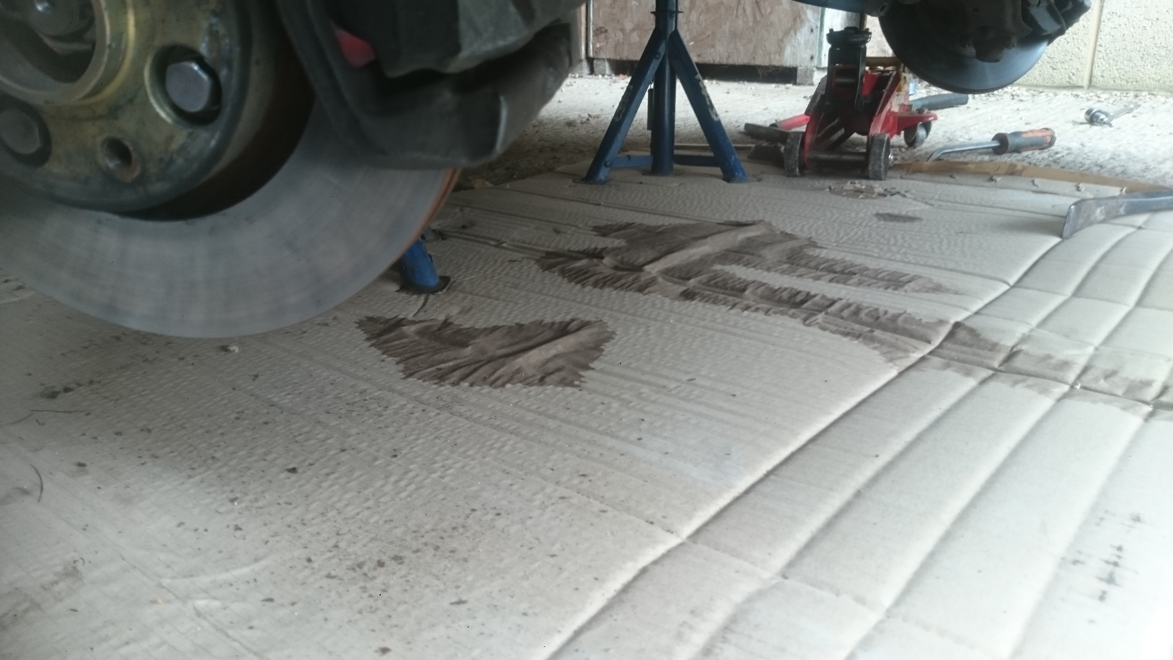

So needed to do a few little things...
Essentially:
coolant loss/leak
brake fluid leak
gearbox oil leak
see if can find oil leak
horrific knock on NSF
So I found leak, nipped up a jubilee for that.
Replaced section of brake line.
Removed drive shaft, cleaned shaft seal lip and replaced 'box seal for the THIRD time. (this time with a Febi one) Topped up with proper stuff.
Clean off back of sump to try and spot oil leak asap.
removed strut brace and "adjusted" (read: used a big grinder) the gap for the damper adjusters which look like they rubbing.
Stripped down NSF suspension strut, checked for damaged anything and play anywhere... replaced strut top mount and bearing (Used Febi/Bilstein parts)
Go for test drive feeling all happy and confident.....
Stop at end of road and "CLUNK"... pull away to "CLUNK CLONK CLUNK"... DAMN KNOCK IS STILL THERE!!!!  Censored
Get back home... coolant STILL leaking and gearbox STILL leaking.
Whole bloody day taken off work to do all these little bits.... and I didn't even manage to do ALL the things I wanted and I STILL have a major suspension noise!  Nospeak
Little annoyed right now.
Driveshaft knock? My last 306 had it and I must have jacked it up and wobbled everything in the wheel arch 20 times before I sussed out what it was.
205 had a nasty knocking that also turned out to be driveshaft.
                                             [Image: 2ljm03k.jpg]
                                                                                      I Don't Have A 306.
(27-10-2015, 08:06 AM)Danny Wideboy Wrote: Driveshaft knock? My last 306 had it and I must have jacked it up and wobbled everything in the wheel arch 20 times before I sussed out what it was.
Driveshaft been replaced, no play in it whatsoever
Its a 306 you can't stop all the leaks, just move them further along... lol
Where was your new driveshaft from? If it's a cheap one, not impossible that it's not perfect, or was the noise the same before replacement? You can't always feel them either, I had one knocking on the GTi6 that felt fine but noise disappeared after changing.
Also you mentioned a loose caliper, they make a single knock on pull away/lift off also, I had that on a 106 after forgetting to torque the caliper bolts so they vibrated loose lol.
Wishbones been replaced recently? Possibly wrong sized balljoint causing an issue?
Haven't read back to when this suspension noise started in your thread but know how irritating it can be.
What HAVE you checked thoroughly?
(27-10-2015, 08:44 AM)Toms306 Wrote: Its a 306 you can't stop all the leaks, just move them further along... lol
Noise same before/after with shaft.
Caliper wa slightly loose on its sliders, packed in more grease!
(30-10-2015, 07:04 AM)ginge191 Wrote: Wishbones been replaced recently? Possibly wrong sized balljoint causing an issue?
Wishbones still same as when I built the whole thing up 2yrs ago.
Ok, checked:
Wishbone/related bushes.
Bearings/TREs
Hub ovaling
Hub bolts
Top mount/bearing replaced
Strut damper movement
Shafts
Subframe bolts
PAS bolts
Caliper
Lower engine mount
Could it be box related?
(30-10-2015, 07:47 AM)JJ0063 Wrote: Could it be box related?
That is what I have been starting to think tbh JJ.
I do have a spare... But want to rule everything else out and tbh Ive never heard this typical suspension/joint clonk from a gearbox before.
I have yet to check thoroughly the two main gearbox/engine mounts... Aiming to do that later if it stops chucking it down and I can get on with work!
Mrs JJ had an ep1 civic which had a box knock which for months I thought was shaft/suspension. Seems like clutching at straws but when you've checked as much as you have then you have to start working up the chain!
If it's not engine/box mounts and you're certain you've checked the things you have properly then considering you've got a spare box it seems like the next step really.
Next step in man logic terms is to do a Tom and fit a quaife diff Wink
