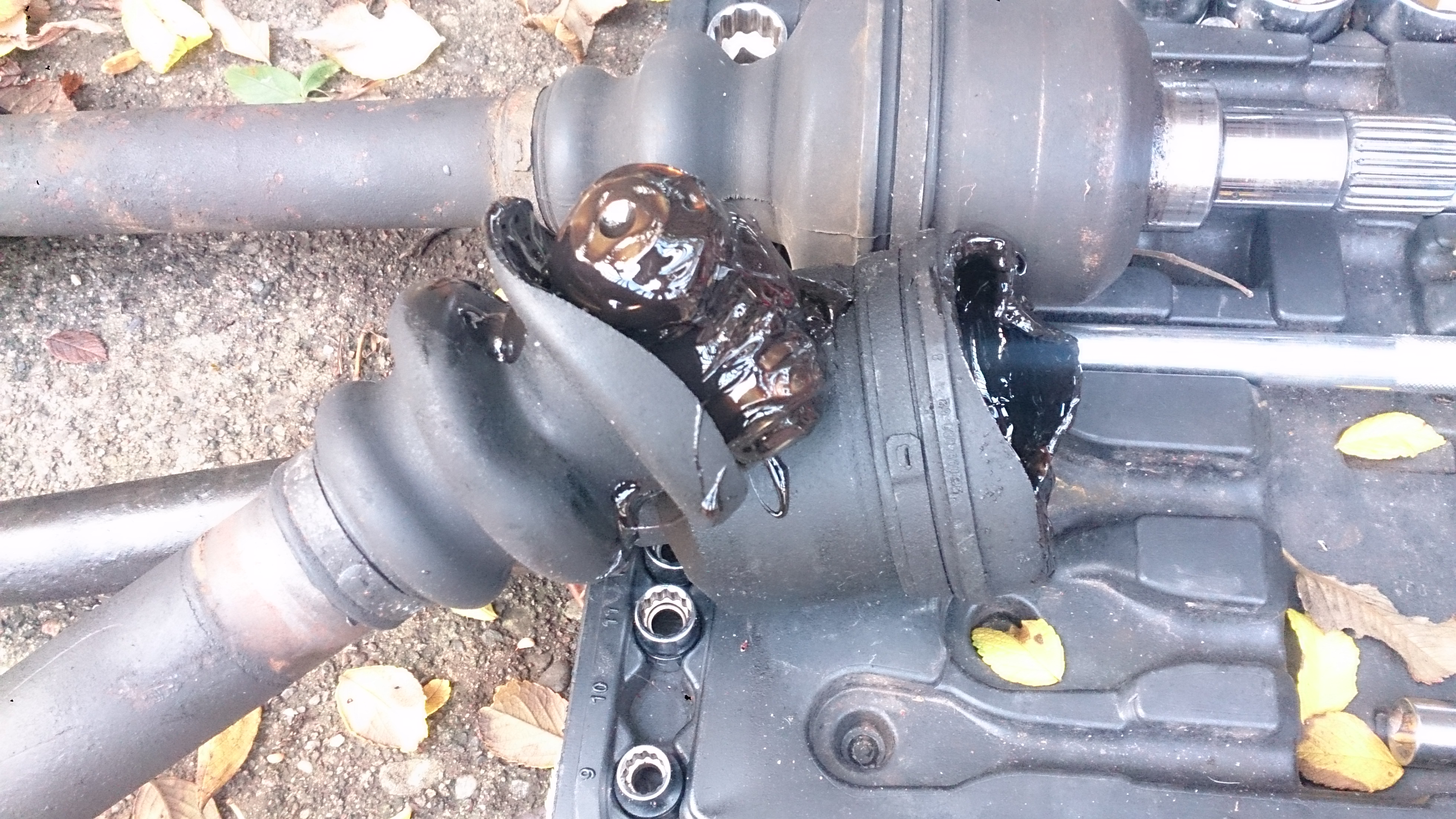

Then this happened :S Hopefully it's just a gaiter

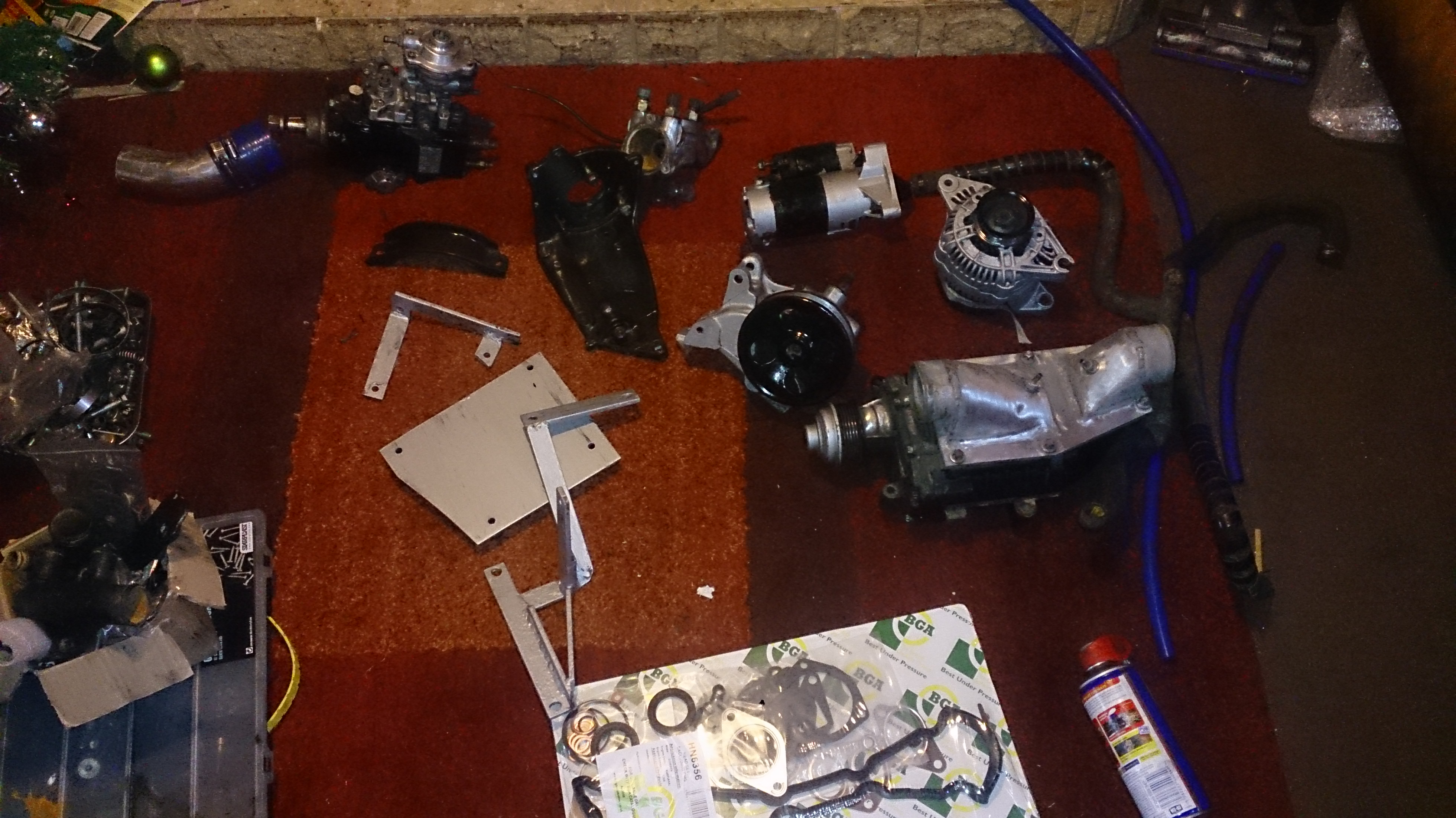

Bits on the floor. Both hubs are off as well as I'll be getting new bearings pressed in
The pump will be coming home with me tonight as well for a good clean.

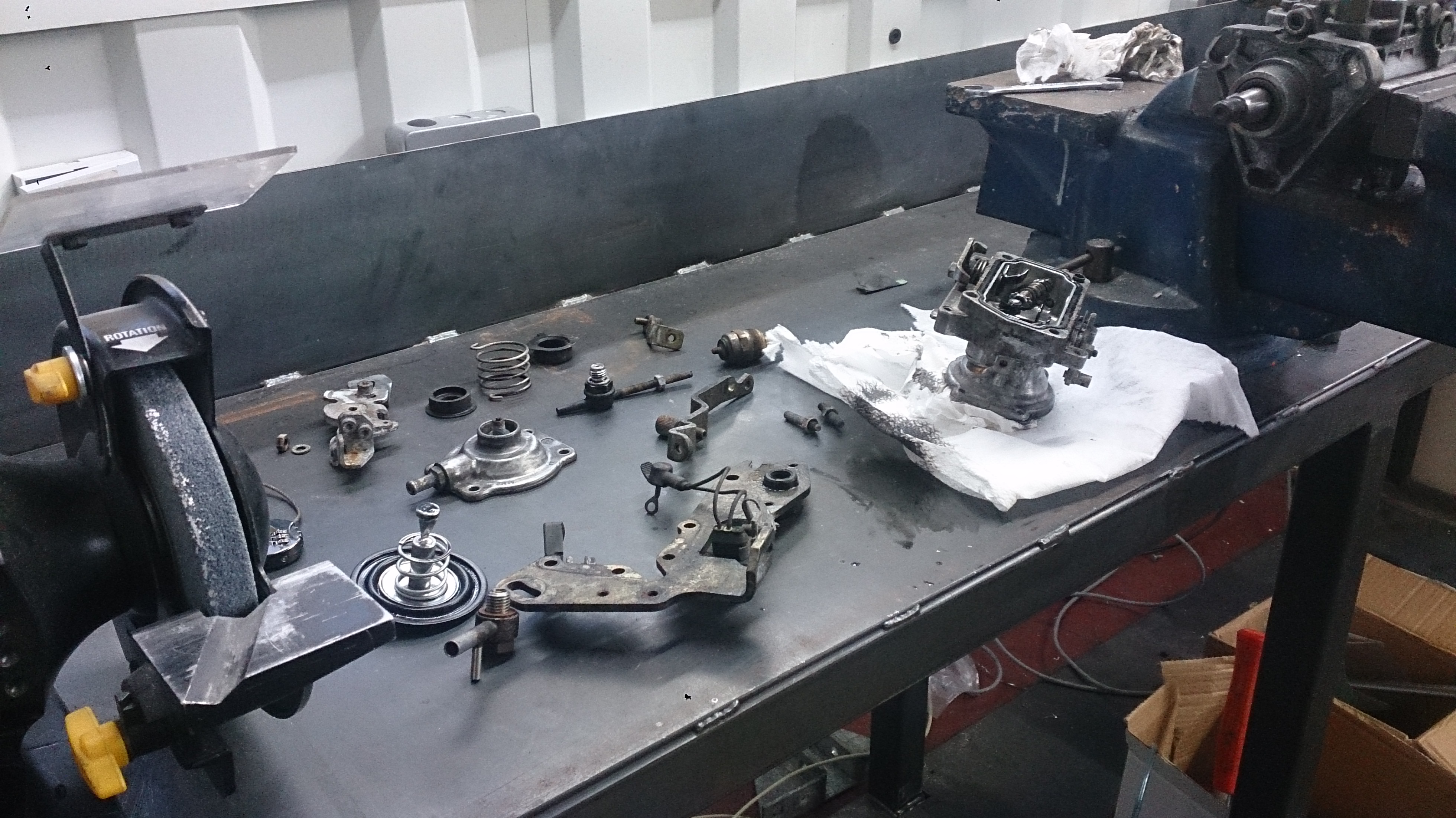

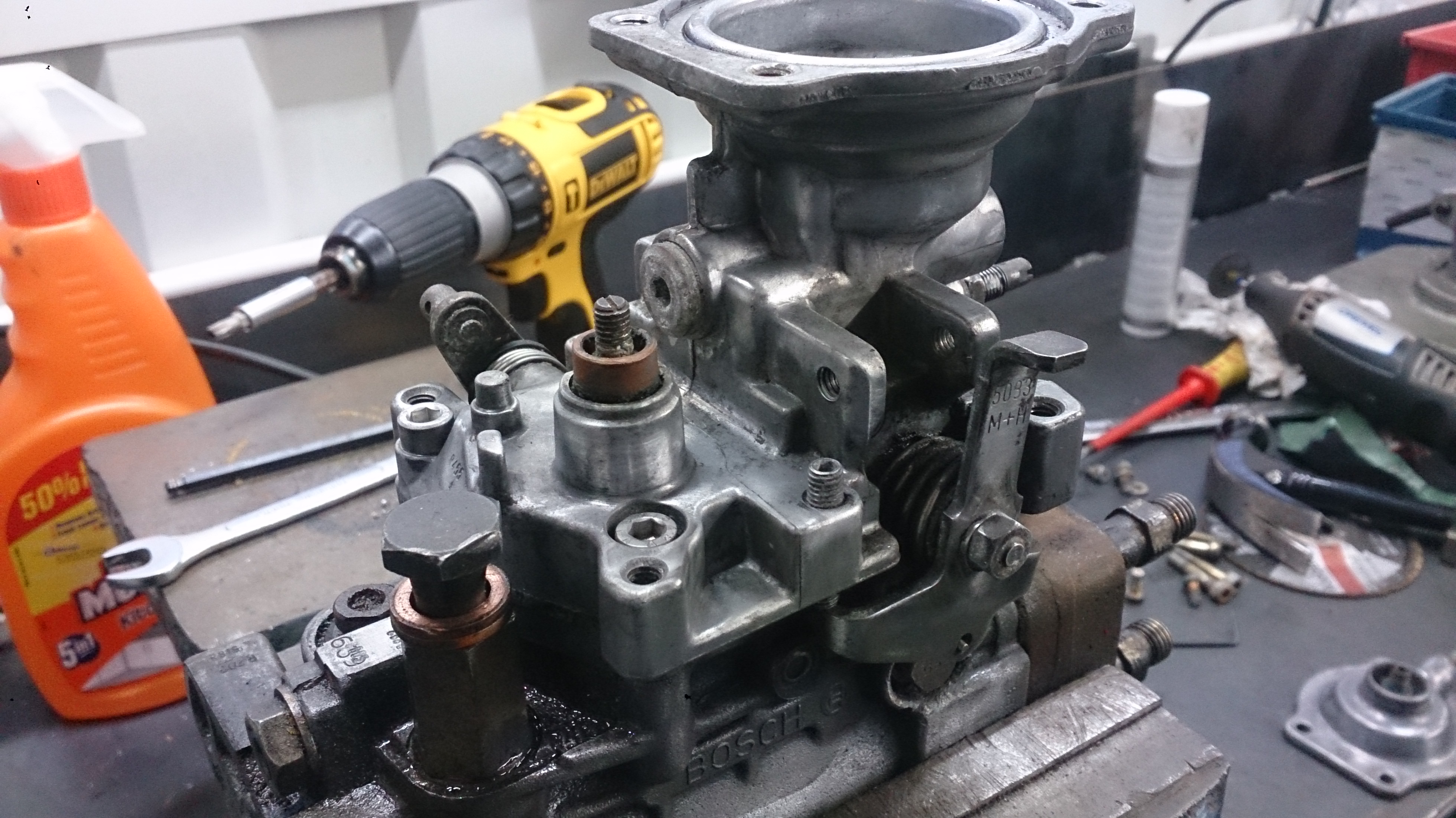

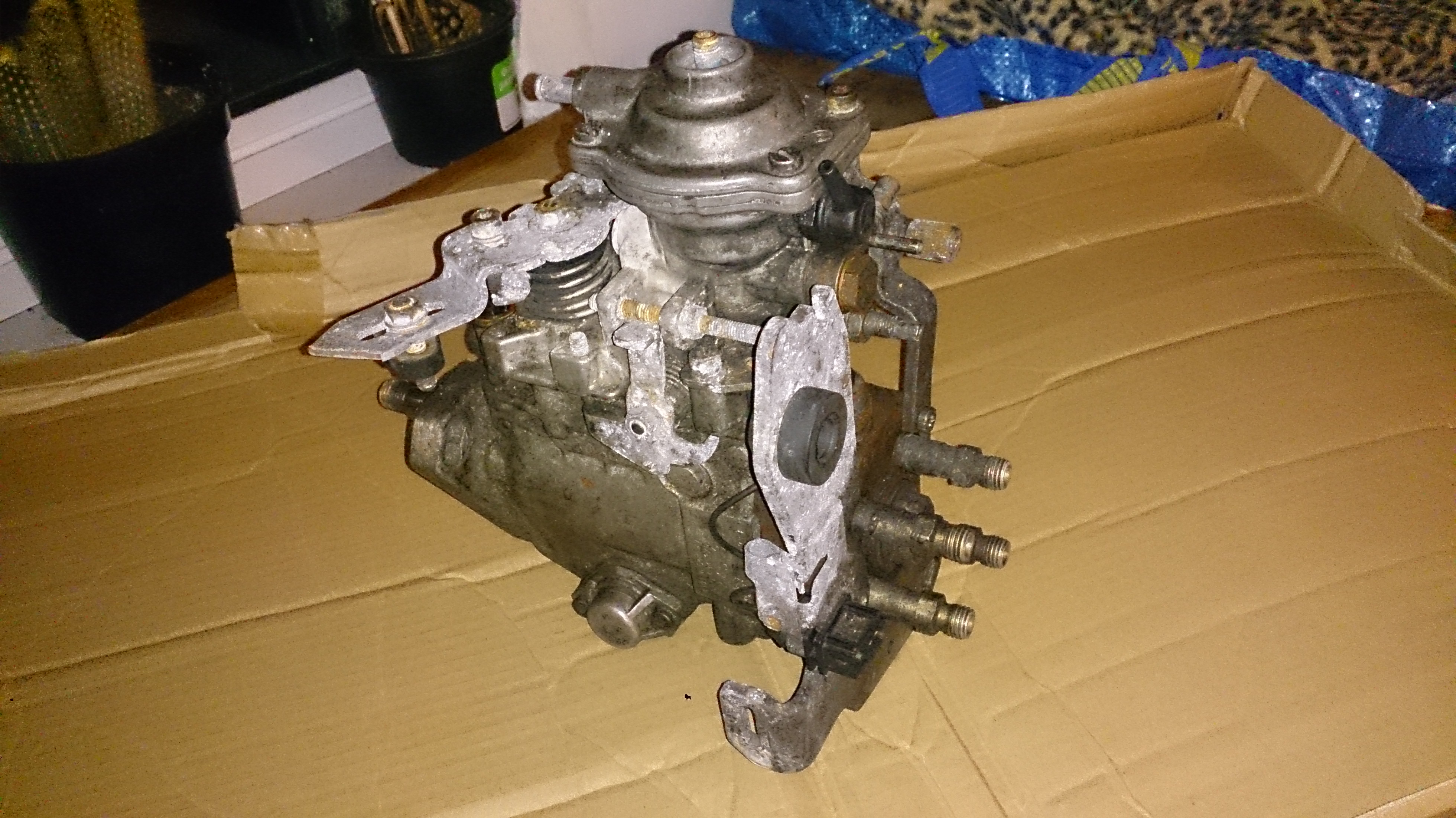

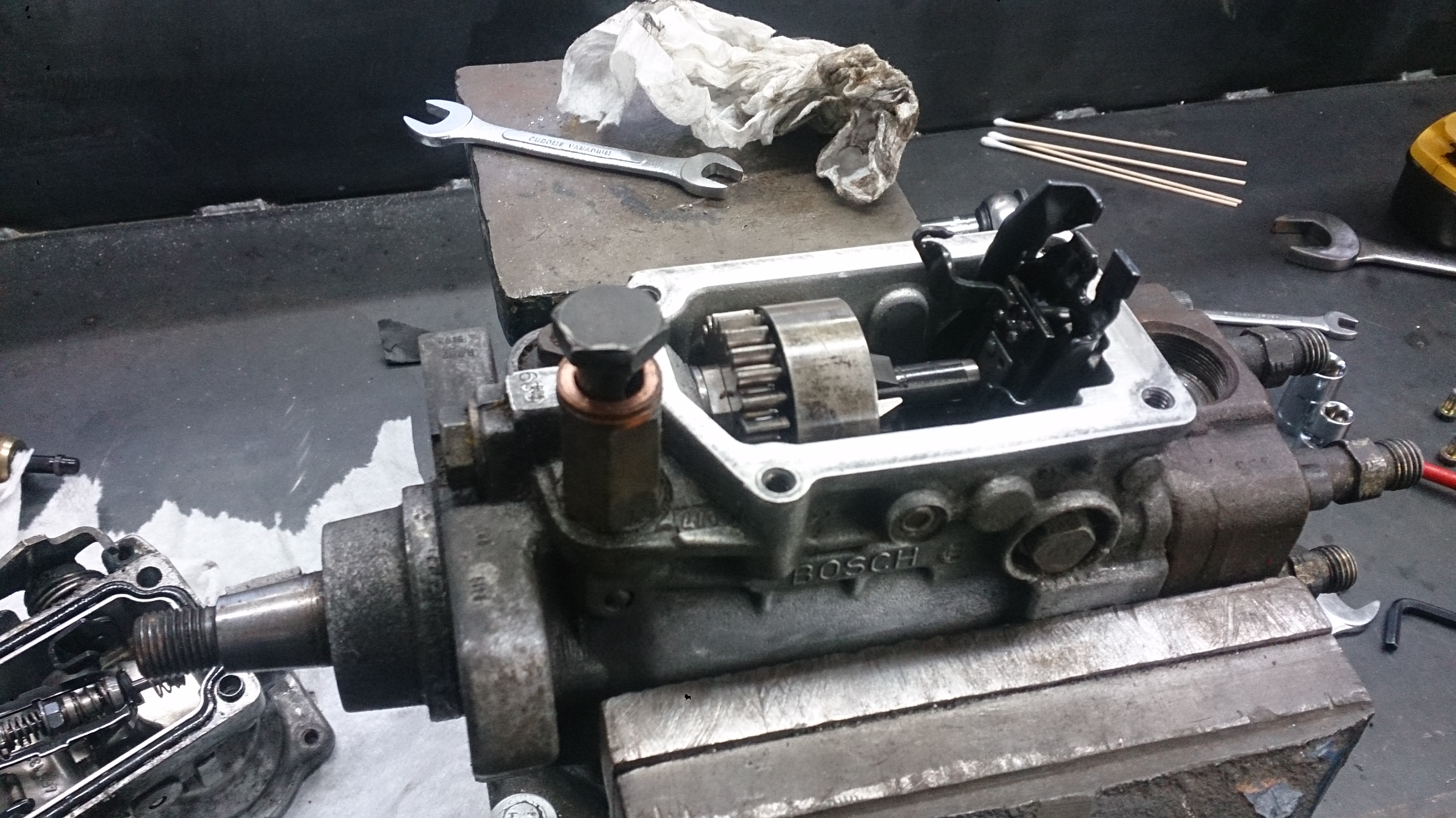

Had my daughter last weekend so no proper progress but the temp engine came from Jacko and I started giving the pump a clean as well especially as its had 2 HG's let go on it!. I ordered a seal kit for it too as I've disturbed a few rubbers now.
The new block

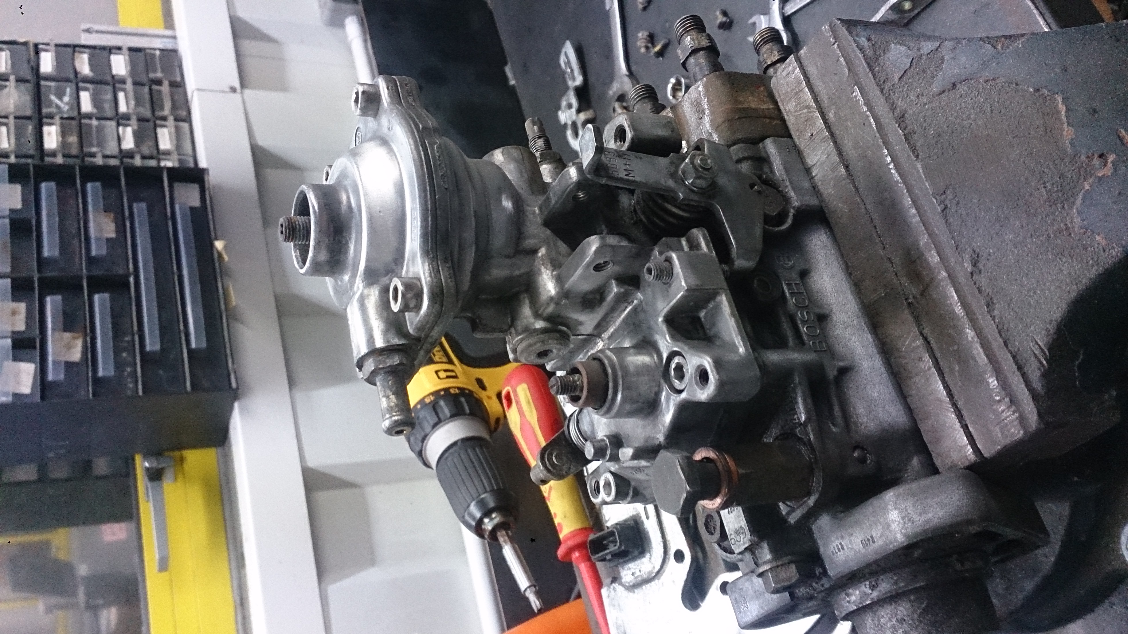

And some pump porn Big Grin

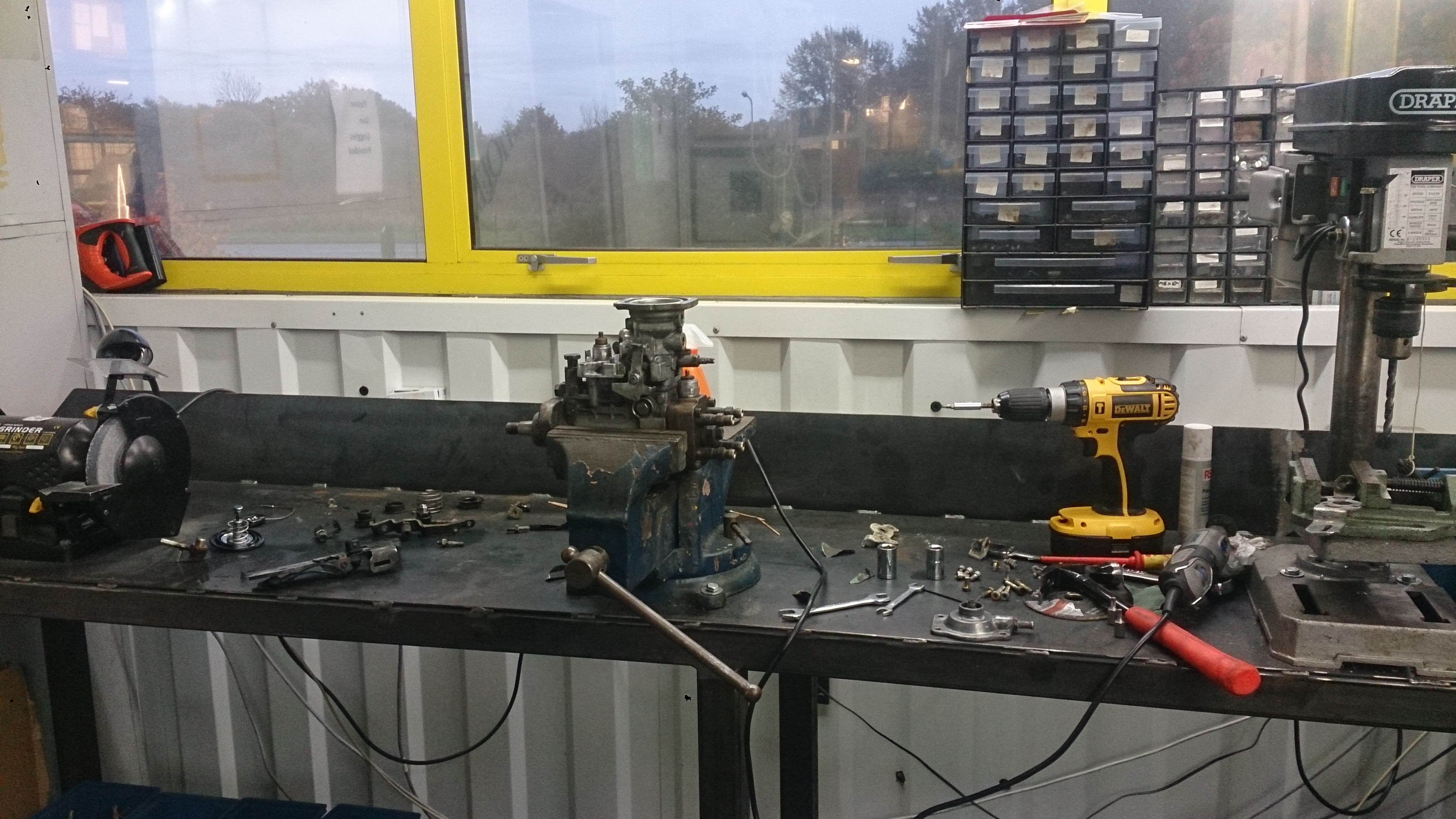

All done with the dremel!! Not sure on weather to carry on or to paint it and if I do paint it what colour????

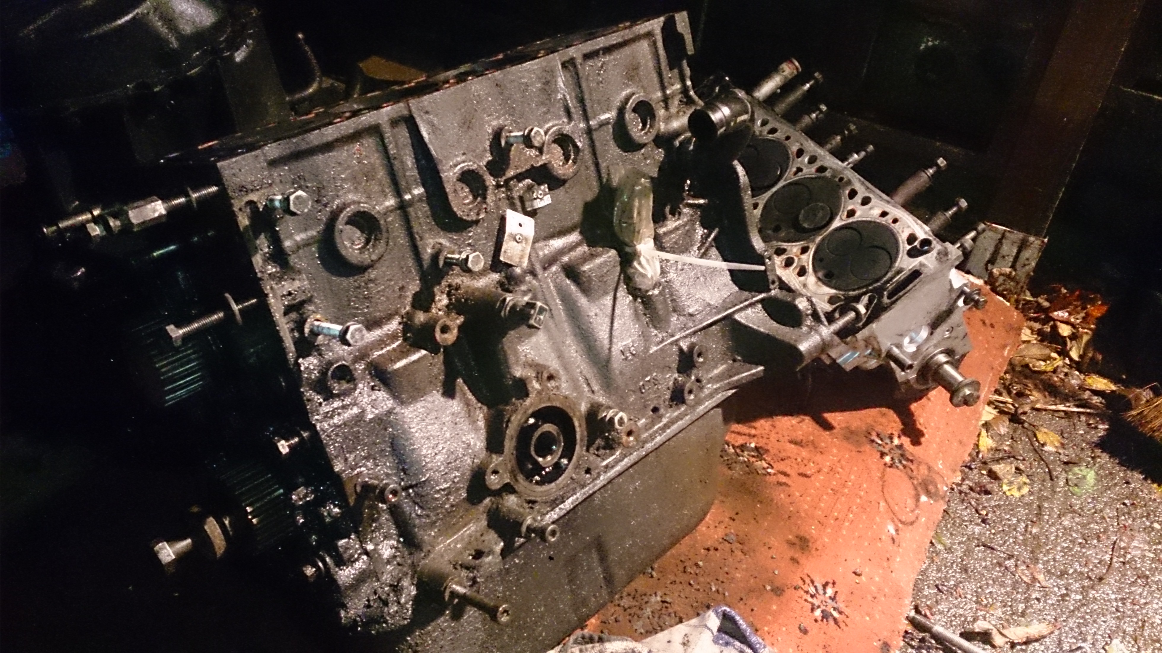

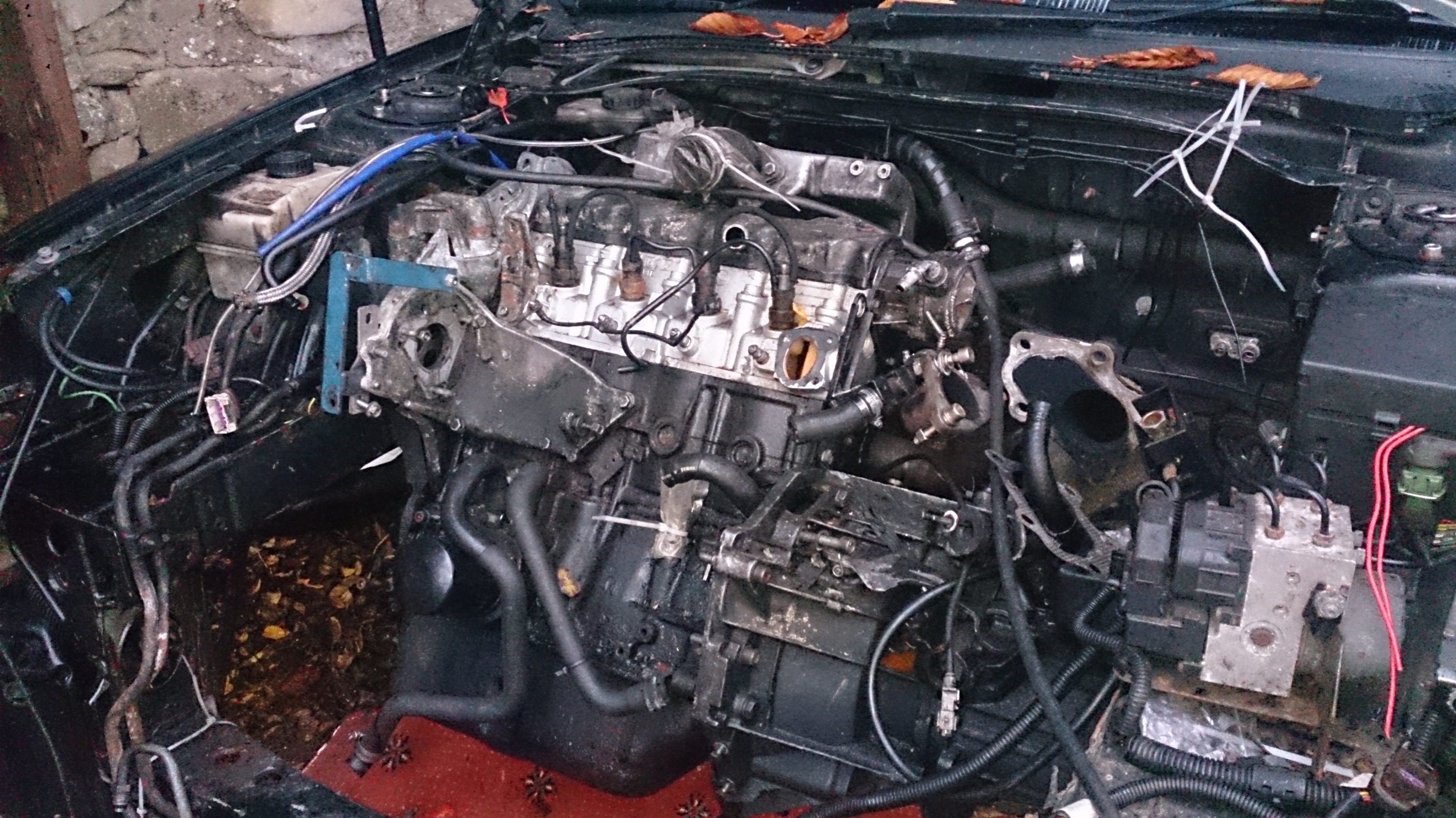

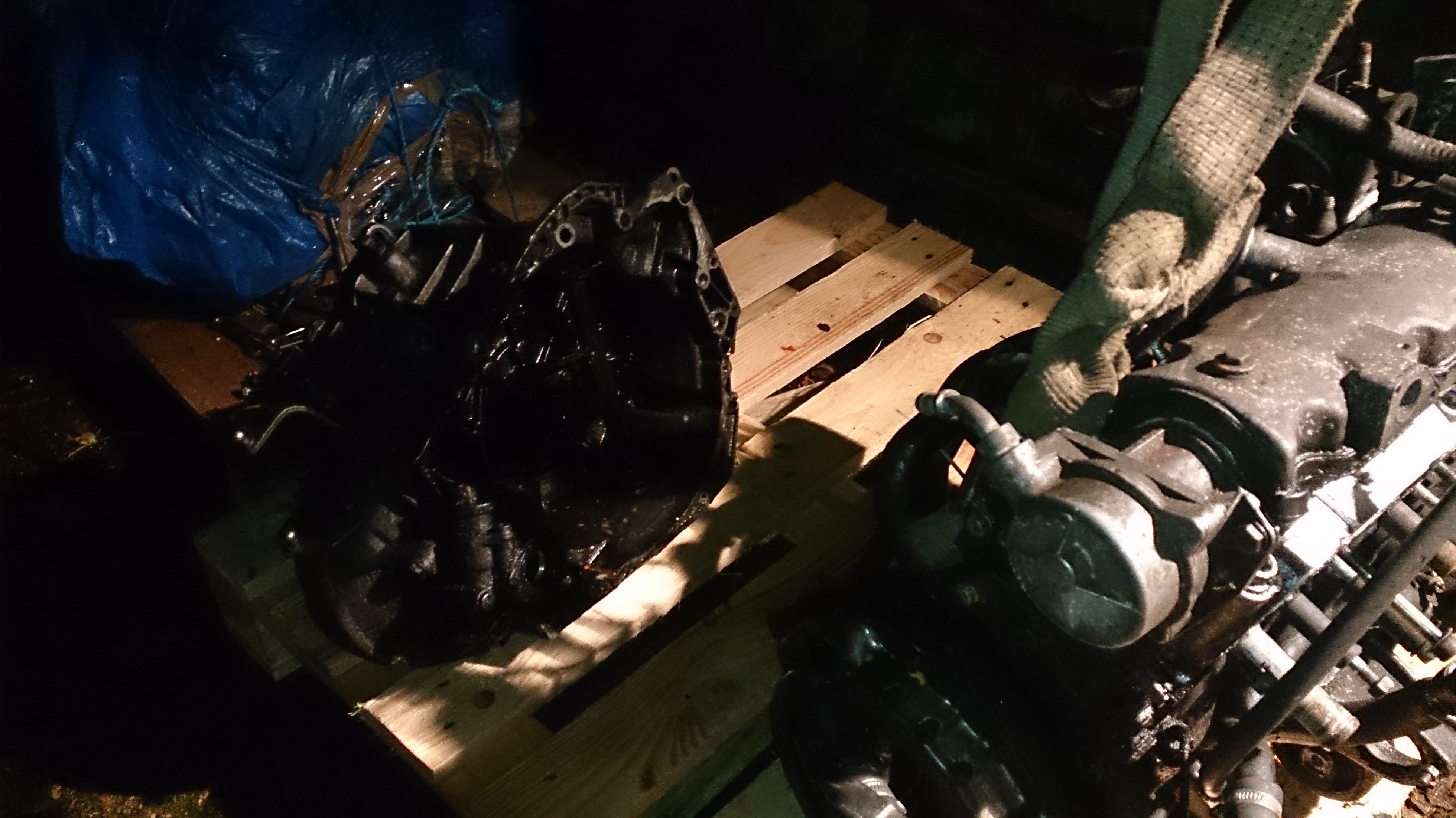

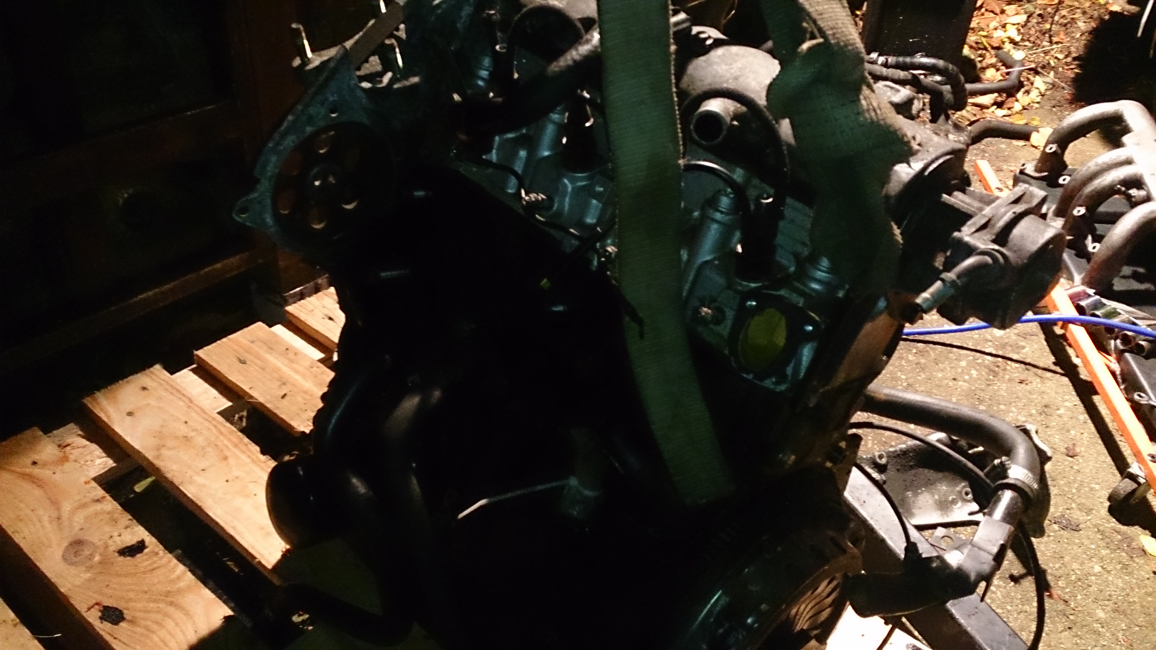

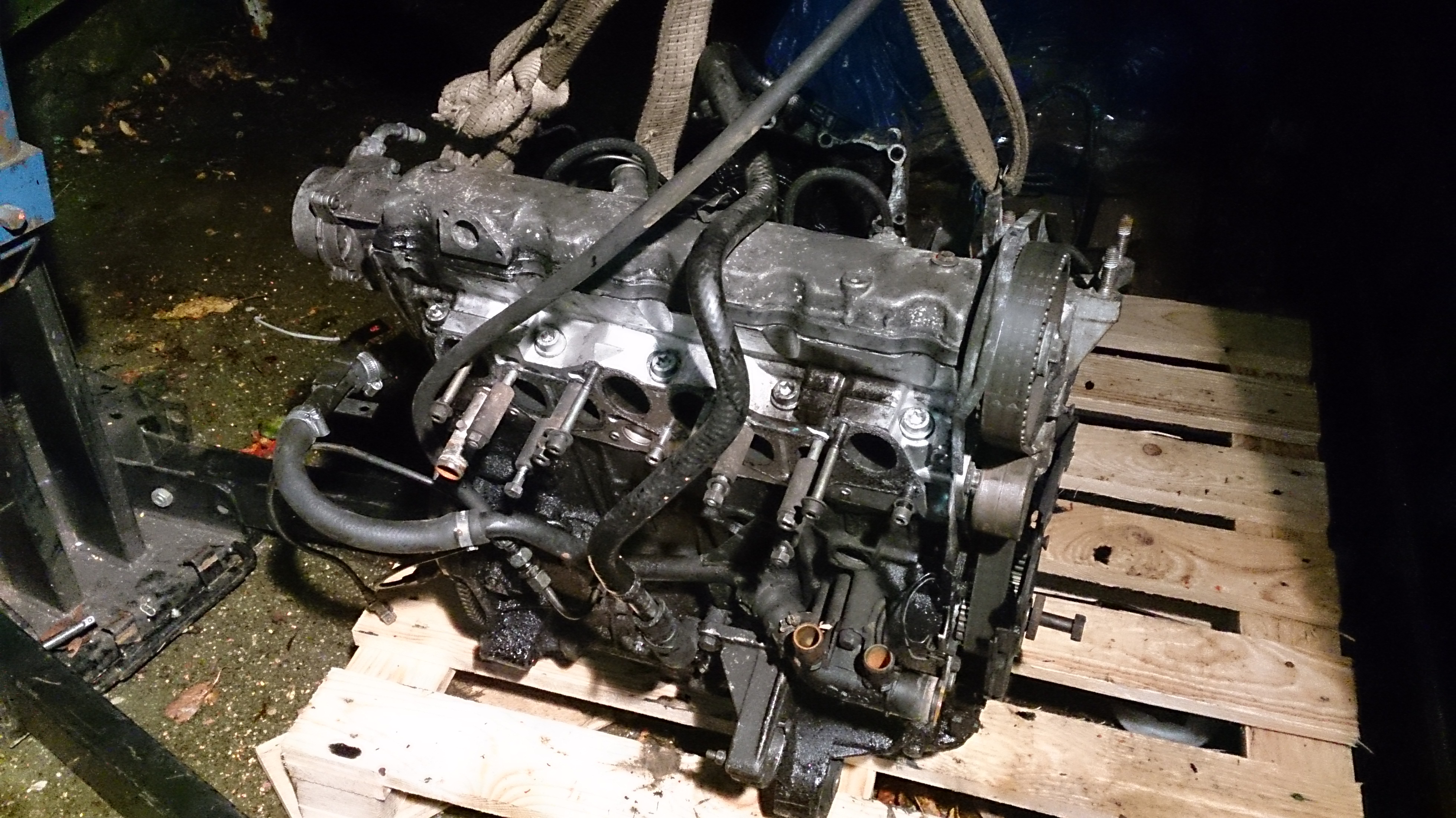

Engine came out late last night, managed to split the gearbox and remove the manifolds as well.
Pictures are a bit crap due to the bodged light!
The cable tied light!! Pikey ftw!

Dare I ask what you've used the dremmel for and what it will achieve? Or will you tell me to get stuffed. lol
(06-11-2013, 02:00 PM)c.gerrard Wrote: I want to see photos of it finished, not in a million pieces!
Looking very interesting.
is cleaning top secret these days then? . . . .Wink
Ah, if that's all it is, I will will hang my head in shame and crawl back into my hole lol
Lol. Yea dremel polishing ftw!!

Erm erm, must think of something smart to say to salvage my reputation as forum genius. ...
Why that part of the pump. Don't the diesels keep it clean enough?
I didn't clean the inside with the dremel!!! Just easier to take the top off, plus I have replaced some of the bolts with stainless

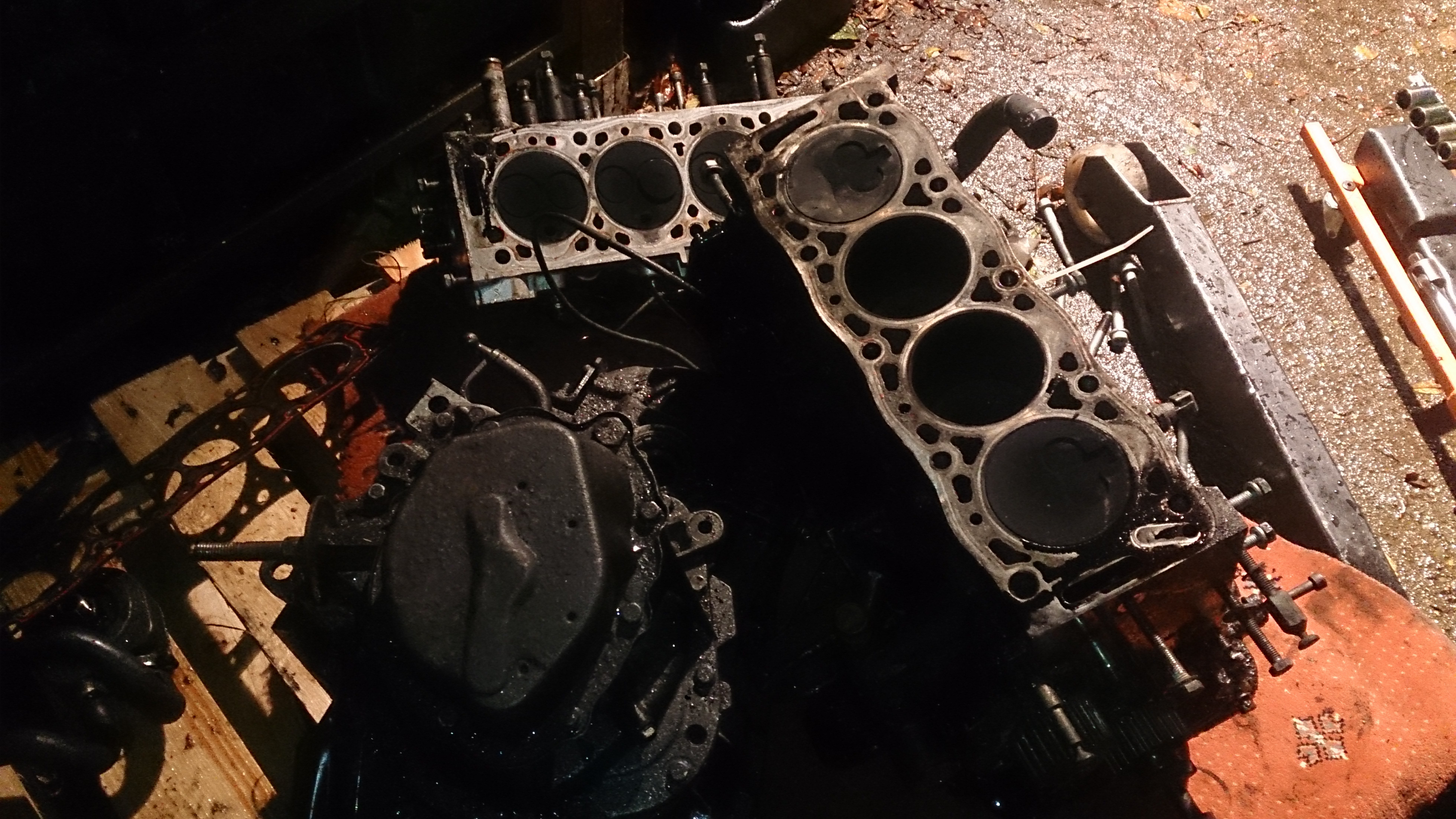

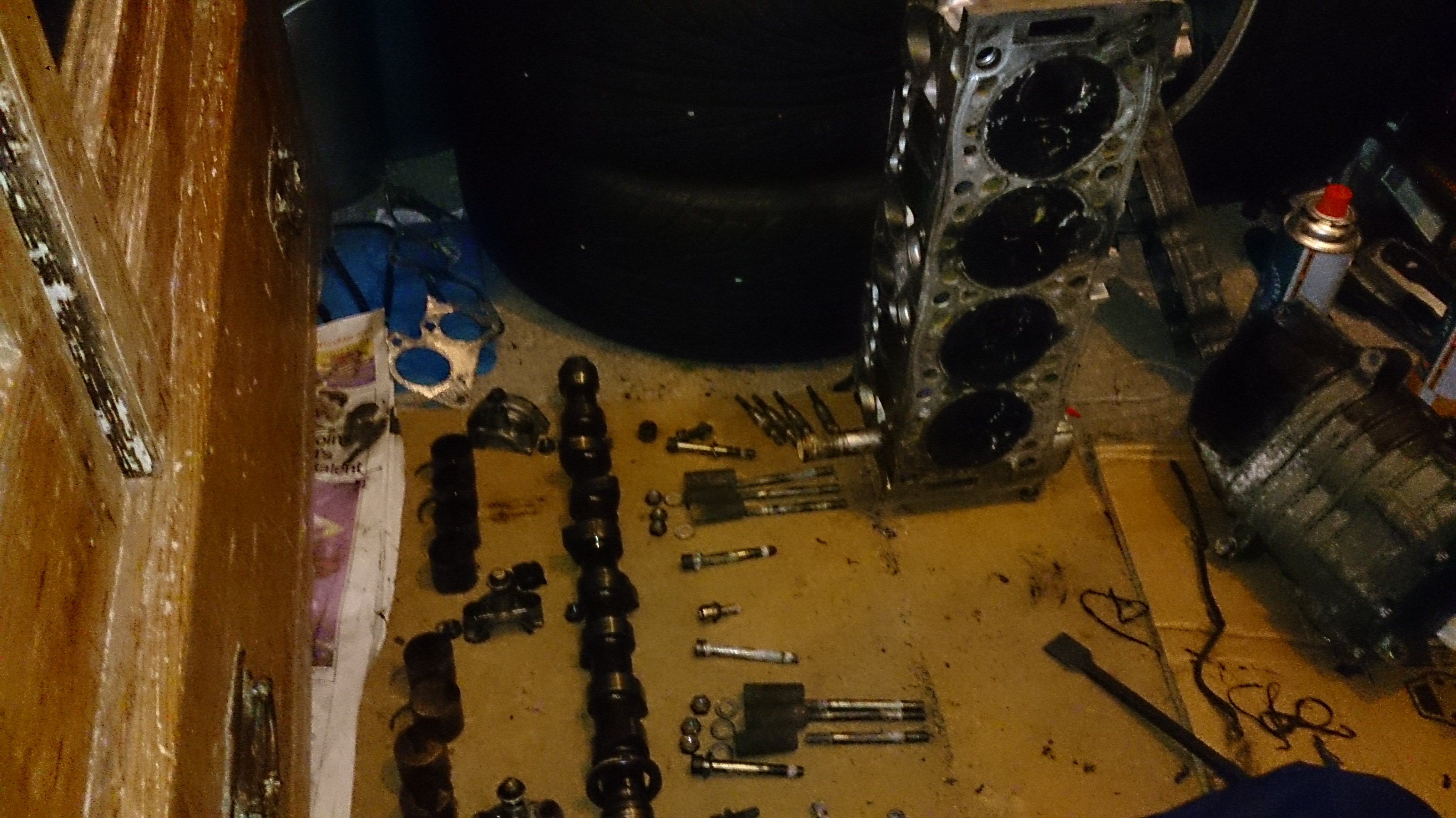

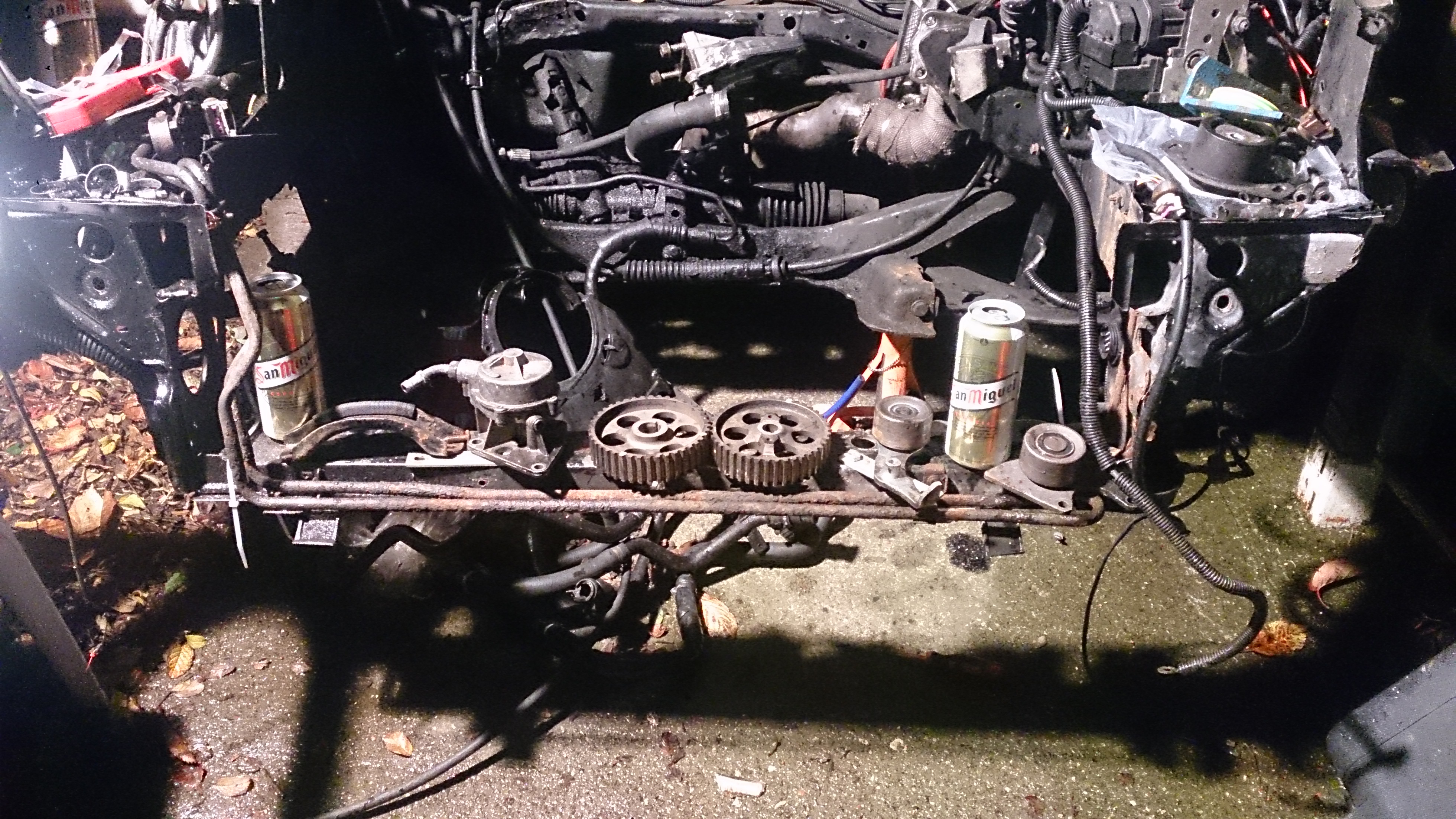

Head came off tonight as well as clutch, flywheel and a few other bits

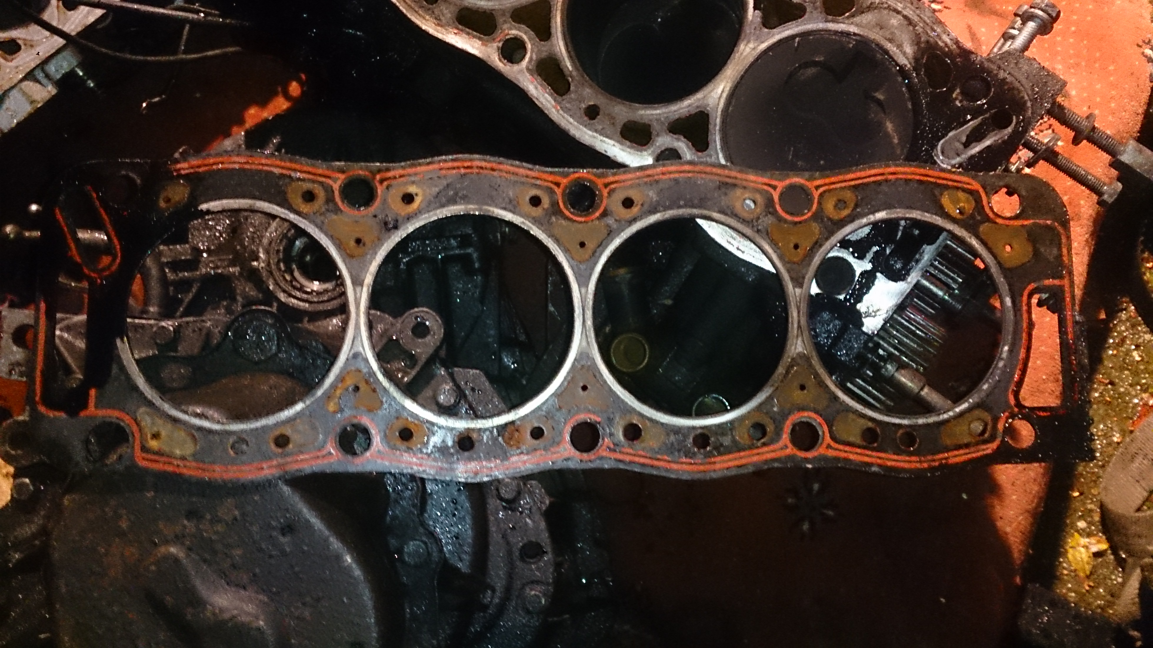

Pics as usual Smile Block and head all seem to be in good nic. Can't see an obvious point where the hg let go but it will be between the cylinder and waterway somewhere....
Top deck and pistons look good
Is this the problem area around No.3????

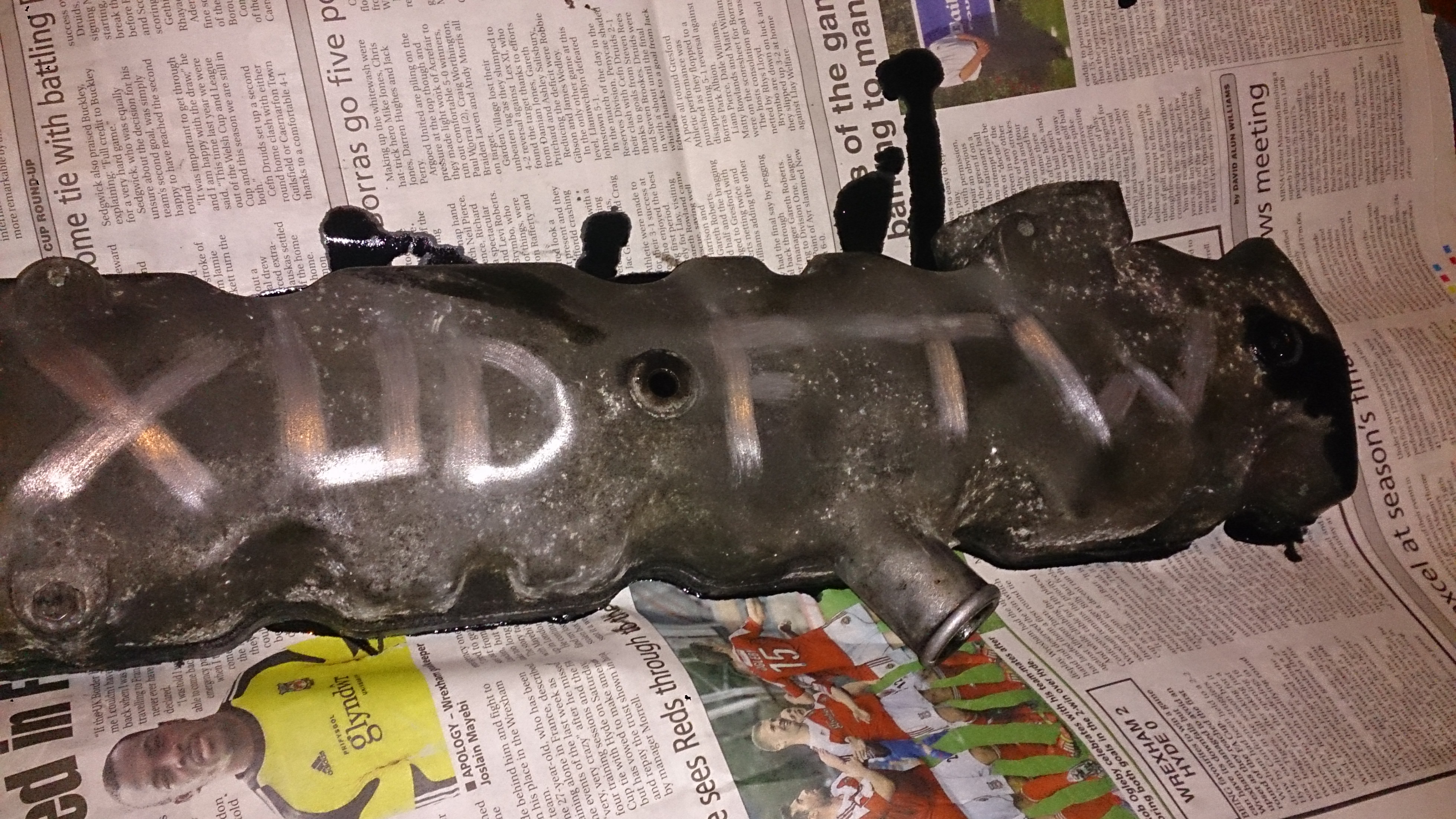

What colour to paint this???? Huh

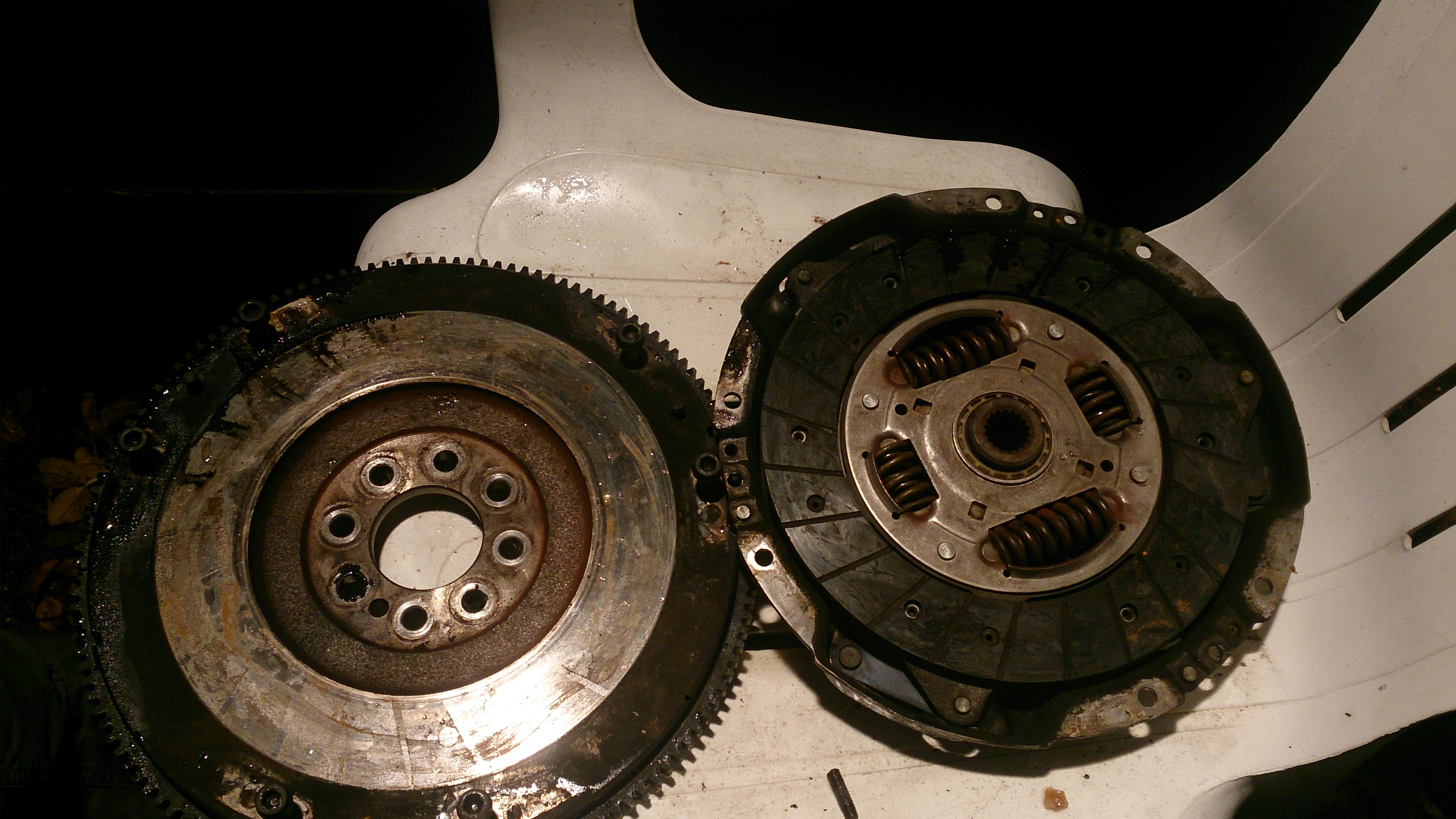

Loads of meat left on the clutch so that can defo go into the little engine, not sure weather to get the flywheel lightened yet or not...

(06-11-2013, 05:05 PM)c.gerrard Wrote: Erm erm, must think of something smart to say to salvage my reputation as forum genius. ...
[Image: extremefacepalm.png]

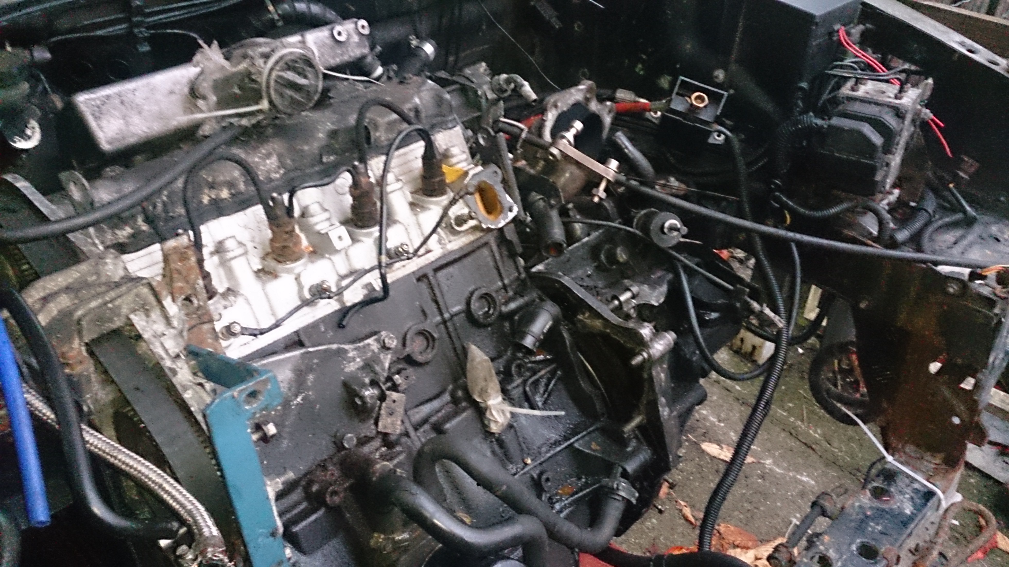

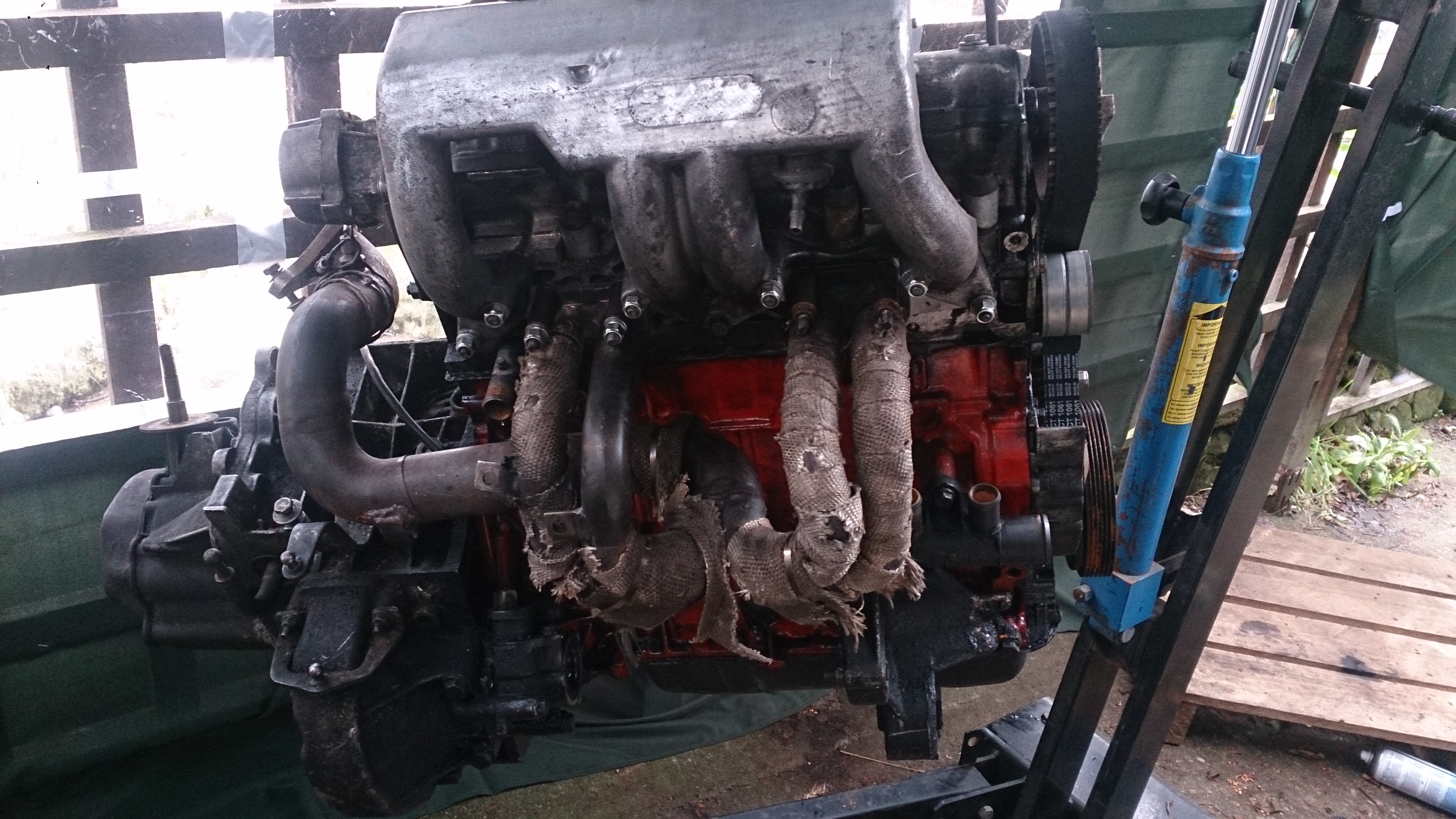

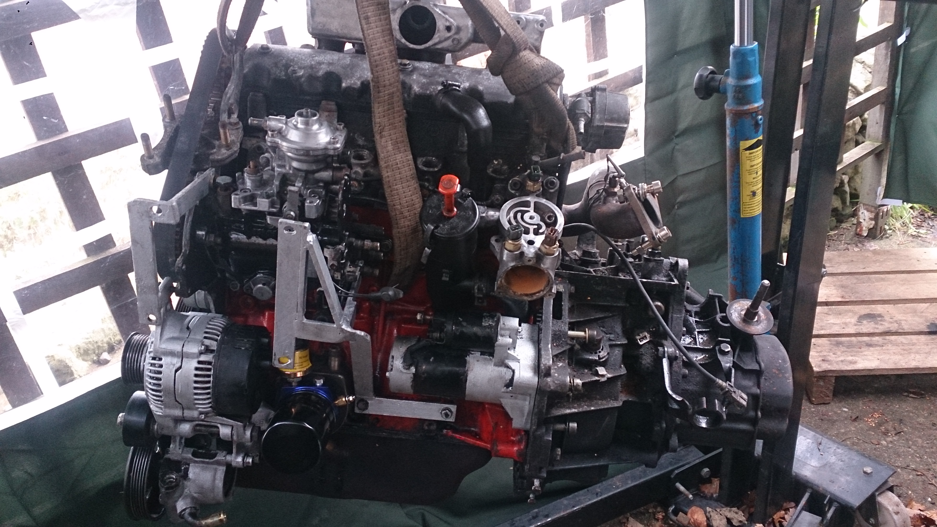

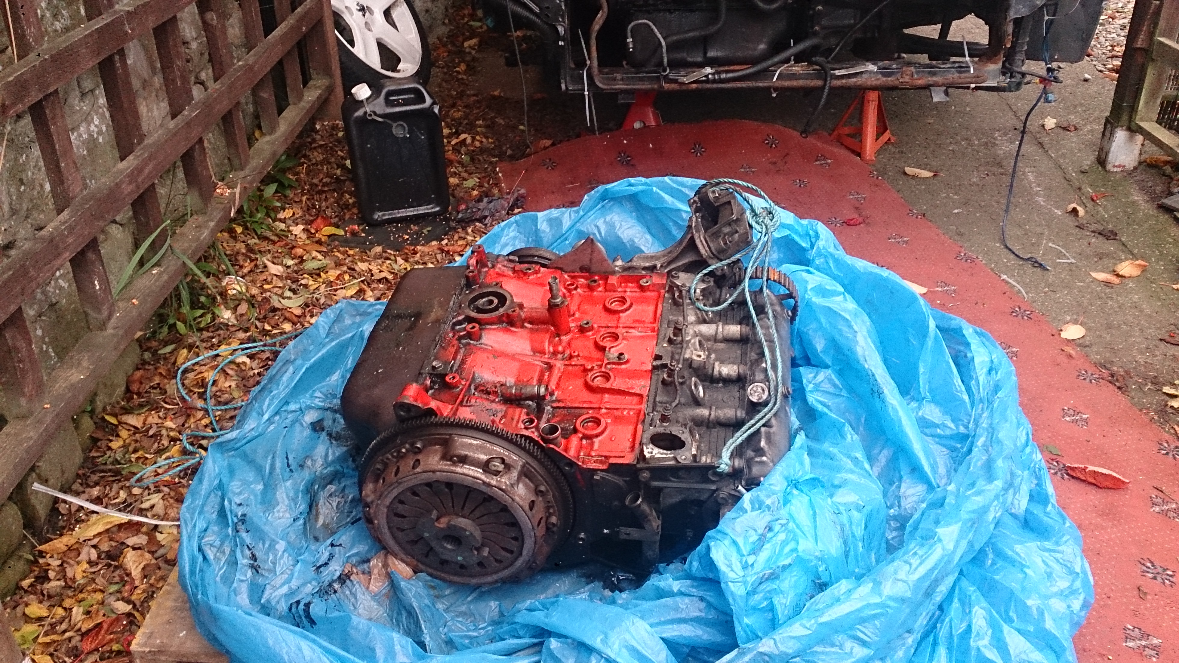

Then yesterday and today I built up the spare engine Smile

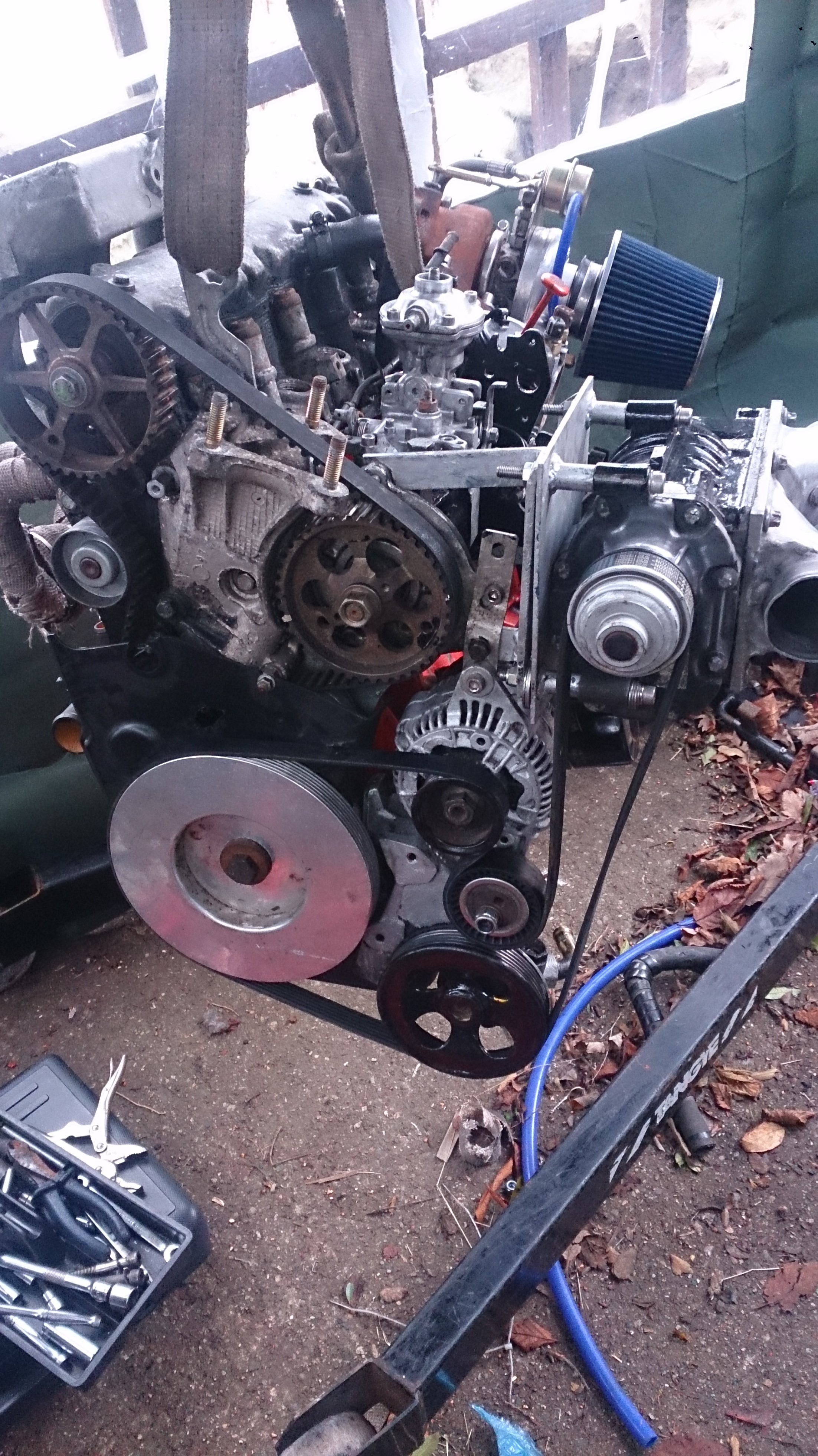

Cambelt on - I may take the engine out every time I change the belt from now on!!
Power steering pump and oil sandwich plate on
Then POW!
The difference in the 2 crank pulleys! The weight of the bigger one is about half that of the stock one too!
Charger belt routing
And she's in!!!!
Thanks for reading Smile

Looking good chap! How far is it off running again?
What's the benefit of the bigger crank pulley? Looking good Big Grin
(15-12-2013, 07:57 AM)Chris_90 Wrote: What's the benefit of the bigger crank pulley? Looking good Big Grin
Increases the charger speed so more air being pushed through. IIRC Darren had that pulley made to take the charger up to about 15,000rpm which is about their limit. Pretty sure it was 15k anyway!
Oh interesting Big Grin more boost is defo for the win Wink
