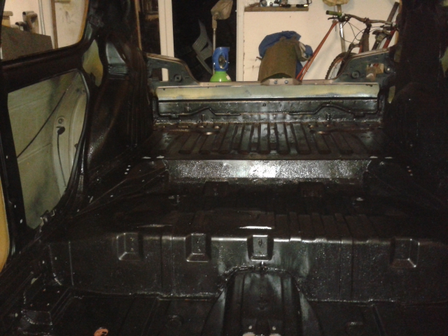

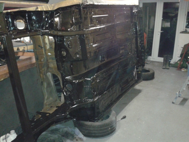

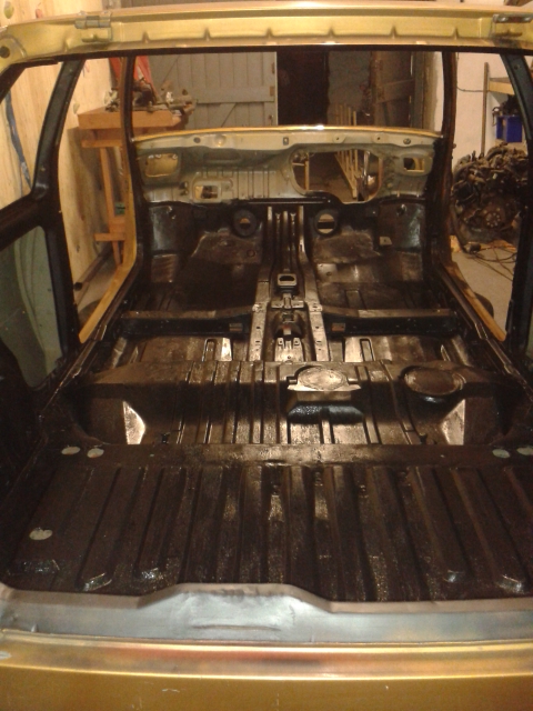

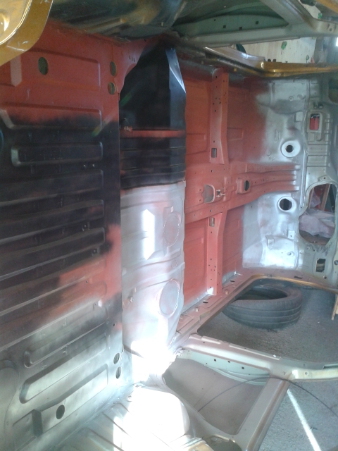

Another update chaps. And it's a big one!
We've got all the welding done, finished the preparation and, finally, painted the underside!
Which looks AMAZING!
And for those of you who want a laugh, google "removing POR15 from skin"
Then look at this picture Tongue
that looks great!
Missed a bit.

shame you'll never see the under side...
well I would hope not anyway!!!

That looks awesome!
(16-09-2013, 11:17 PM)Jonny81191 Wrote: Might spray "P.T.O" on the bottom lol
Do it Jonny ! lol
[Image: siggy1.jpg]
Looks good girls Tongue
Awesome progress guys. That's gonna look awesome under there with everything crisp and fresh
Its going to be like building a brand new 306.

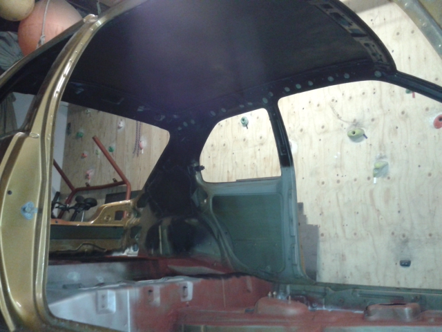

So here's the latest..
It's so much better to paint than grind rust! Big Grin
We've now got the whole inside painted, just a few bits to touch up here and there. On the floor, we used deck paint that you'd normally find on fishing trawlers, it's got sand in it to make it all grippy, and covers pretty much anything!

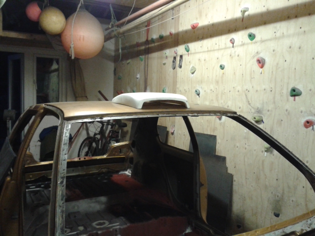

Also test fitted the roof scoop, it's off a Subaru Impreza
Next thing to do is move it to Carl's place again, then start turning it into a car!!
