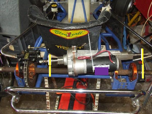

anyway here is a loose plan of action

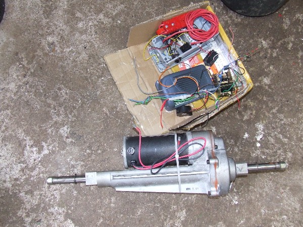

for the drive i have a motor driven trans axle with built in diff
which I'm going to graft onto the existing axle
via 2 sets of chain and sprockets and the original kart axle is going to be cut and joined with a double bearing allowing the axle to turn sharper without skidding the tyres allowing the diff to work Wink

box of electronics to graft on once the mechanical stuff is done

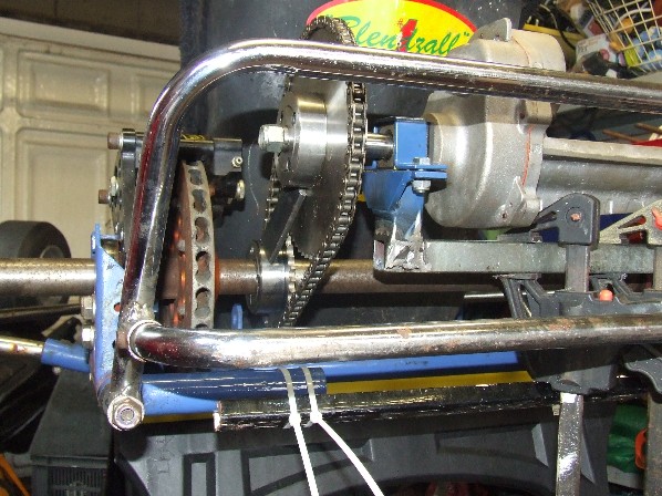

gathering a list of sprockets and chain i need
have sent off for a few quotes
2xqty 06B1-30T 1210 taper sprocket 3/8 pitch
2xqty 06B1-57T 1210 taper sprocket 3/8 pitch
2xqty 1210-30mm taper lock bush keywayed
2xqty 1210-3/4inch taper lock bush keywayed
2mtr 06B1-3/8 simpex chain
2xqty 06B1-3/8 simpex chain con links

power will be from 2 lead acid gell cells to start with so 24v with the first build
started to make up motor mounts
chain and sprocket quotes are in.....
£123.12p delivered or £69 delivered
so have ordered my kit from http://www.engineersmate.com/
So your providing the the "drift taxis" at FCS? Lol

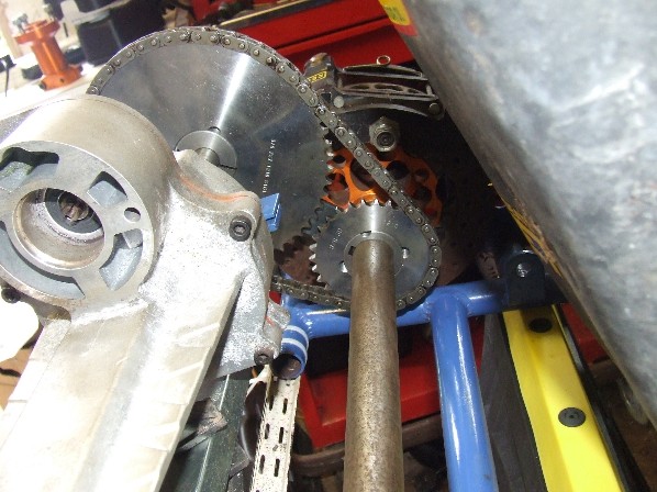

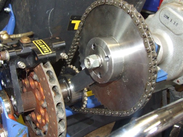

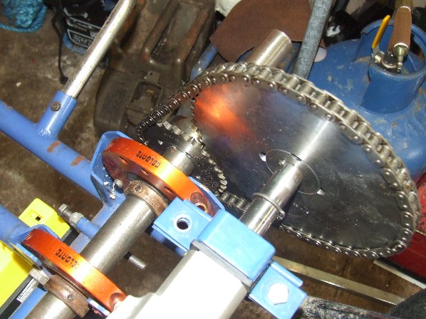

ok so all my sprockets have turned up so have mocked up the drive
but ive run out of metal so need to go back to work to raid the scrap bin
