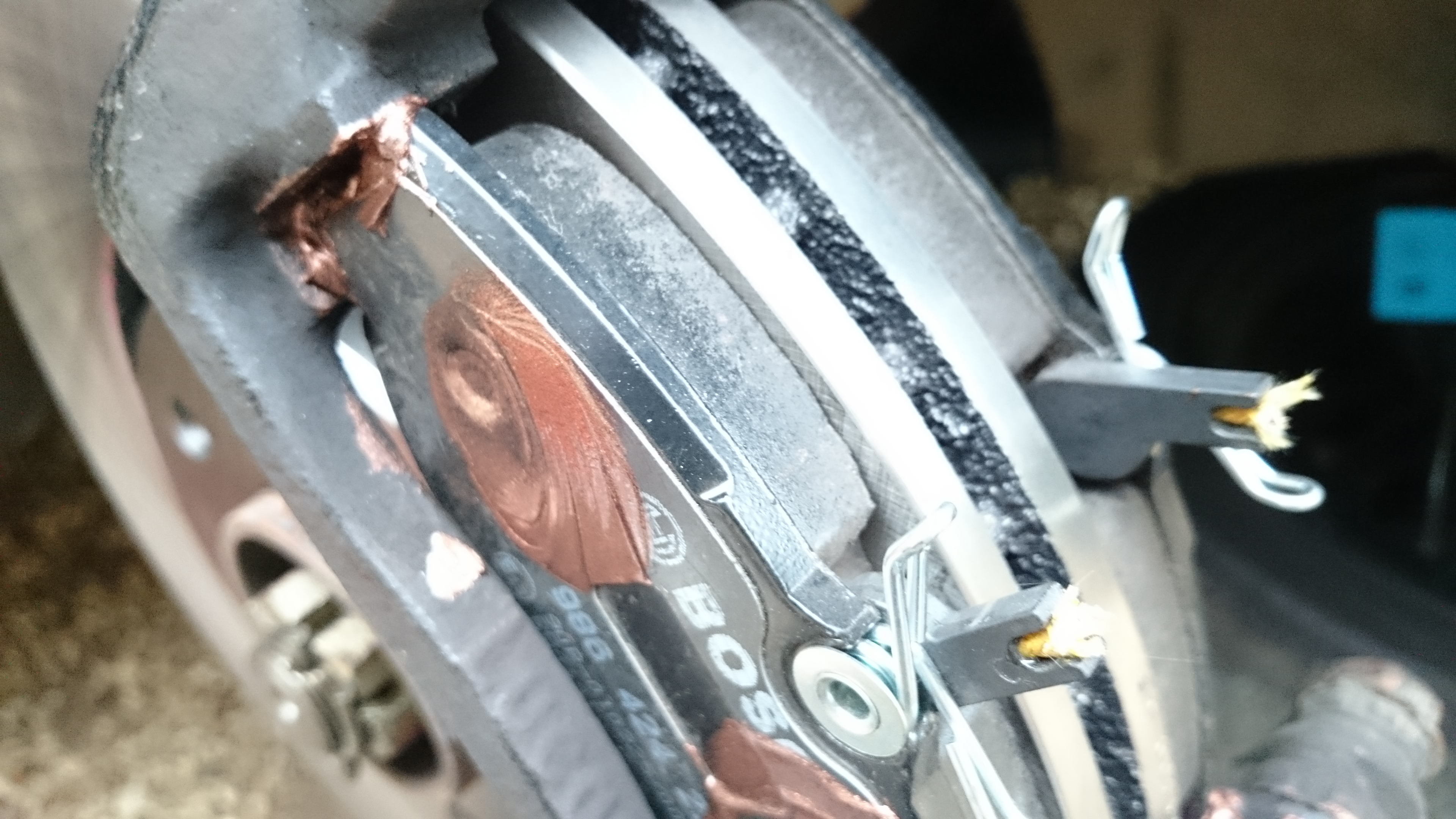

So took my time...got discs off...cleaned all faces (inc the 20mm spacers) and cleaned off all the pad residue on the discs...
Still got bad judder...feel through the pedal.
So...ordered new discs. Doh.

Ordered bosch discs and pads
(26-06-2016, 06:35 PM)Piggy Wrote: Brembo discs.
Had nothing but issues with "Brembo" discs - I don't think Brembo even make the ones that you get from the motorfactors, pretty sure they just bung their name on any shit. Only ones I've had success with from the motorfactors is Pagid and Bosch.

New bosch discs/pads on the front.
Annoying standard pads dont cover the full depth of disc.
Think its the clio 182 pads that cover them fully like I have with the ferrodo ds2500?!
