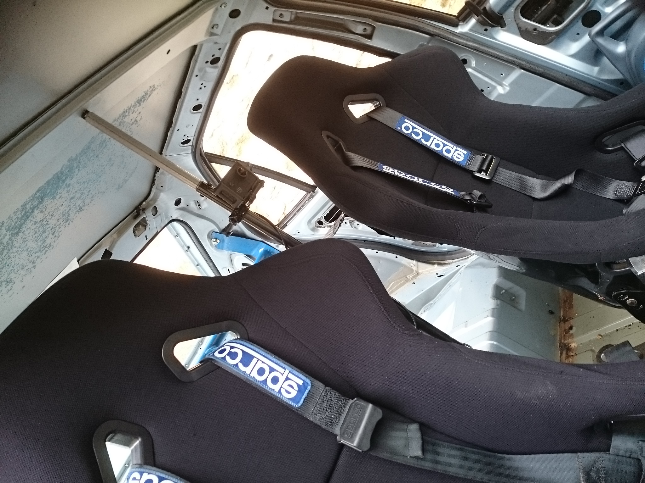

Finished camera mounts...tried a few out this evening on a good run to Cirencester... Cant get oil up to thermostat opening temp though despite trying hard!
Also added rubber pad for less heel slip...esp as forecast looks like rain Undecided

How many SJ's have you got? Three?
(02-06-2016, 08:18 AM)JJ0063 Wrote: How many SJ's have you got? Three?
I've got two. Third coming as one was bit crap sound...so they sending another.
However the plan is to have one internally all the time., plugged in, so wont die...
Then the second I'll move about during the session to get different angles
