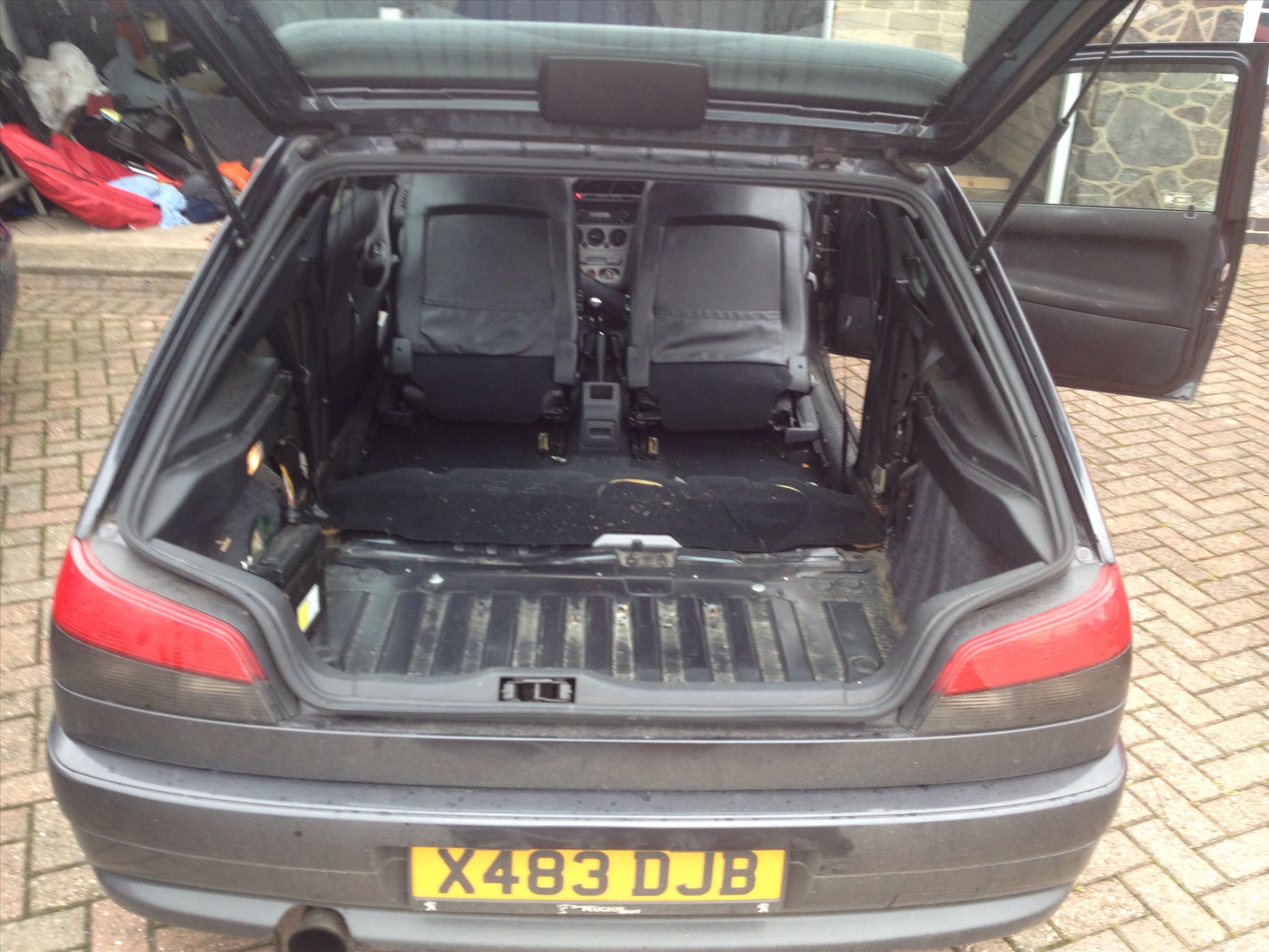

Right-o, update
Stripped out;
Cage;
Needed painting, so decided to change the colour;
And in the back!
ooo nice Smile
This is the car that made me want to buy the astor gret Xs today Big Grin fine looking motor there mate!
Absolute win! Nice one buddy
That is gawjus!!
Bloody hell mate you didnt hang about lol, looks nice in that colour

Cage looks great btw! I always thought candy purple went well with astor. Just a shame Scott never manned up and painted the wheels this colour Tongue
It's not candy purple Wink
meh. Looks it. lol
(03-11-2013, 01:11 PM)Niall Wrote: meh. Looks it. lol
Tried a matte puple from halfords. Artfx or something like that. Covers pretty easily

Cage look awesome that colour!
