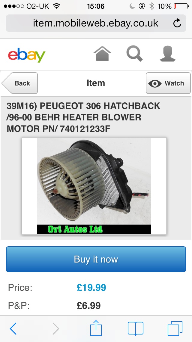

How do i go about getting one of them lol!
Like this or does it have to be for a gti 6 haha
Attached Files Thumbnail(s)
I tihnk they differ on being AC or non AC
PS find ya charger...qwik!
Im on 3% not to worry Wink haha! Um its ph1 no air con! But its the 96 model? How confusing! Lol
non a/c fan should be fine then
Ideal thanks! Now just to find someone to do it for me haha
is dead easy. one plug and three screws
the position to do it in is fun!!
Oh god! Il give it a go then lol!!
