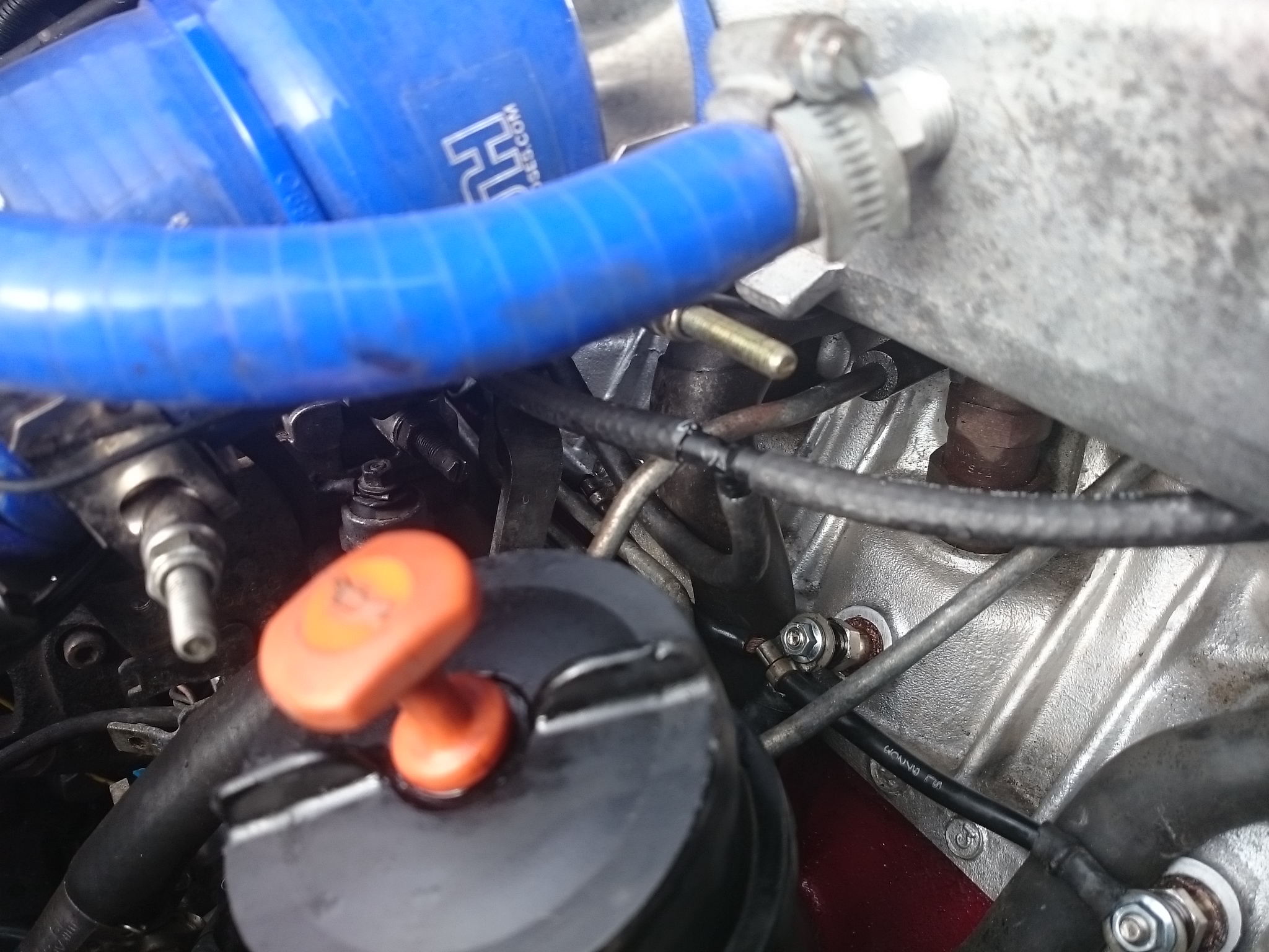

(18-04-2016, 06:51 PM)Piggy Wrote: How or why I don't know but bash reminded me of something i have always wanted to do coz the bungs always leak...run it back and T it into the return.
Like on the 1.9? Will it still get enough fuel to the injectors? If there is something to go back to the return, where does it go now when it is blocked?
1.9 same system. That is the leak off, not the supply.

Also when I re-do leak offs I always tee the last one back into the return anyway.
It's p/n 1564 94, it's still available and costs £8.72 inc VAT for a meter from Pug.
So fixed the fuel issue...tbh duno why I never did this in first place, always thought it be a neater idea.
The t piece is brass with plastic shrowd to give strength.

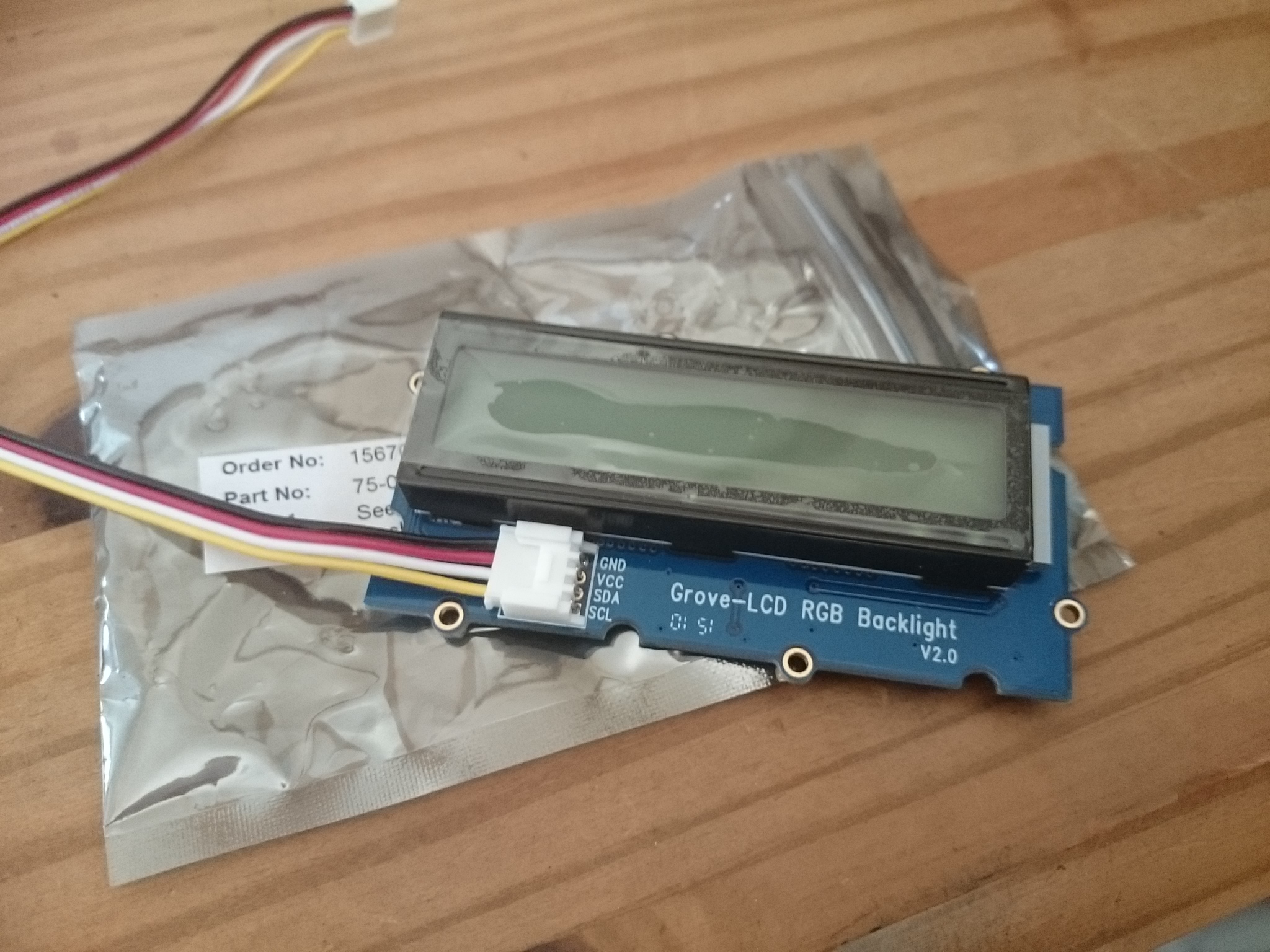

Just need to wire this in next...
 i2c rgb lcd display that will fit in same old slot in center dash but work with the new software...been running a empty hole for ages (!)
