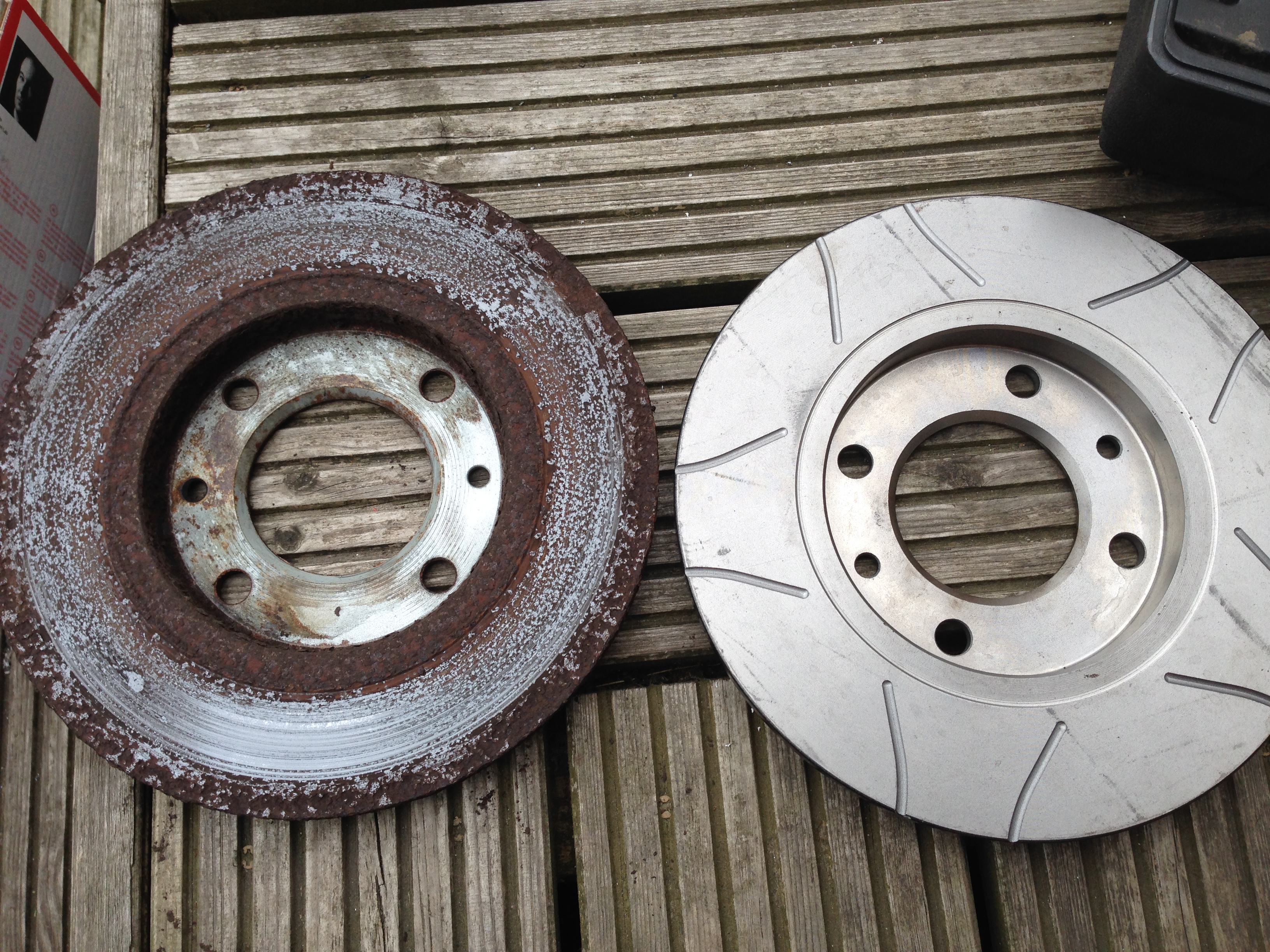

The rear now has a 40mm drop which sits nicely with the 30mm on the front.
Fitted the rear with some Brembo max disks and pads
Passed its MOT without any problems - phew!!

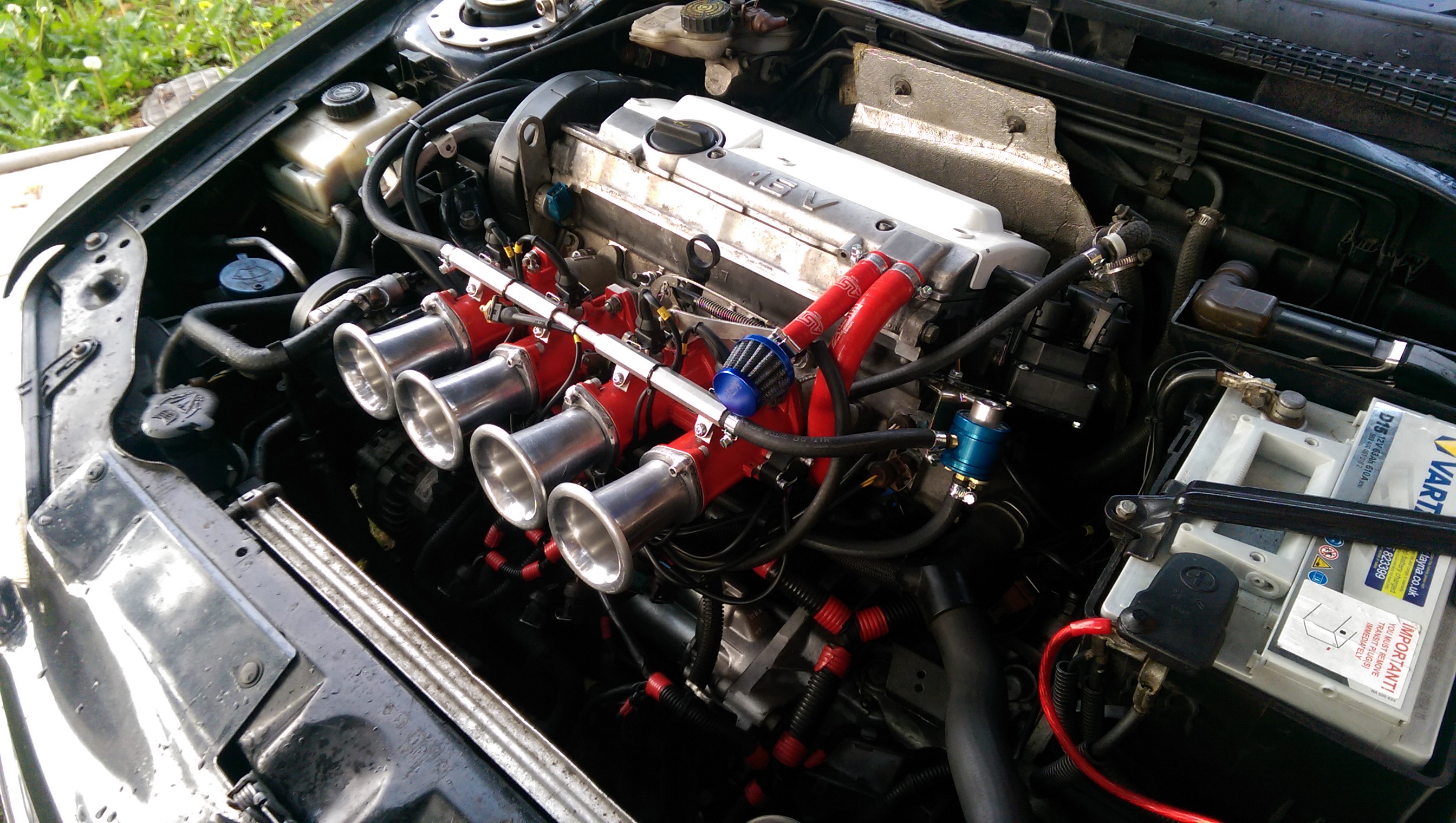

On impulse, managed to buy a set of 45 Jenveys with 90mm trumpets.

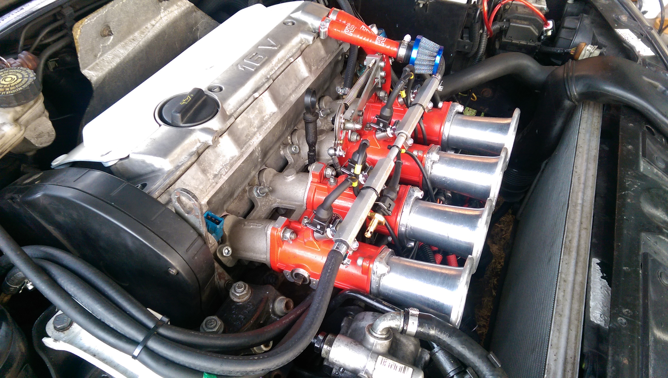

Small update:
Jenvey's on
OMEX and loom installed
Mapped
Sorry about the shakiness of the video, new phone!

I have two questions. Firstly what are you planning to do with the oil breather? I had mine like that on my 1.8 with bodies and it leaked oil everywhere after some time so definitely get a can fitted. Secondly what is the vac line setup? Ive gone straight from the vac pump to the brake vacuum lines with nothing to the manifold. Yours look likes it goes back to the bodies so i presume you have a double or single take off?
Thanks for the replies fellas!
Will try a couple slimlines with the current rad, if still not better new one.
2x 10" fans should be ok?
and any links for good prices?
Re the oil filter, I have a little catch tank which will be going back on with the filter on the end -->>
[Image: attachment.php?aid=27477]
and yes, it goes back into the manifold for a single take off:
THe little catch can looks like a good idea. I saw you had that previously but would have thought you have had fitted it straight away. Ive got a catch can ive never fitted and stored for years so im just going to use that especially as ive bought all the bits to pipe it up now. Did you drill the bodies to fit the pipe or was it already there? On my 1.8 there is no vac pump so to get any vac at all i had to drill the bodies but ive blocked the hole up now the 6 has a vac pump.
Glad the Jenveys are being used mate, looks and sounds awesome.
Didnt hang about with that did you!!
When you get some slim line fans, dont get cheap ebay copies. Get some Spal's. Yeah they are a lot more expensive but on my 6, when i had the ebay copies in traffic the temps would just climb and climb. I replaced them for same size Spal's (exactly the same design) and the temp would sit perfect no matter what the conditions. Made a huge difference! Plus they were virtually silent which is nice
(12-05-2016, 08:29 PM)Eeyore Wrote: THe little catch can looks like a good idea. I saw you had that previously but would have thought you have had fitted it straight away. Ive got a catch can ive never fitted and stored for years so im just going to use that especially as ive bought all the bits to pipe it up now. Did you drill the bodies to fit the pipe or was it already there? On my 1.8 there is no vac pump so to get any vac at all i had to drill the bodies but ive blocked the hole up now the 6 has a vac pump.
I haven't driven the car much as need to fit the filter - Sound like it wants to eat small children and animals :p
Will probably fit the catch can once I've moved the battery.
Was tapped into the longman manifold and not the bodies. Should really have another into the 3rd manifold joint, a job for a later date.
