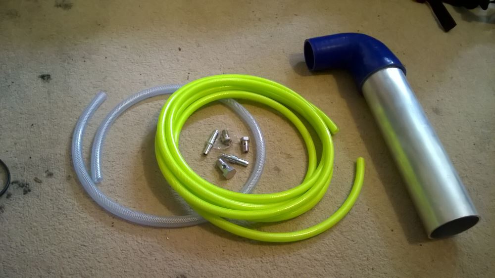

More has turned up in the post now, got some banjo bolts for the turbo and the fuel pump and some line adapters as well as awesome colored fuel line and the bit of ally that is gonna become my inlet plenum. Still trying to rain though sadly.

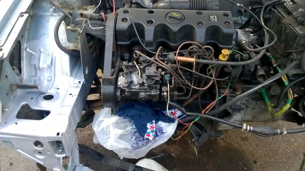

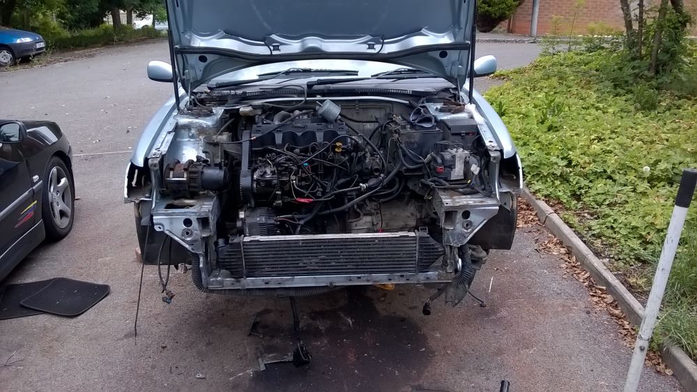

Done a little more this afternoon, drive shafts are in, chassis is modified for the FMIC which now comfortably fits, PAS pump bracket modified and almost fitted (need the drill to recharge), swapped the earth wiring over to something more substantial and have been playing with water pipes trying to get those sorted.
Small issue that i hooked up the glow plug relay to the live ans half hour later the wiring caught fire with a bit of a woosh as I was under the car with the hammer. I think the positive terminal of the relay dropped onto an injector pipe and earthed the feed wire. Fortunately I got to it and put it out sharpish. I have turned the ignition on and there's no funny lights, only issue there is the temp sits well off the top of the gauge so I guess that's either getting 12v when it shouldn't or earth when it shouldn't

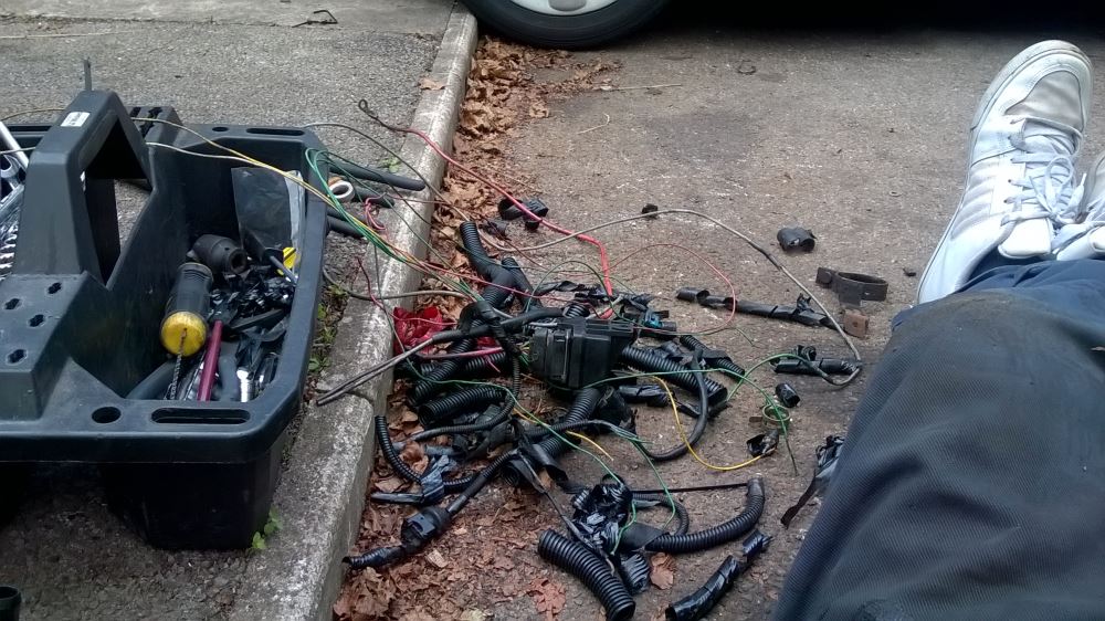

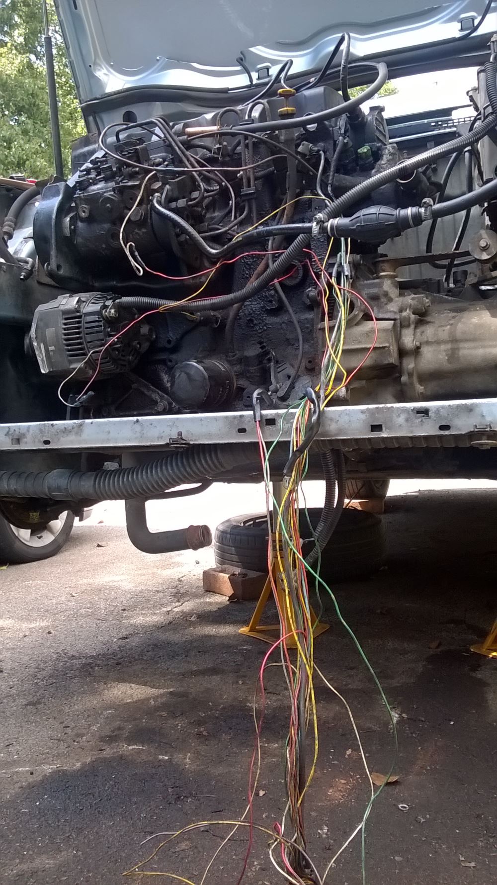

Had another afternoon working on it after going out this morning then spending far too long doing a slow cooked bacon snadwich for lunch. Decided to strip all the stuff that isn't used out of the loom
That turned out to be quite a bit of wiring that I'm not using. There's more to go back in like a glow plug relay and fan wiring which I want done separately plus all the gauges but that'll do for now.

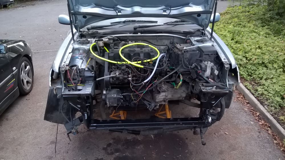

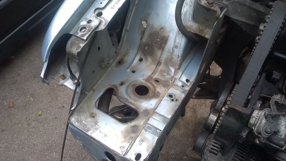

After finishing drilling holes for the PAS pump I cleaned up all of the surface rust.
I then slapped some hammerite about and bolted the power steering pump in after bending the pipe straight with a blow torch. Worked out where the resovior is going too, up by the brake master cylinder to give it enough height that I won't get an air lock. Checked that the pump worked after trimming out the wiring and it does. Gave the lucas pump a tune (hence the carrier bag over the alternator and rag), cap unscrewed nice and easy and couldn't believe my luck when the allen key hole was right there in front of me. Gave it about 15 degrees.
I ran my shiny fuel lines under the car, 10mm feed and standard size return in the lovely high vis stuff with about a hundred cable ties to keep it all up.
And here she is as she stands tonight. Had the rad on and looked at hoses some more and have a plan of action for those. Also think If I trim a little more off the intercooler I might be able to bolt it straight to the slam panel
