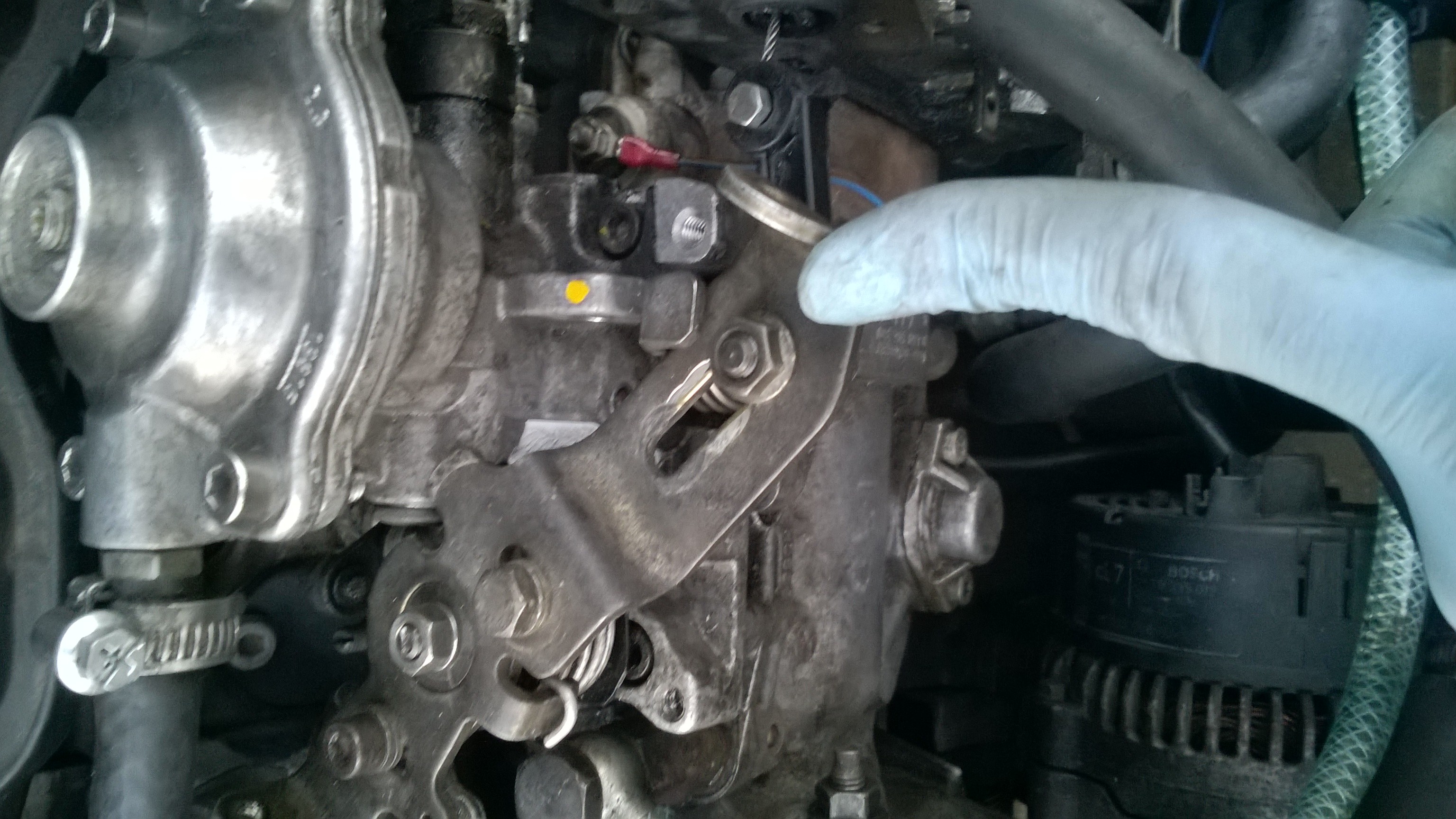

So the tune has gone downhill Sad still cant get enough fuel in to start with. Throttle doesn't feel like I've got enough travel on. (may grind the bit on pump) also my boost has now settled on 1.4 bar again. Probably because I don't have a mbc. One is on order should be here tomorrow. So ill plumb that in and take a look at the pump again tonight hopefully. Smile

Anyway. Trying to sort my fueling issues and adjust the pump. Manages to get some more throttle travel and knocked the bit on the pump off while I was at it. Still cant get it to go any further though. Add pics in a sec.
Where it is and where I want it to be.

2.pump bot delivering enough fuel (finally knocked the bit off the pump to allow extra travel and adjusted to suit along with knocking the lda down to gain some more fueling down low.
