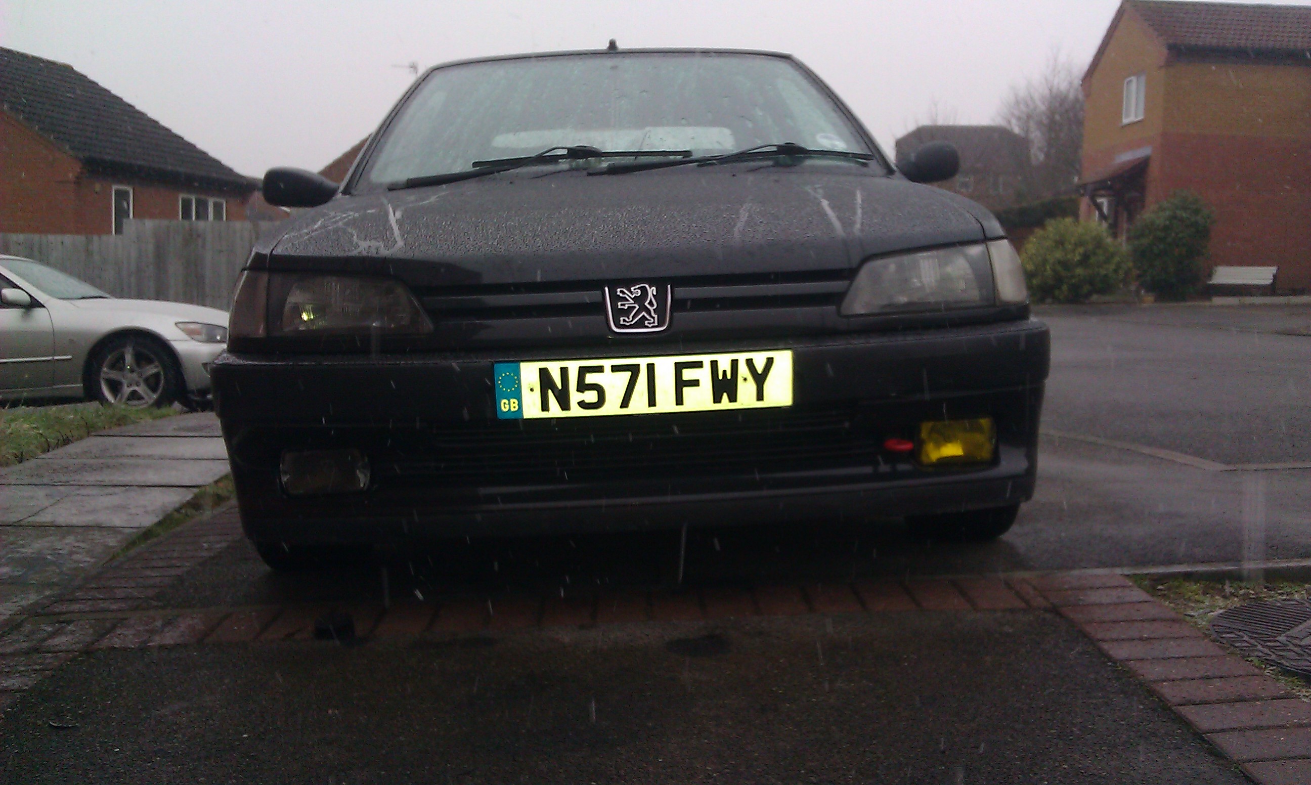

I had my number plate on the side, I think its only the phase 2 bumpers that can pull it off

following on from your rear light conversion, when you enlarge the passenger side hole to fit the numberplate light plug, make sure you give it a quick spray with some primer then top coat so that it doesn't rust where you've cut the hole out.
oh and your plates look so much better in the middle again, the only way you can pull of a side mounted numberplate is if you get a square one and a wacking great intercooler poking out the frontm but thats my idea Wink

haha maybe Tongue, cheers i wouldnt of minded black but white isnt as common plus it looks nice.. mine too Smile wish it was mettalic though
(03-02-2013, 09:14 AM)ozonehostile Wrote: following on from your rear light conversion, when you enlarge the passenger side hole to fit the numberplate light plug, make sure you give it a quick spray with some primer then top coat so that it doesn't rust where you've cut the hole out.
oh yeah thanks for that,
haha it looks so good i might accidentally cut a hole in the bumper then run over an intercooler hoping to fill the gap in XD

Looks much better with the number plate back where it should be ThumbsUp

Looks much smarter with the plate in the middle mate.
Yellow fog light lenses would look good...

Cheers, funny you should say that i have some yellow tint film coming off ebay

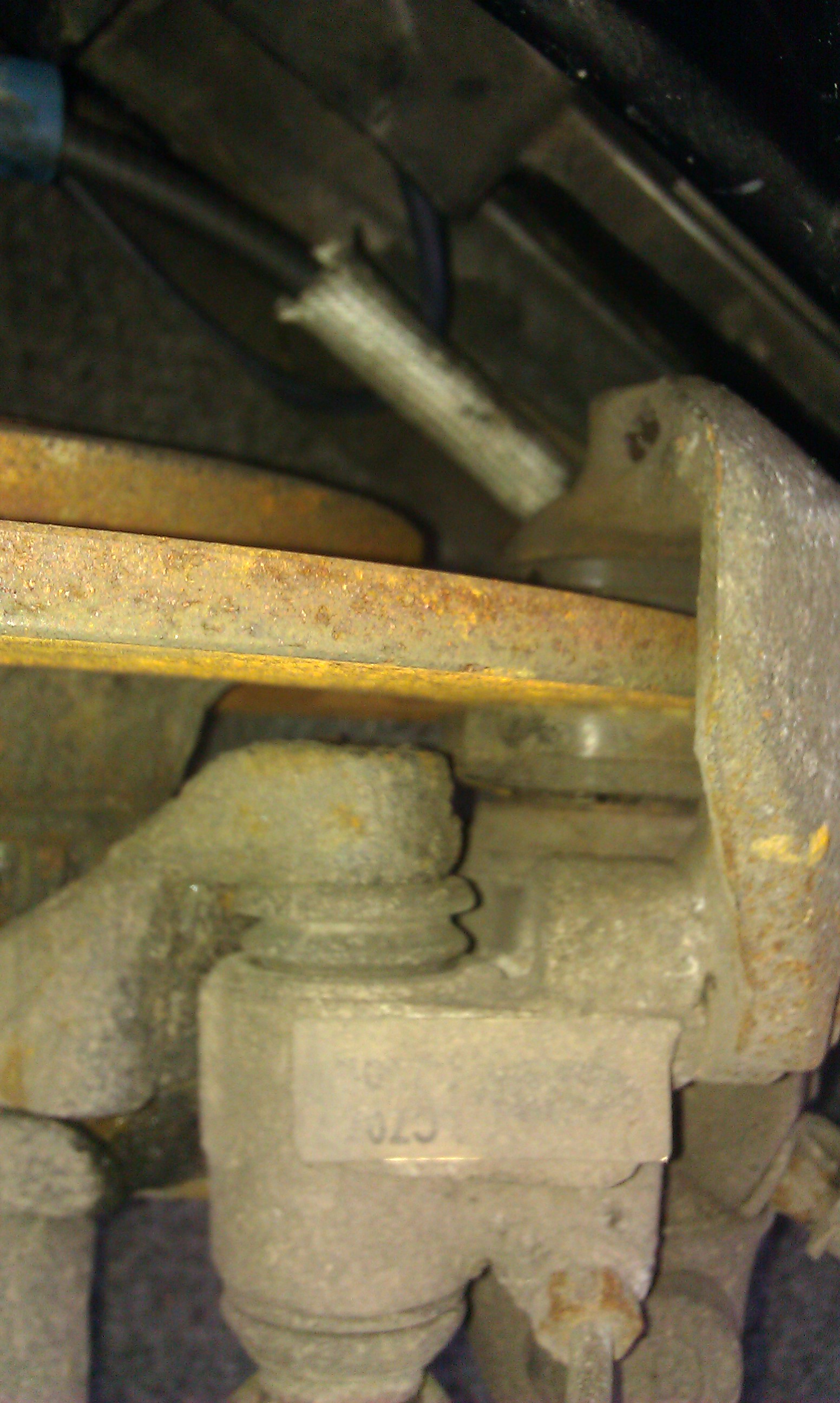

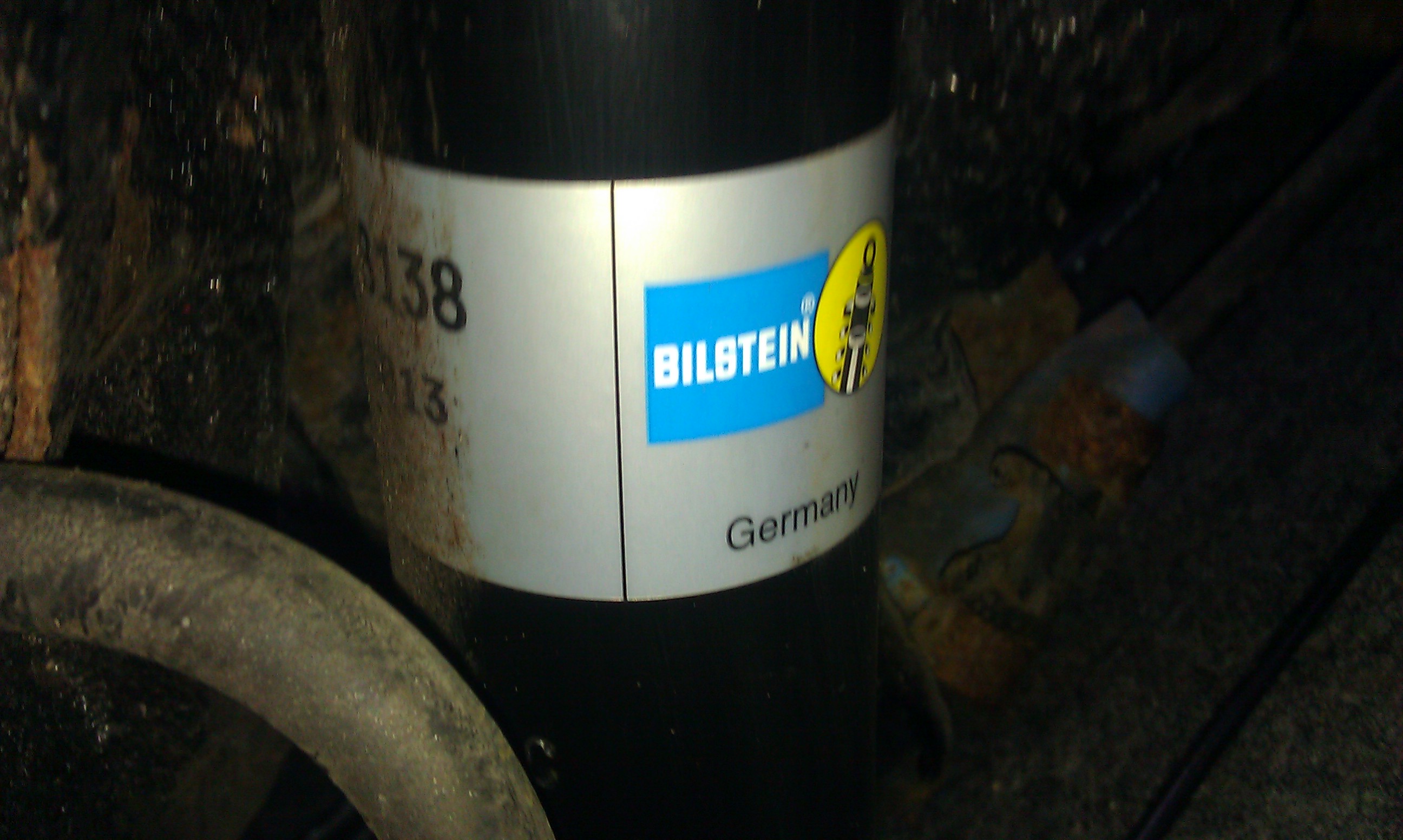

UPDATE: i finally got my beam today, drove 33miles to get it specs:
306 rallye beam covered 60K
Lowered about 40mm on bilstein shocks ( look brand new) not sure on model.
brakes are in good condition, surface rust but all in good condition also came with handbrake cable.
paid £140 for the lot which i think is a good deal, not sure how much the bilsteins are worth but what ever.
when fitting the beam is there anything i need to know or do? isit just the 6 bolts etc? any help appreciated
#43
It looks like a good condtion beam. I would say £140 aint to bad price for it.
When changing the beam it is just 6 nuts to undo from inside the boot. Take the spare wheel and exhaust off as that makes it easier. Also remeber to undo the brake pipes and the hand brake cables
#44
(10-02-2013, 10:40 AM)Frosty Wrote: It looks like a good condtion beam. I would say £140 aint to bad price for it.
Cheers pal, me neither do you know how much the bilsteins are worth?
I'm not fiddling about with the exhaust lol. Yeah thanks, this beam has wheel speed sensors which means it had abs, with this beam fit mine still?
#45
those bilsteins are worth about £80 i think so defiantly a bargain. you can remove all the abs stuff Smile
#46
The beam will be the same.You can either leave the abs bits on or cut the sensors off

#48
The exhaust runs under the beam so you'll have to drop at least the back box but mid pipe helps if it out the way
Brake pipes can be a pain but other than that its pretty simple
#49
A brake pipe spanner and some sort if WD40 will be handy when it comes to the brake pipes
#50
(11-02-2013, 11:26 AM)rocker8742 Wrote: The exhaust runs under the beam so you'll have to drop at least the back box but mid pipe helps if it out the way
oh right, well im taking it to a guy who does beams so itl be ok Smile
(11-02-2013, 01:08 PM)Frosty Wrote: A brake pipe spanner and some sort if WD40 will be handy when it comes to the brake pipes
yeh i noticed they were a little dirty and rusty, wont be too bad though

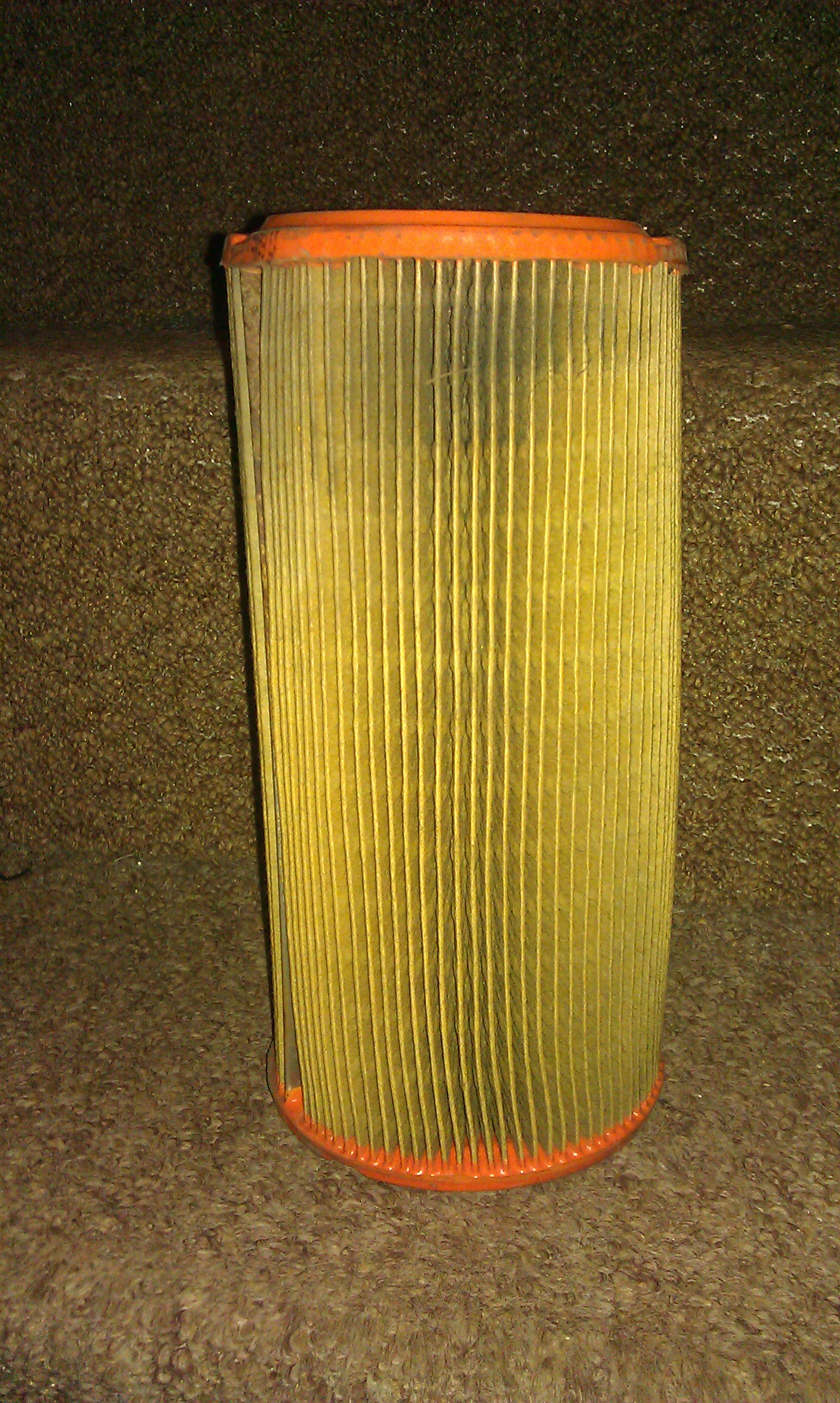

got a few goodies from ebay, the whole list consists of:

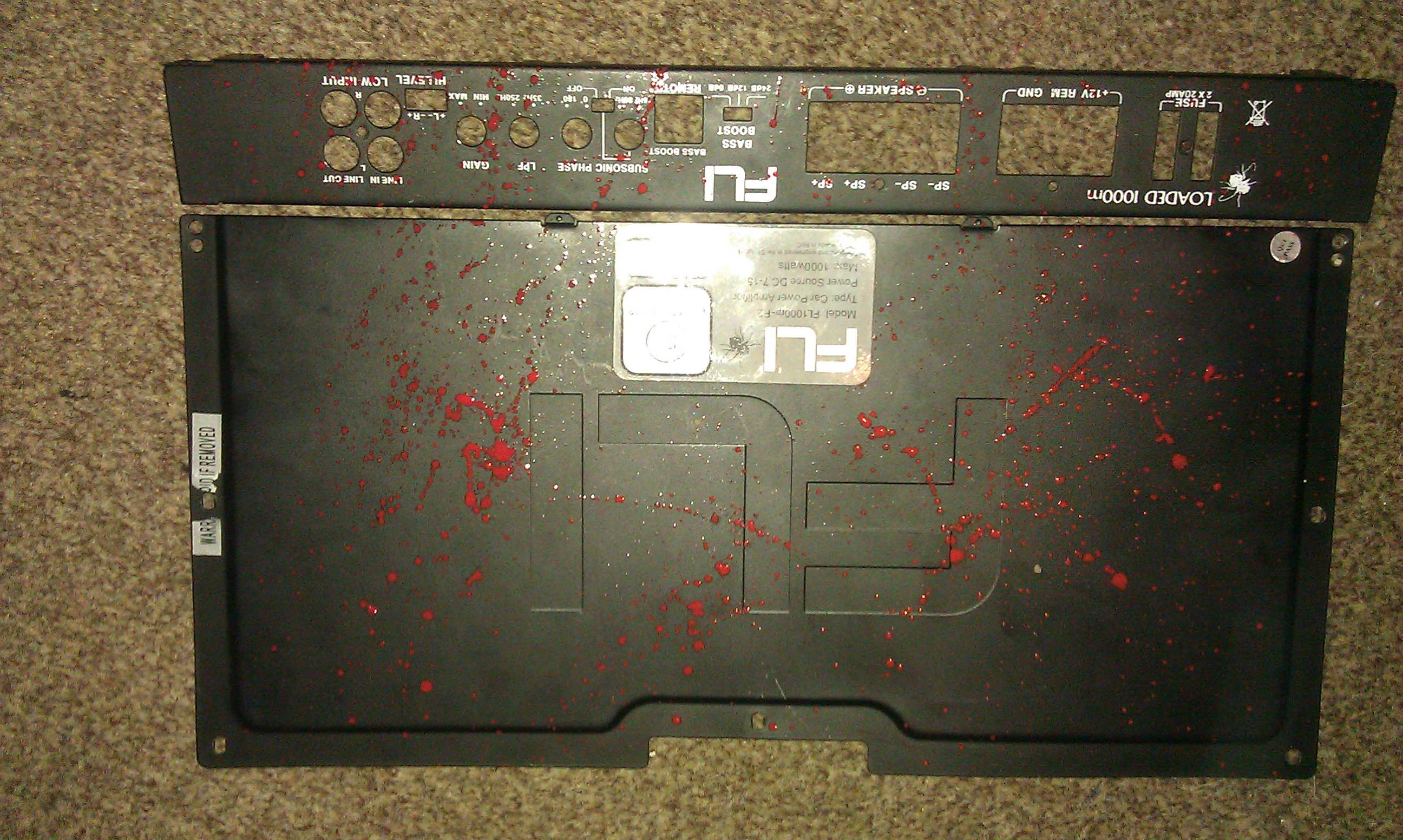

Sticker bomb book 2 - gunna bomb a few bits ive already started doing splats on the amp
Peugeot locking valve caps - beause i have 40" stupid ones that are supposed to light up, i also got them because they lock and have the mighty lion on them
Shortened aeriel - mine has snapped and been gaffer taped on so i bought a shorter one to look a bit more tidy

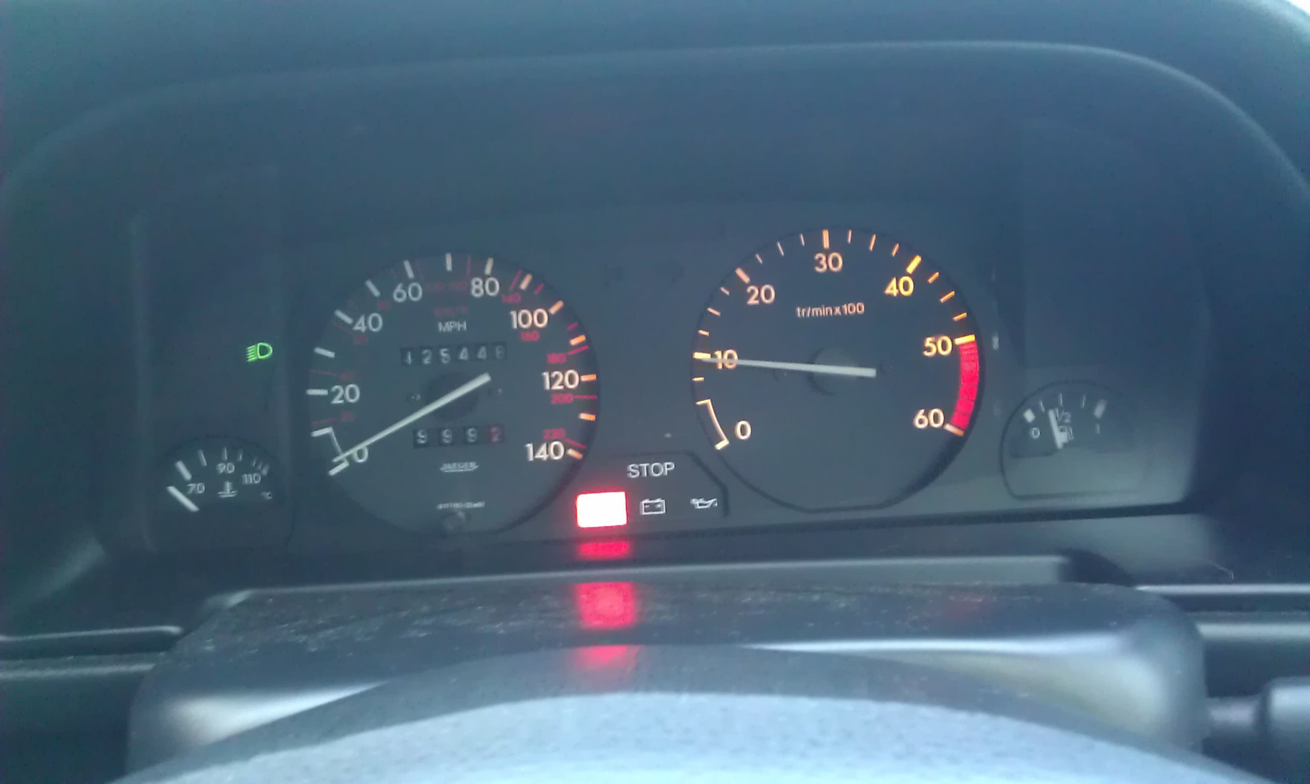

10x red bulbs - the left side of my speedo has gone out so im going to put red bulbs on the speedo and revs
1x green - using green for fuel light
1x blue - using for temperature light

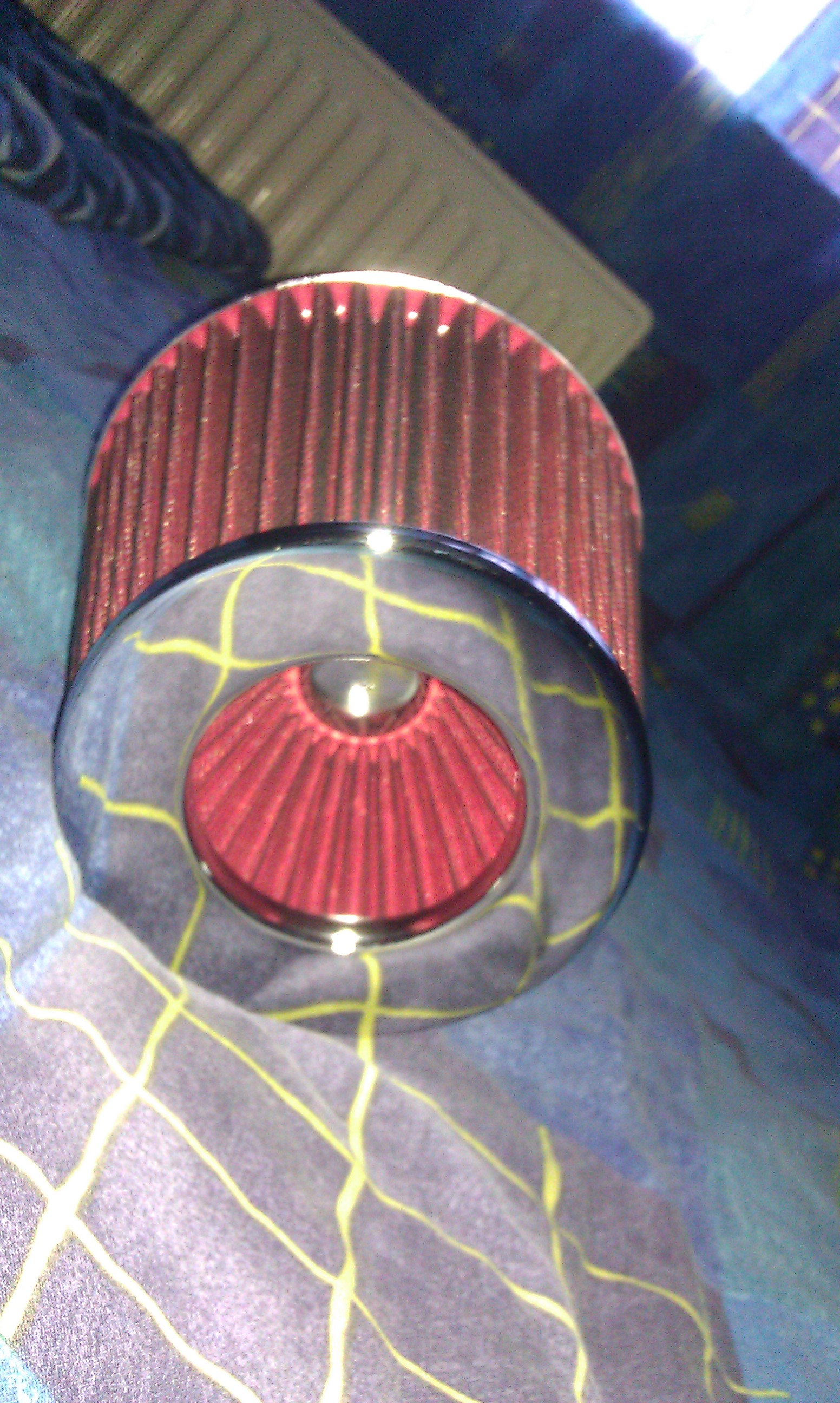

Air filter - give it a bit more aggresive grunt
i put the filter on to make it sound alot better, sharpens up the throttle reponse and gives it cleaner air as the other one was a little dirty

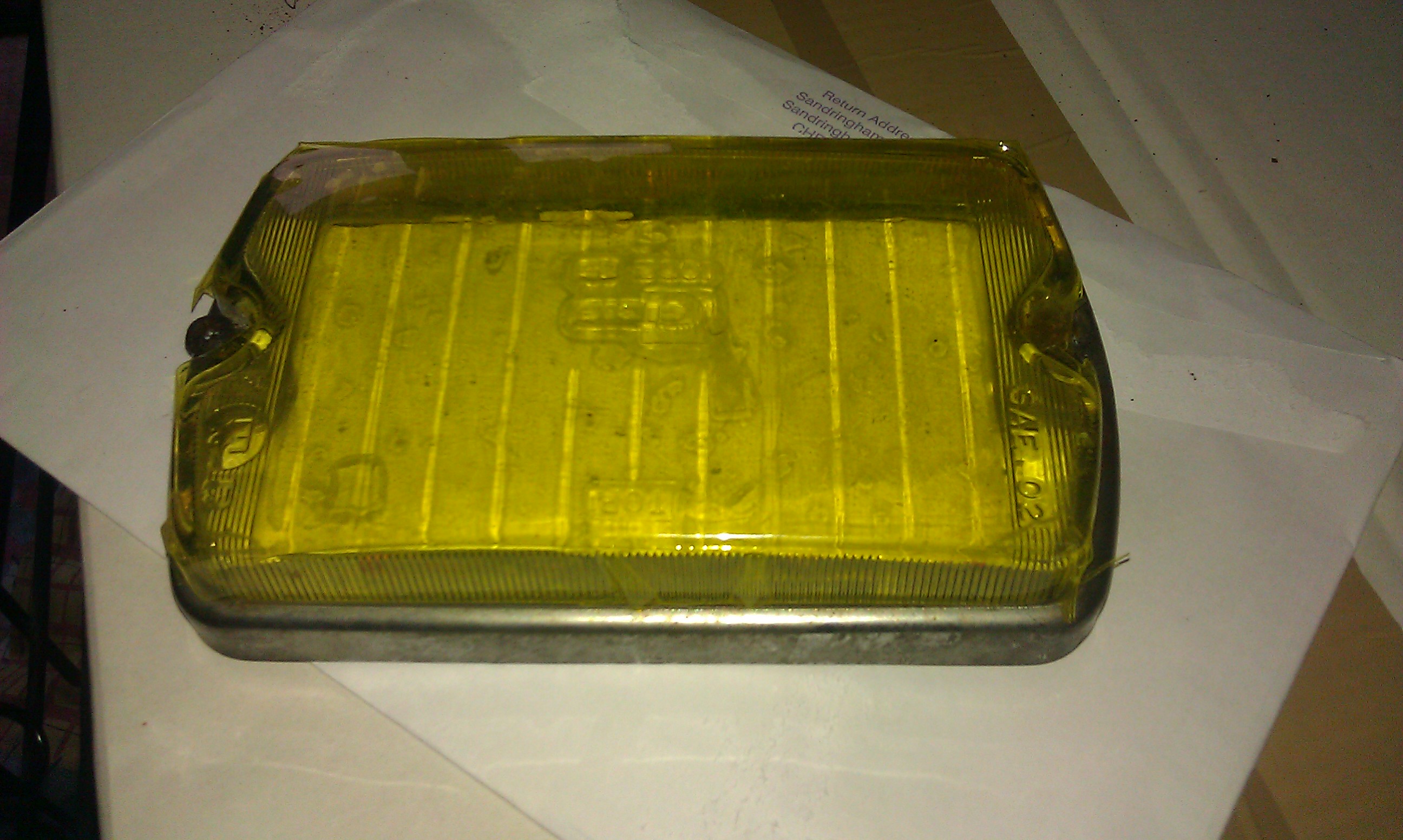

More goodies off ebay today:
My yellow tint film im going to put on the fog lenses

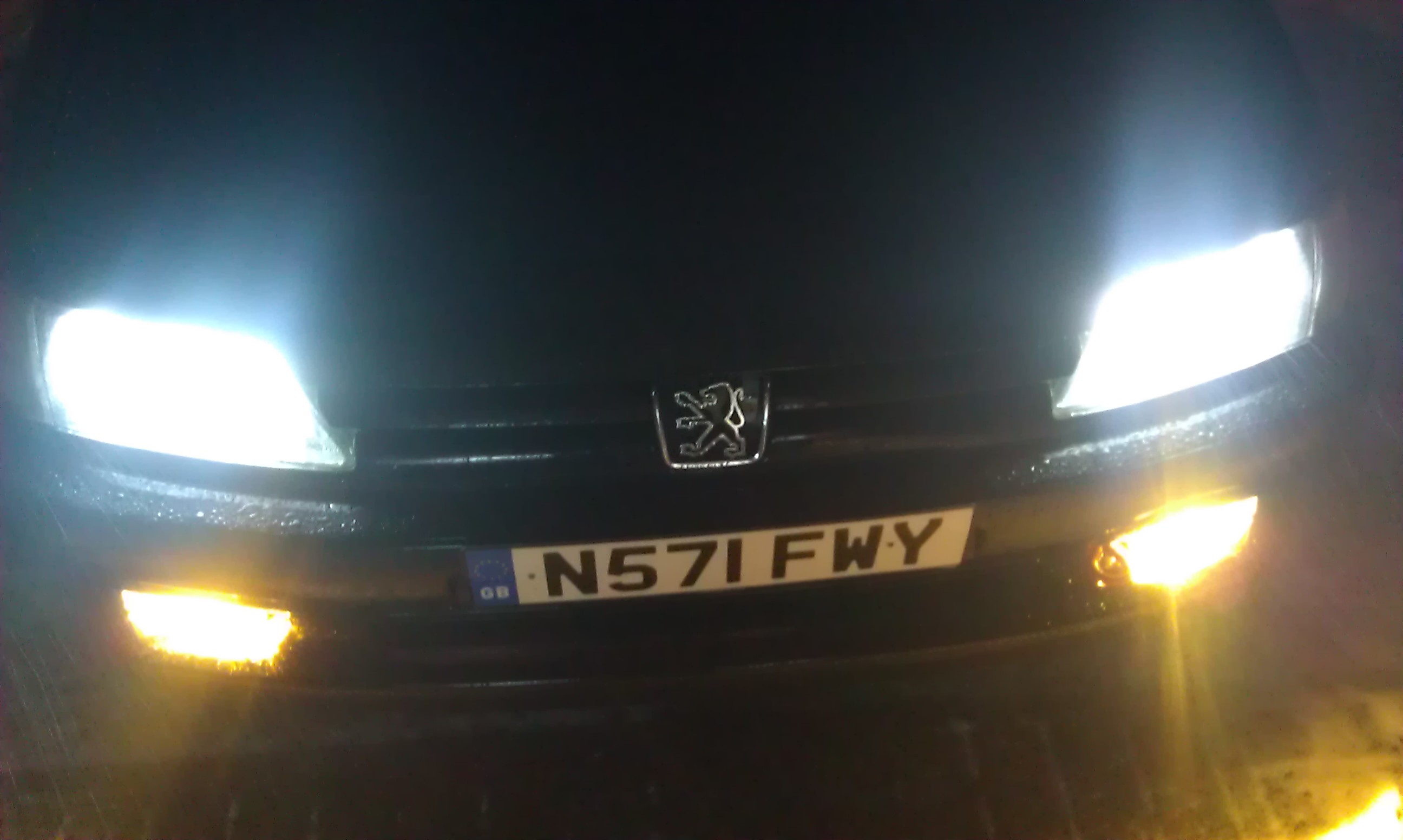

so i got cracking with the fogs, i just cut a size of the film a bit bigger than the fog then laid it on and cut the sides, i also did inside by cutting a rectangle out of the film and place on the inside..
before
after
when the right side was done i started on the left, one screw was really rusty, despite me taking my time i still rounded the bolt, i ended up getting it off with a torx bit. i replaced the screw and put it back on.
(13-02-2013, 01:09 PM)Frosty Wrote: Have fun doing the fog lights! They aren't the easiest things to do!
i didnt find it that hard to be honest. its not the netest job but it looks ok

#54
Looks like a pretty good job. Mine look good from a distance but close up not so great
#55
(13-02-2013, 06:51 PM)Frosty Wrote: Looks like a pretty good job. Mine look good from a distance but close up not so great
Cheers pal, looks like a rally car now haha.i didnt know you had yellow fogs how did you do yours?
#56
I got some on the S16. Got a few spare sets of ph1 fogs so fort me and a mate would give it a go. Sounds like we did it the same way as you. Cut it a little bigger than the lense and fold it over pretty much. I got some yellow glass paint that im ging to try do some with

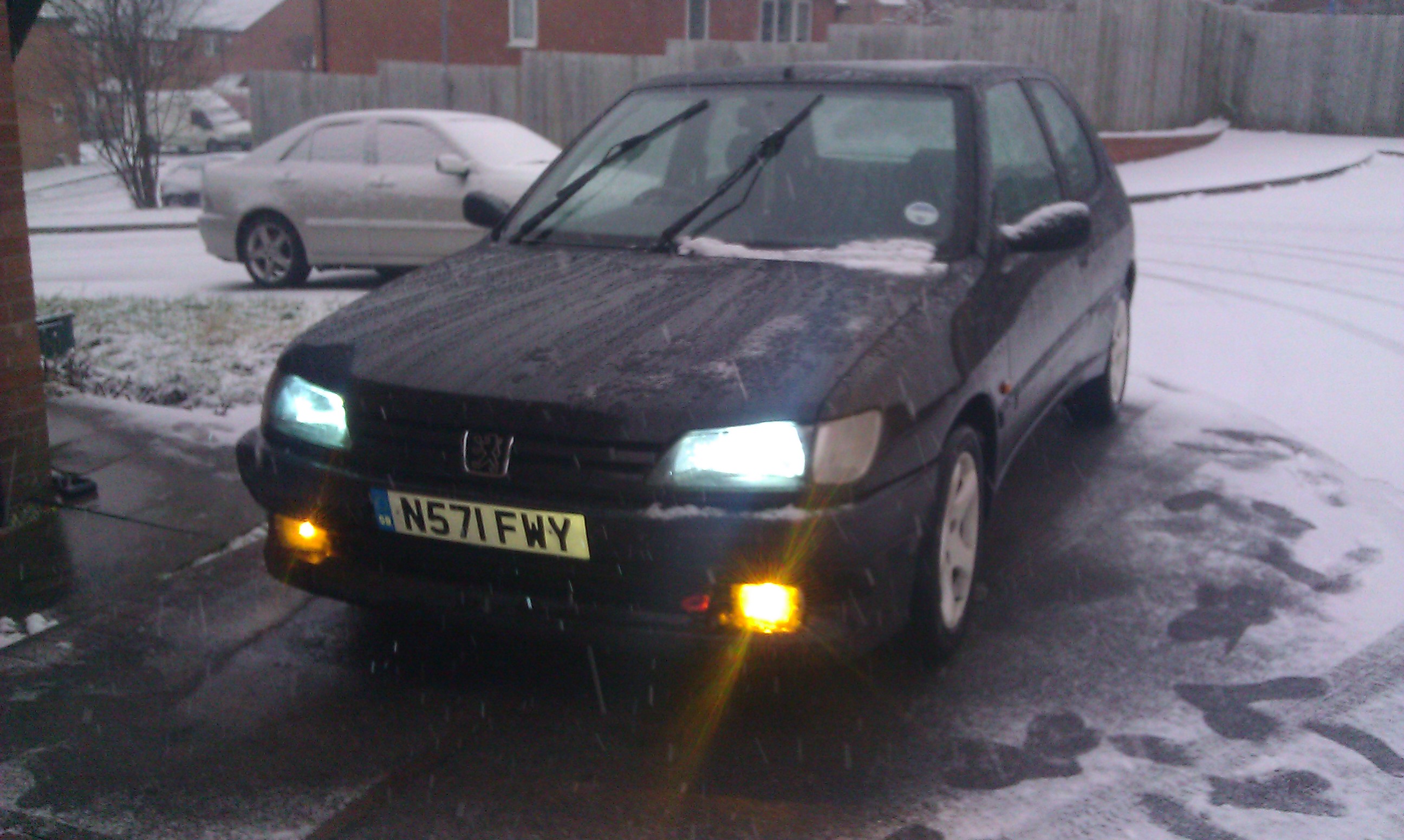

Looking a lot better mate really line yellow fogs on a black ph1
