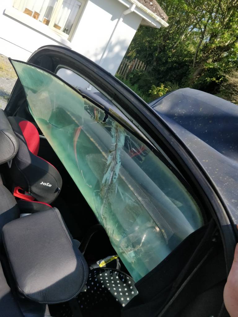

So today being another gorgeous if windy day I decided to make a stab at replacing the rear window.
Window off: about 90 seconds
Cleaning the adhesive tape residue off the roof: about three hours!
Zipping in new window and pressing on new tape: about 30 mins
Came out pretty well, and a damn sight better than the old one!
