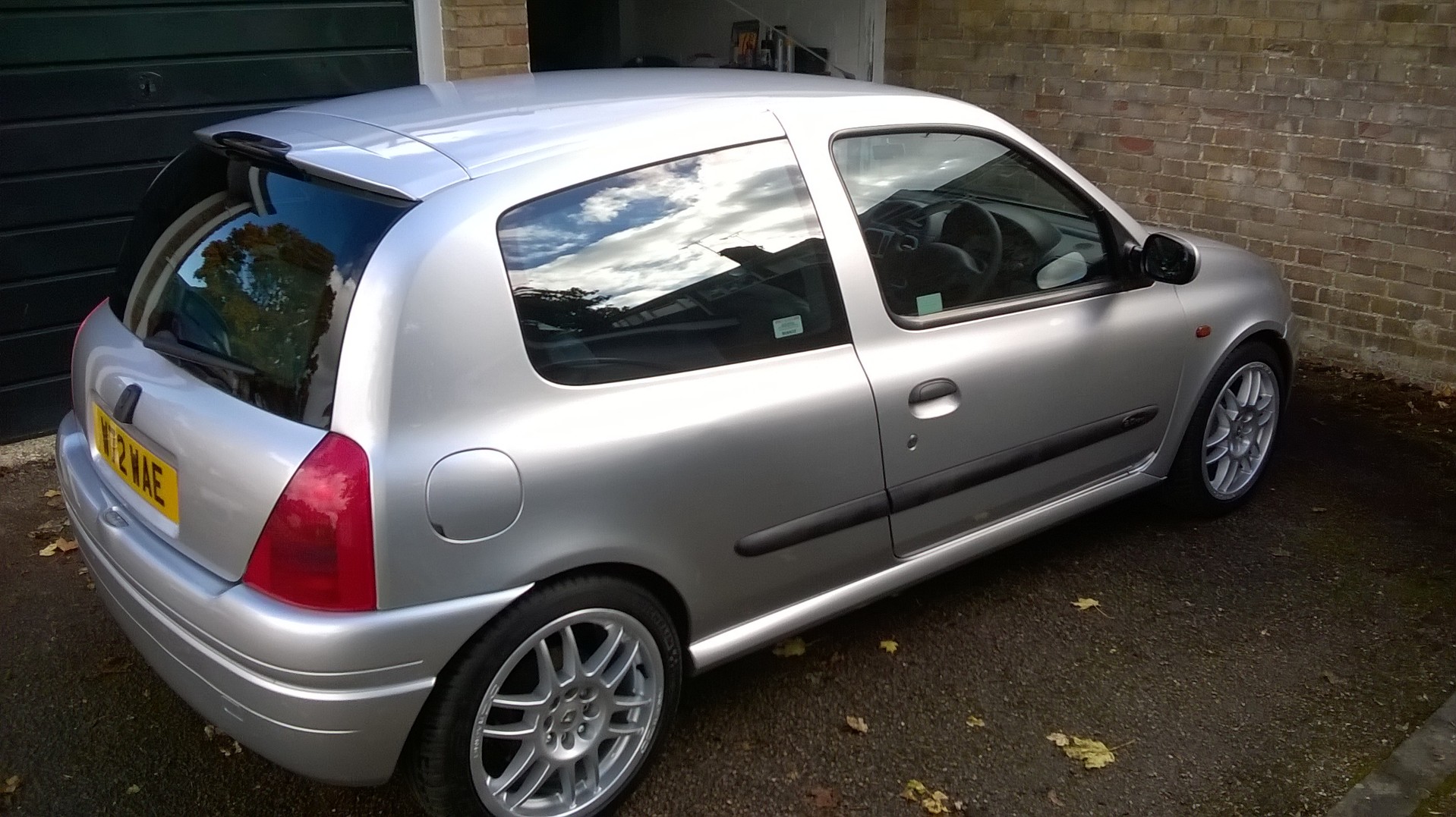

A before shot of the Clio. It was in a bad way when I bought it but I've since spent a lot of time and effort on it and it now spends a lot of time in the garage waiting for Summer.
After giving it some love and attention it has started to look a lot better..

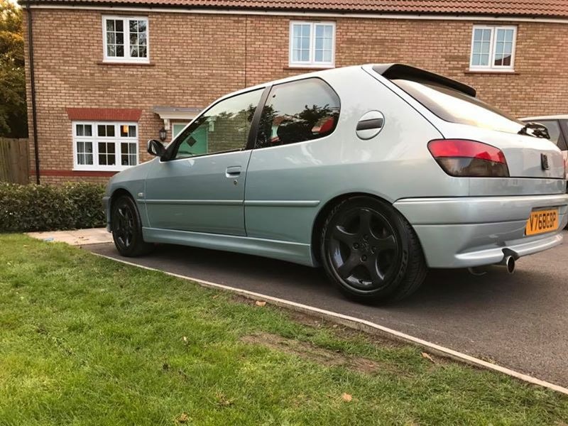

After very little looking around I stumbled across an advert for a Moonstone Blue V reg HDI on facebook marketplace, the car had done some serious miles in its time but had a decent wedge of paperwork (which I didn't look at) and drove well (round the block) and the engine sounded pretty healthy (for a tractor).  But enough of the good points, overall the car was a little untidy to say the least as the pictures will show, despite the bodywork looking surprisingly decent for a car of its years.  I don't know why but something inside me thought sod it, it's worth a punt and everything is fixable with the right attitude plus it has 10 months MOT and a set of cyclones on which I could always sell for parts so I handed over £350 cash without a single further thought.
As I drove the car away the exhaust heatshield gave a happy rattle and when I tried to wind down the windows for a bit of fresh air they didn't work, nor, I realised, did the lights on the heater controls... Itwasntme
The advertisement at least highlighted all of the (major) bad points of the car.  The colour of the door and the wing looked a little mismatched in this picture but on viewing the car it was just the lighting as the owner pointed out.

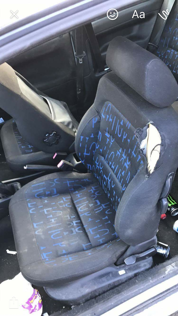

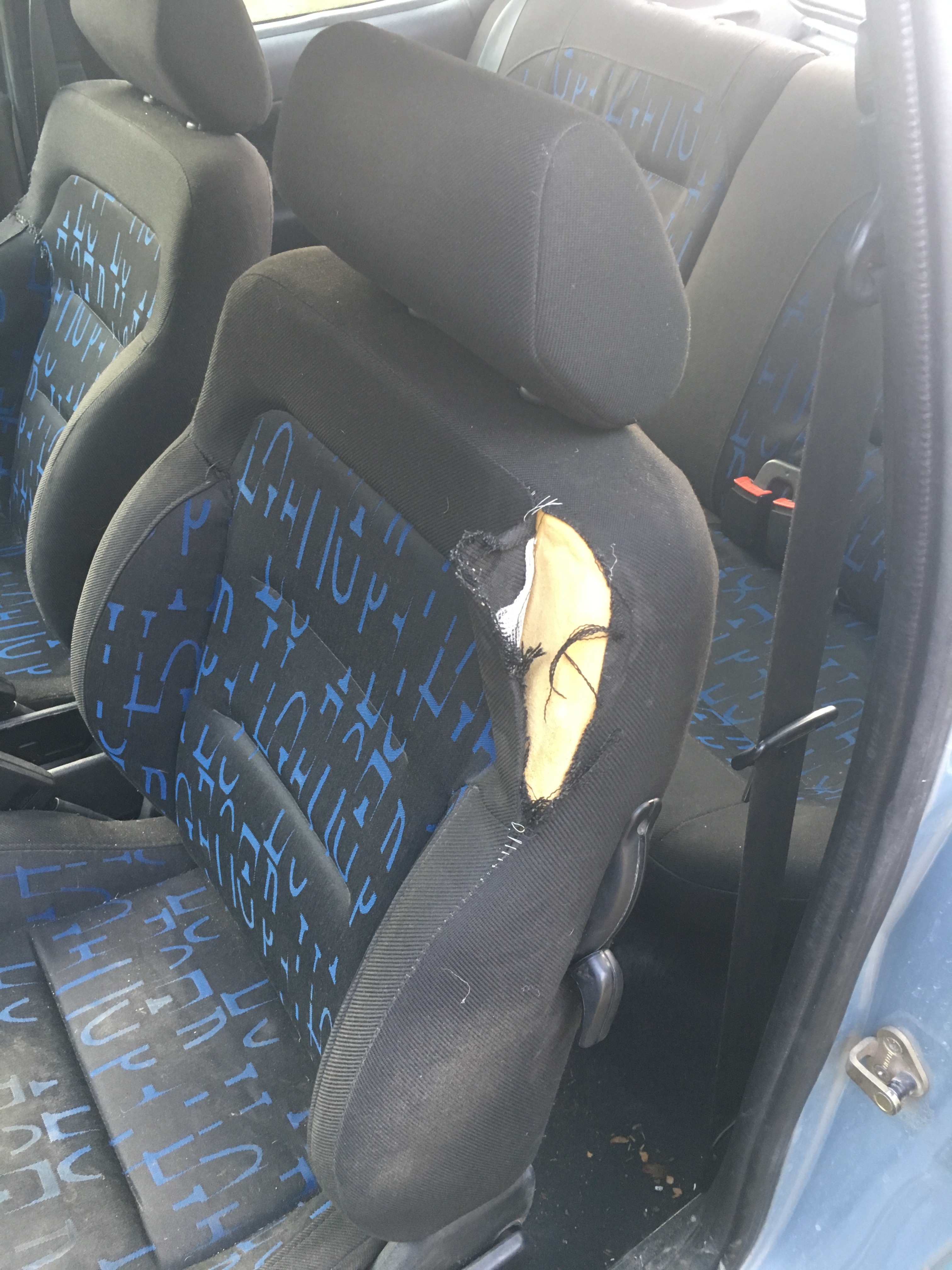

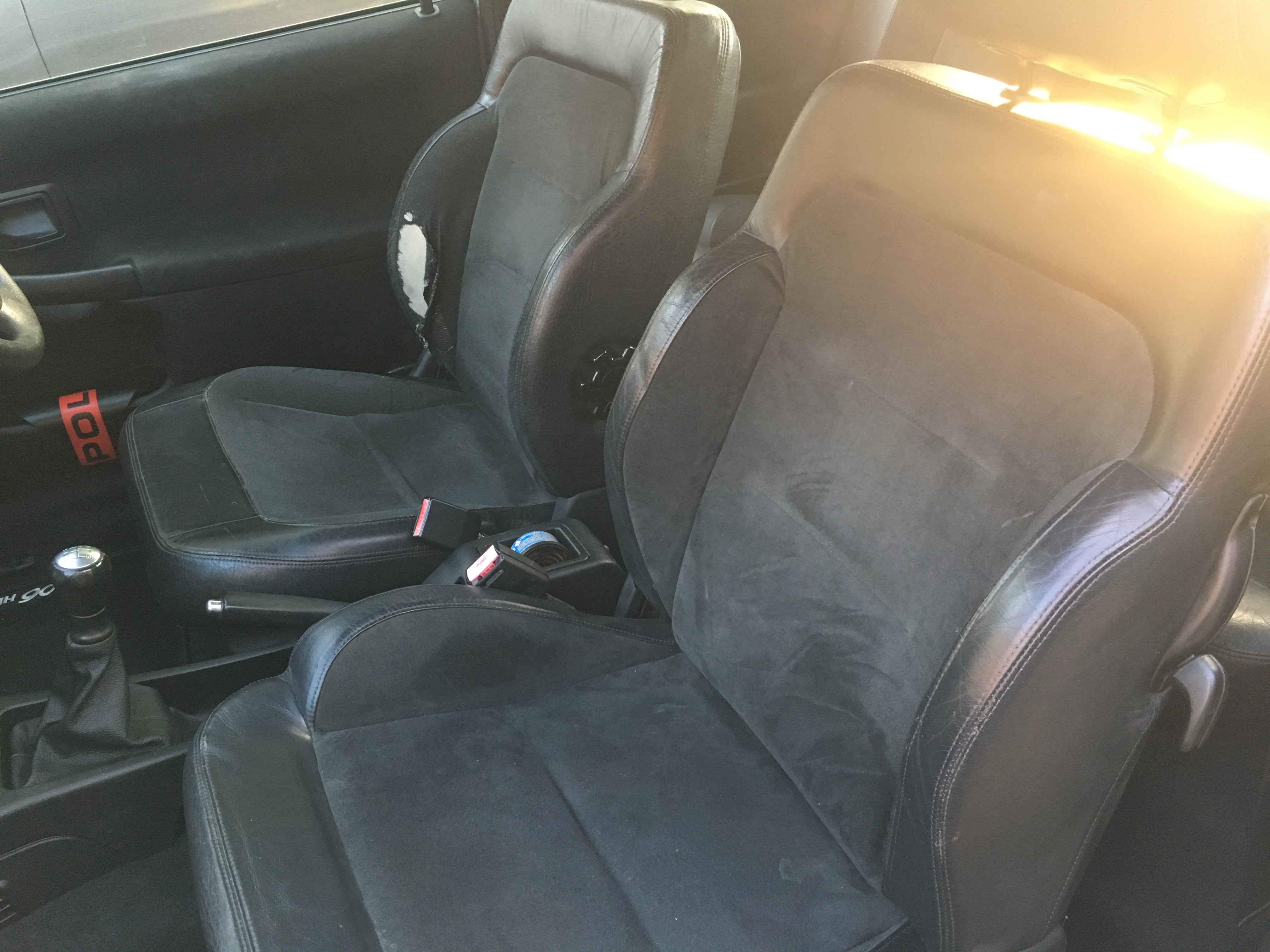

Ripped passenger seat, with the driver's side having been stitched up.

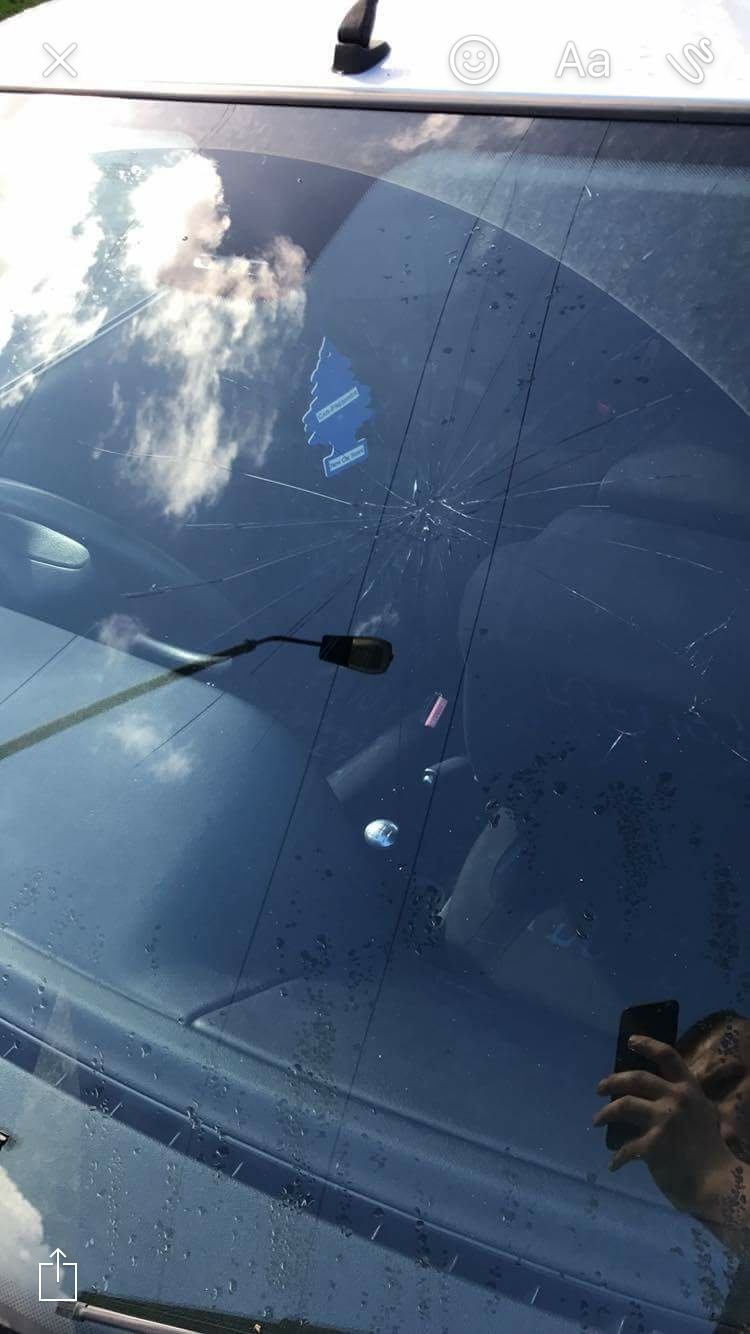

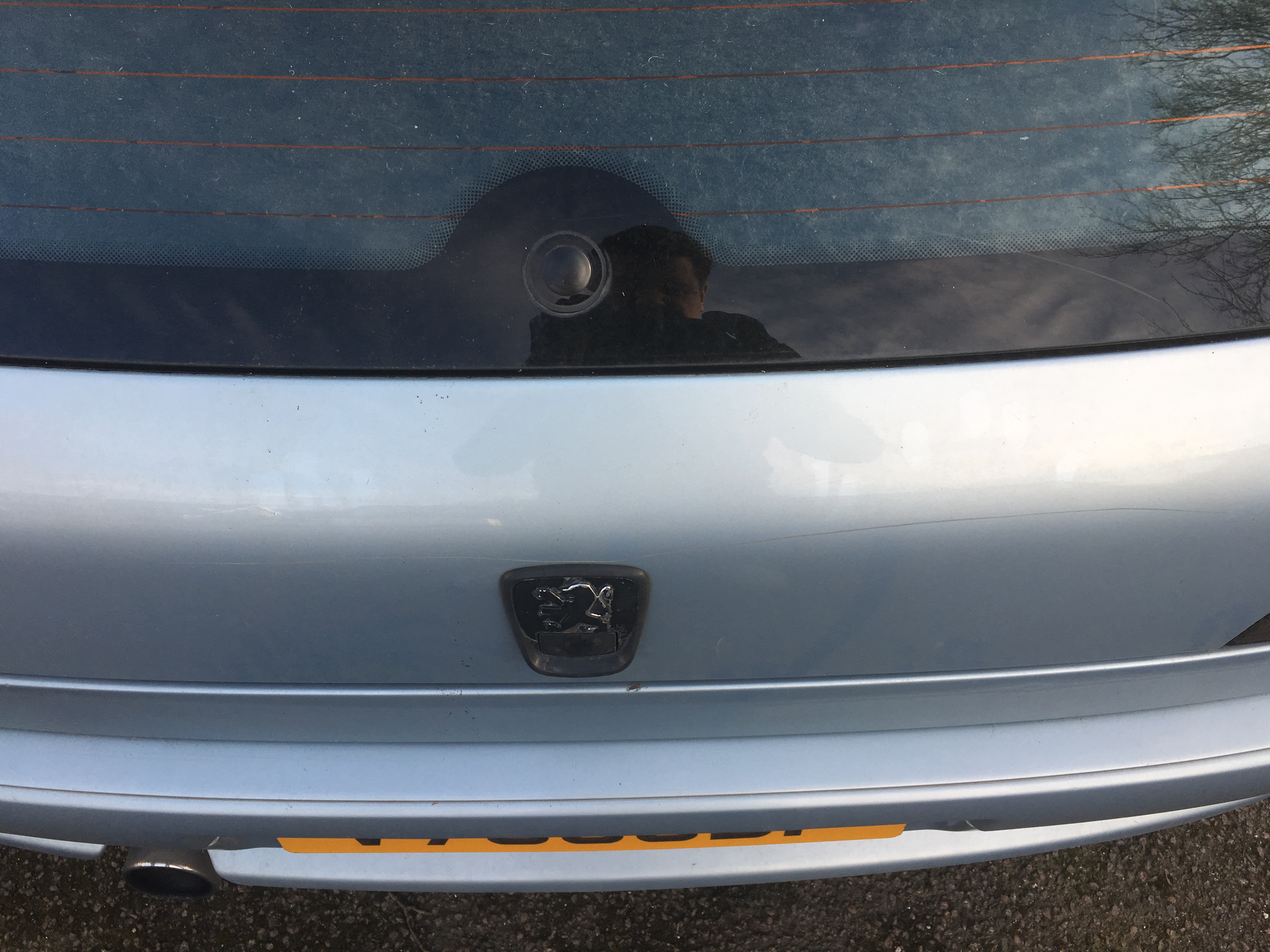

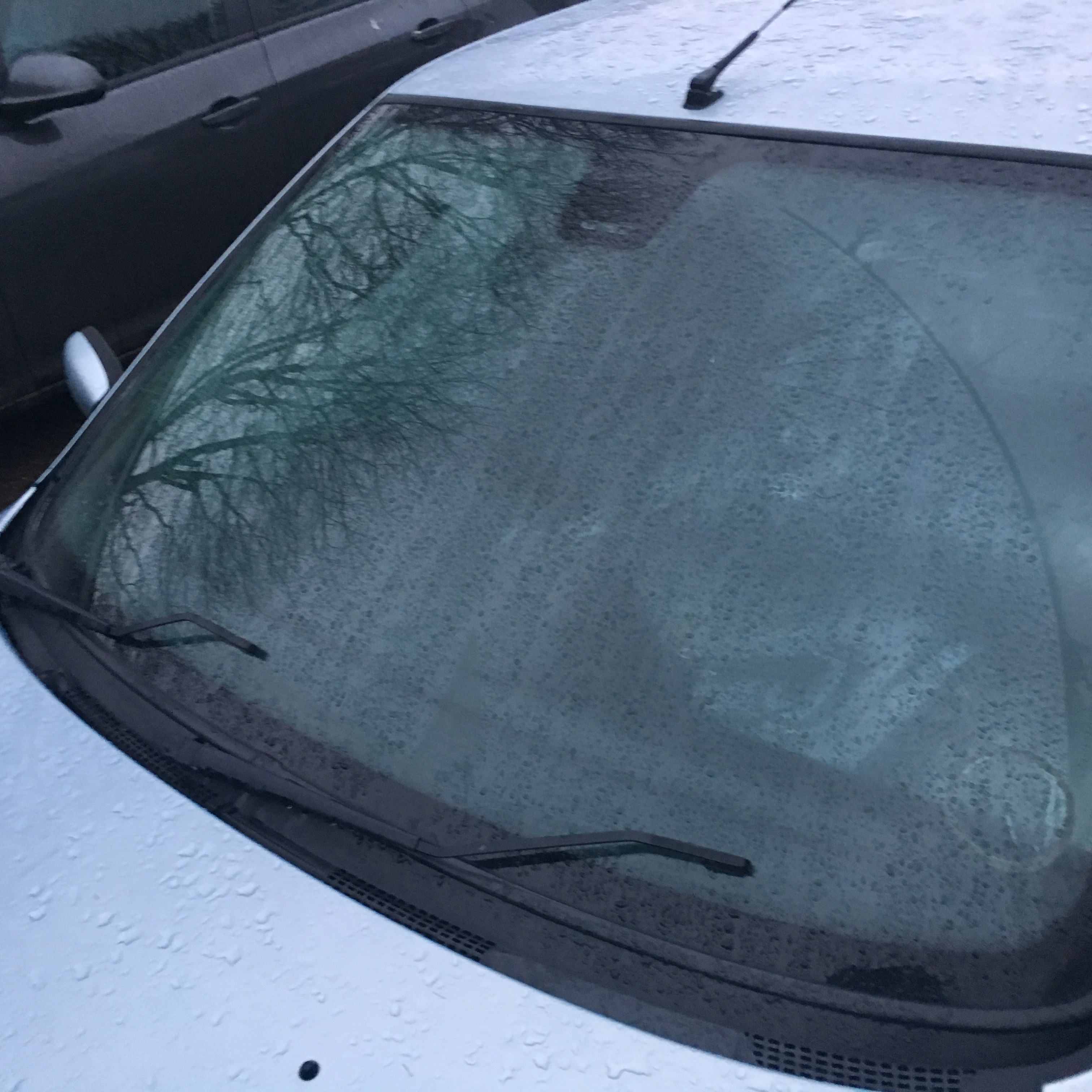

Cracked windscreen. I've since ordered a like for like replacement with rain sensors and green tint/hue from National Windscreens which is due to be fitted next week.  It's surprising how much you can actually see when looking out, it doesn't obscure the view at all but I won't be driving the car again until it's sorted.

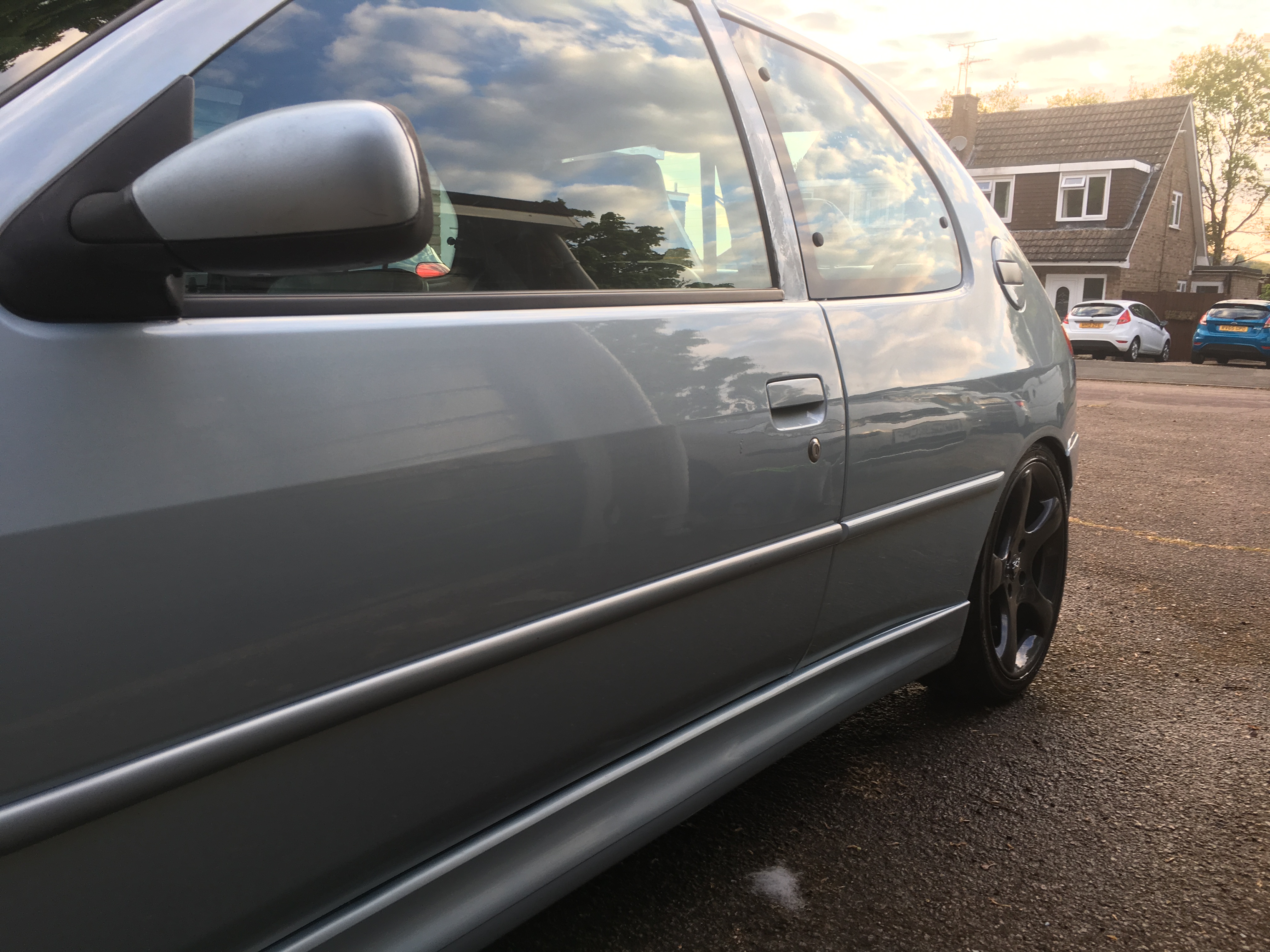

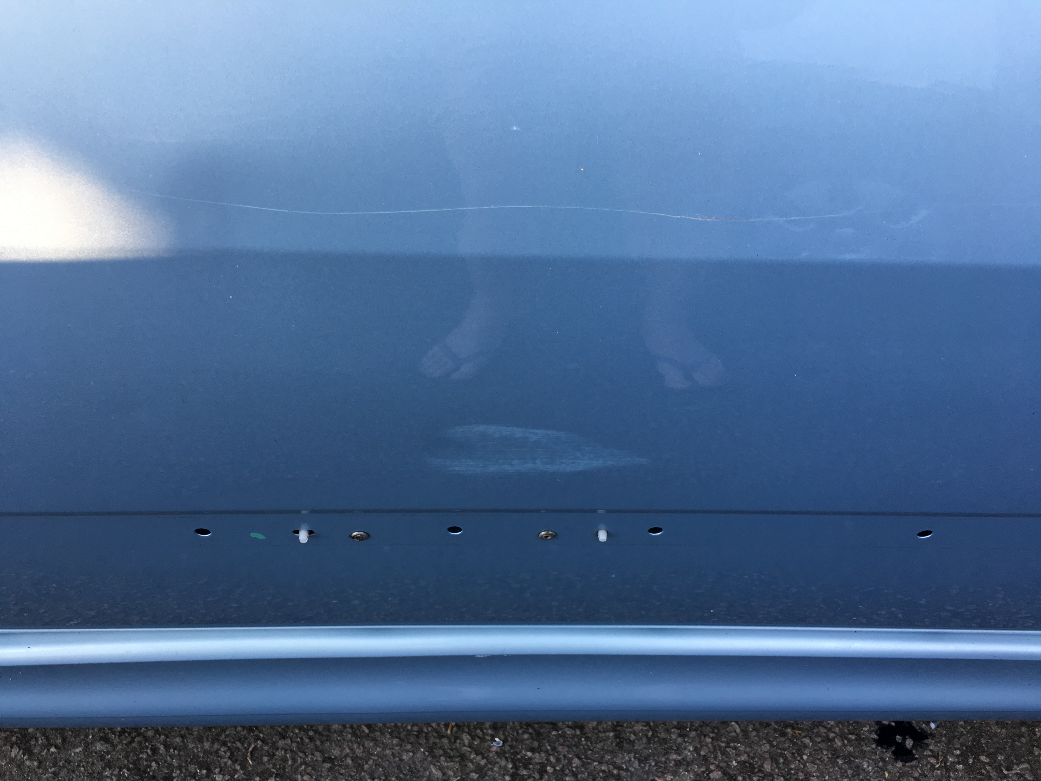

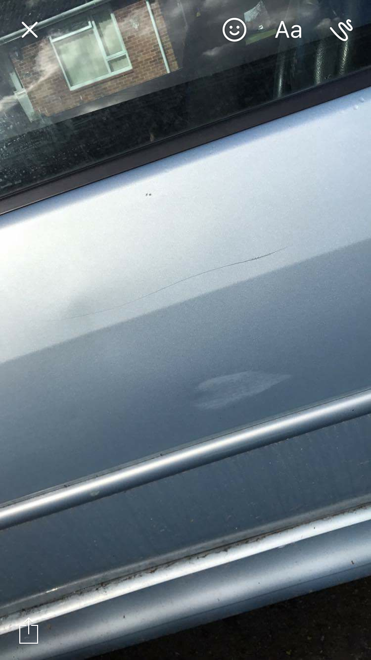

A couple of fairly deep key scratches to the boot and driver's door (which also has a scuff/blemish).  If there's one thing I am fairly confident about it's that I will be able to remove or seriously reduce the impact of the damage with the machine polisher as the blemish is just a surface mark where paint has rubbed off onto the door and the scratches have not gone through to the primer.  I've always been a sucker for Moonstone, it's such a rewarding deep colour when polished and waxed Inlove

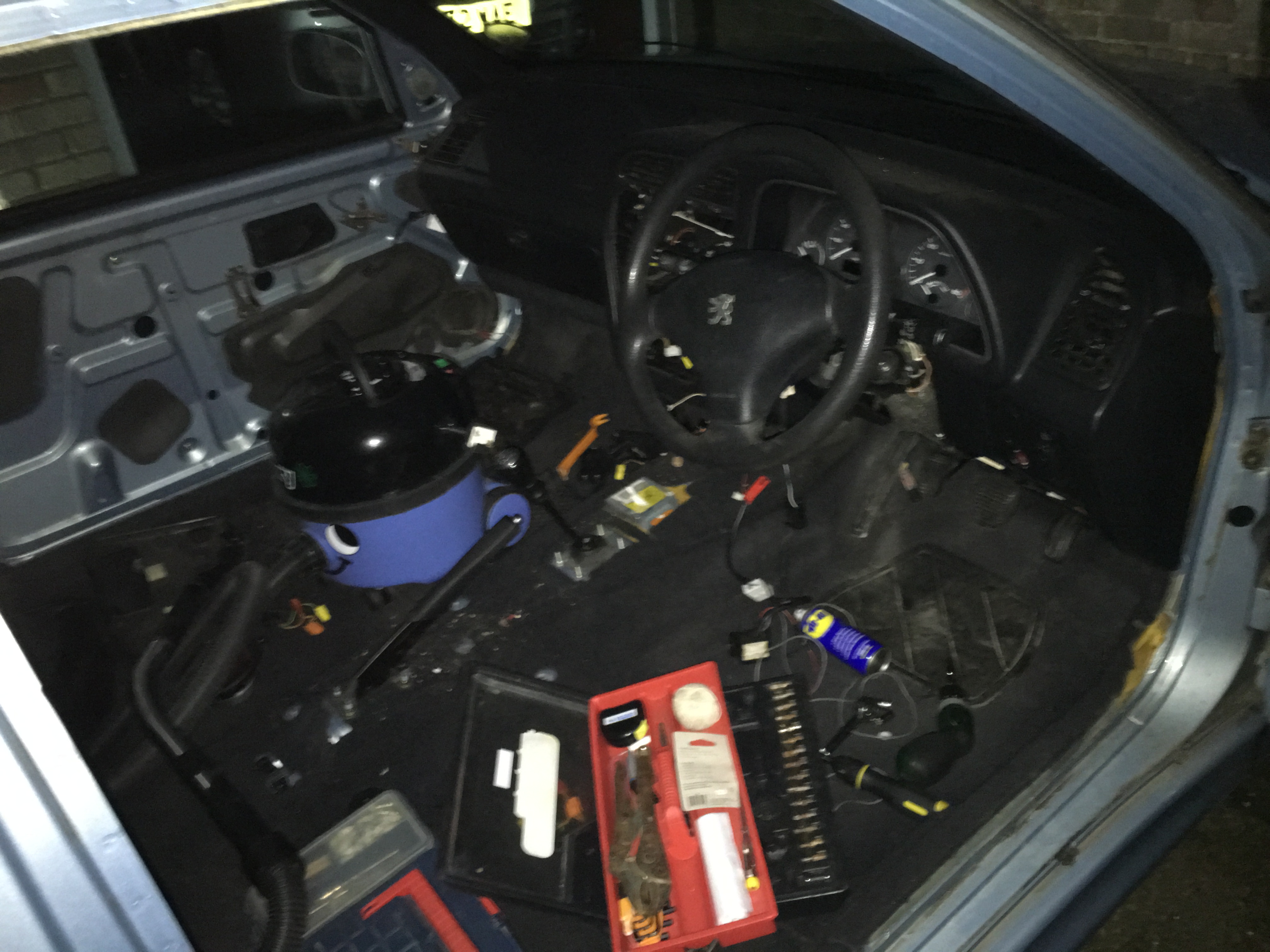

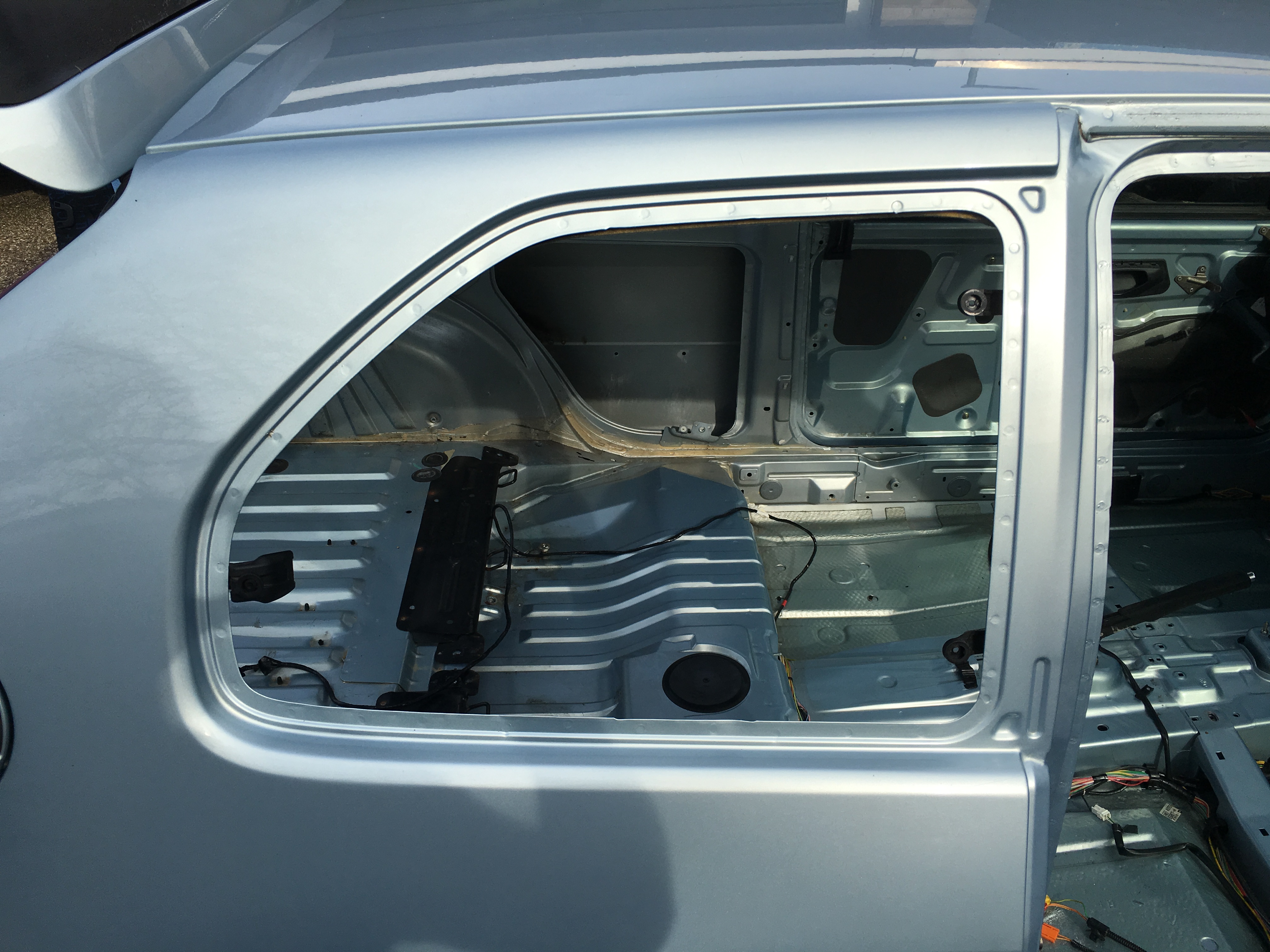

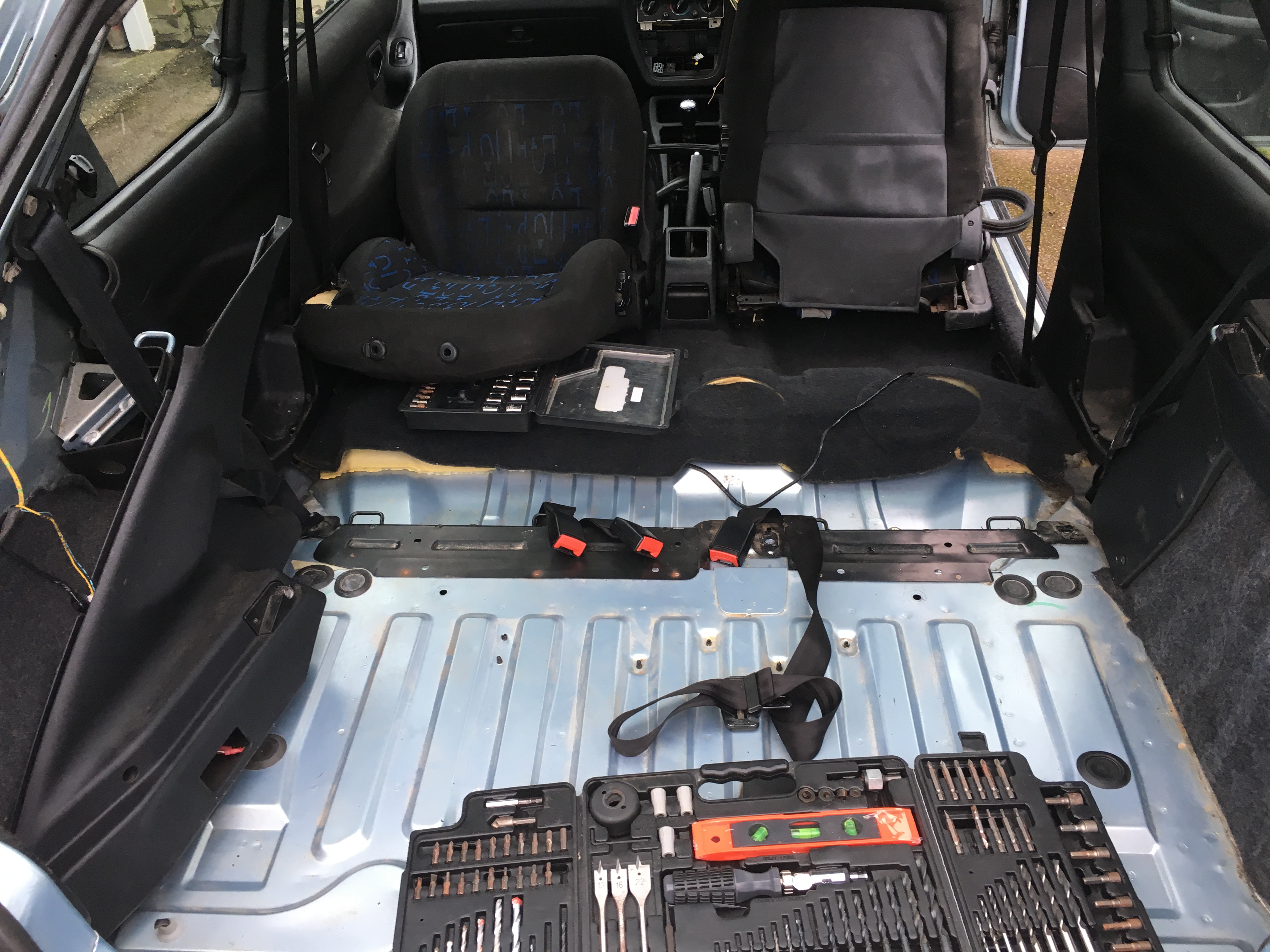

So I spent a couple of hours on Friday and pretty much all of today removing the interior.  It wasn't actually that difficult as I'm used to torx screws shearing off and bolts being seized on the Clio yet everything seemed to run smoothly until removing the last bit of carpet which I cheated on and cut with a stanley knife as it will be hidden when the centre console goes back on.
I started by unbolting the rear seats followed by the fronts hoovering as I went.  As it turns out the front set had a bolt missing and the rest were pretty loose so I'm glad to have found that out now.   I made sure I bagged up all the parts separately so I can have half a chance of putting them back where they came from.
The car was absolutely minging and has a smell of death.  When I saw these chips I nearly gagged.

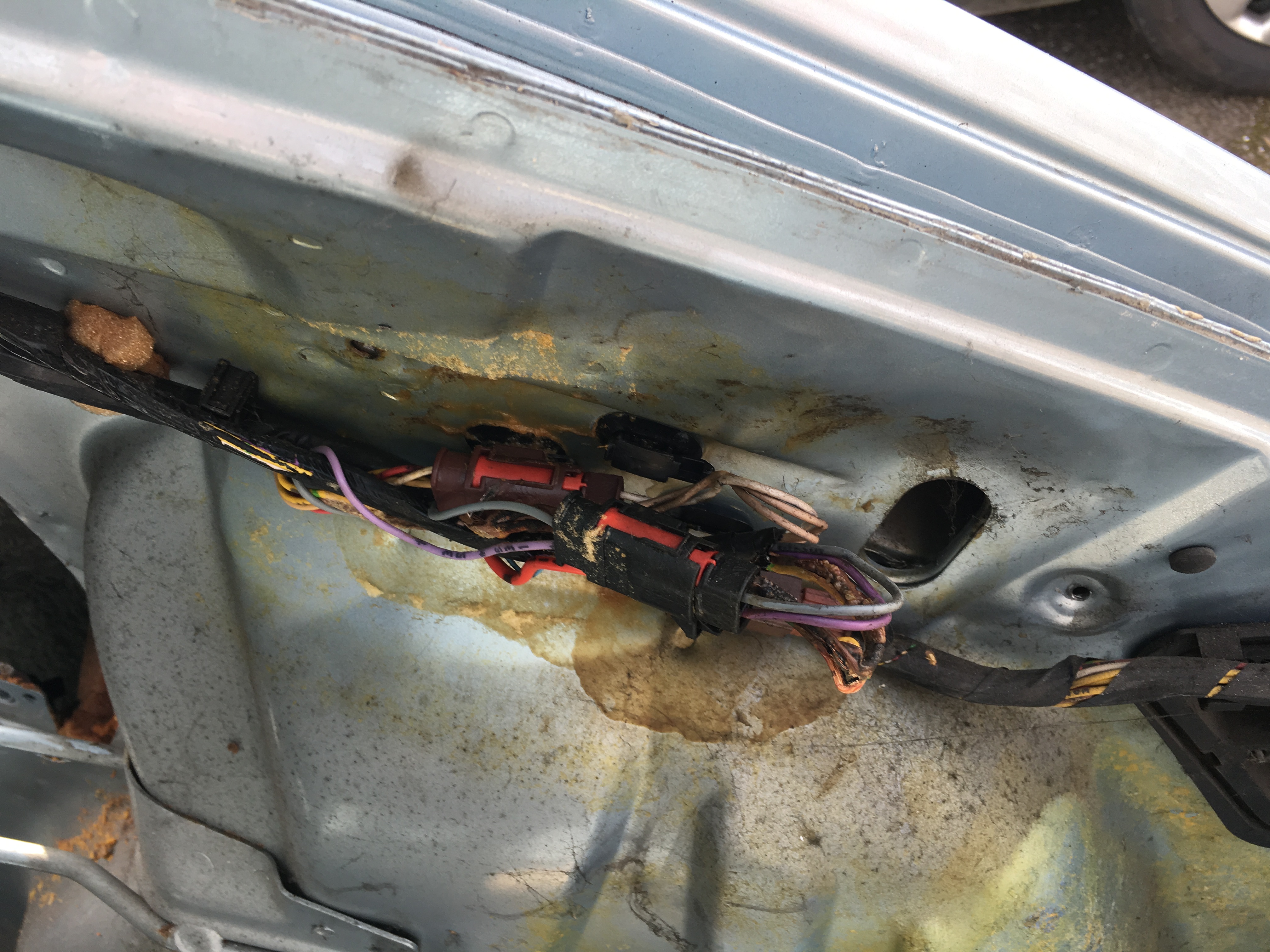

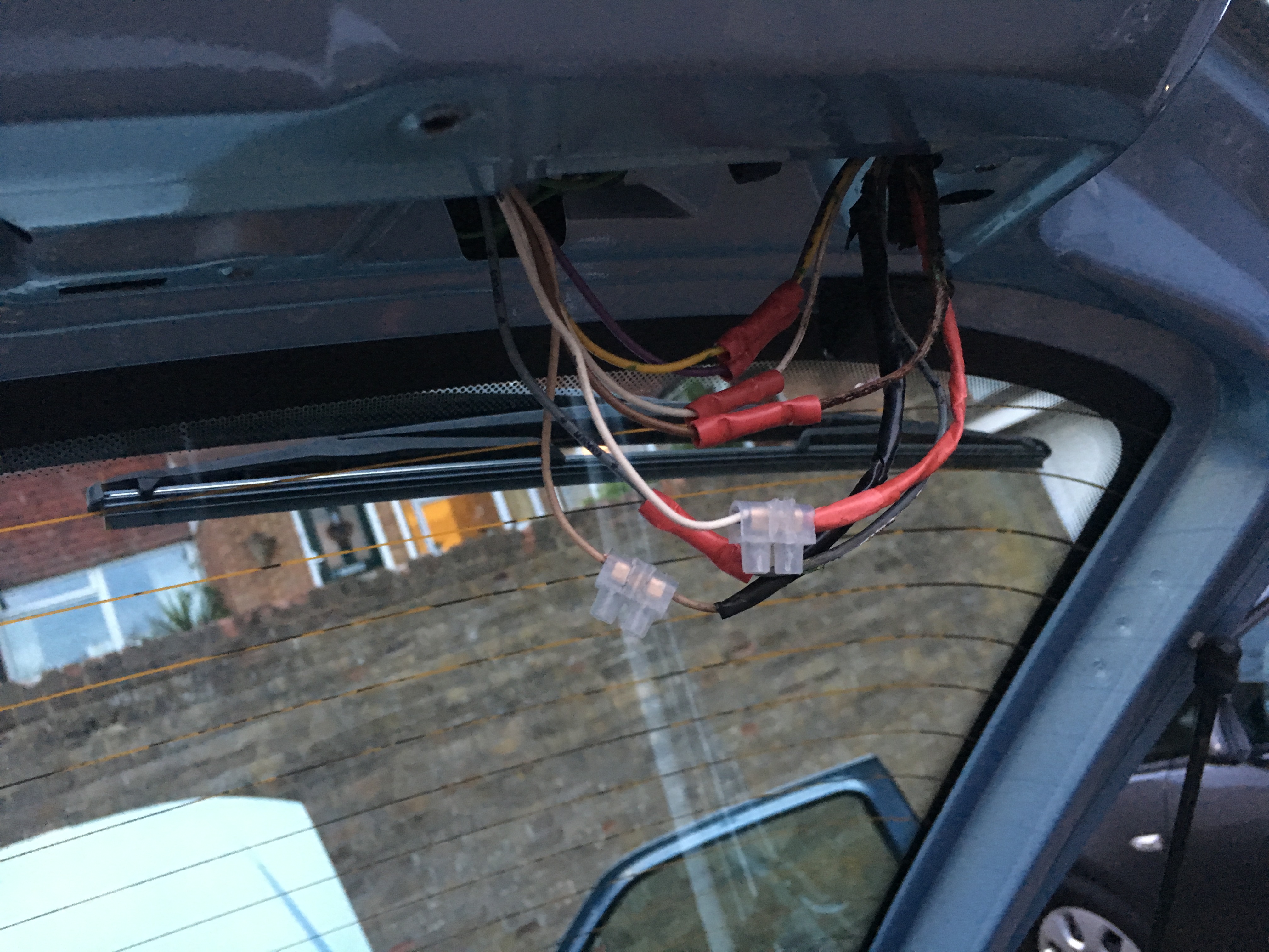

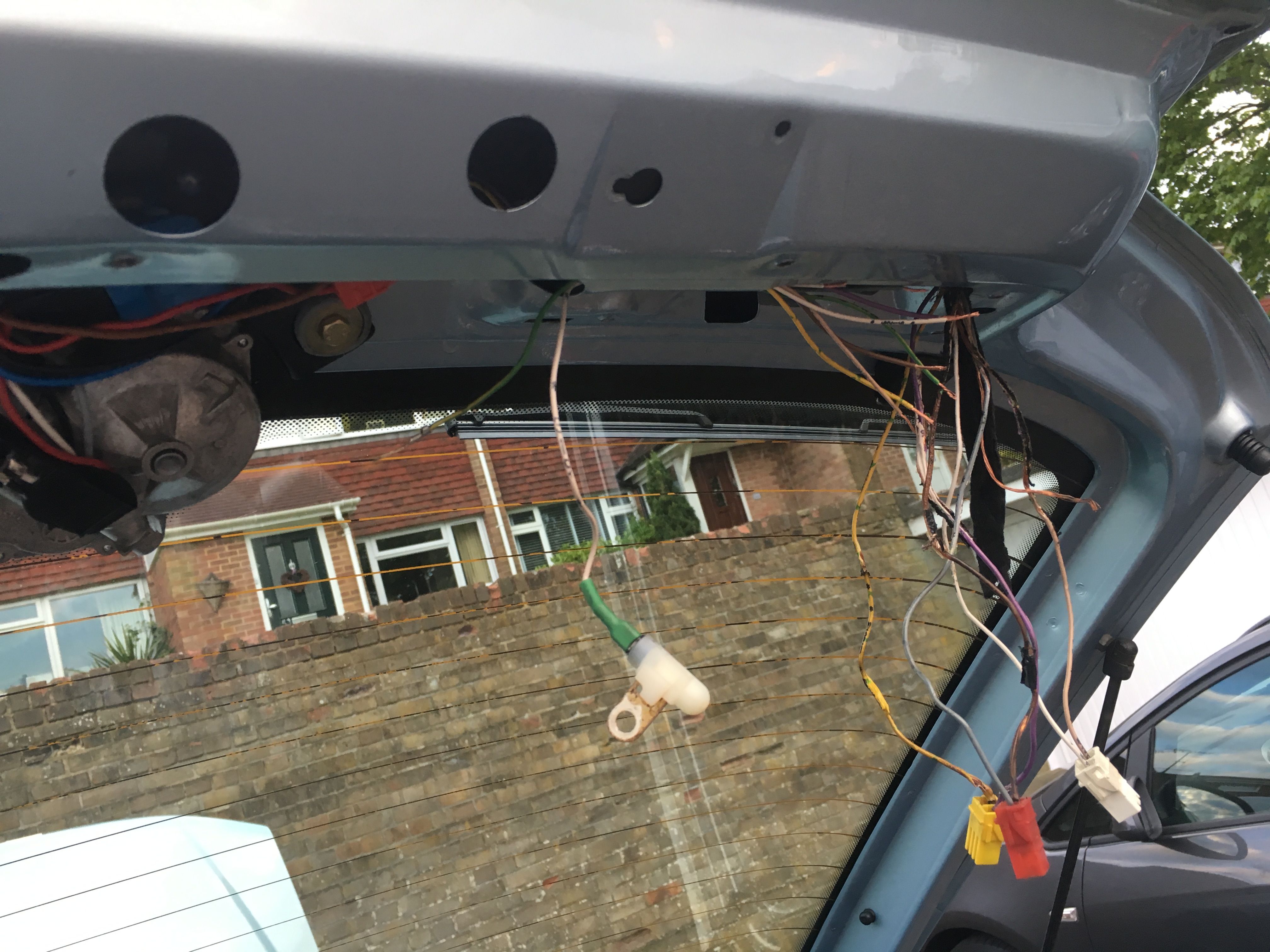

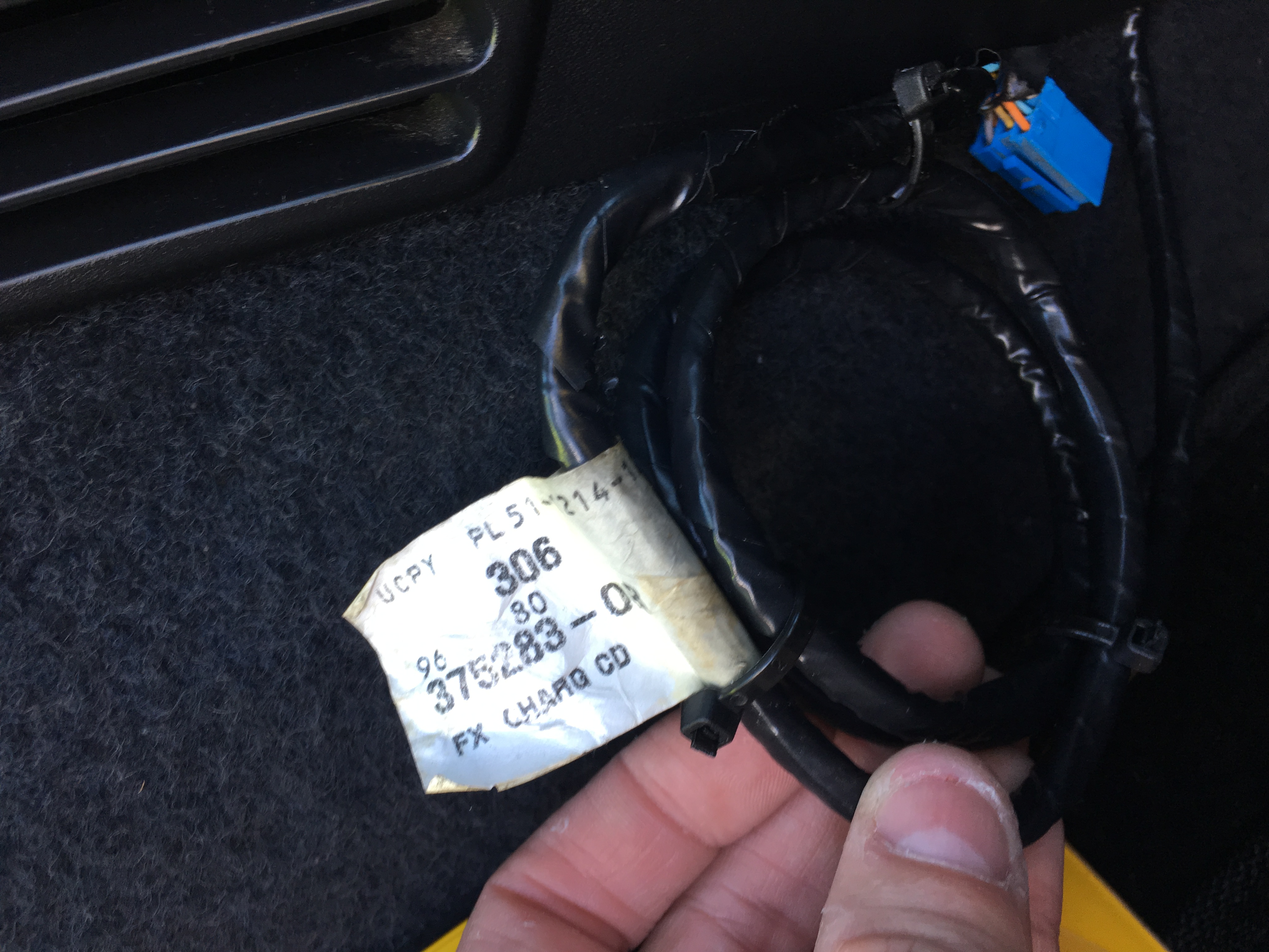

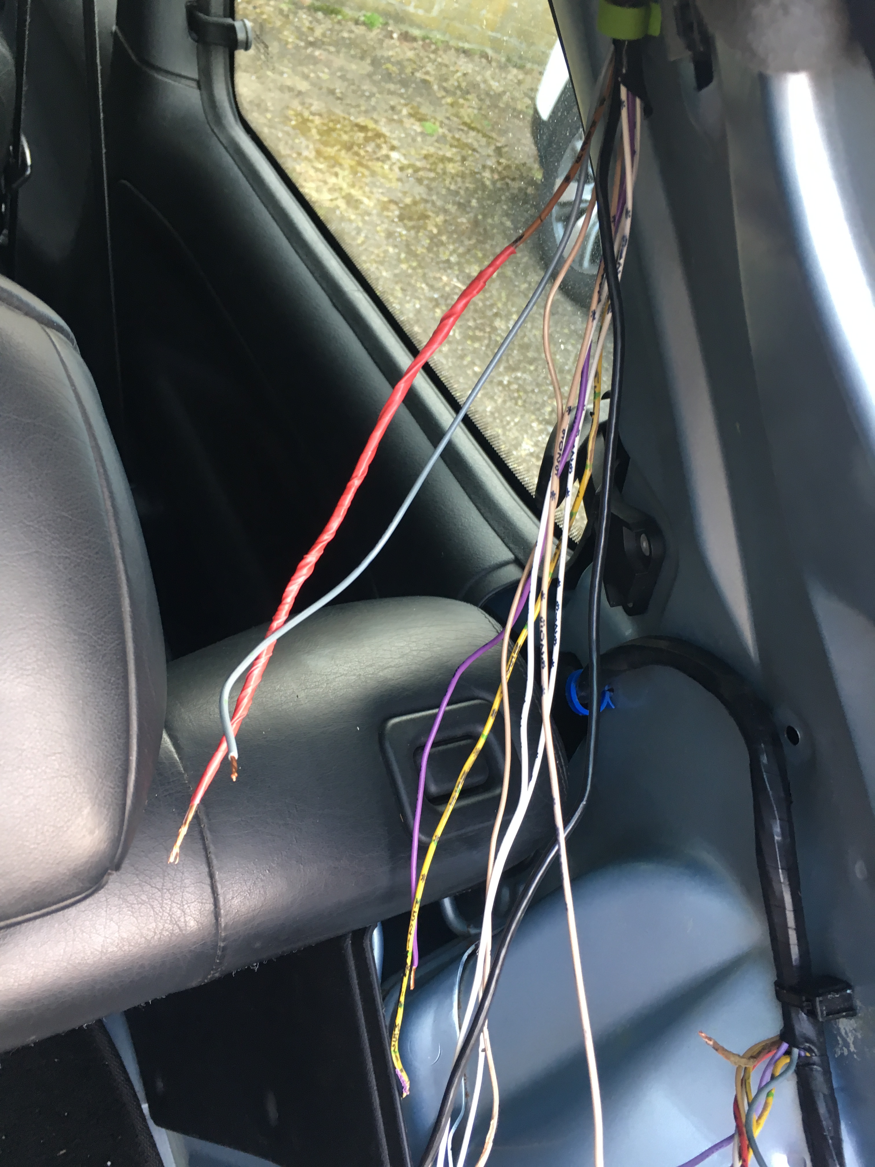

Someone who owned this car was a bit of an avid in car audio DIYer as there were cables running everywhere, little bits of wire in the carpet and so far I have found 10 speakers in the car including two in the bootwell and two more in each of the rear seat pockets?!
When the wiring was run to the boot part of the carpet wasn't put back in properly which you can see bottom right

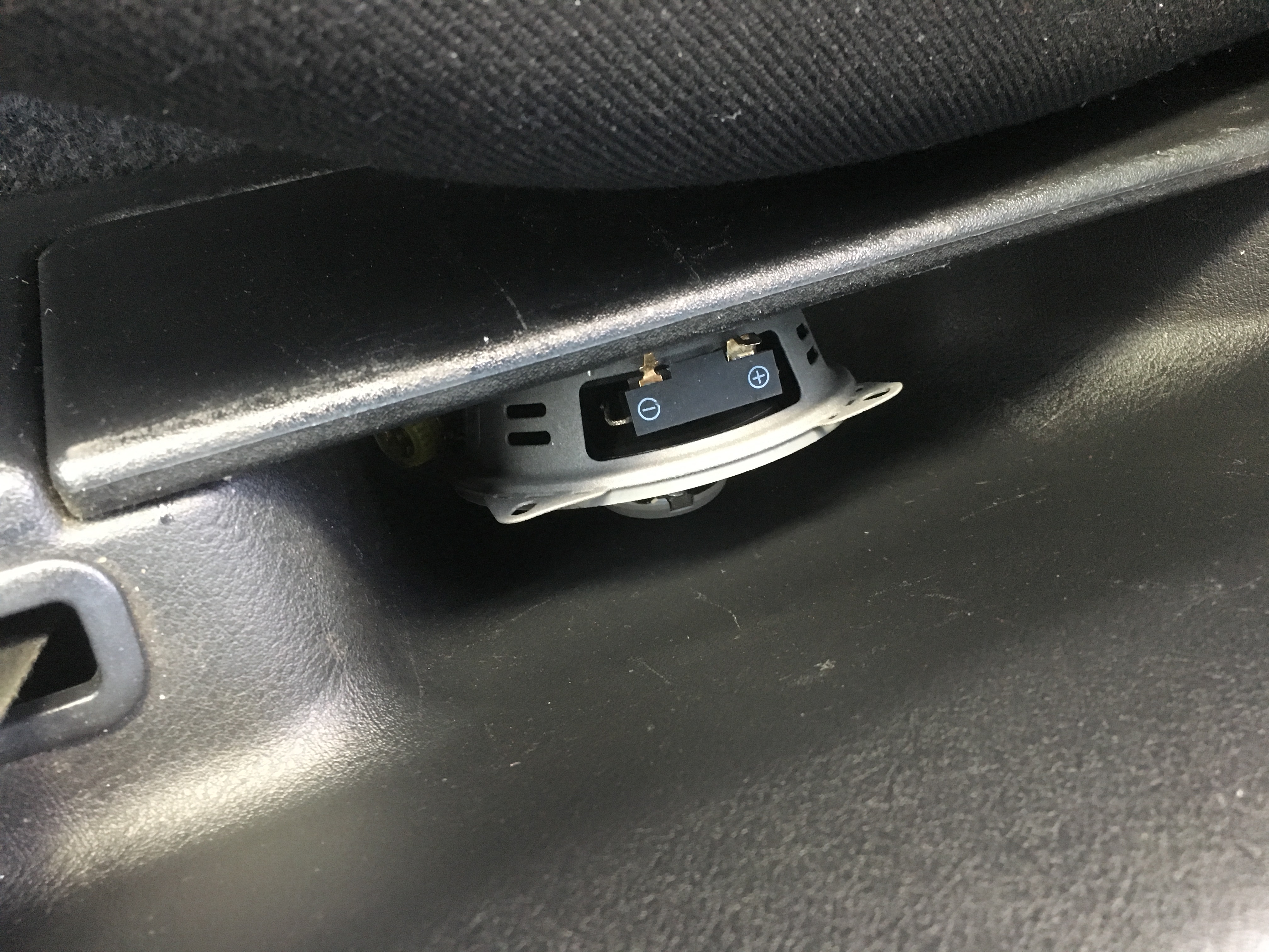

The 6x9s were seemingly held on by hopes and dreams (and massively long screws) and basically fell out when I took out the parcel shelf.
I'm really not looking forward to having to reverse whatever is going on with the stereo loom.  Does anyone know if this looks like a bodge job or whether I can simply remove the Pioneer adaptor and be left with what is there as standard?

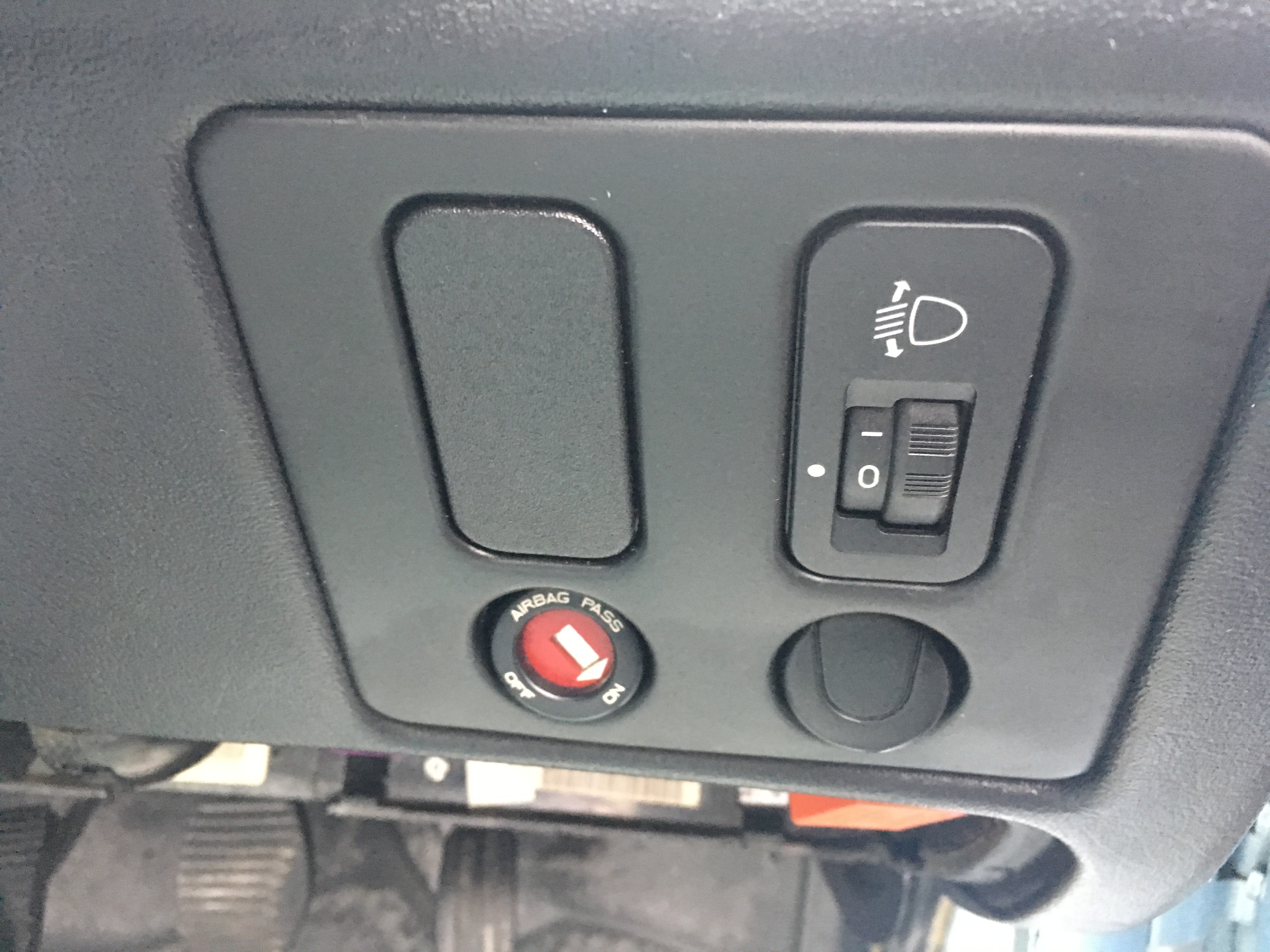

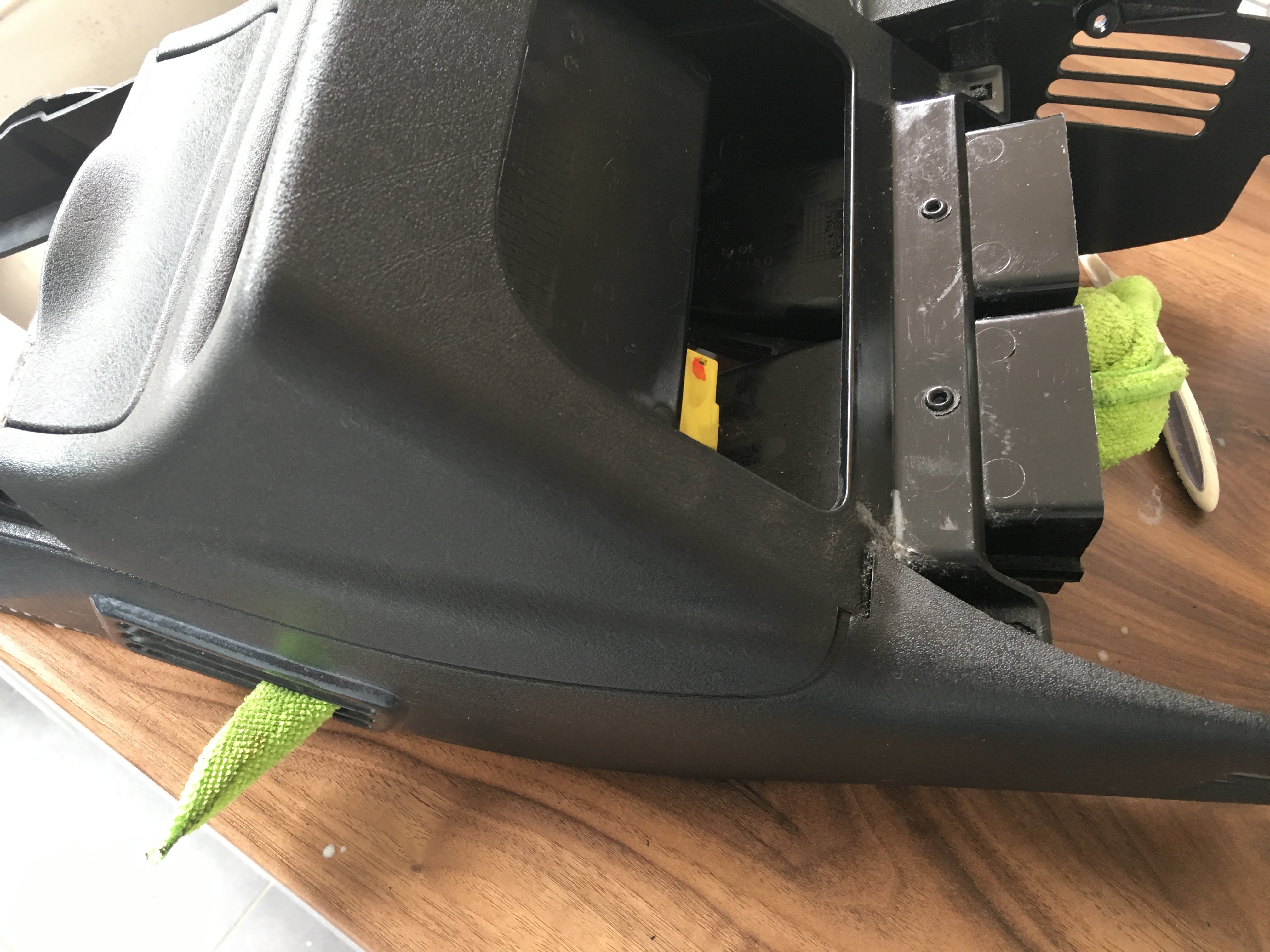

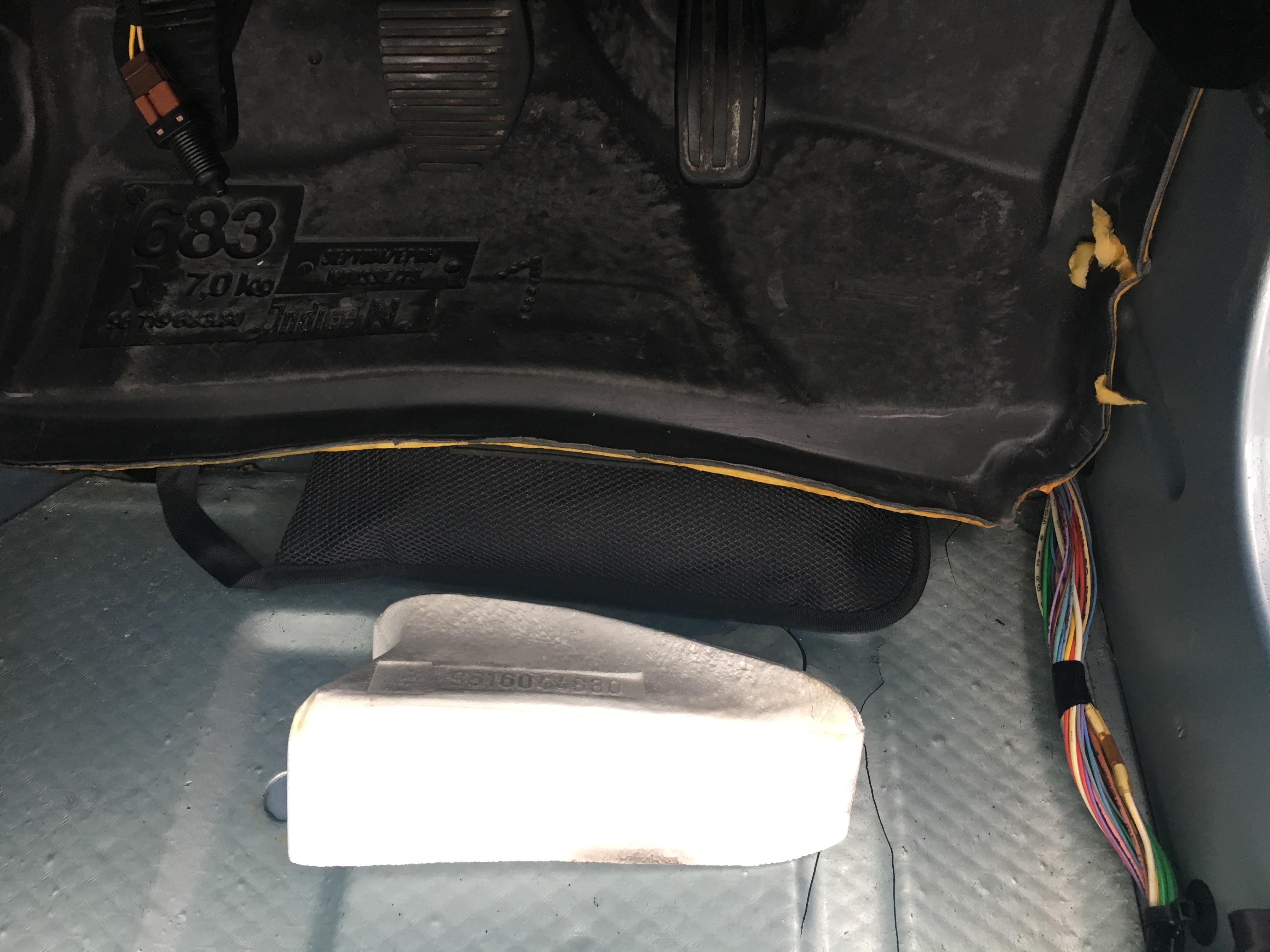

Does anyone know what the little push button device is in front of the clutch pedal in this shot?  Looks important and it's surely not supposed to just hang there?!

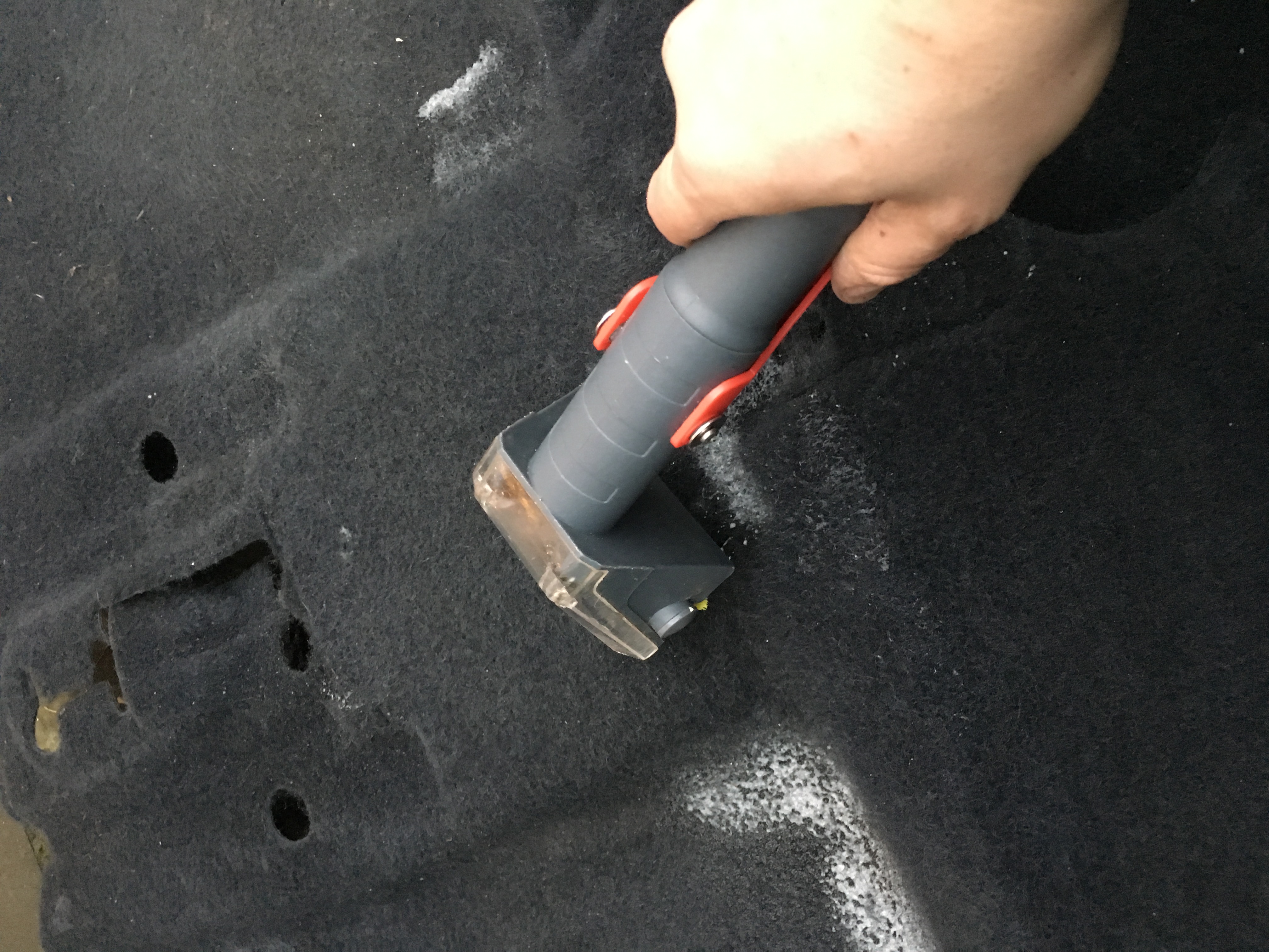

Today (Saturday) I got up early and went down to Homebase to hire a Rugdoctor for the carpets.  When I got home I found some ebay deliveries - a keyfob battery and lion embossed rubber button. The existing keyfob was a little worse for wear...

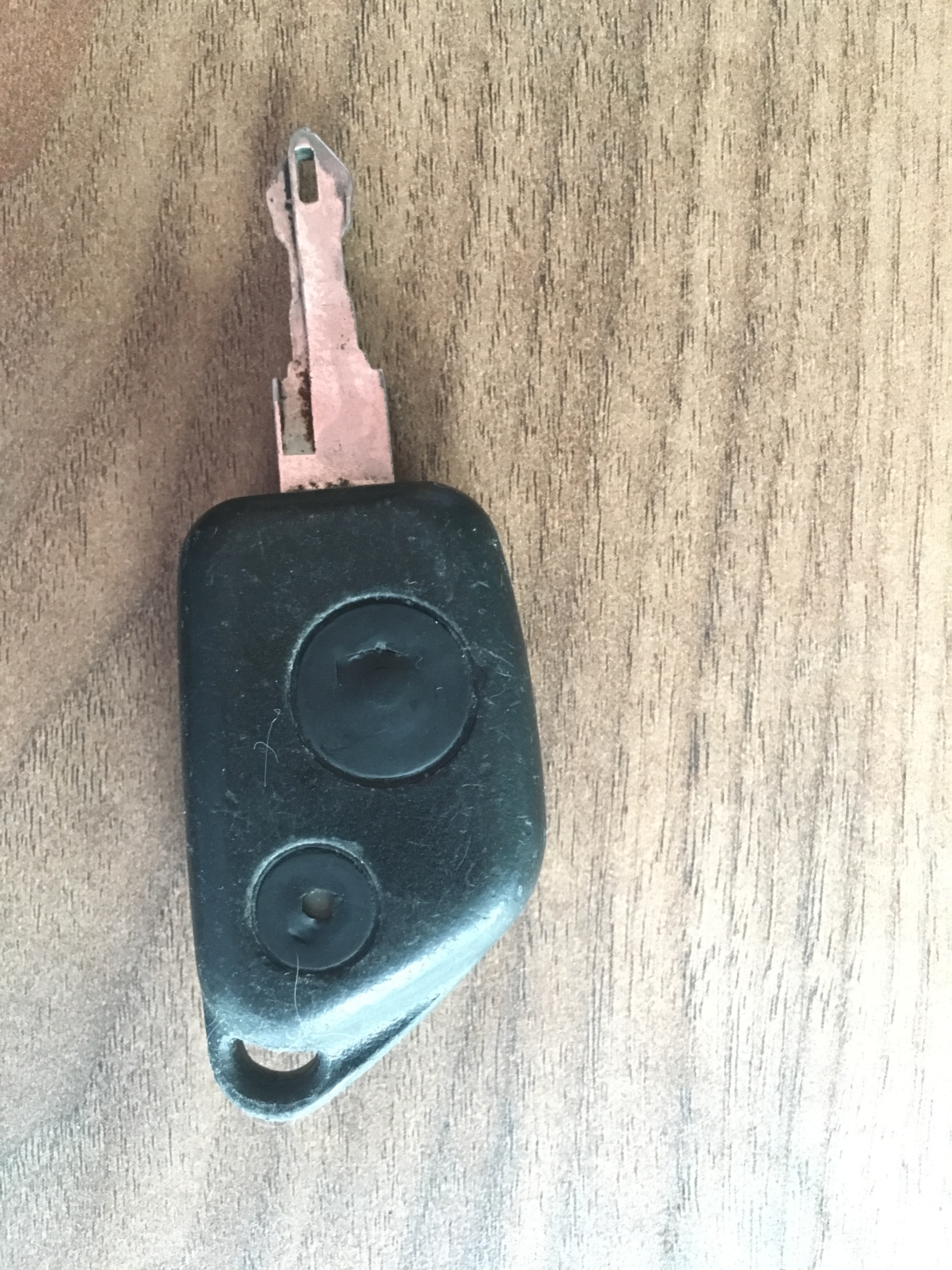

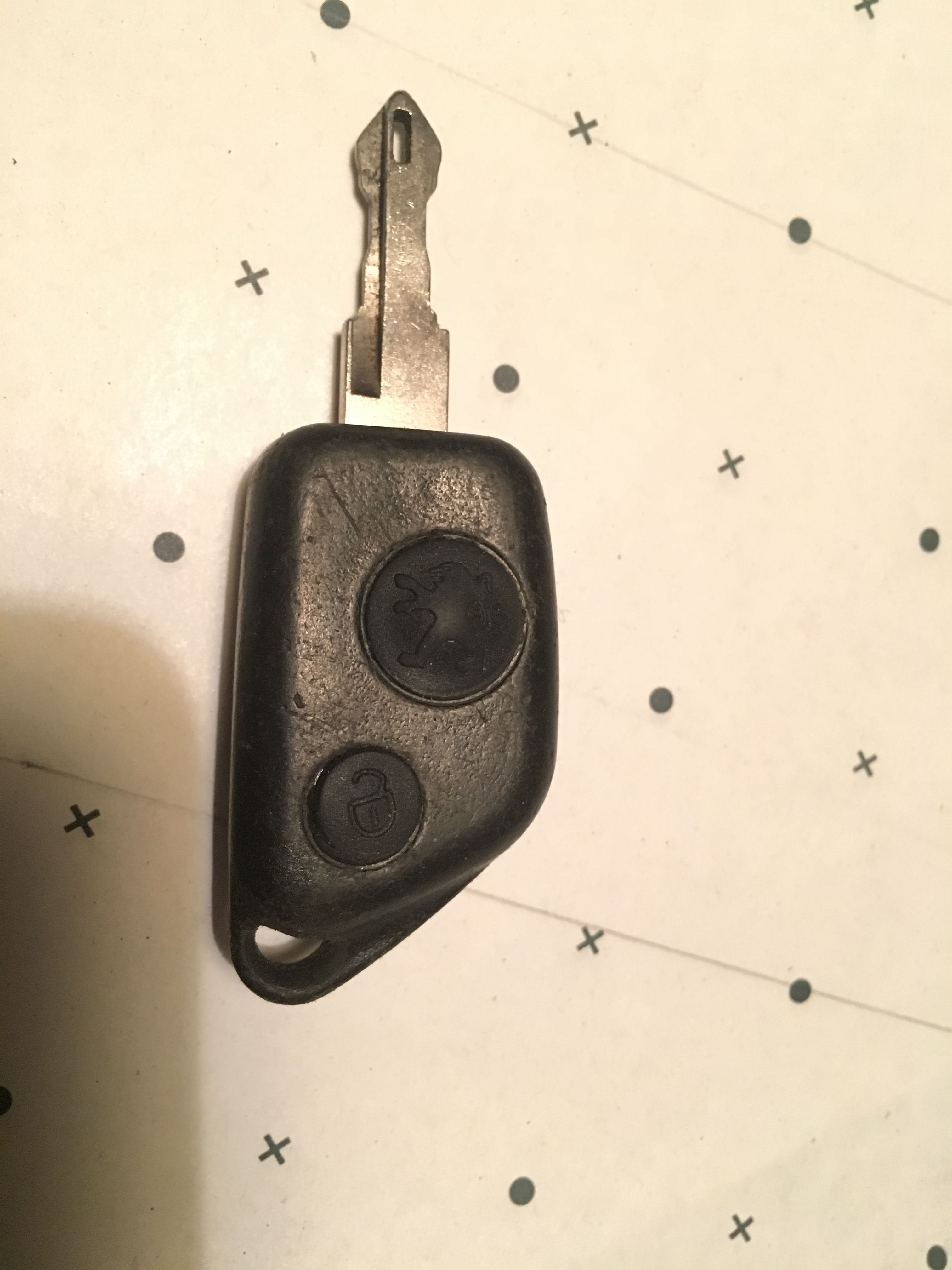

I started by removing the key part and polishing the dirt off with wire wool and autosol.  I then had to use the wife's hairdryer to heat up and remove the old worn rubber buttons as they were well and truly stuck on.
The finished result...not perfect but certainly better.
When I went to try the key the remote locking didn't work first time then I found and followed the guide on here and turned the key in the ignition once, off and on again making sure to hold the large button down for 5 seconds.  After that I tried pressing in AND.....nothing  Huh . I slipped the key in my pocket thinking it was a lot to expect anyway and 15 minutes later the doors locked. I realised the key had pressed in my pocket so I took it out, tried it again and it worked!! I now had a fully functioning keyfob and remote locking which called for an air fist pump!  Big Grin
I am thinking I will buy a used fob, another set of buttons and a new shell on ebay then get a key blank cut to get a second key - does anyone know if you can re-programme any used key to work the central locking just by doing the on/off/button hold trick?

Yeh there's a black pot that goes in that hole. I make a 3d printed cup holder for that space as well if you want something more useful. How much is the wetvac rental?

That looks like the brake light switch that is hanging down there.
Are they working O.K?

(12-03-2017, 12:33 AM)Eeyore Wrote: Yeh there's a black pot that goes in that hole. I make a 3d printed cup holder for that space as well if you want something more useful. How much is the wetvac rental?
Yeah, that would be great, having a cup holder would be really handy.  Have you got a pic of one that you've done?  The wetvac was £30ish for 24 hours plus £20 deposit that you get back.  I've got mixed feelings about it.  It takes ages and the suction is worse than the Henry I've got but there's probably nothing quite like it for deep cleaning and the amount of dirt it picked up was impressive.  I might just shell out and buy a "George" as I think that is Numatic's wet vac.

(12-03-2017, 12:09 PM)Danny Wideboy Wrote: That looks like the brake light switch that is hanging down there.
Yeah, the brake lights work fine but I'll check them again.  It has a little push button on it so I'm not sure what that's for.  Where is it supposed to be?

moste likley will be the clutch switch so get it working as it effects fueling in some situations
Sorry haven't got a photo I can upload from mobile but there are some on my project thread probably a few pages back.
(12-03-2017, 08:49 PM)madmadmax Wrote: moste likley will be the clutch switch so get it working as it effects fueling in some situations
Aha!  I think you're right, as per this diagram.  Just got  to figure out where it goes now, think its at the very top of the clutch arm.

Once the carpets were out it was time for the RugDoctor!
In progress.  It took ages to get them clean, the hand tool attachment sprays cleaning fluid onto the carpets and there is a little brush on the back to move apart the fibres so the vacuum can suck up the soap/dirt.
I don't have many after shots as it was getting dark but what came out was impressive.

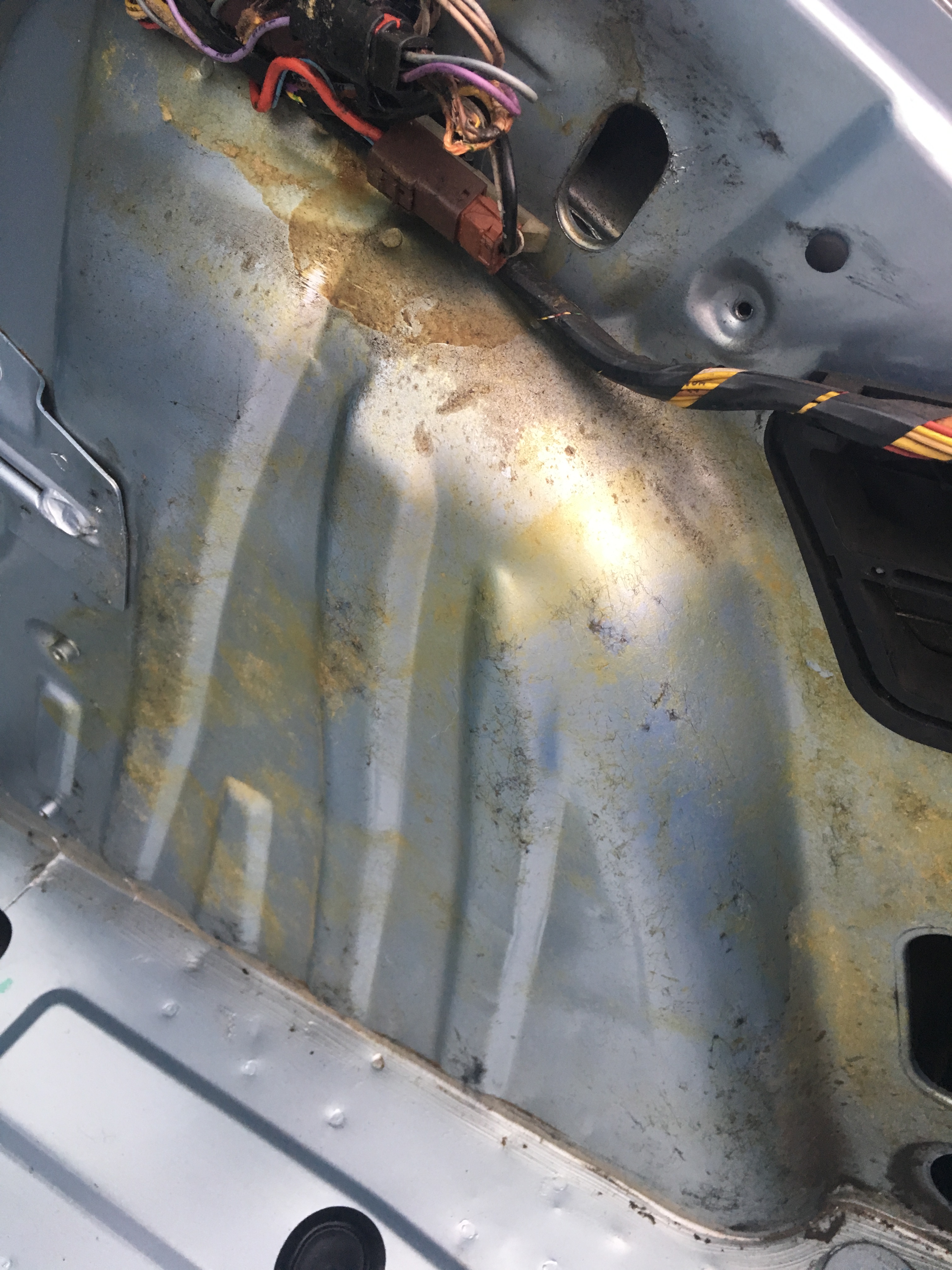

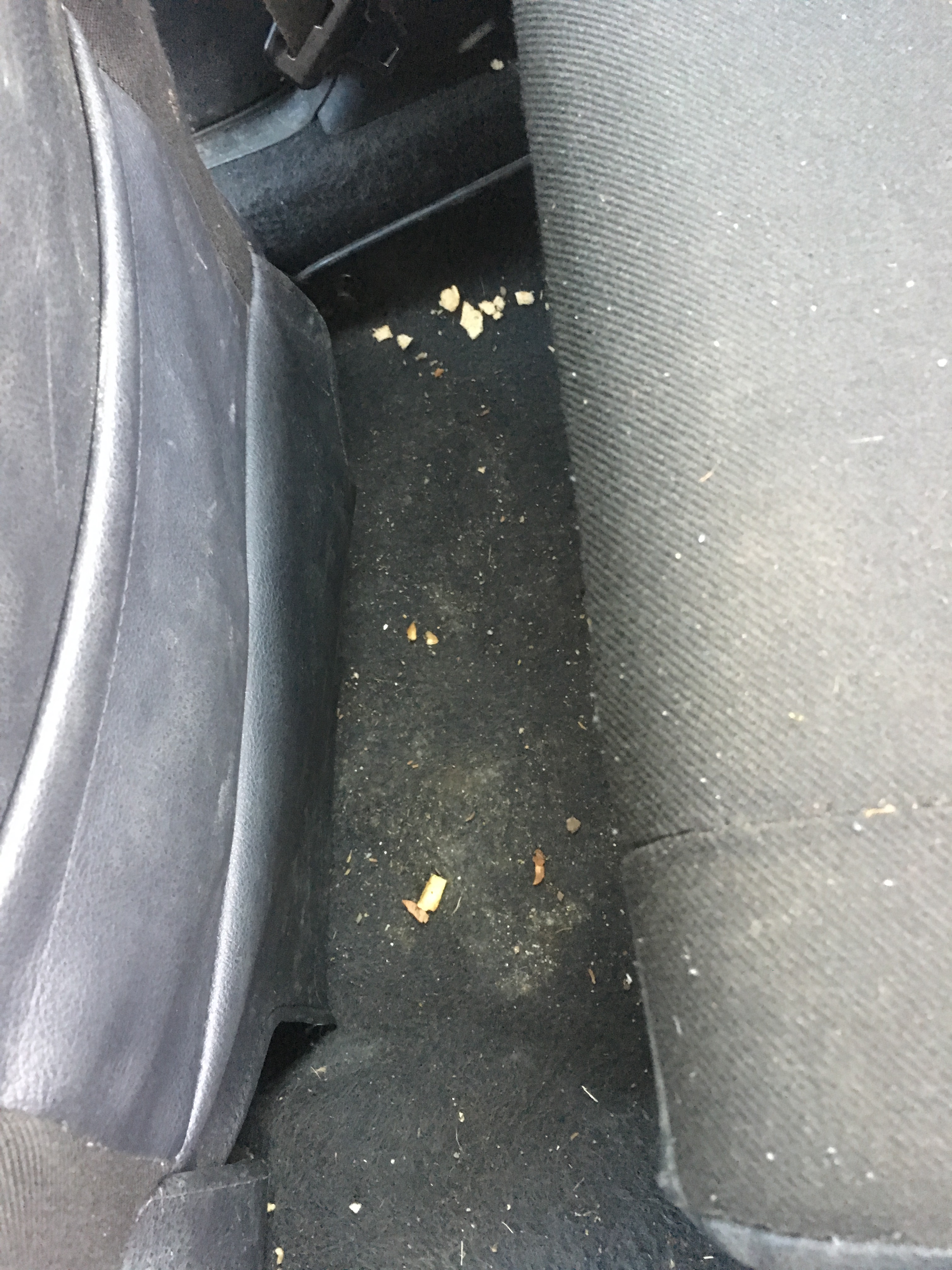

So it was raining on Sunday and I basically sat inside the car with a bunch of cleaning gear and made a bit more progress whilst it is stripped out.
Both footwells appeared to be quite damp/wet which might have been the cause of the bad smell inside so I got two large bags of silica that I use to keep my Clio moisture free and stuck these under the sound proofing at the front of the car which has dried things out nicely.  I just need to identify what is causing the leak as it seems there are common things like a lack of foam inside the doors by the speakers and/or draining holes in the scuttle panel being blocked.
I took a quick trip to a breakers yard to pick up some interior parts and whilst I was there I took an interior switch off a Meridian which looks like some kind of light dimmer - I was surprised to find my car had a plug behind the blanking plate so I'm not sure if it will do anything but it looks a bit better.

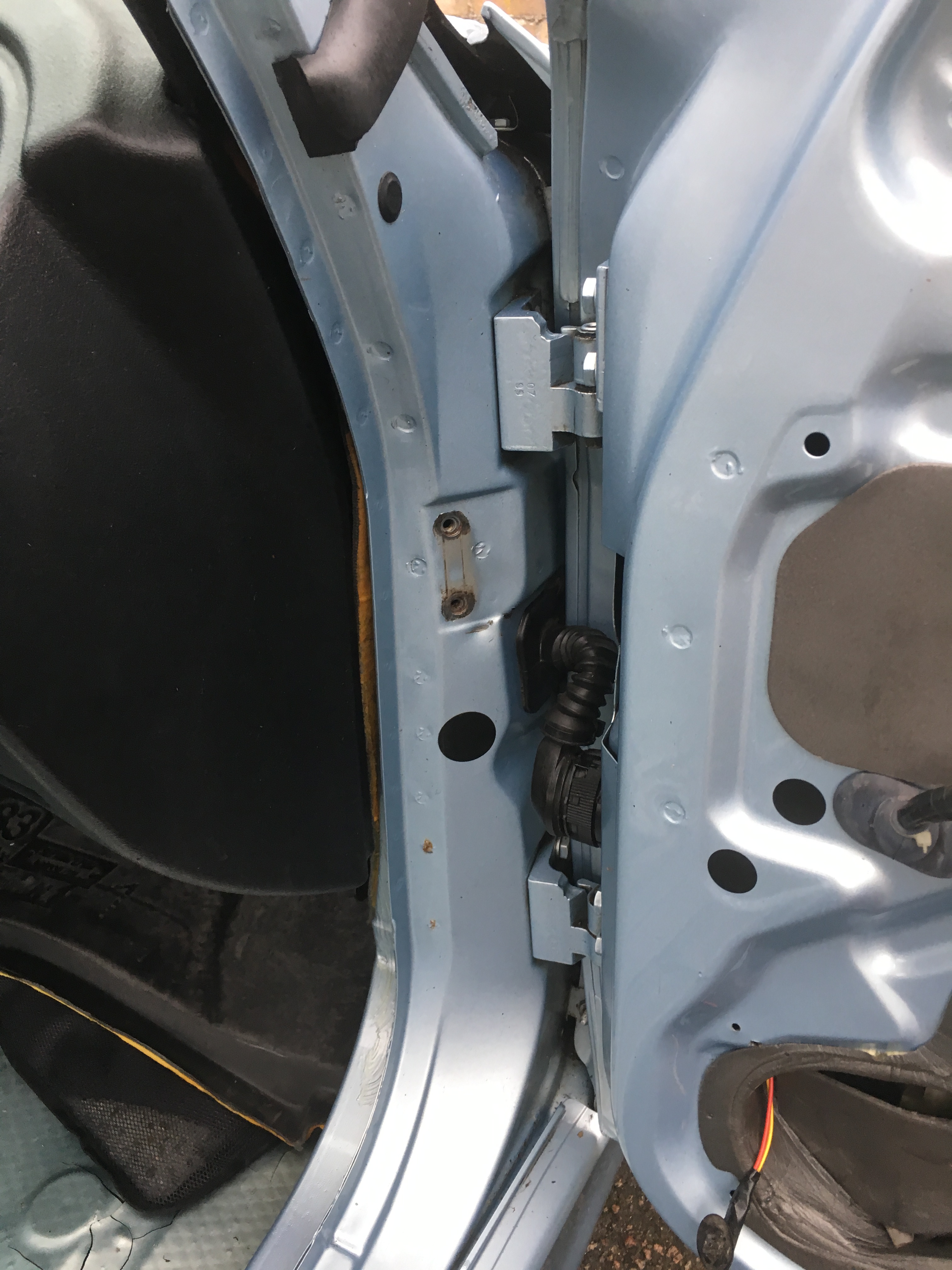

It was drier when I got home so I cleaned out the inner door panels and door jambs using a detailing brush and some quick detailer

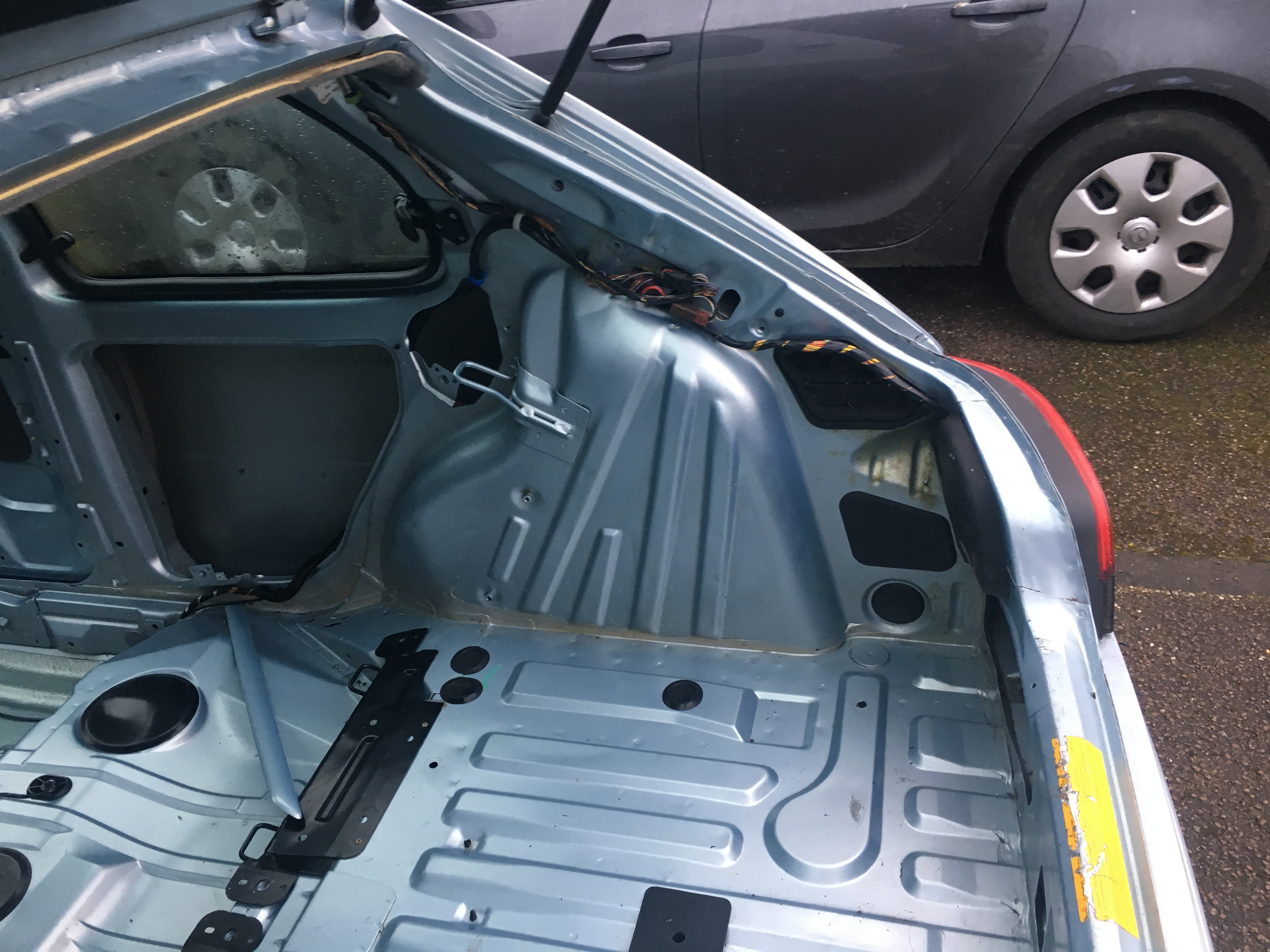

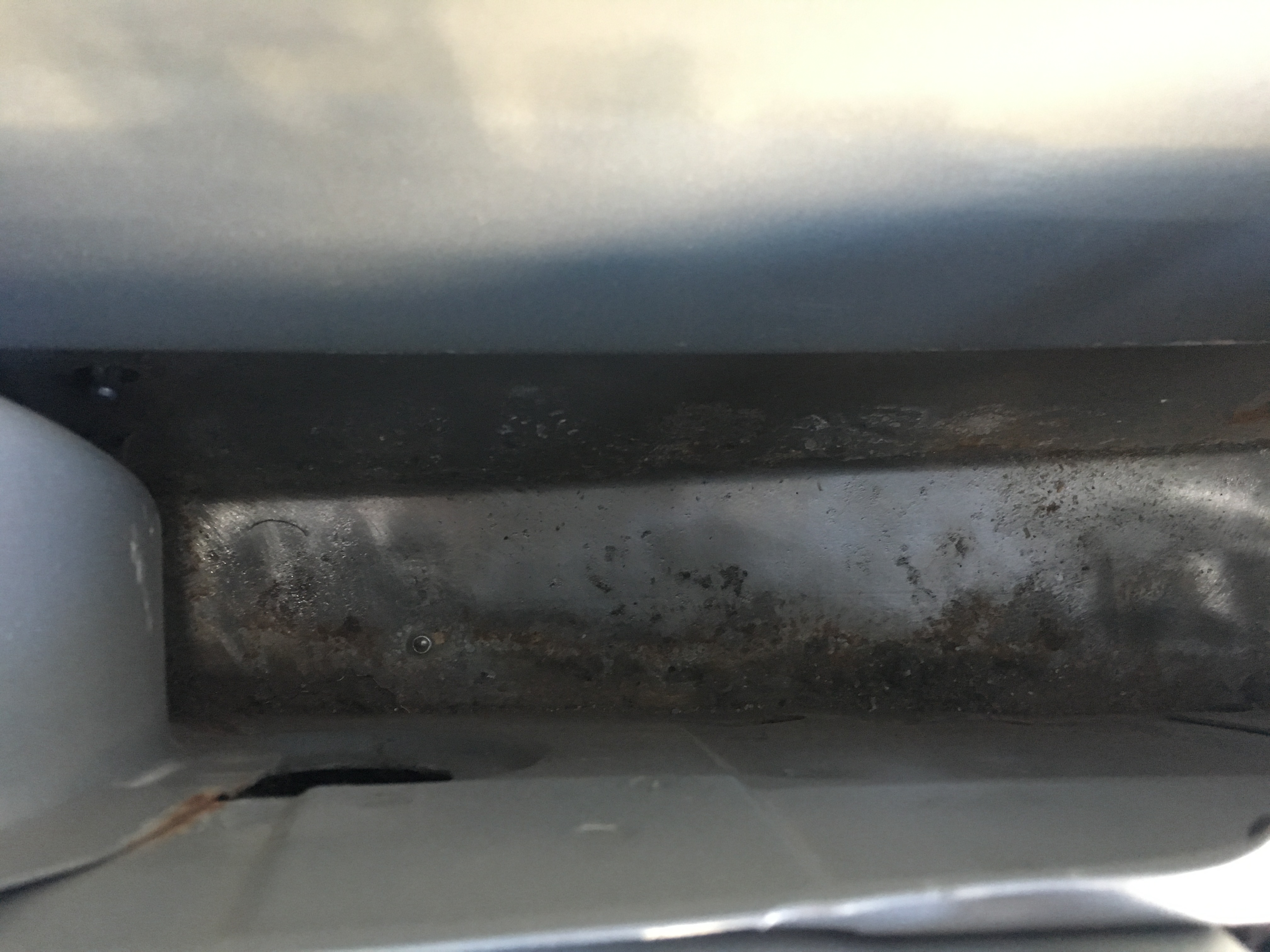

I then turned my attention to the boot.  I ripped off the really thin carpet on the boot sides and there was a yellow glue residue that just would not shift so I eventually got out some white spirit and went to work.
Before...
After..still a little bit to do but much cleaner...

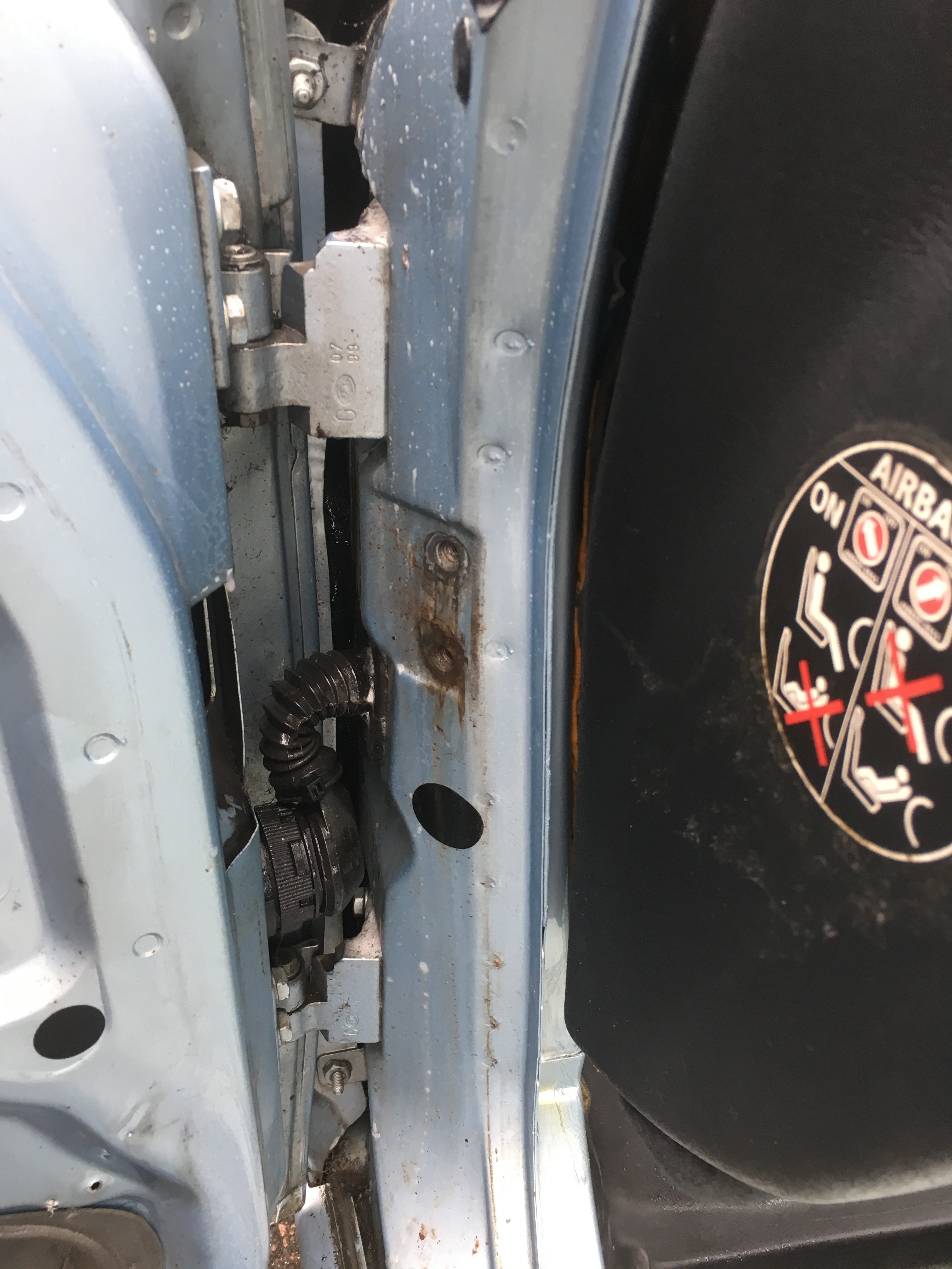

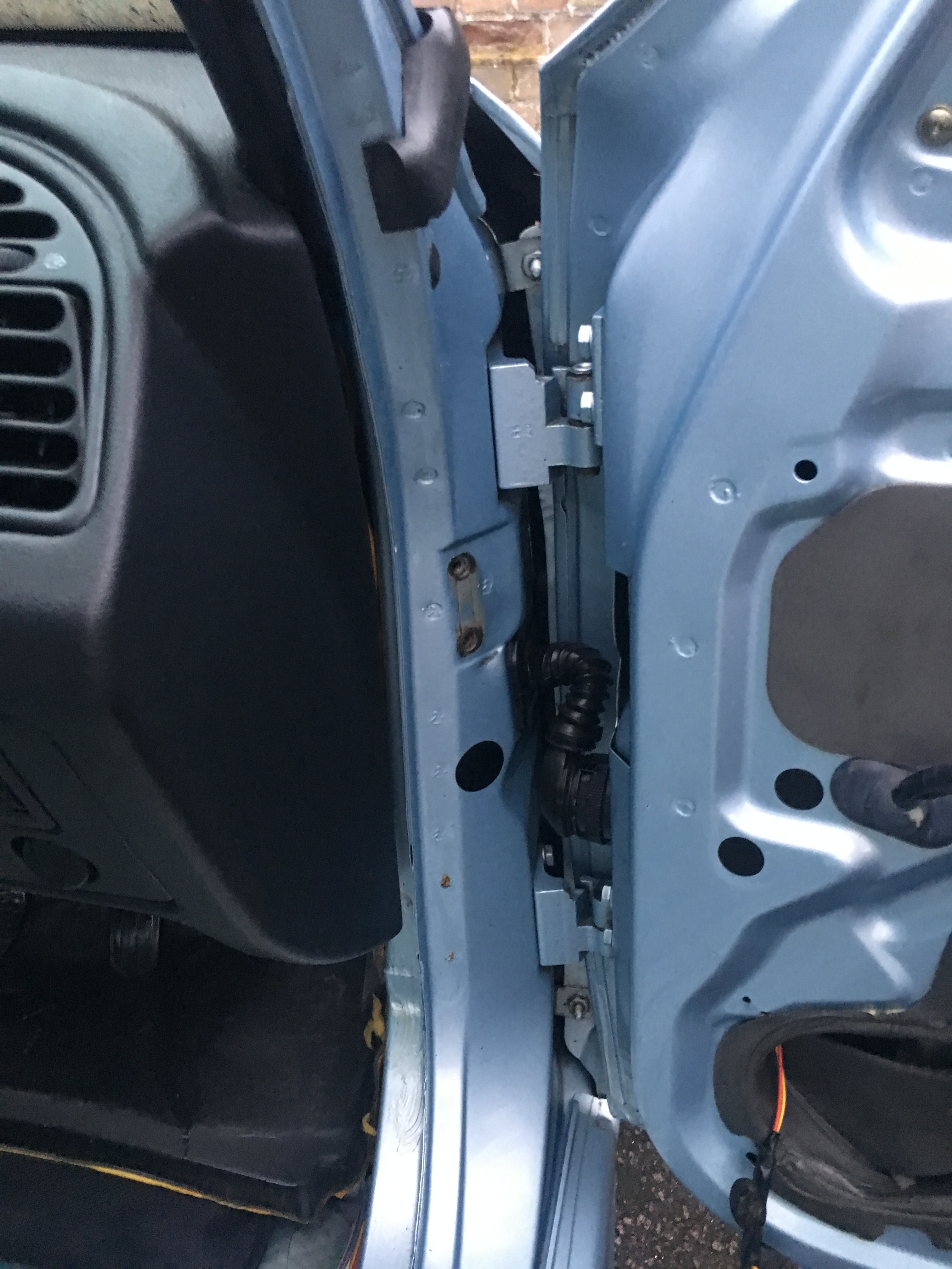

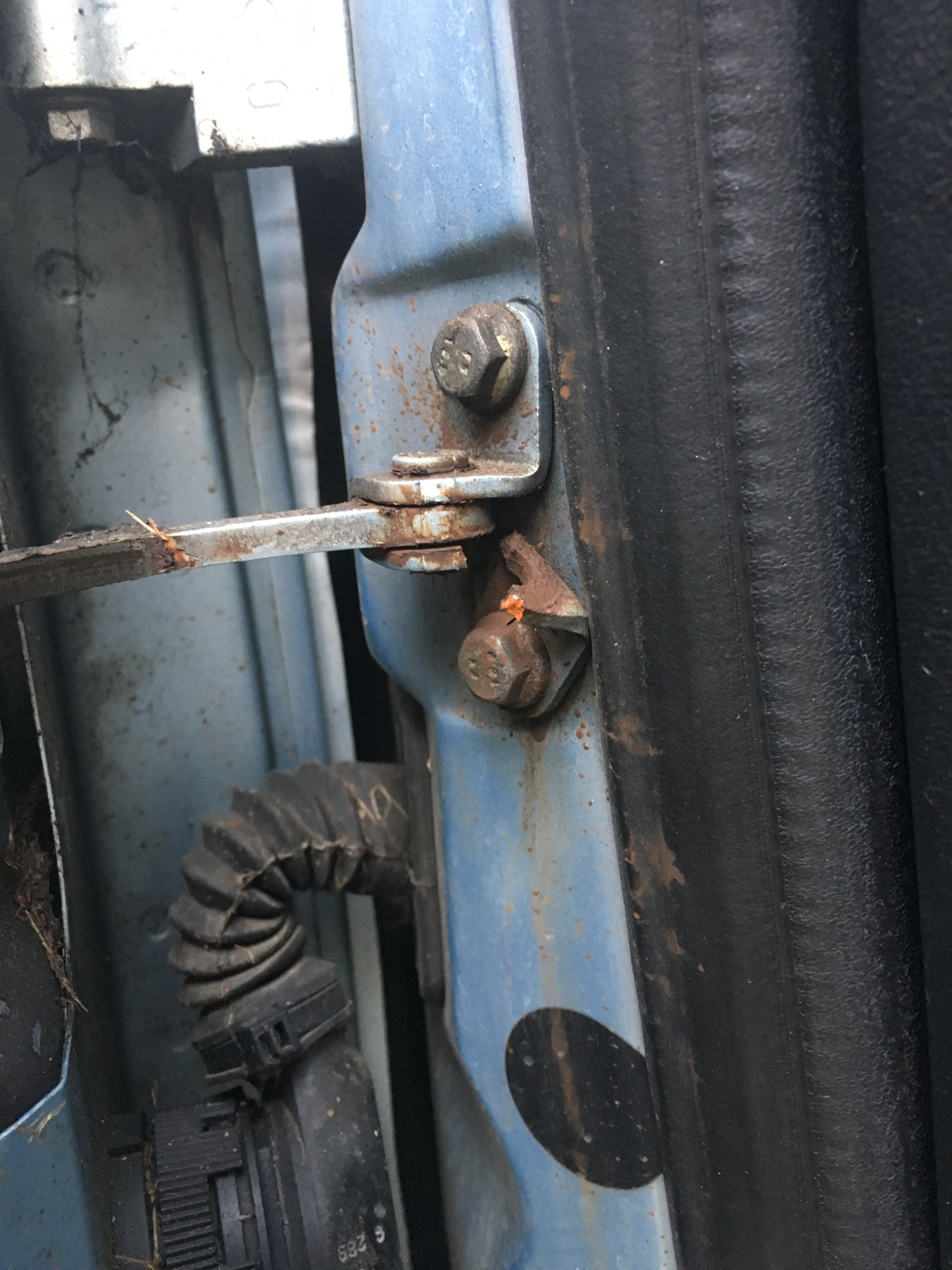

Couple of pics of the door jamb before as it was in a filthy state, me brushing out the vents using Aerospace 303 protectant and the door panel which I cleaned up using APC and Autoglym Quick Detailer which has given it a nice shine (only to be covered up by the door cards eventually!).
The boot has cleaned up nicely but the back of it is still really dirty inside so I am going to try and source some trim to cover this up as I have seen that Meridians have this trim.  Let me know if anyone has some?

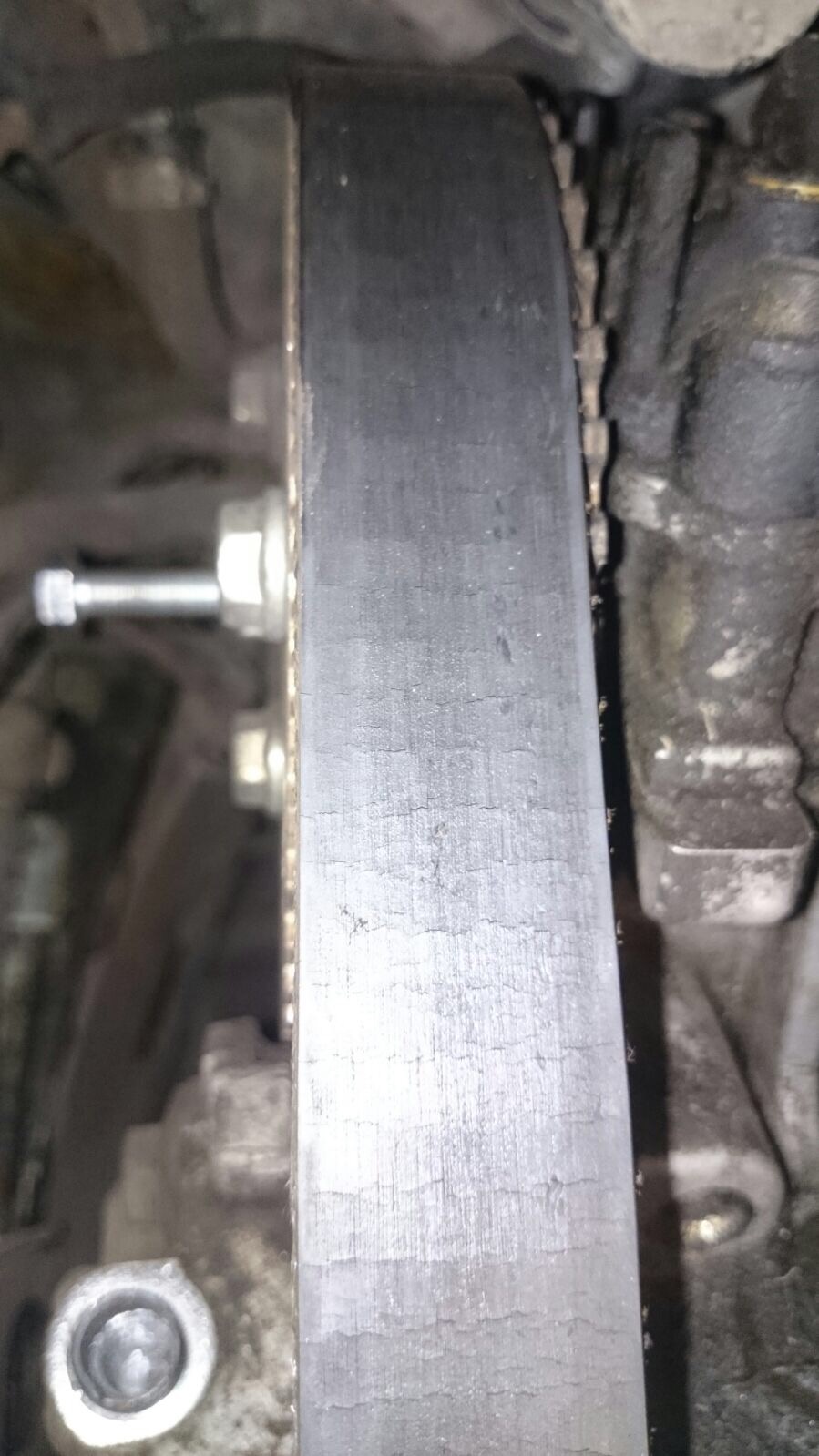

Halfway through the job Alex sent me a picture of the existing belt...looks like I got away with it!!

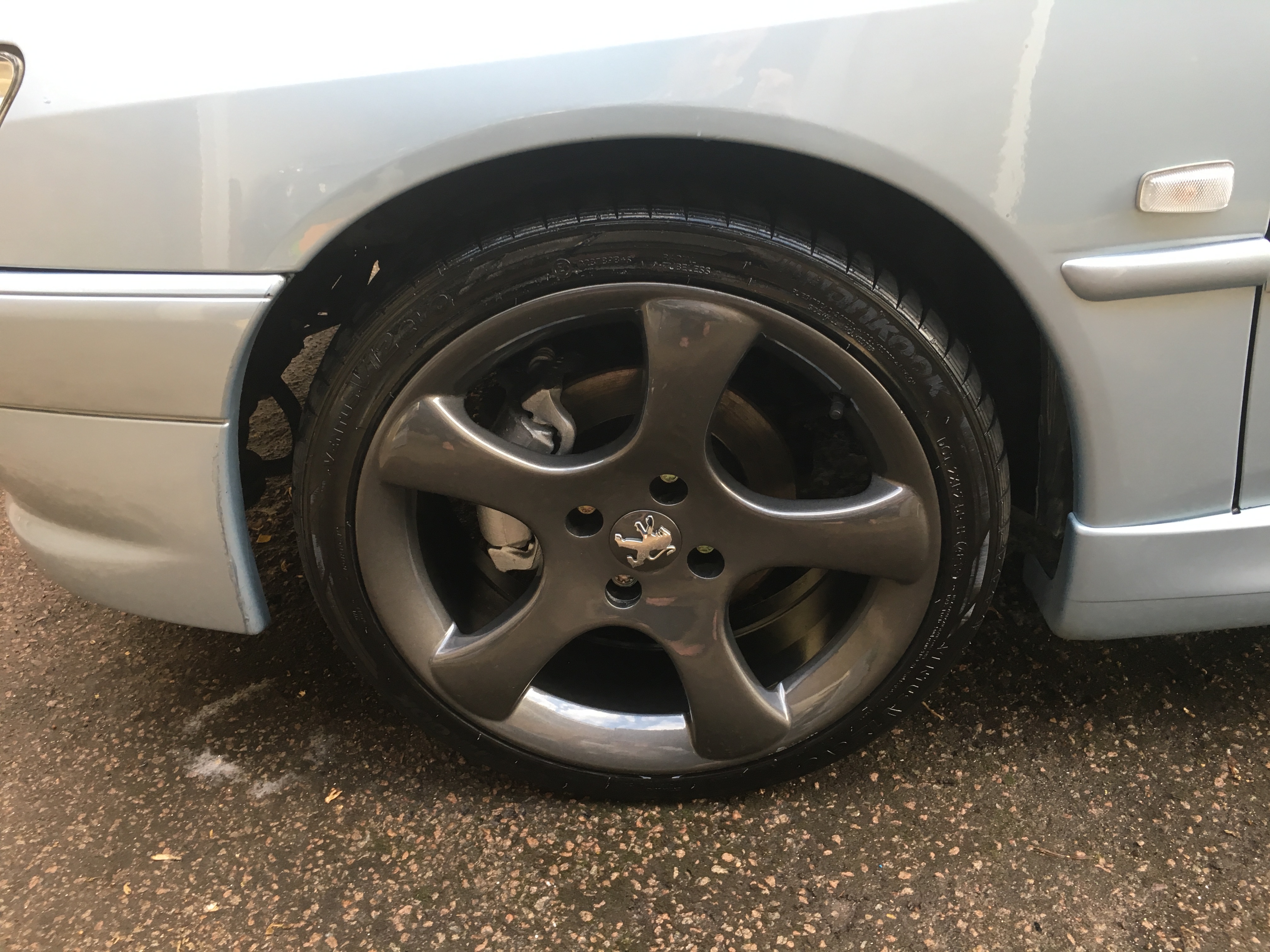

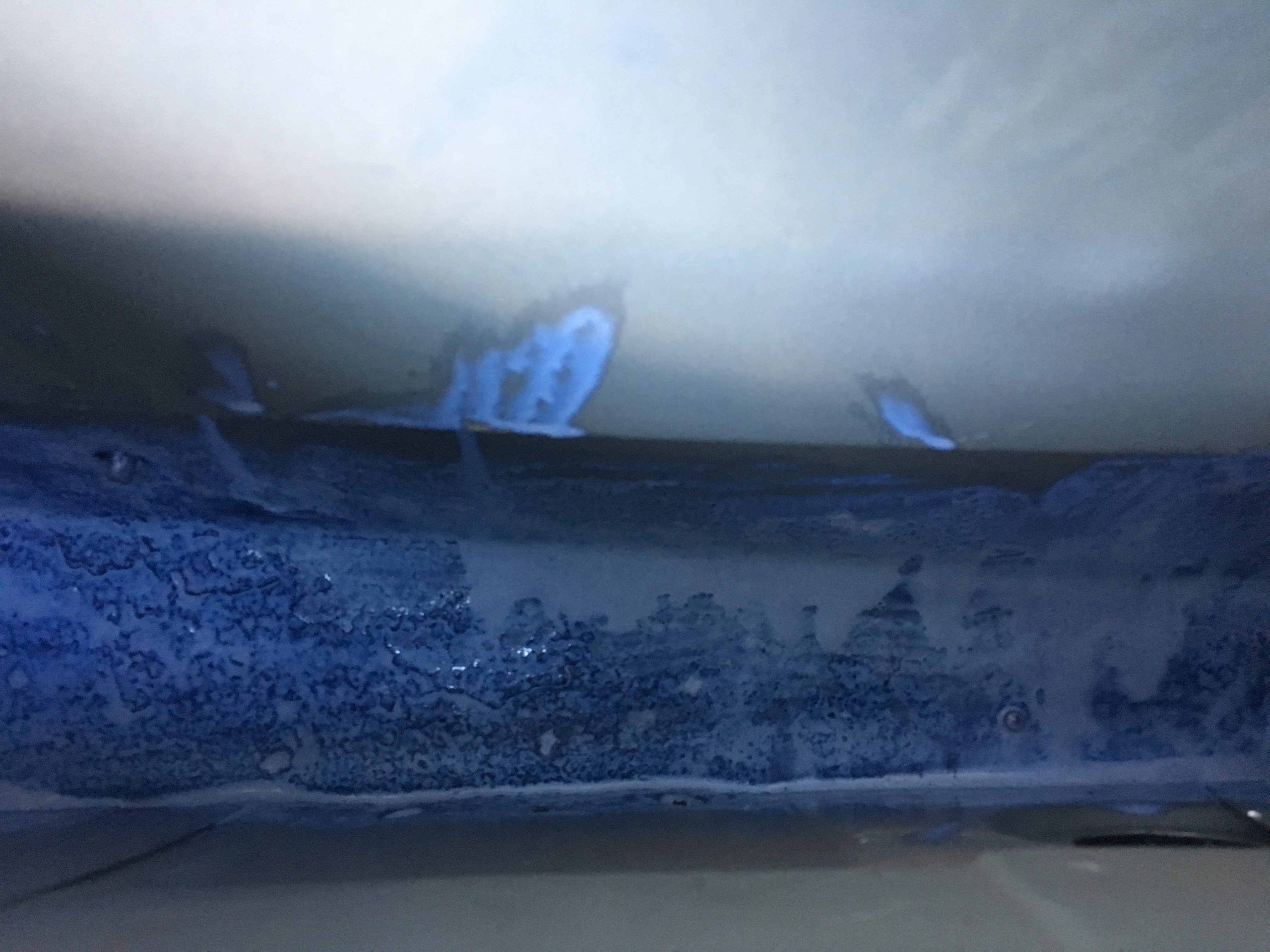

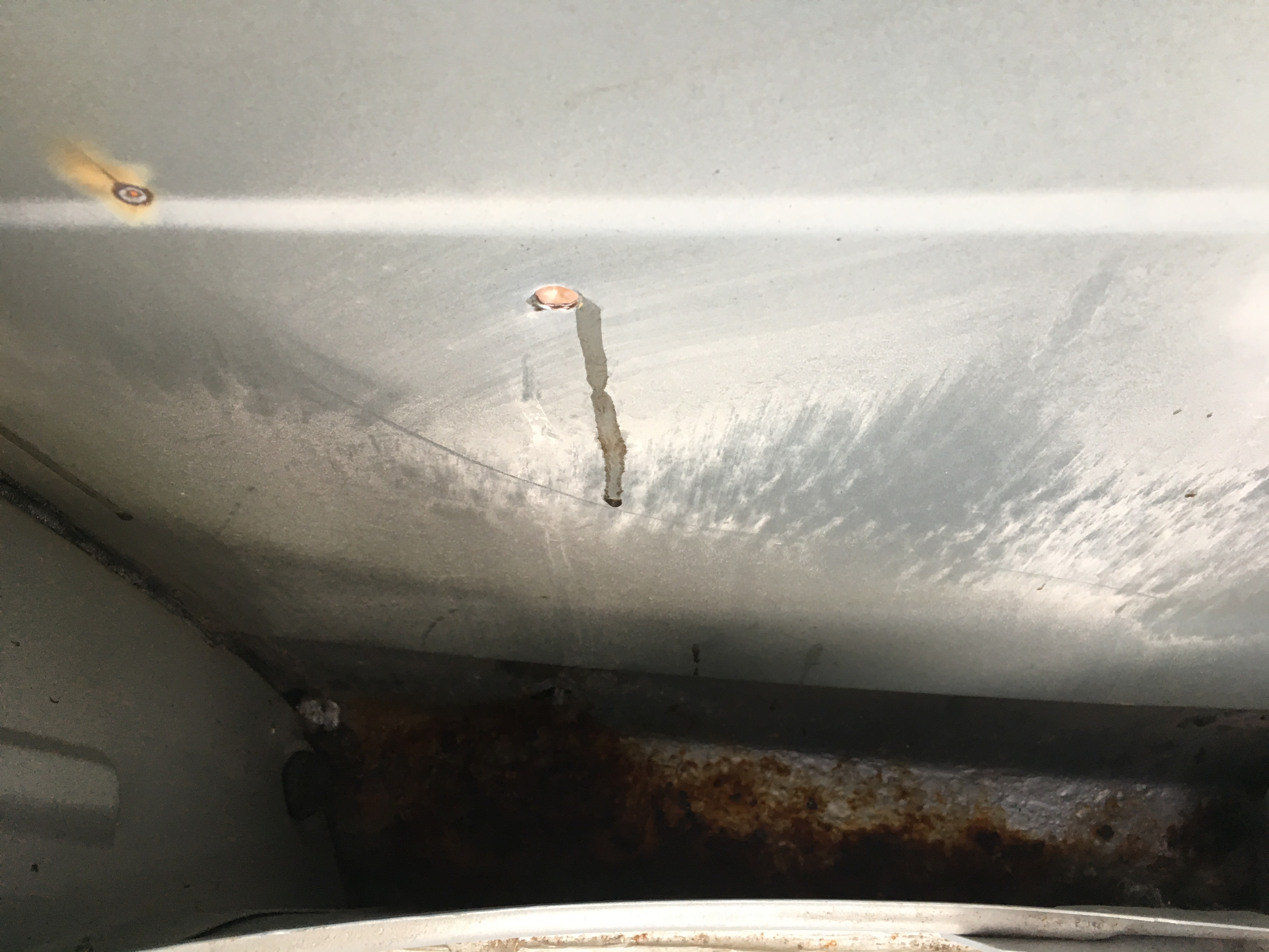

When I got the car back home I started to attack the rust in the arches.  It turns out that the offset colour in the pictures was an arch repair but the welds look neat and it is a decent job.  The colour difference of the rear wing isn't all that noticeable except in certain lights/angles and I plan to address it further by machine polishing and detailing the car so the end finish will make it look even less so.  Still, it was a £350 car so as I said I can't complain!

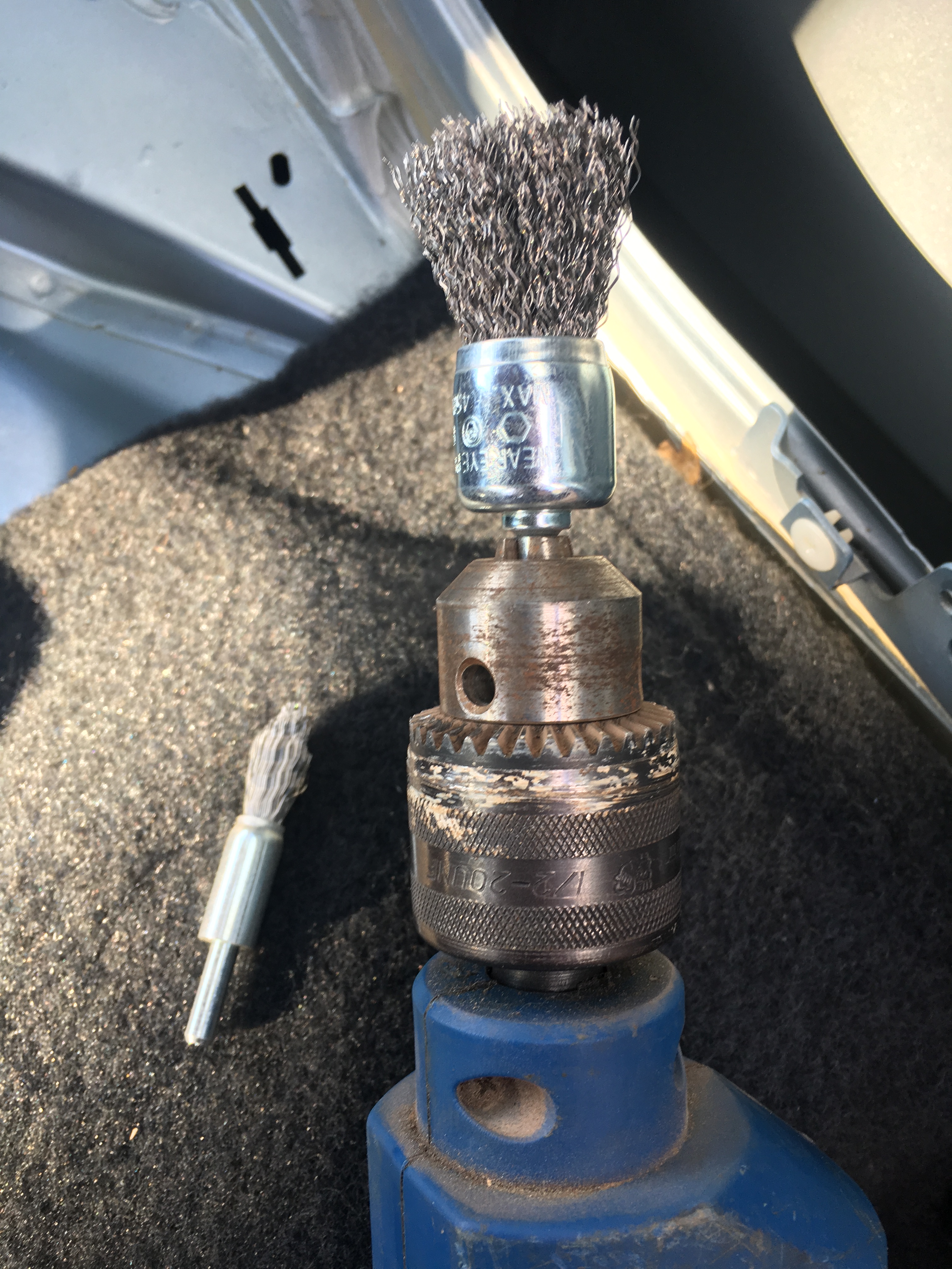

I used a trusty wire brush attachment and took the rust back to bare metal

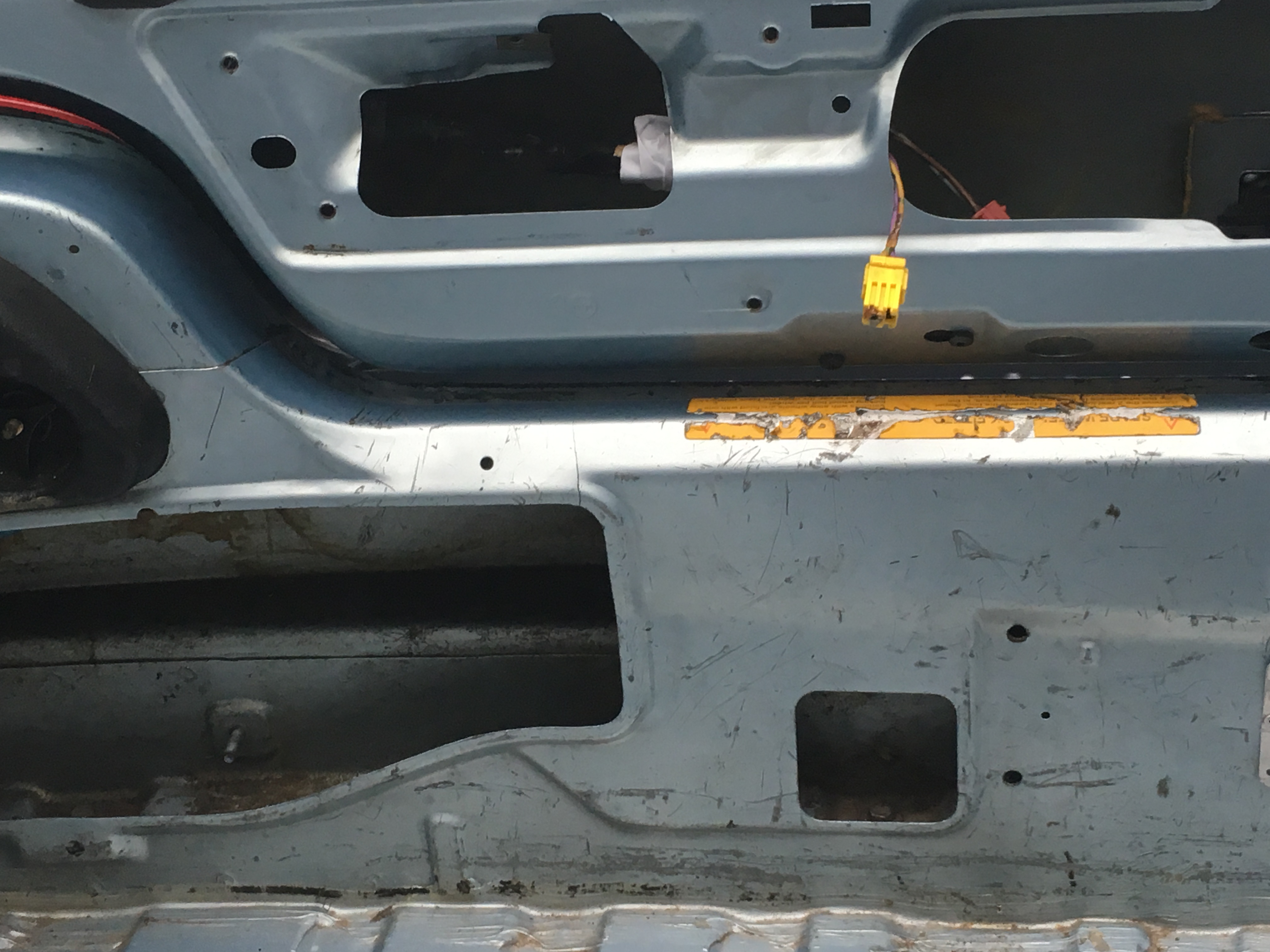

Once that was done I applied Bilt Hamber Hydrate 80 and left it for a couple of days until it did it's thing.
Freshly applied...it turns darker purple and converts the rust after 24 hours..
Once the hydrate had converted the rust I applied Bilt Hamber Dynax S50 into the cavities to hopefully stop the rust coming back.  After that had settled I had bought some silent coat to start the sound deadening process ready for a new ICE install.
Silent coat is amazing, the tinny sound you get from tapping the wing is now a dull thud and it makes the car sound smoother on the road.  I used 2mm sheets and applied it to the inner arches and rear sections of the boot.  I plan to source more to do the doors, boot, roof and behind the dash.

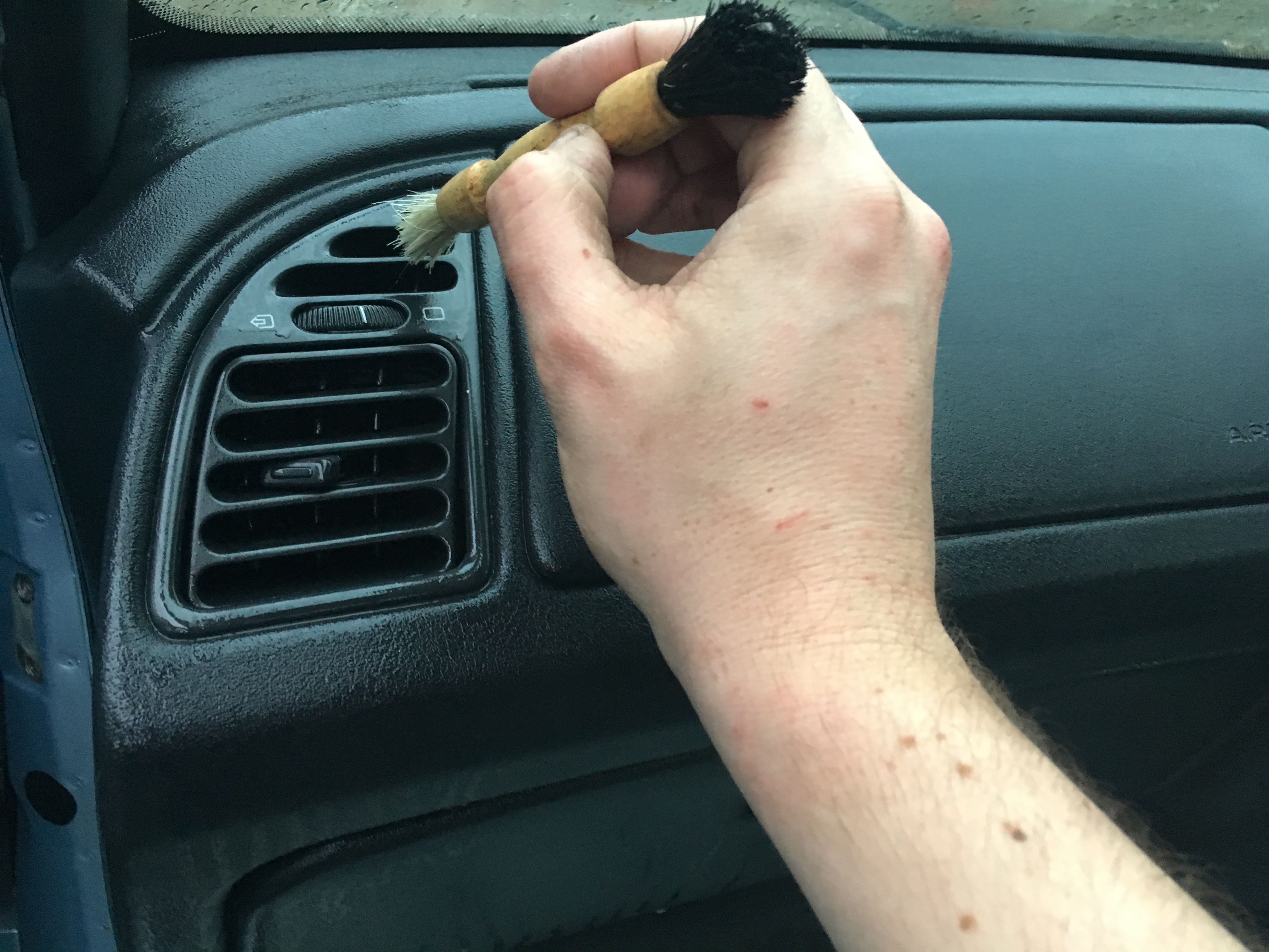

Before I started I cleaned all the plastic interior trim with AutoGlym Vinyl and Rubber care (I was even able to clean through the vents using a microfibre).

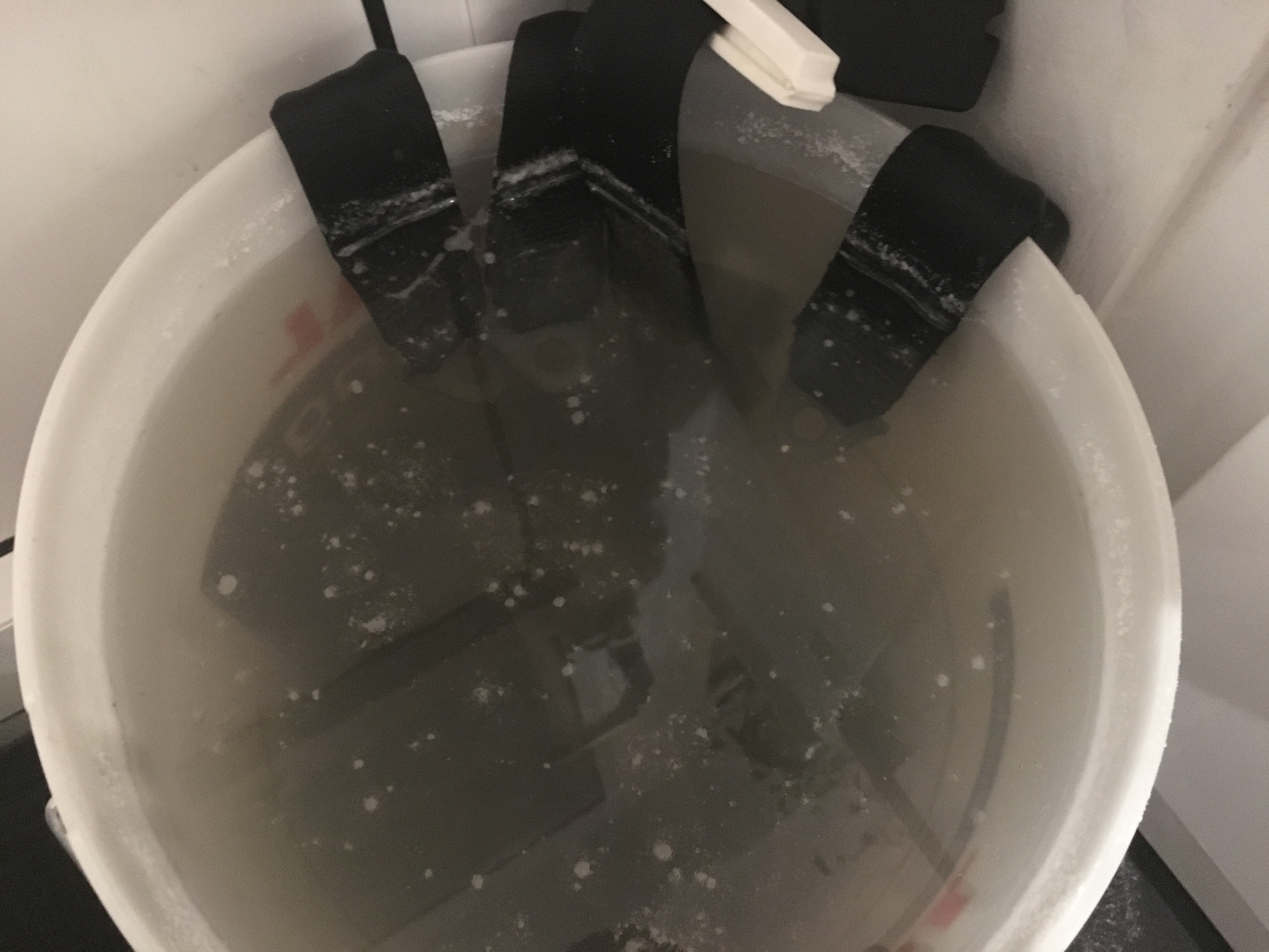

And I let the seatbelts rinse in a soap solution overnight - it made quite a difference

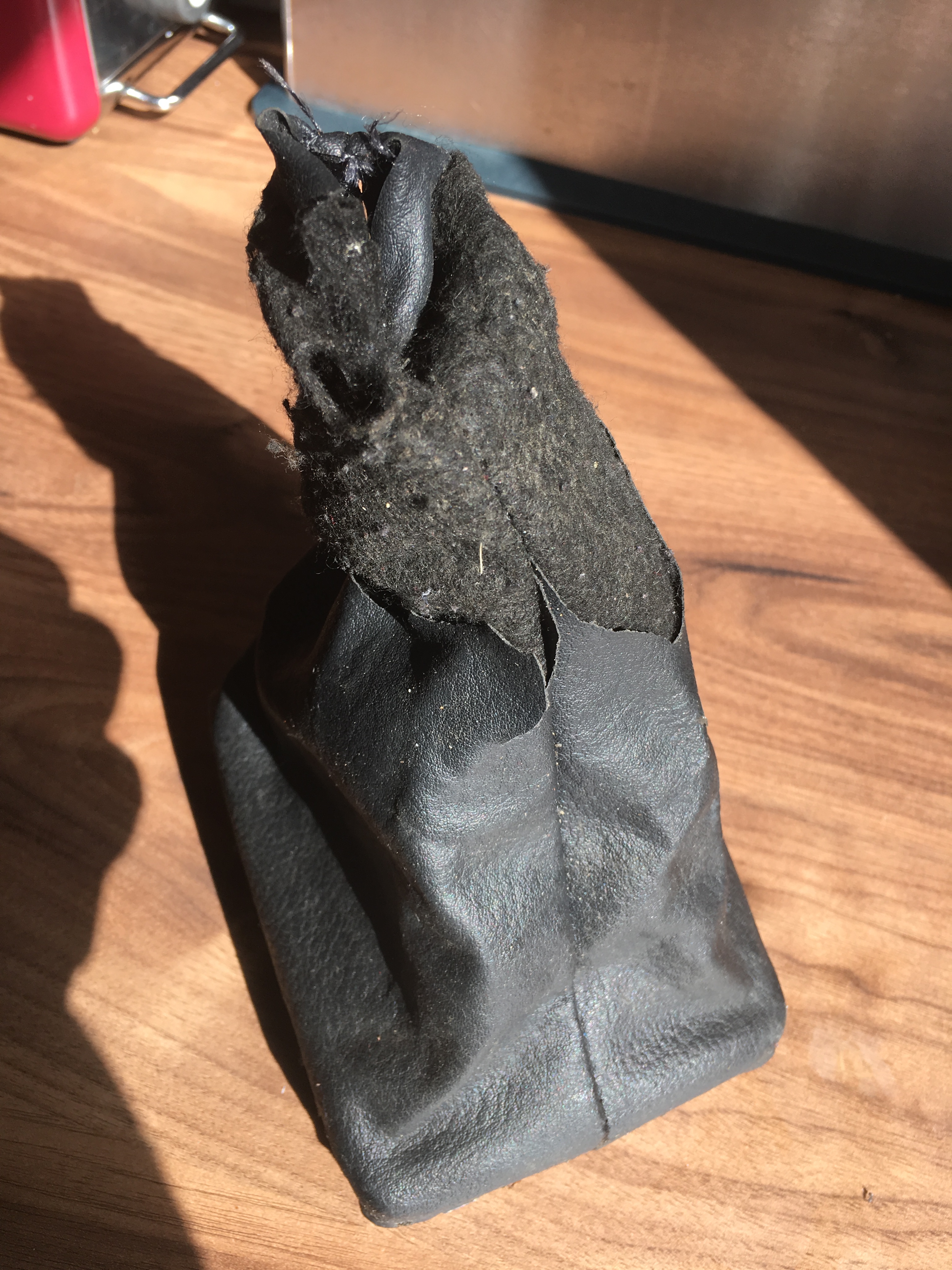

I also did a few little tidy up jobs like the gear lever gaiter which had seen better days..

I couldn't identify what this wire was for - anyone know?  My guess is it is for a CD changer in the boot?  I just cable tied it up and shoved it into the console in case it turns out to be important later on.
The boot had a load of yellow glue on it where I pulled off the dank thin carpet, so I got busy with the white spirit.  The wires were all burnt out but that was next up on my list.
After much rubbing and still a little bit left in the corner to do another day.

When I took out the interior paneling I came across some burnt out wiring in the rear of the car so I ended up taking some advice from my neighbour who is an electrician and cut out the burnt wire replacing it with new wiring.

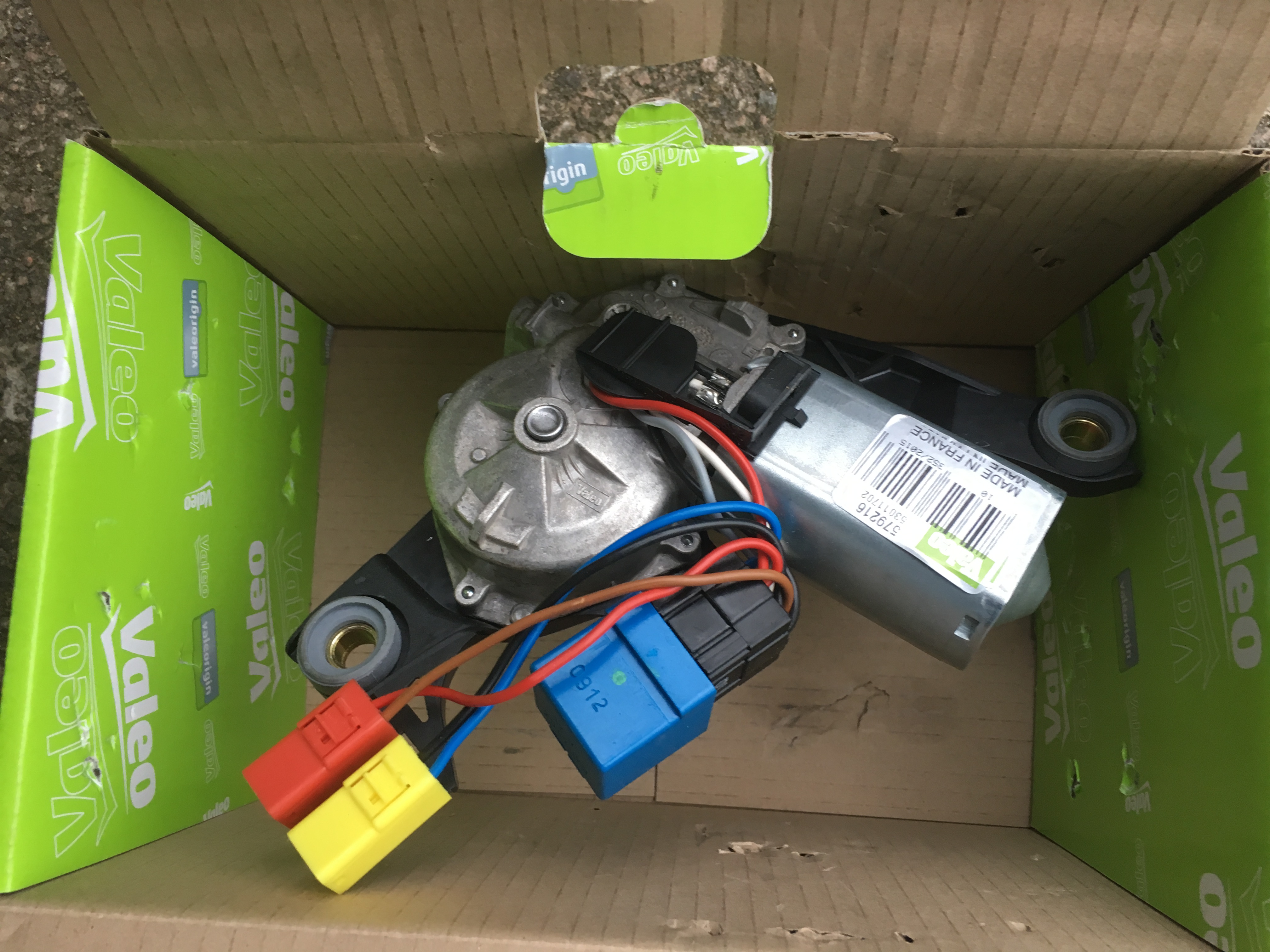

There were more burnt out wires in the boot and the rear wiper had been removed and blanked off so I performed a similar task by cutting back the burnt wire and splicing it in using plastic wire connectors and a couple of blocks.  It was a right mess to start with and the last two wires were stripped completely bare of their casings so I wrapped them in electrical tape and basically took a guess at which one was which when reconnecting them to the new wiper motor unit I'd sourced.
Once I'd connected it all up I turned the ignition on and tentatively flipped the rear wiper switch.  There was a short delay and then the wiper started working...cue me fist pumping the air!! Rofl  It even seems to have made the passenger side electric window work again (although that could be coincidence).
I finished off the evening by adding in some rear boot trim that I had taken from a gti6 which made the boot look much neater.  I removed the warning sticker with some white spirit after this pic.
Whilst I had the interior out and drying I cleaned up all the door jambs and shuts and other little areas like the fuel filler properly.  The door hinges were both broken when I got the car and they didn;t look like the best design to start with so I sourced a new set plus pins from Peugeot and had them shotblasted and zinc plated together with a new set of alloy wheel bolts as I'd done this on my Clio and they look nice and withstand the elements better.

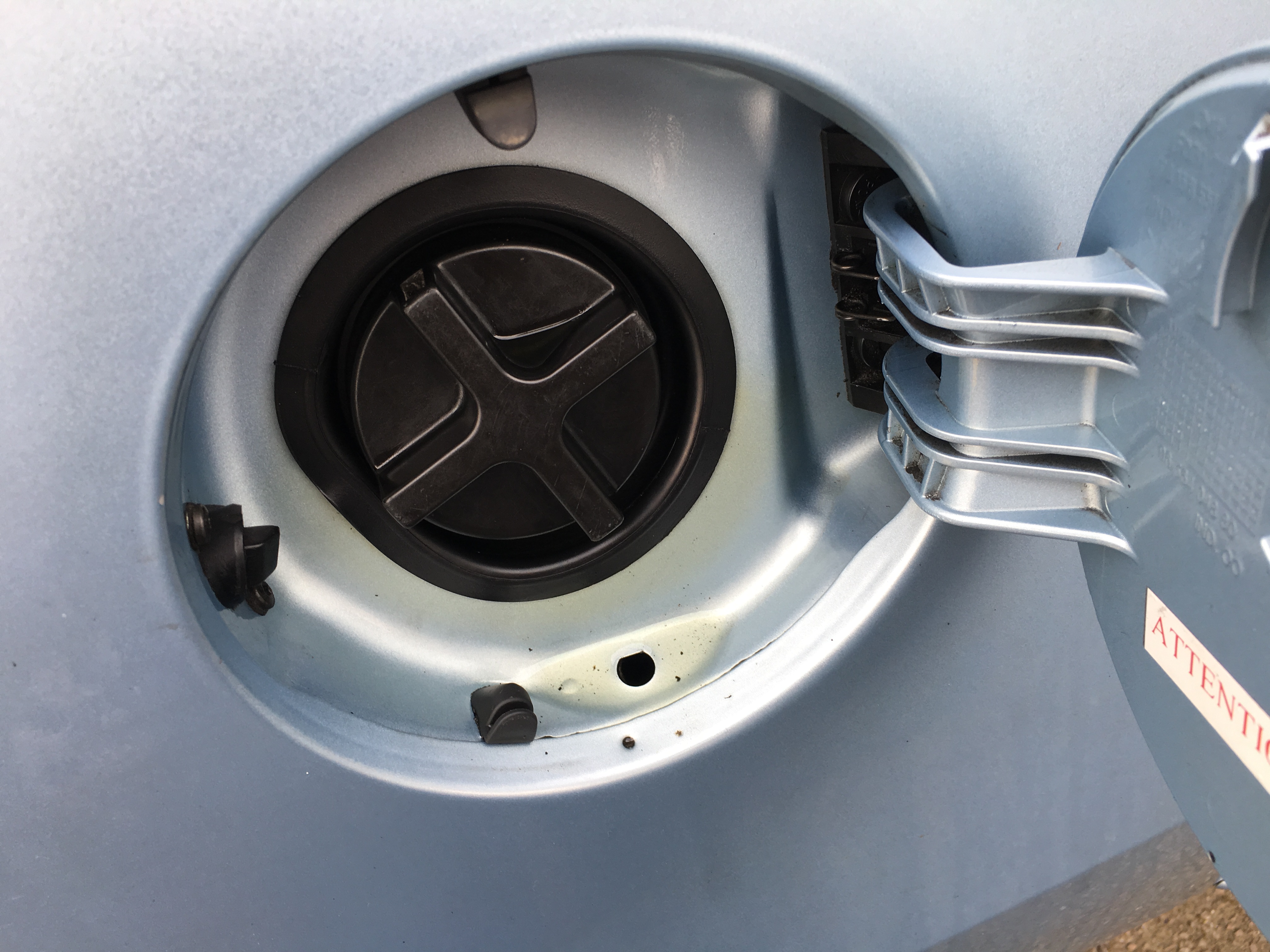

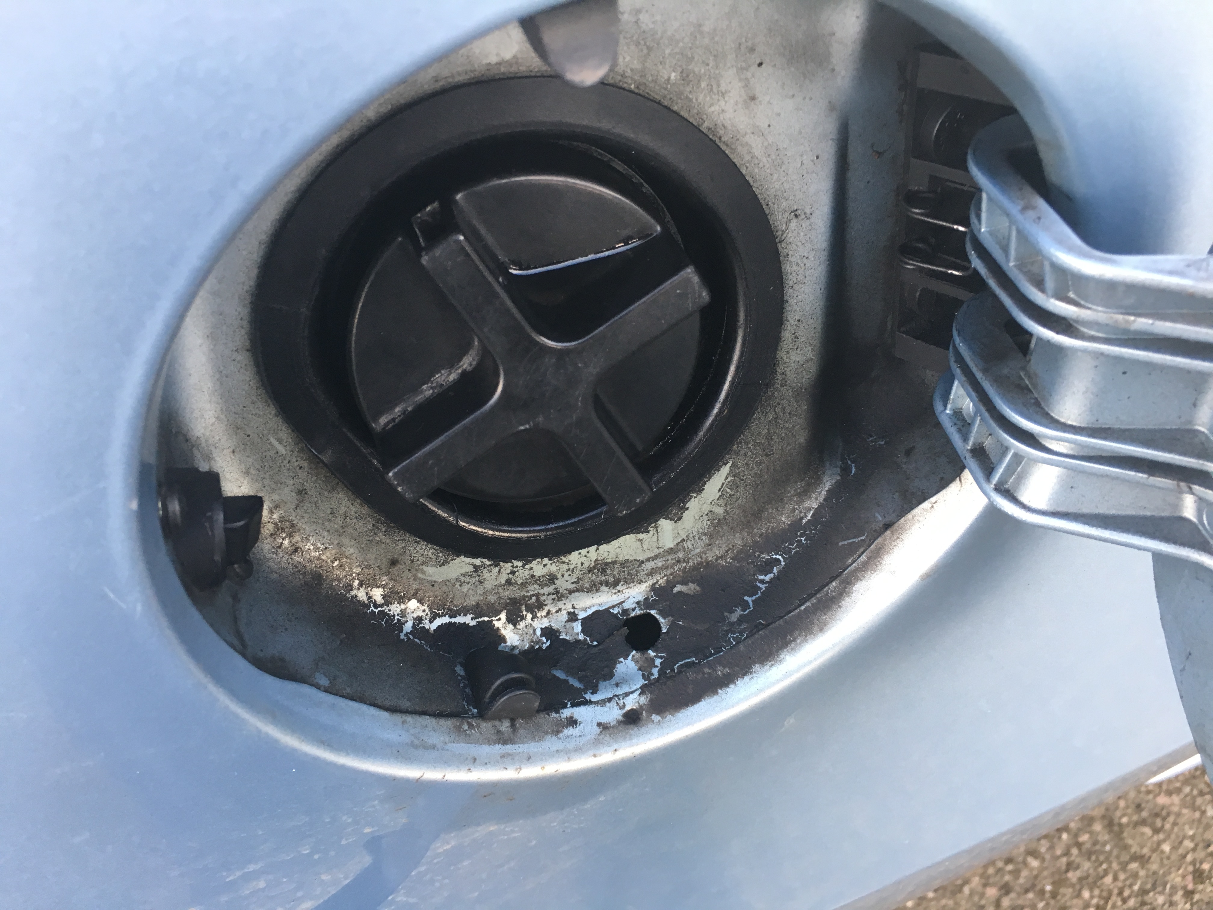

The fuel cap had accumulated a lot of crap over the years..
After going at it with a toothbrush and some solvent..

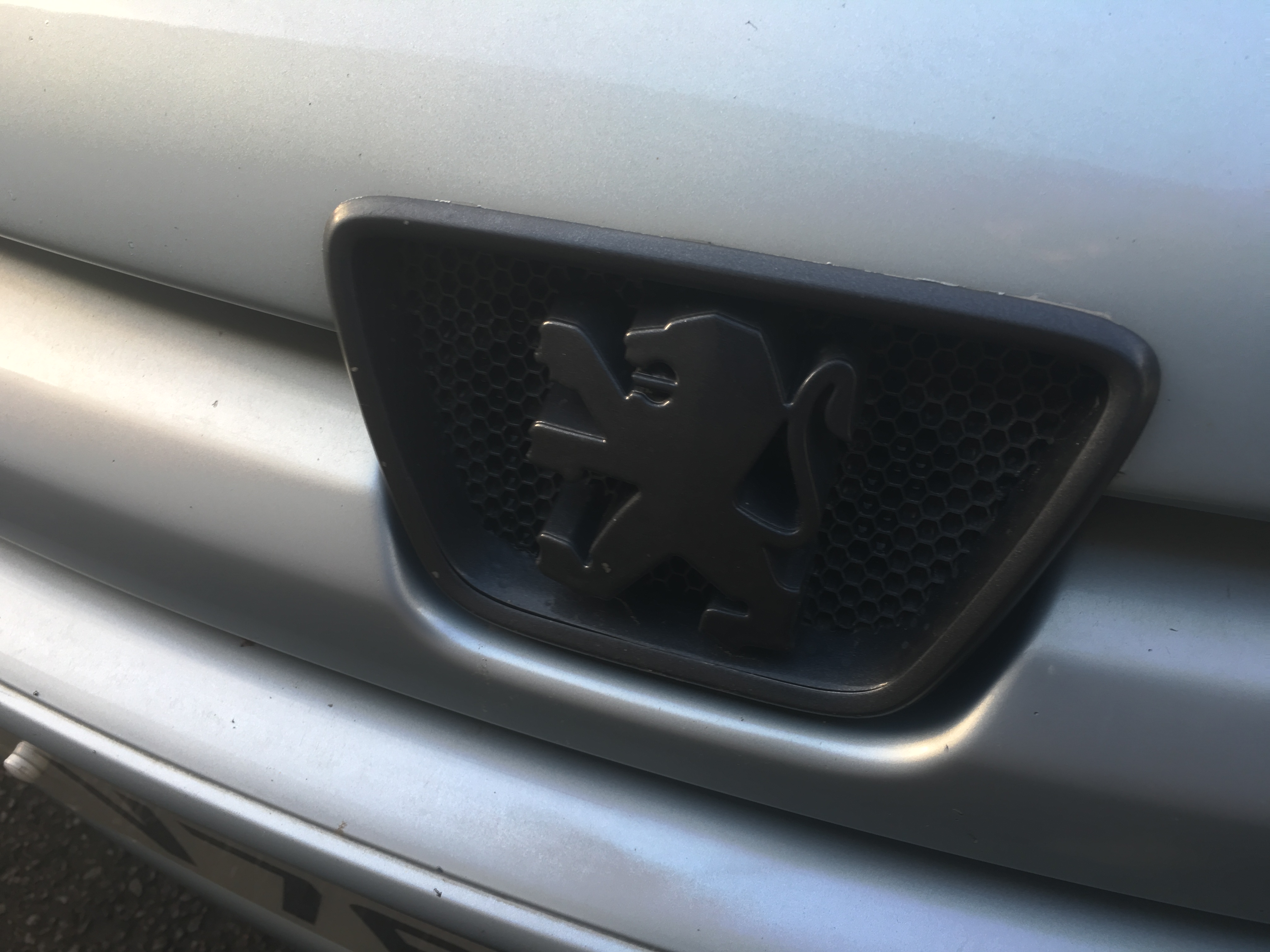

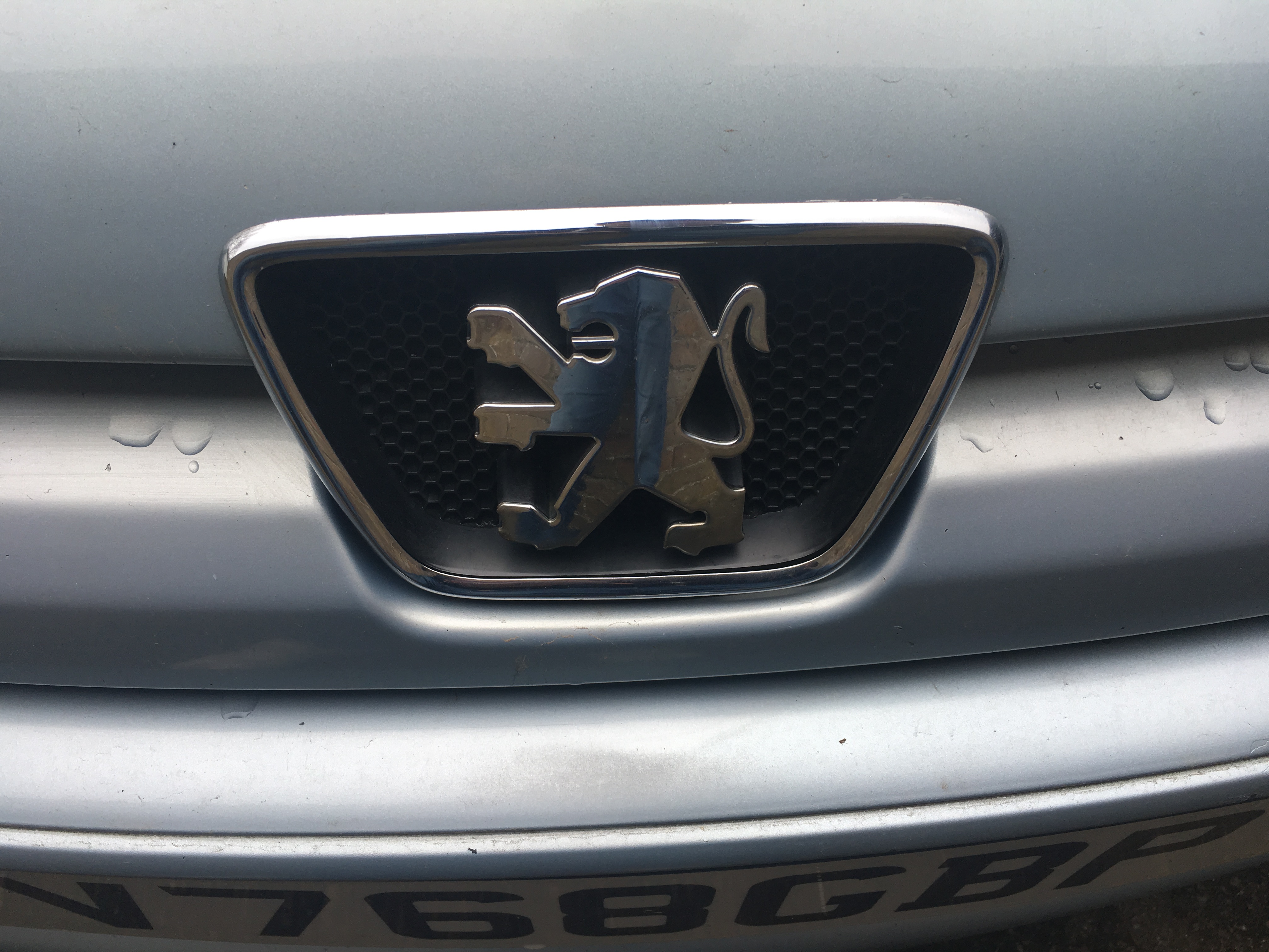

Lastly I swapped over the blacked out lion with a replacement sourced from ebay to make the car look a little more OEM..
Pretty much since I'd bought the car I'd been on the lookout for some decent gti6 leather/alcantara seats to replace the smelly ripped seats that the car came with.  I managed to find a seller on the gti6 forum and turned up to find he had about five gti6's on his drive so I left with a rear bench and three front seats as the plan is to swap the bases/backs over on the driver's side so I end up with a seat that has no wear.  The seats had accumulated some mould so I attacked them with some all purpose cleaner followed by using a clothing de-bobbling machine to get the alcantara looking nice then treated the leather with leather cleaner followed by leather care cream.  I left the seats in the car overnight with some large silica bags to absorb any moisture from them.  I plan to get some black leather paint to get the cracked leather parts looking good again.  Anyway, after a good clean they were much better than the old seats and they came out of a phase 3 so the side airbags were just plug and play.
Old seat
New seats on arrival
190k Moonstone 3dr HDI sold
There's still a rip in the driver's seat bolster but when I get the time I will strip down the spare seat I have and replace this.  They are much nicer to look at on the whole and I will hopefully get some door cards to match at a later stage.

The paint was looking pretty dull and flat before I started.
I started by washing it with Meguiar's NXT car wash which made it look a lot better.
I then removed all the door strips and used a DA machine polisher to get rid of the worst marks on the car - like this scuff which had left white paint on the door.
Part of what let the car down was the alloys, they were flaking really badly from a DIY spray job and each one had a different brand of budget tyre on.  One tyre was completely bald meaning I had to put a steelie on just to get it home.
Before I even sourced the car I had manged to acquire a set of Wheelmania Lions from a user on the gti6 forum.  These wheels seem to divide opinion but I really like the OEM look they give the car whilst providing a bit more to fill the arches than the 15" cyclones.  Anyway, when swapping the rims over I decided to paint the calipers in hammerite smooth silver.
After washing, decontaminating, hand-polishing and sealing the car I was pretty pleased with the difference.
Before (I have no idea why the steelie was covered in red paint).
After shots...
And that's pretty much where I am up to.  I've actually changed my mind about how much work to put into it because I have really enjoyed working on it so much and it's been rewarding fixing things and learning as I go so when I get a bit more time I plan to do a full machine polish, tidy up the engine bay and continue the soundproofing in advance of adding a nice stereo setup for the daily commute.
Hope it wasn't too dull a read and all comments welcome  Smile

The only advice I could give is that it might be worth using some cable sleeving or heat shrink instead of electrical tape. The reason being that the tape can start coming undone when the glue softens on hot days and can leave the cable at risk of shorting again.
I'm taking the radio out in a could of days so I can get some photos of the loom then for you.
