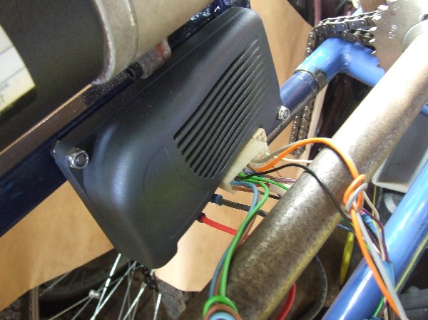

big progress today Big Grin
Ive had it running on the stands in the garage
video to follow heres some more pictures
been wiring in the essentials today like master kill switch and battery lines
still not quite sure where I'm putting the battery's yet cause i need to source a seat i can fit into Smile
[Image: DSCF0123.jpg]
temperary battery's notice the fuse at the terminal for protection Wink
[Image: DSCF0124.jpg]

ha just found out why the battery monitor dont work it needs a 3rd wire connecting not just two
online instruction manuals are good Wink

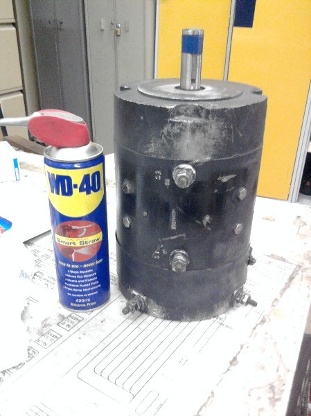

#80
well heads up guys stage two Kart Boost has started!
went on a little trip to bristol today to pick up some parts
new motor and speed controller
and its a beast! :drool:
this upgade is potentaly easyer than the first build but it probably wont work like that!
heres some pictures
1st is of the motor and size.

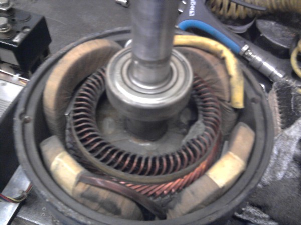

2nd is of the internal windings of the motor,
it looks to be wound from copper bar not wire!

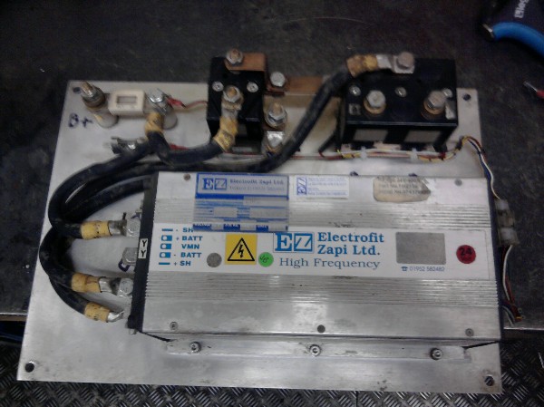

3rd is the speed controller ,
the top left white square is a 350Amp fuse!

Connor Wrote:Should have said you were up this way, where abouts did you go?
went to
Oldbury on Severn,Thornbury, Bristol
to a company called Electrocare, they look after our electric tow tractors in work
After talking to the boss he came forward with some favable parts at a good price !

just been informed the motor i have got is 6.5Hp or 8.6Kw
should haul my fat ass around lmao
