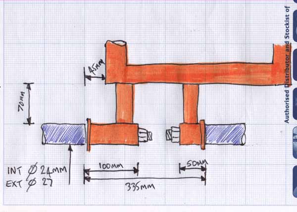

been and measured up Ive got to make a swivelling motor mount bracket so i can tension the chains
so Ive come up with this
the blue bits are existing frame hollow tube on the cart
the top orange u Ive made which mounts the motor, now Ive got to fabricate the lower fixing swivel
then just join the two

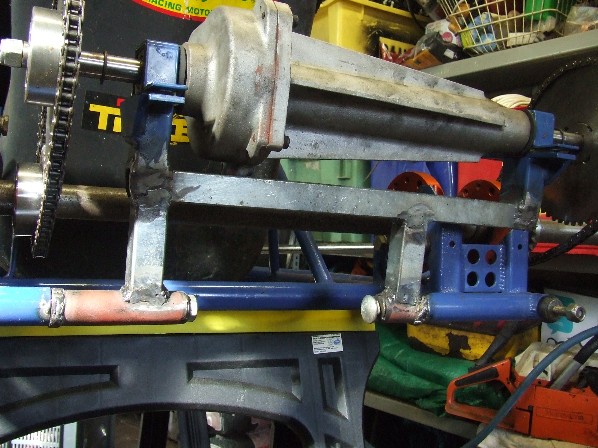

motor mount is comeing along well
hope it looks like the drawing Wink
#46
quick update
motor gearbox drive sprockets and chains are all fitted
have connected it to a battery and it runs Smile
now to mount the motor controls batterys speed controllers and throttle linkage

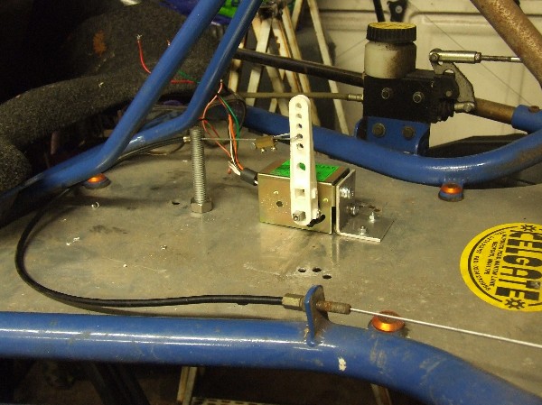

but have managed to sort the throttle control linkage and pedal

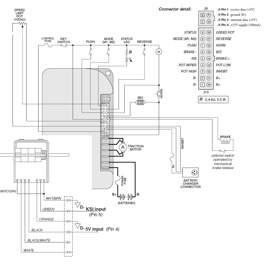

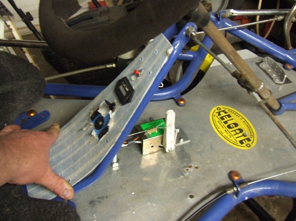

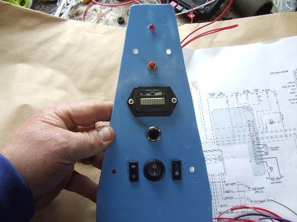

pictures of dash and throttle controller
the throttle controller works on a 0volt to 5 volt signal 0v is off 5v is full throttle this unit talks to the motor controller which converts the 0-5v to a motor speed

Nice. Im presuming that the throttle controller is incremental? Like its not just on or off right?
The guys at my uni built an electric tt bike and the first time they tested it it was no power, or max power! lol
Im sure you thought of that tho haha

yes the throttle has a programmable ramp so you can alter the speed ramp and the torque curve
but its preset
I'm looking into the software and cables to program it

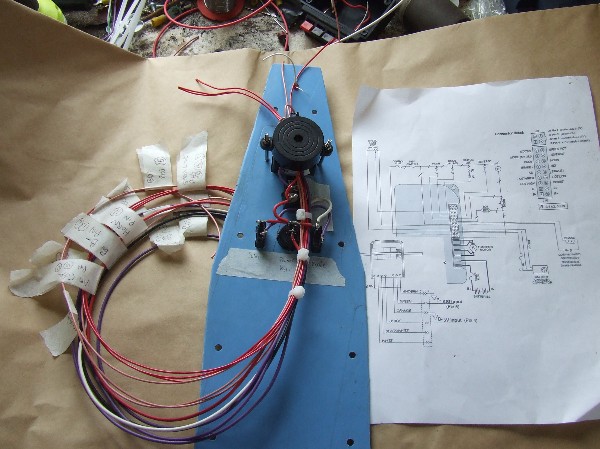

im trying my best to get this done but if it comes to FCS it will stay in the back of the Estate
have been wiring up the control dash
#57
Thats alot of wires
#58
Dum-Dum Wrote:Thats alot of wires
yes and i just relised i dont need half of them Doh
ah well coil them up im sure they will come in handy for any upgrades Smile
