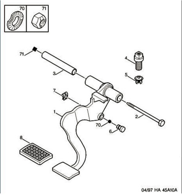

Might someone have the parts diagram for the brake light switch area for a 306 hdi phase 3 please...
Or
Know if the brake light switch fits into a plastic bit that fits into the brake light switch metal bracket...
The brake light switch has a plastic ribbed end, it does not screw into it's holder...
Febi 17217 is the brake light switch part number...
Not sure how helpful this is but that's all there is on Servicebox ...
Thanks given by: pug306driver
That's fantastic, so there is a plastic clip, part 5.
Would you have the pug part number for part 5 please...
4534.12 (retaining clip)
