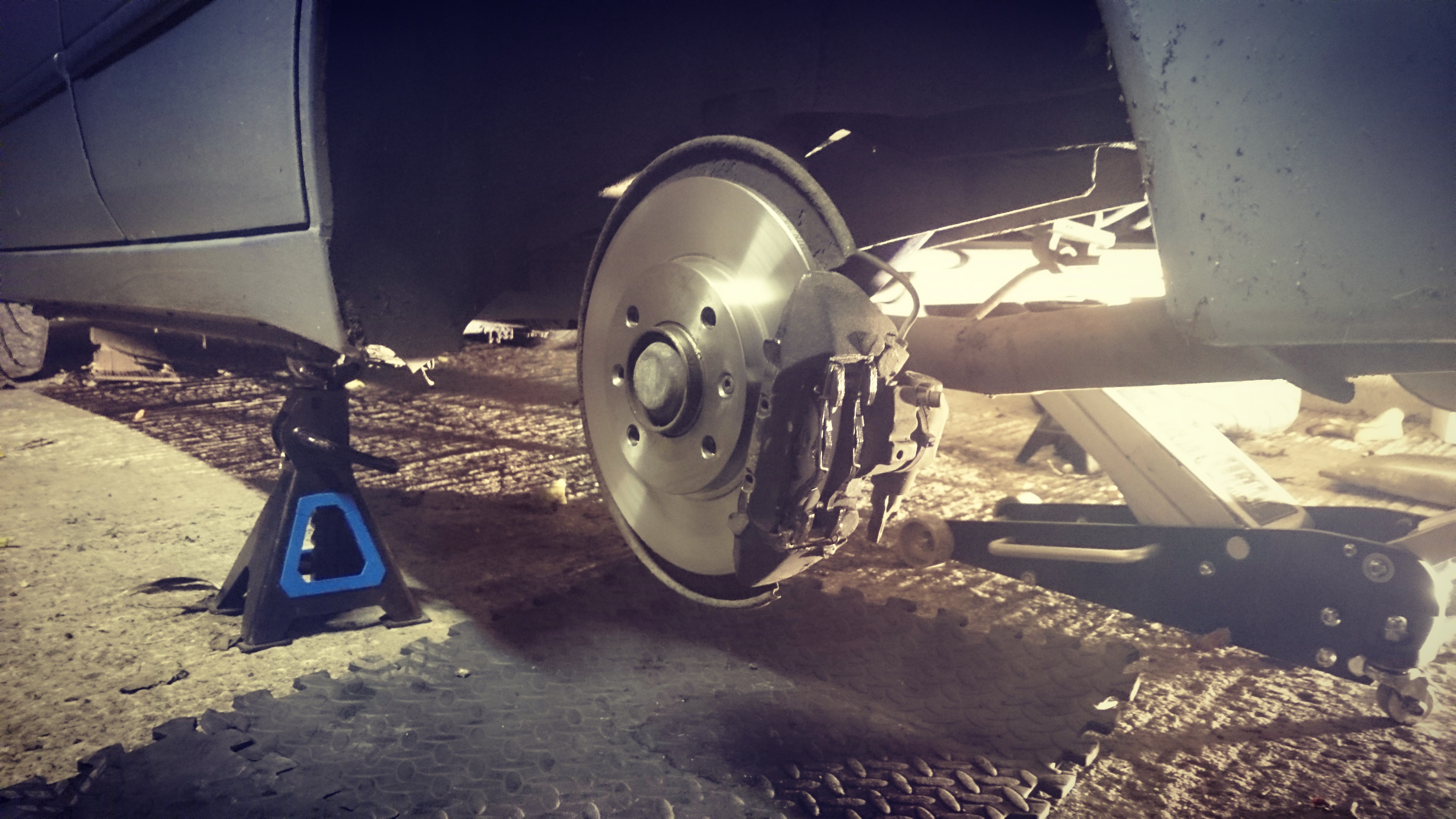

Stripped rear brakes, rebuilt/serviced a spare caliper, fitted new discs/pads. New cables on monday as were out of stock today. Old cables were "ok" but split and felt sticky.

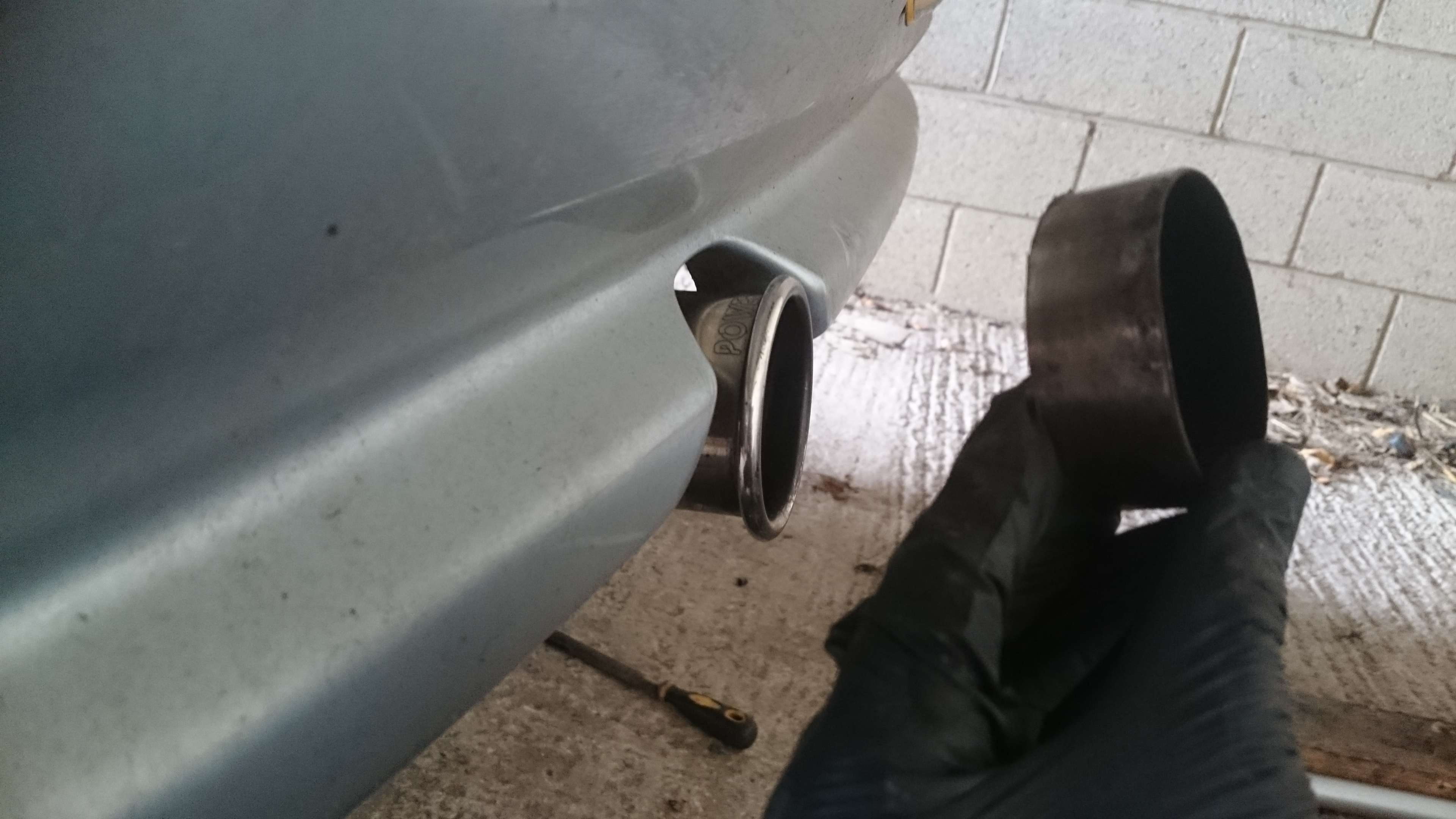

And shortened the exhaust by 20mm at the join from downpipe. Better fitment at rear and when a rubber slipped it had melted the tank a bit  Confused
