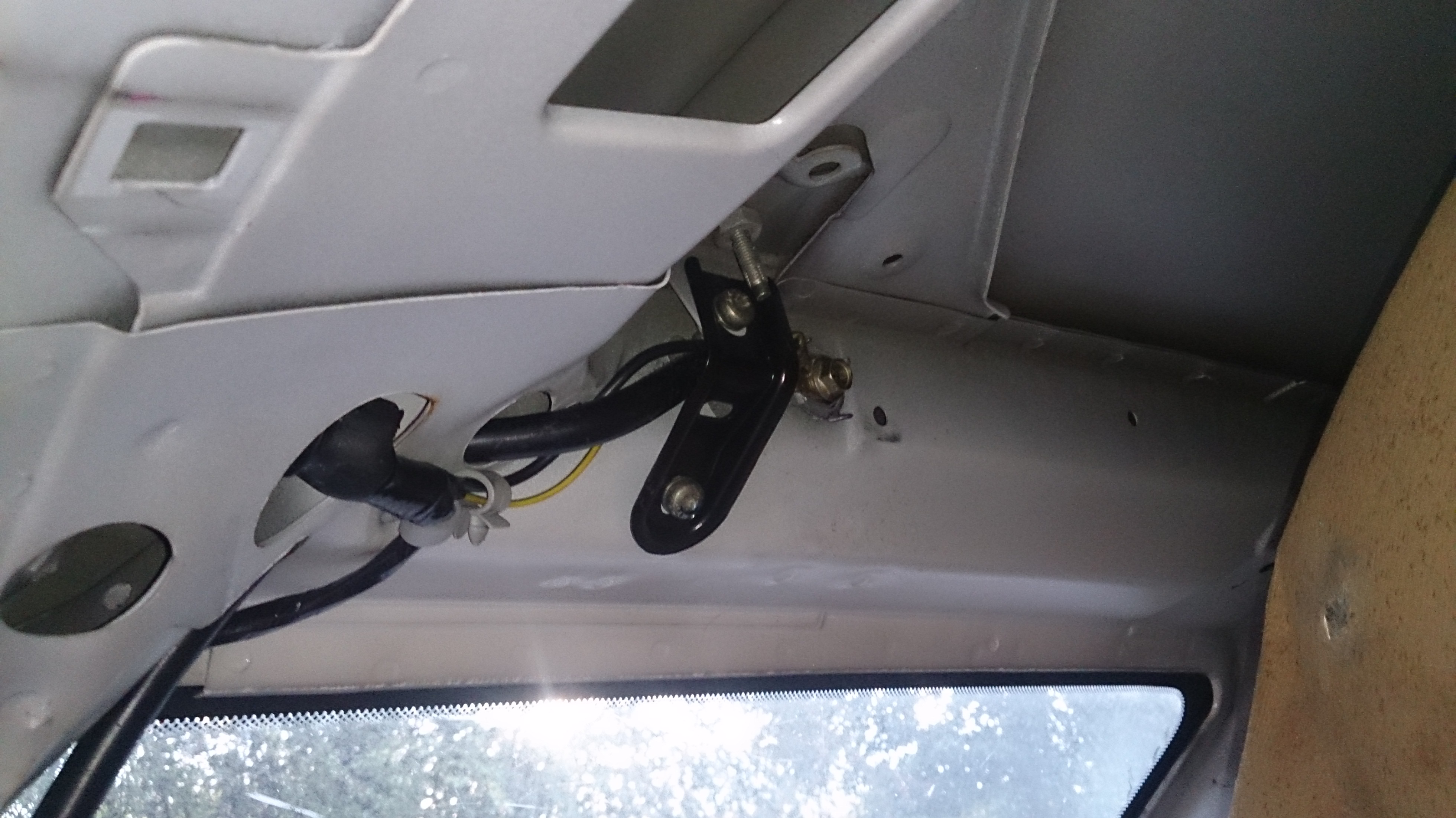

Sorry liturally just seen this. Im earthed under a seat bolt. Found the biggest issue was forgetting to upgrade the engine earth for me

i used a light bolt hole and never had an issue once. ill take a pic when im down workshop next. as long as its clean both ends you should be fine
