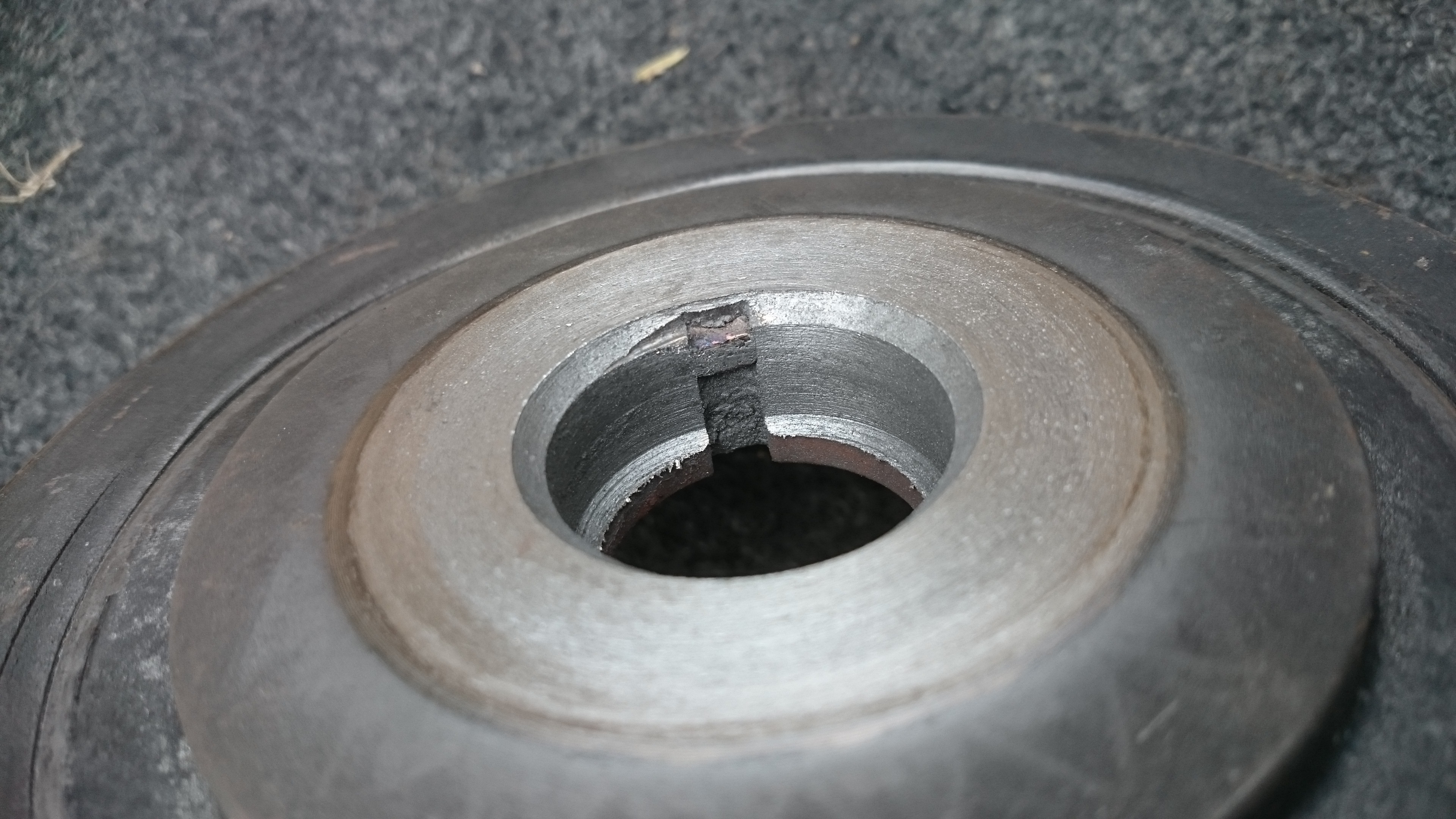

Crank pulley destroyed
Oh. V odd. Its never been off since it was built...
Too much torques!?!?  Confused
I'm not really sure how to fix the issue  Confused
Billet one fit?
fit new key and pulley and bolt, job done.
as long as the crank isn't worn.
See the crank pulley... Woodruff key smashed off in the slot
Weld it on...
Seriously though, I've always thought woodruff keys look a bit small considering the forces that must go through them, not seen that happen before though!
Woodruff keys only locate...its the massive bolt that holds the forces...
Which had come loose...which is odd,because as i say, its not been touched for some time
I may temporarily slam a replacement pulley on there and just threadlock the hell out the bolt and blast it in mega tight
Ah, that makes sense!
Was it a new bolt used? I know they're only meant to be used once even though most of us probably re-use them.
Don't threadlock it in mega-tight, you'll never get it out again. Had a HDi where someone had done that, couldn't budge it with the gun or bar...scrapped the block with the bugger still stuck in eventually lol!

Tom (zxvolc) kindly dropped in a spare xud9 pulley last night...I kept him at a distance to spare him from our germs though... Can't describe how much it pained me to say no to his offer of a passenger seat run in his ZX... Sounded epic as he left though...
But thanks Tom. Found a spare newer crank bolt too...attached to a spare 2.2hdi crank!
So when I'm feeling better than death...will try n sort it
Exact same happened on my 406, just fitted a new pulley making sure that the remains of the key were in line with the slot to allow it to sit flush against the crank sprocket.

Oh and just machine out the keyway and fit a bigger (custom made) woodruff key then nail the whole lot back together.
Well that went well....
1.9 xud pulley does not fit a 2.1!
Shitter mate.
