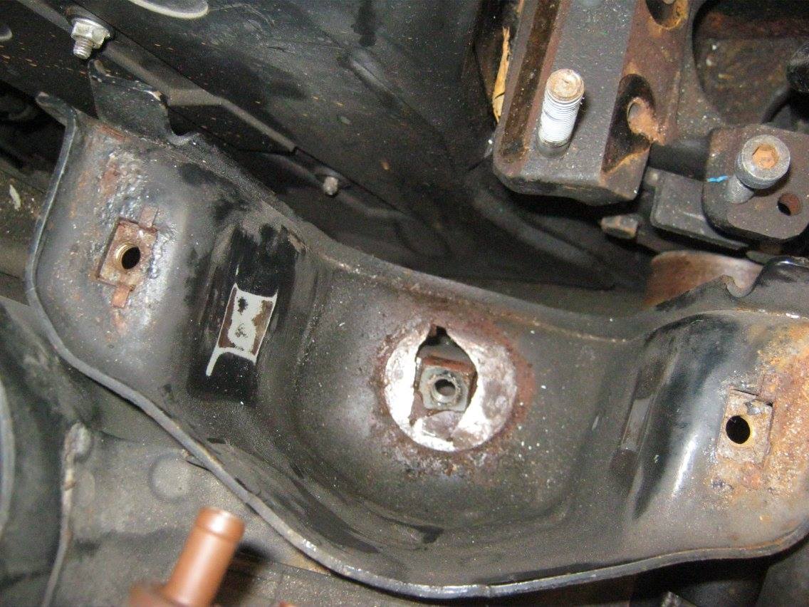

Thats one heck of a rust hole...wonder how that whole "rail" is back there
common as muck now 306's rusting there now lost count the amount ive welded up in my time, some have required subframe out!

With regards to rust, I haven't probed any further as didn't want to further weaken it any closer to the subframe. Hopefully Carl will take a picture for us once it's he's cleaned it up though, see the full extent of the damage!

I have since however been told that the rust on the bulkhead is a fail so that also needs to go on the list. Im waiting for him to have a look at the drivers side when he does the cambelt. If that side needs doing too then it will be an engine out job. Weld, stone chip the engine bay, fit a clutch and lightened fly, fit the seam welded subframe and meyle HD wishbones before putting the engine back in.

Bulkhead rust....
[Image: FB_IMG_1455577059415_zpshdxevmou.jpg]
[Image: FB_IMG_1455577064375_zpsiy46cq7d.jpg]
[Image: FB_IMG_1455659780419_zpslliqrapi.jpg]
Drivers side chassis rust...
[Image: FB_IMG_1455577046005_zpsvtivltlb.jpg]
[Image: FB_IMG_1455659676989_zps8pmomrro.jpg]
[Image: FB_IMG_1455659699090_zpsxfdsvcqt.jpg]
passenger side chassis rust...
[Image: FB_IMG_1455577050812_zpsh4qlw1x0.jpg]
Looks like its coming on well! Smile
I still find it weird how rallyes rust in that place on the bulkhead. You'd think all the cars with the aircon pipes going through there would be more likely to trap water than the rallye bulkhead
Mine is getting crusty there at bulkhead...not a rallye, but ph3. Water just collects there
Yeah I've seen surface rust there on a few ph3s, never seen an actual hole before though. Guess it depends whether they're mostly parked facing up or downhill maybe!
the gti6 i broke had a big hole there Wink

Hm, interesting repair....What happened to the photos between the cutting out, and the random white gloop being applied liberally!? ALso hope more was cut out than pictured, as looking at those chassis rails, they will be fully of rust inside Tongue
[Image: sigi-2.png]
(19-02-2016, 05:15 PM)darrenjlobb Wrote: Hm, interesting repair....What happened to the photos between the cutting out, and the random white gloop being applied liberally!? ALso hope more was cut out than pictured, as looking at those chassis rails, they will be fully of rust inside Tongue
I had been wondering the same tbh...looks like kind of repairs I do on old fords to make em last another year
