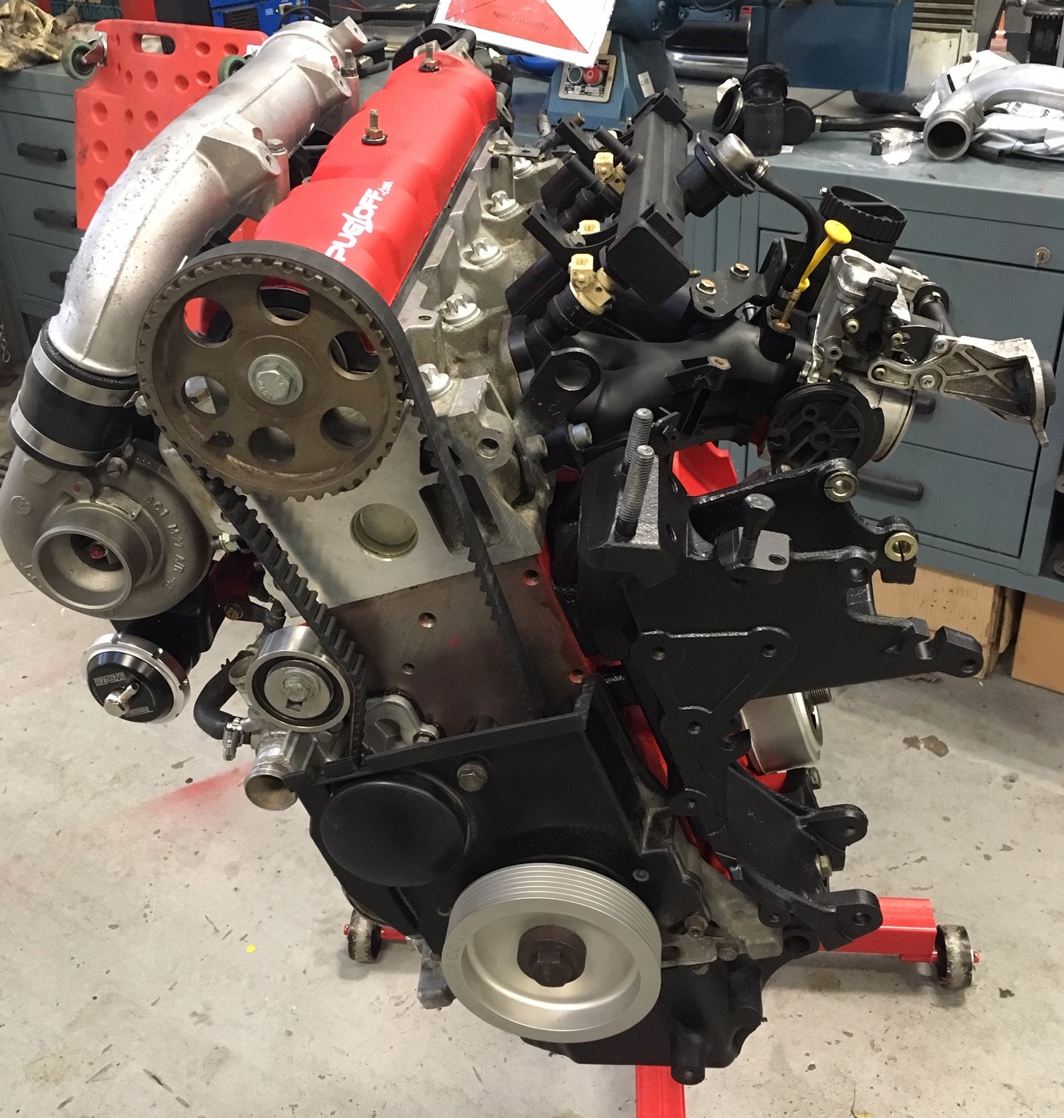

Hi All
The engine build is almost complete.  The biggest problem so far was the camshaft was worn out of tolerance. looked at a 205 GTI one but then there would be a valve overlap problem.  For the cost of replacing the cam Cat Cams do a Peugeot 205 turbo fast road cam so went for that and had the cylinder head gas flowed.  The turbo has been rebuilt by AET turbos with a 360 degree thrust bearing. Hoping to have the car back on the road for next summer.

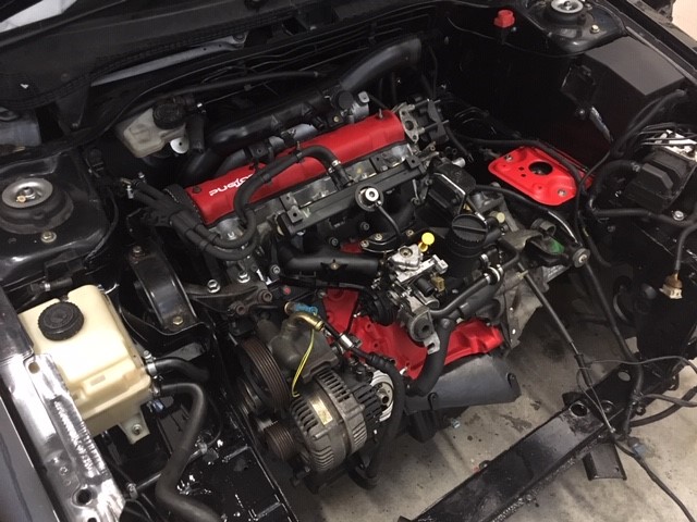

Engine and gearbox all back in hopefully no more issues and will be ready for next summer
