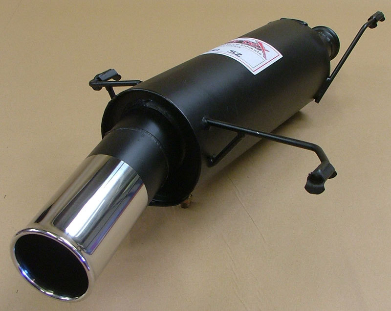

Yeah maybe it is then, it certainly looks like a magnex but not only is the quality shit it's obscenely loud too, like you all know I like a loud car if you heard my GTi but this gave me ringing ears even with ear plugs. I'm not even sure it would be that loud with no exhaust at all.
I've ordered a Sportex back box and I'm gonna team that either with the now ruined cat and standard mid section thats also now ruined, only taken me a month to blow the baffles and crack the box itself with too many bangs when i lift off. That or hopefully the lambda goes nicely in the de-cat once I've re cut the thread and I'll use a £25 HDi mid section as at least that has no baffles at least until I can afford a straight through mid section.
Its one of these
[Image: %24T2eC16FHJH8E9qSEUc7MBQG6PGV+Ow~~60_57.JPG]
