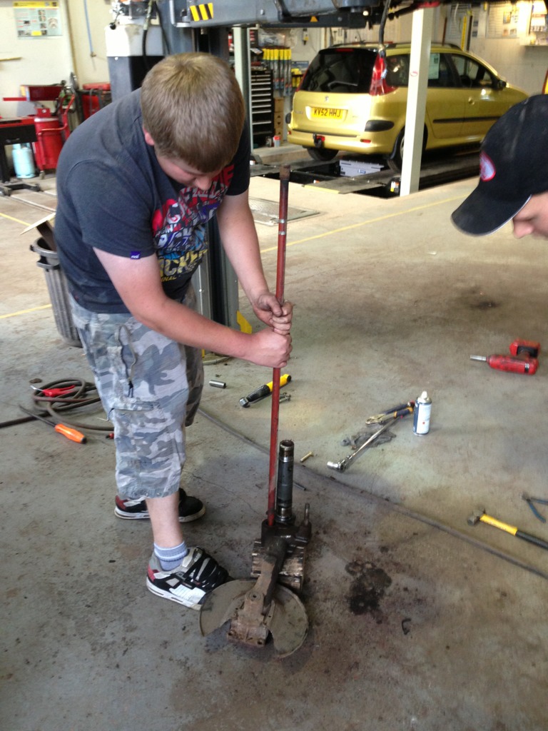

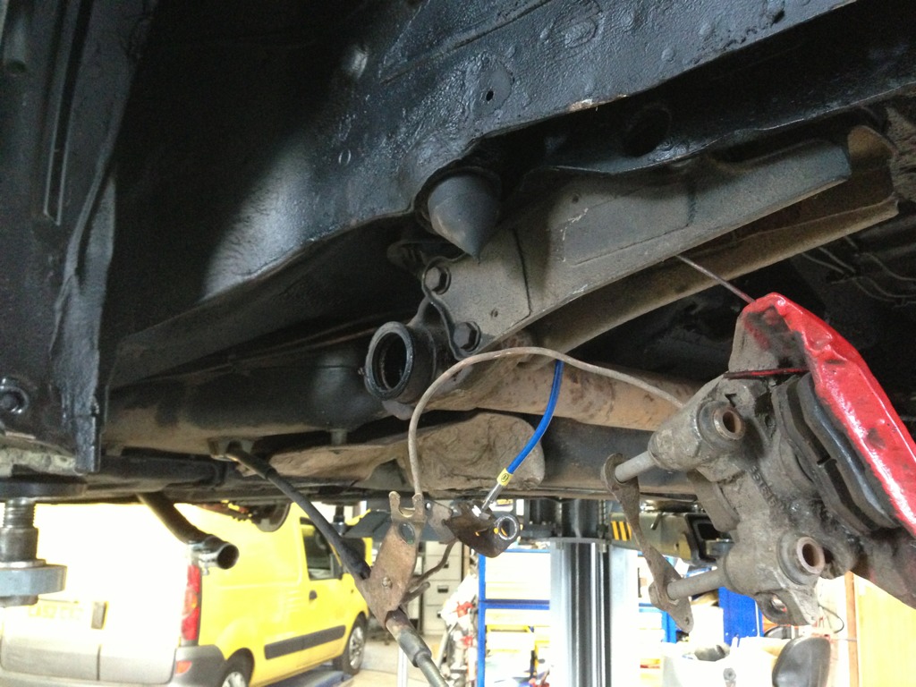

I didn't get any pic while doing the axle mainly as I was getting stressed out but heres some pics of the beating the near side trailing arm took

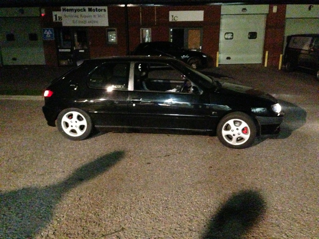

Some pics of how the car sits after the axle been lowered
[Image: null_zps5fcbb05e.jpg]
[Image: null_zps4f0ef2cf.jpg]
[Image: null_zps6f995624.jpg]
[Image: null_zps004dc518.jpg]
[Image: null_zps3d95186e.jpg]
I think the passenger side is the perfect height I am after but the driver side is a tad lower but I think they always seem to be that way. But I cant really tell on the height till I get the front lowered and I have got some challengers to go on so will have to see how it sits with them on.

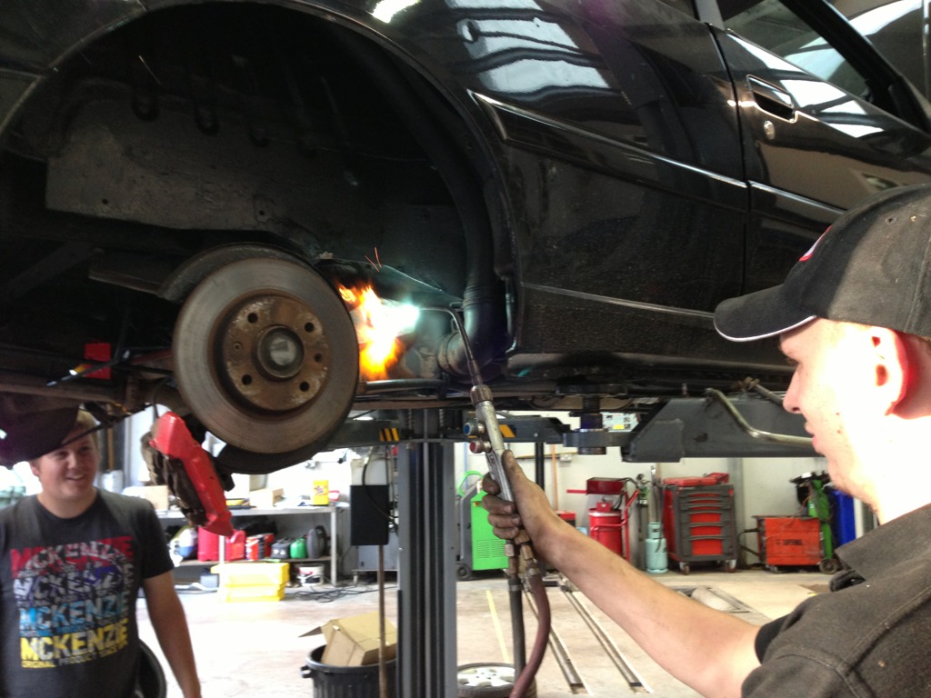

Few extra pictures of frosty's lowering
Didn't take long to break out the heat.

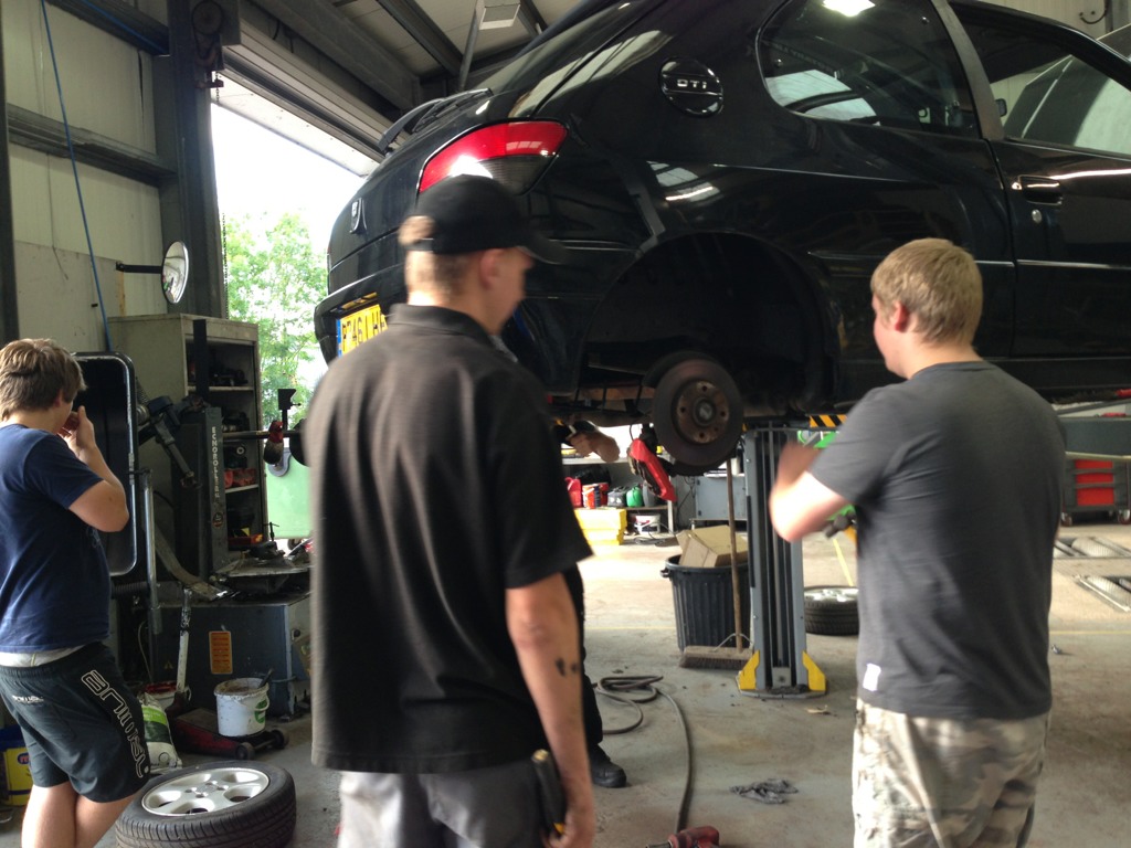

One off, with Jimbo looking happy
Poor mr frost was getting a bit niggly come the end but did get it all back together and down on its wheels.

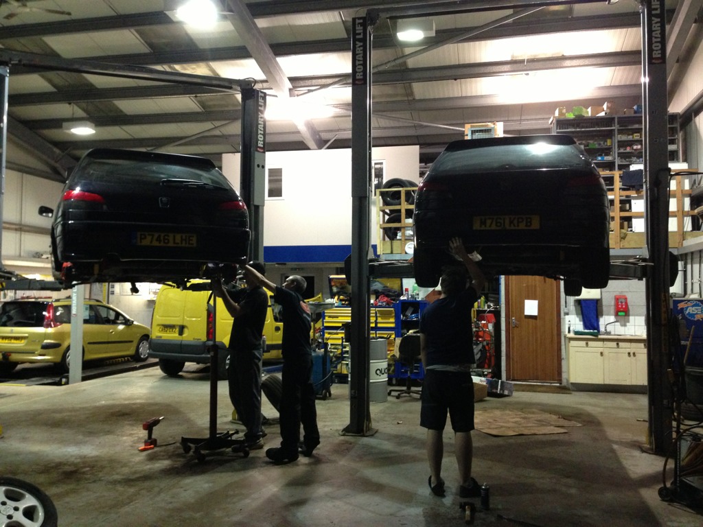

While the lowering was kicking off, Jimbo made use of an empty ramp and dropped his backbox off to fit another
Two black ph1s on the ramps
And one of the box fitted...
