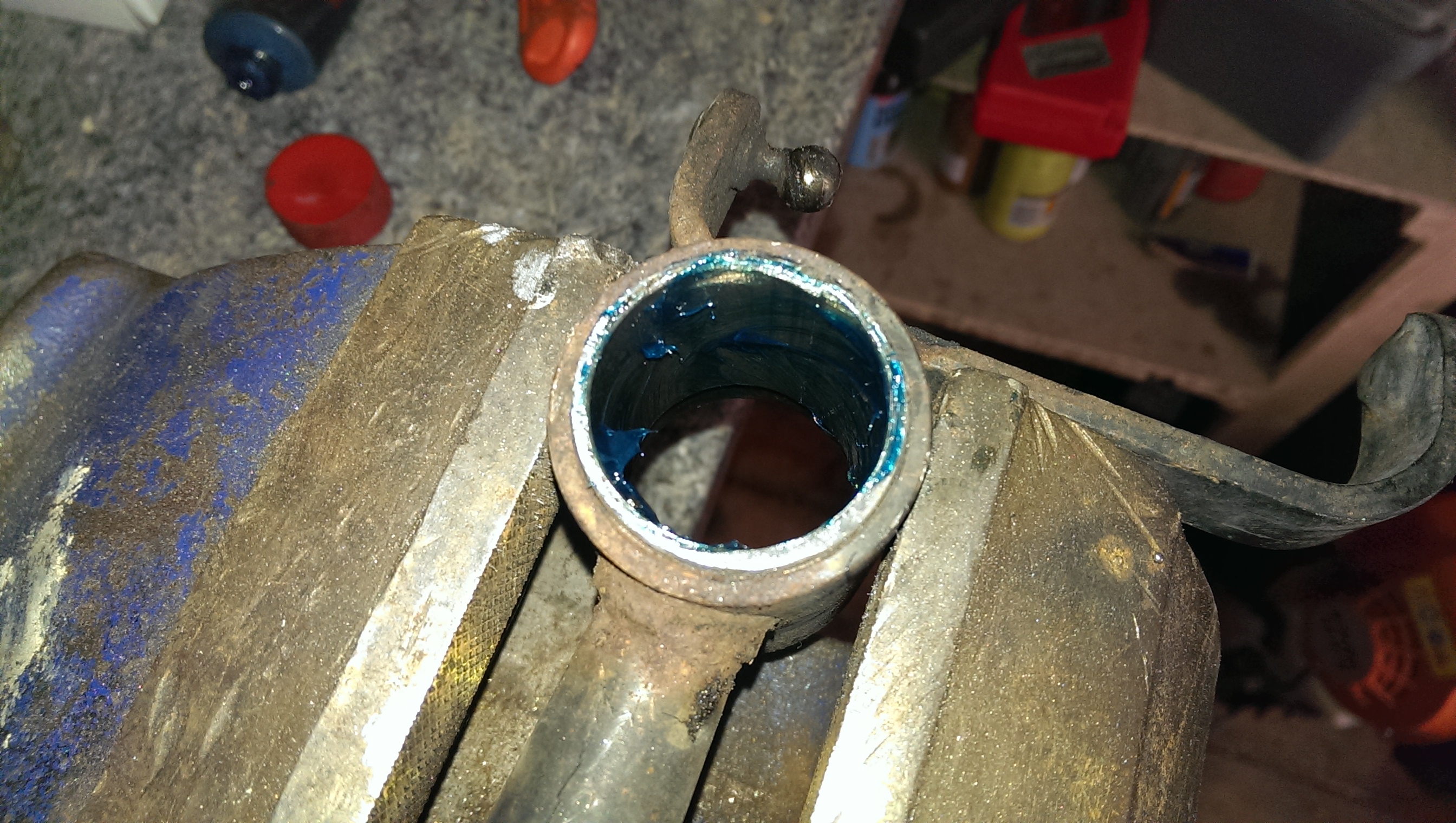

Well my cured knocking noise.....its back Sad Im assuming the ball joint is buggered and has probably buggered the new hub so next payday i need a new Meyle ball joint and a new hub. Fun times!

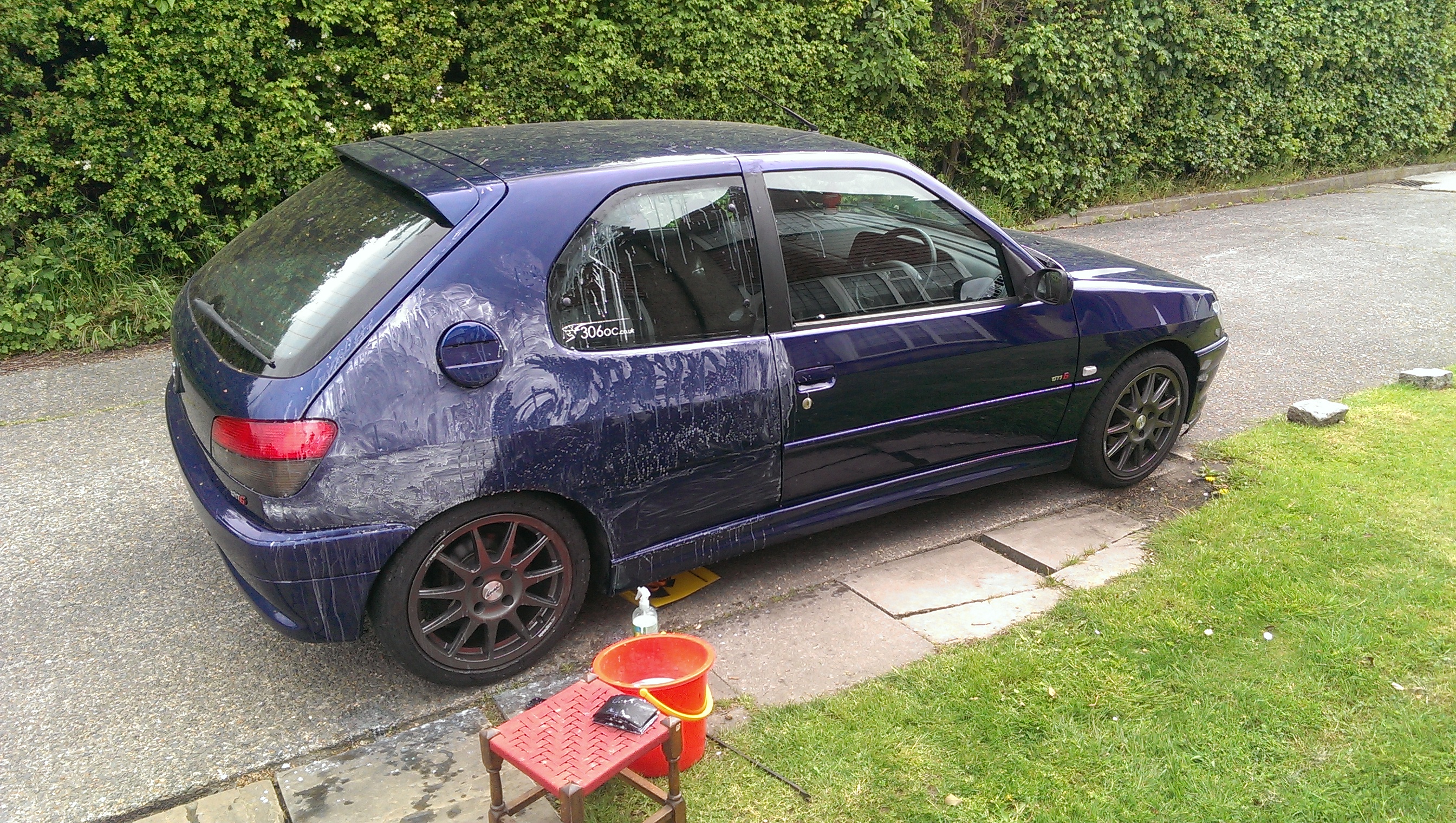

So yesterday this happened
And then it turned into this
Unfortunately though i then ran out of cutting compound so its no where near as shiny as i would like. WIll have to wait to pay day to get some more Sad

Some bleddy balls taking sand paper to your paint, i'd chicken out! It does look like its working though! What cutting compound you using?
(19-05-2013, 05:23 PM)Tom Wrote: Some bleddy balls taking sand paper to your paint, i'd chicken out! It does look like its working though! What cutting compound you using?
Any body shop will do it after a respray. The final coat of paint is not the final finish! You will normally find once its been painted in a body shop, it looks shit after.
When pug did them originally though, they were painted under such controlled environments that it wasnt really needed so there is still a nice thick coat of lacquer on there.
Flatted back with 1500 grit paper and then cut with these two
http://www.ebay.co.uk/itm/Meguiars-M105-...2c6edf6e3b
Unfortunately i ran out of 105 after a first go over the rear quarter so thats why its still quite hazy. Ive put a coat of wax on it to protect it but that will be going in a few weeks when i can order some more cut and will go over it a few more times.
May do a guide once i take some more pics when i carry on. Want the whole car done before pugfest including a few little touchups.
