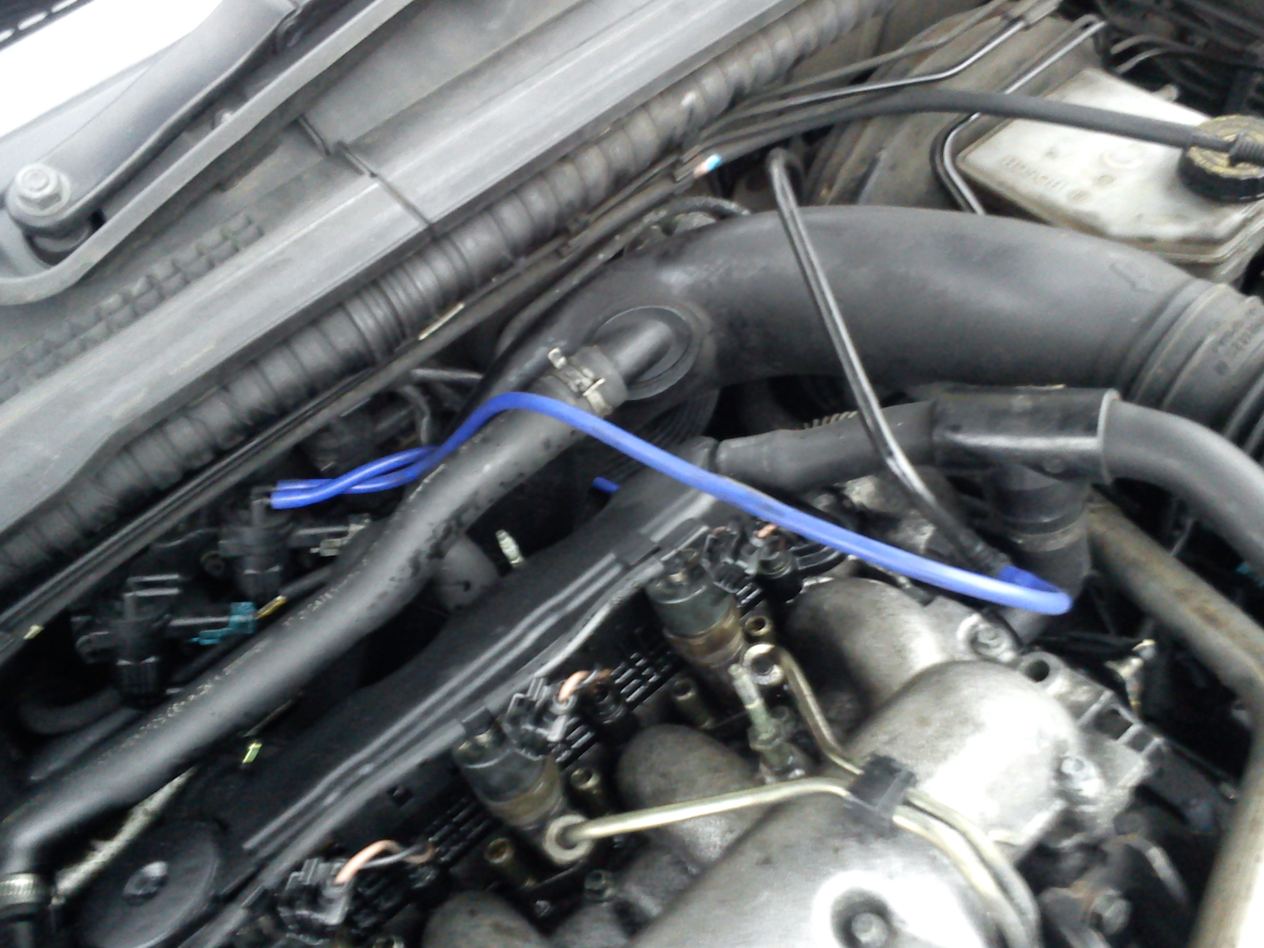

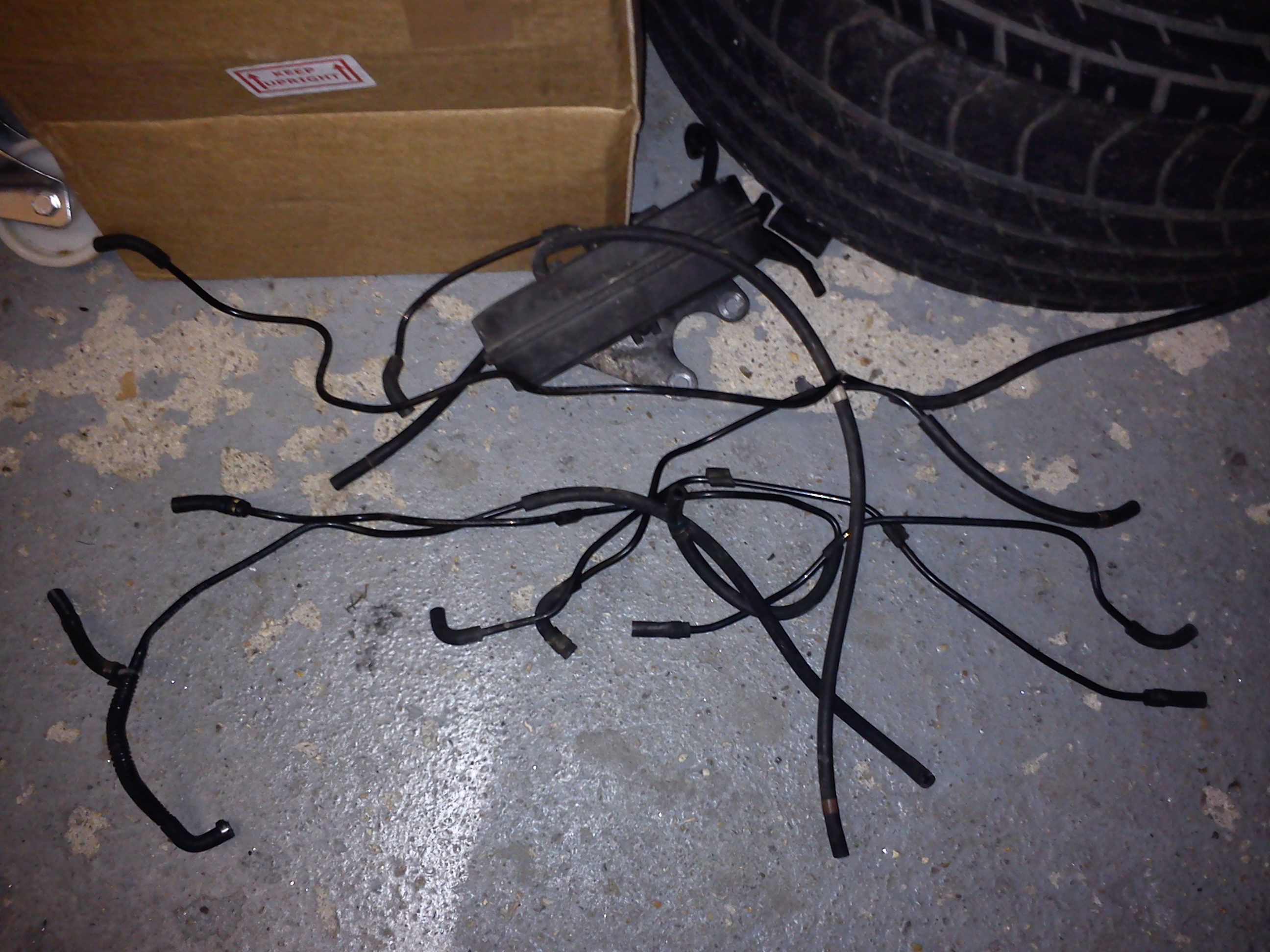

Today's work has involved removing all the standard vacuum lines and working out what was leaking and causing my over boost issue and thus limp mode.
It looks like the pipe that went onto the actuator for the swirl flaps as that was split, the pipe to the turbo actuator as that had gone brittle and split in about 4 places where it had got too hot, one of the air dossers, the electro valve for the turbo actuator and the vacuum tank which had obviously split and been poorly repaired at some point.
Anyway instead of 5 solenoids and a vac tank I now run vac straight to a solenoid for the turbo actuator and thats it.
f*ck me its quick now, feels to of added 10bhp and alot better response and theres no limp mode. Smile
Only slight issue is that the vac tank appears to of been quite important for the brake servo lol so that'll take a bit of getting used to.
I really need to sort out a FMIC as without air dossers its sucking hot air through the fast warm up pipe thing. Also I don't know if the swirl flaps are sitting open or closed and the car is a bit smokier now so I'm gonna try cable tying the actuator rod to see if that'll get more air in.
