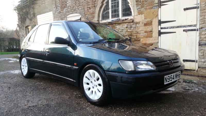

Here you go. about 50mm.
#68
nice one chap...repp'd...
may ask for it to be done again with me new rims tho!!!
looks good actually...may go for -40mm
