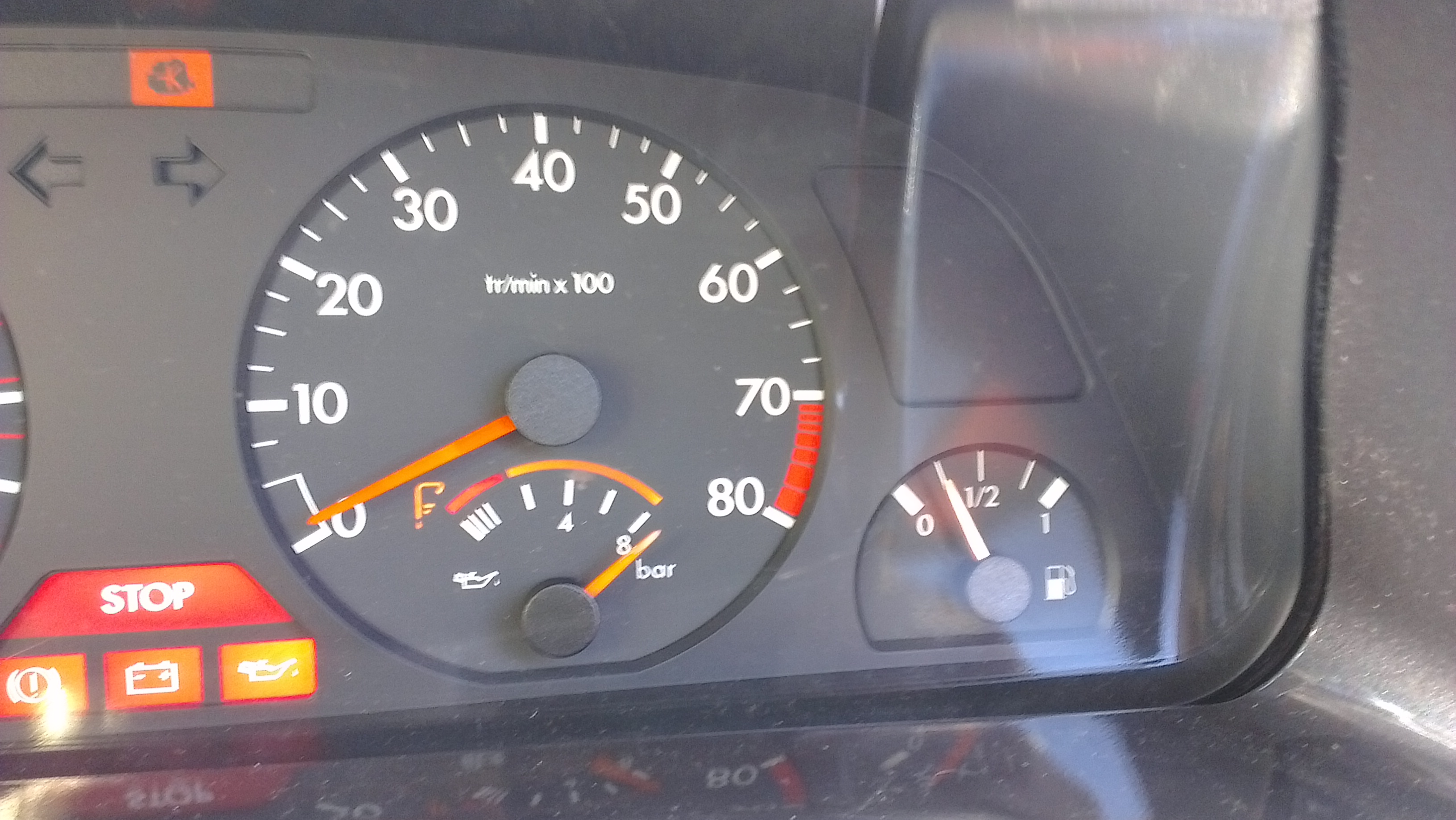

So thought I had "French electrics" syndrome yesterday:

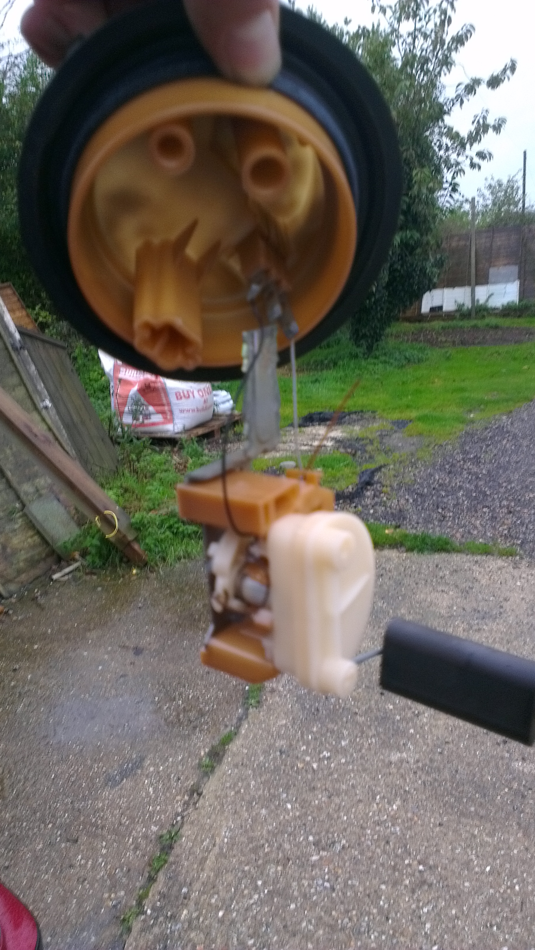

After investigation I found that it was more my fuel sender had become the victim of my bumpy suspension...
So I soldered the wire back on:
And glued it back together, with a self tapper for good measure:

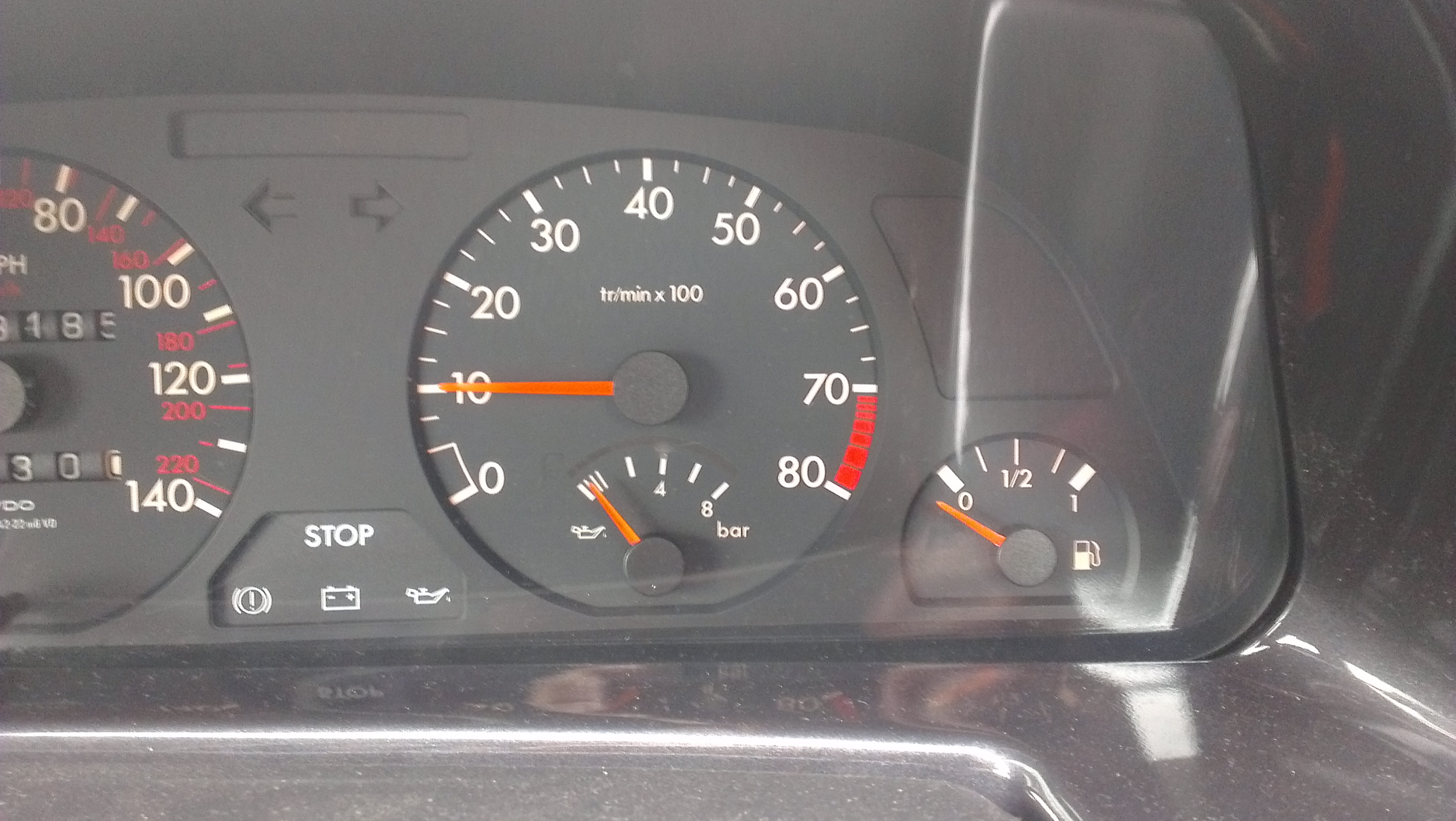

Success:

Loving the bodge work curt Big Grin top job mate
Haha cheers Jamie Smile gotta be done! Does the job.
