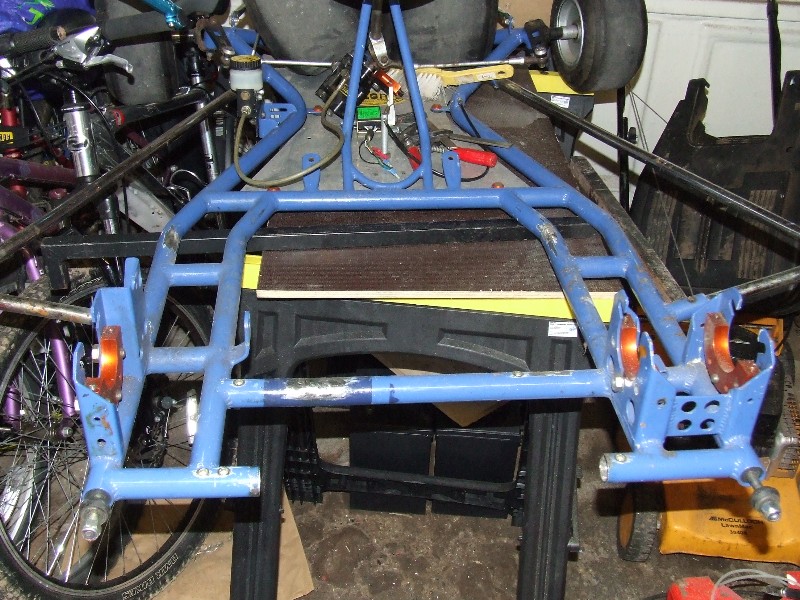

the Kart is home in the garage now on stands and i have stripped off all the old electric gear
so Kart 2 Boost project has now begun Smile

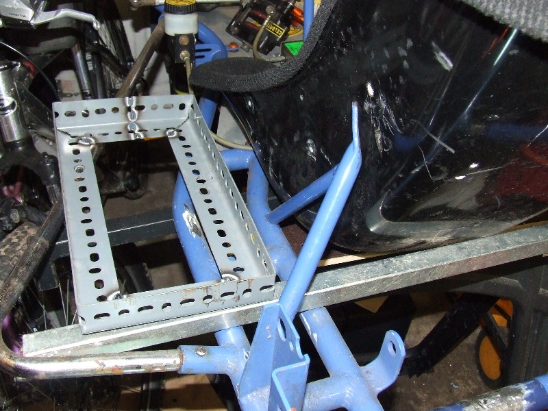

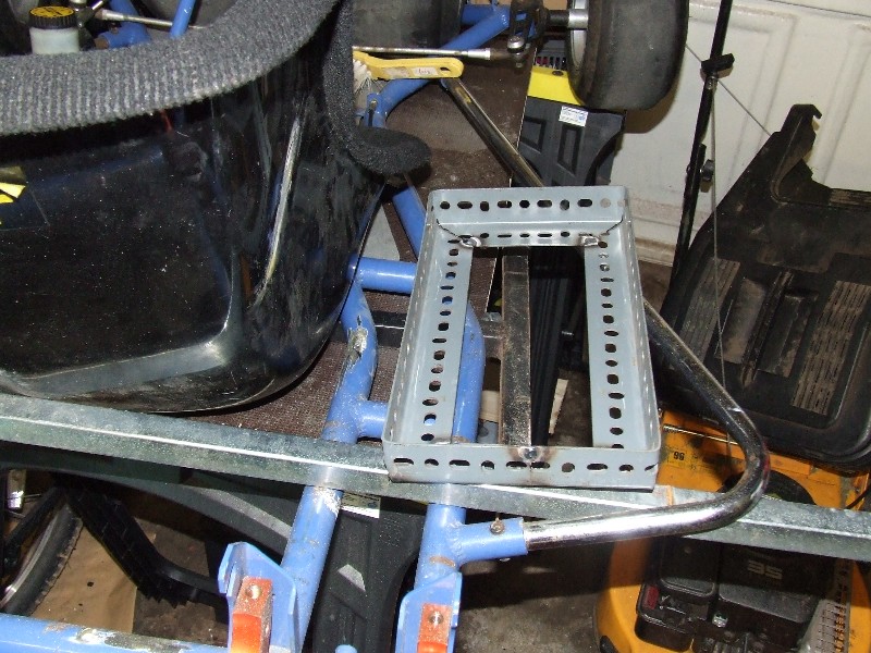

have made up two battery trays one for each side now i can offer up the seat and trays to get some sort of fixing ideas
had a mass build day today in and out of calls from work
and finaly the fat bastard can sit in the Kart seat mounts and battery trays are in !

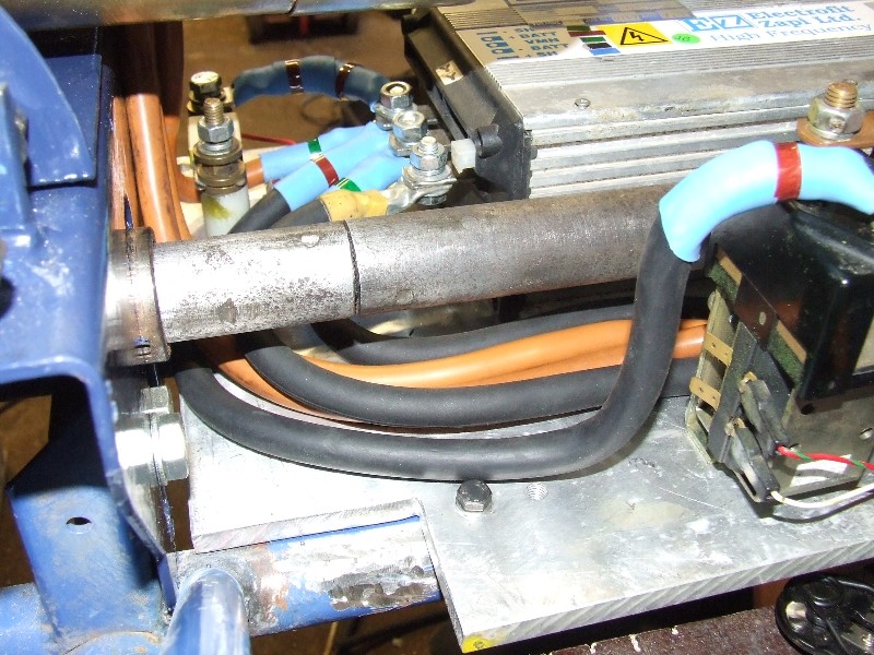

35mm cable is a bit of a bitch to crimp!
tightly around the rear axle and up to the motor
