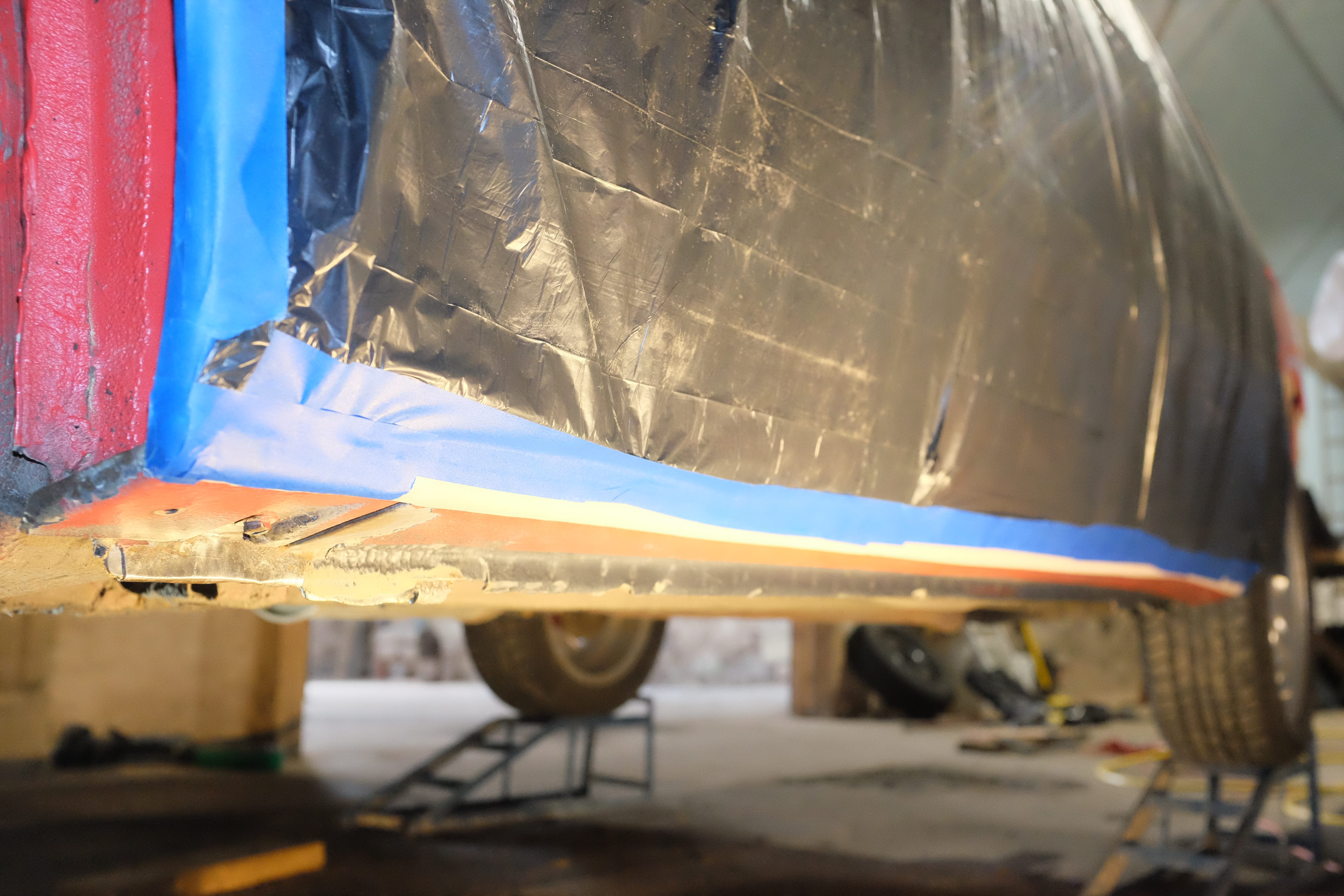

Hi All, just a few pics showing progress on under sealing my recently acquired Ph1 DT!

^ Masked up. Decided to seal the whole sill to be safe.

More pics to follow!
Good work.  Have been meaning to clean up the underneath of mine for the last 2 years.  Am sadly heading in to yet another winter without having got it done!
Had any more thoughts about the rear beam? The 205 GTi rims look great btw.
Speedlines are always a win on a phase 1. Whereabouts in the highlands r u
