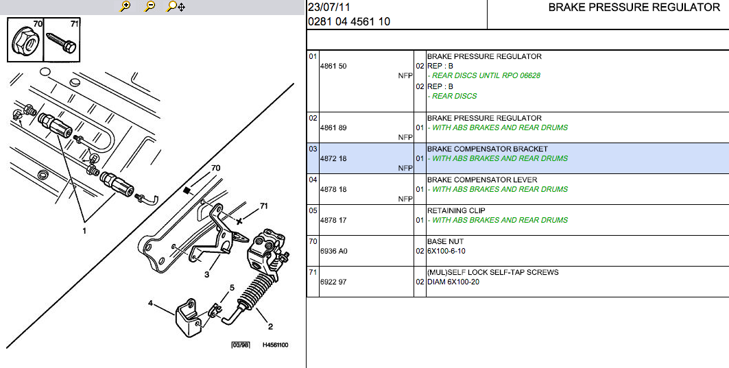

same as a late 205/309 so readily available not too expensive.
service box says NFP
part number 1
GSF which I have bought from in past don't seem to stock any longer, or ECP
(10-10-2016, 10:24 AM)welshpug Wrote: same as a late 205/309 so readily available not too expensive.
been nfp for about 15 years lol.
try mr auto.
or a bosch stockist, got mine from one for the zx 16v. shorts auto electrical in cardiff.
will probably need to find the bosch reference number first.
