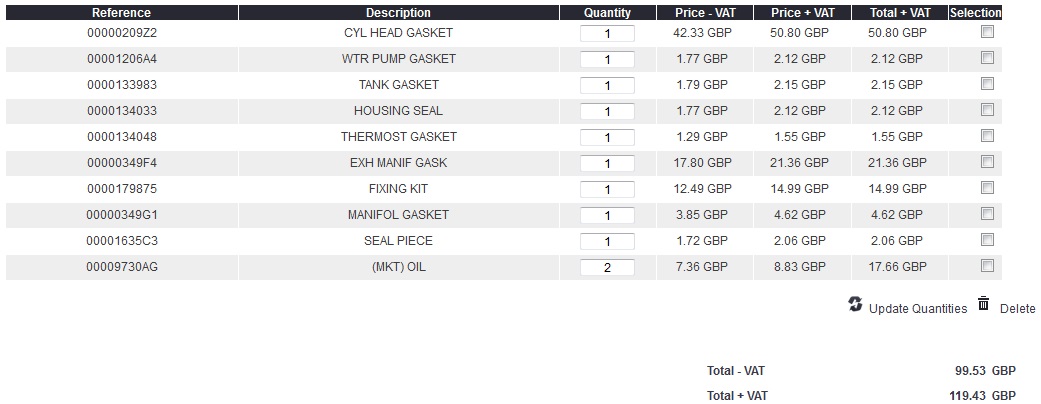

i cant assemble any more untill i start buying gaskets so this project is on hold now untill probably june
GTI6 Info
looks epic man as always. i love this project just the details man. i love the details
ordered some more gaskets
will be putting the head on this soon Smile
