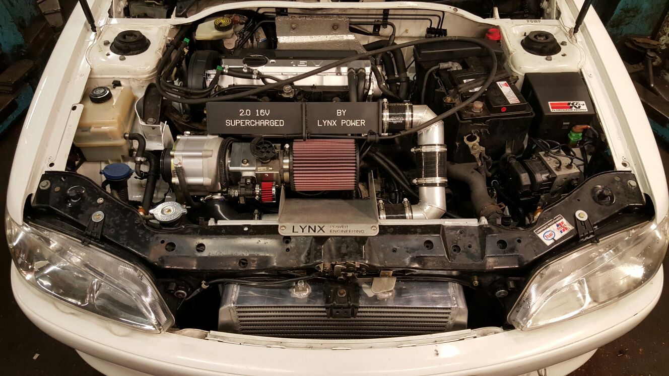

        Hi all thought I would finally get a project thread up an running now I have the 6 back and work has calmed down a bit!!! Bought the car in December and was thinking just a rebuild and low boost but went to see Rich walker to pick up some bits and he had a high boost motor complete on the stand looking very lovely so I wanted one!!! As he got busy with all that I started to strip my xsi of crystals,exhaust, cyclones and numerous other bits to complete the standard look I wanted. Went a bit crazy with it all but now have a cracking looking 6 that goes sooooooo fast :-). Will be doing suspension next but unsure of which way to go with it. New T1r x4 with new genuine discs all round with ds2500 pads in- fab stopping power!! All looks very standard with very dull paint "sleeper" look. Will get pictures on asap cheers

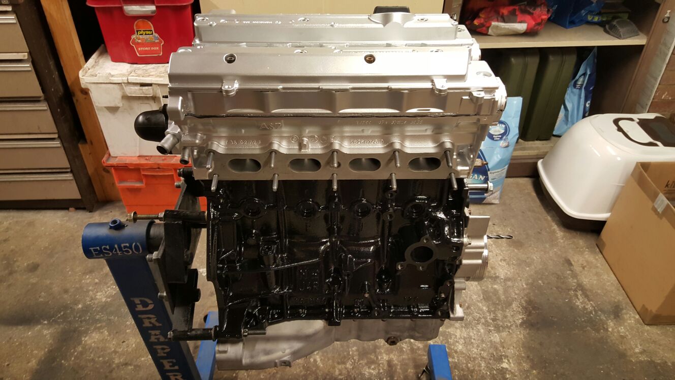

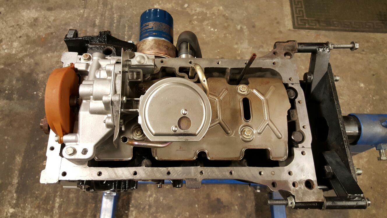

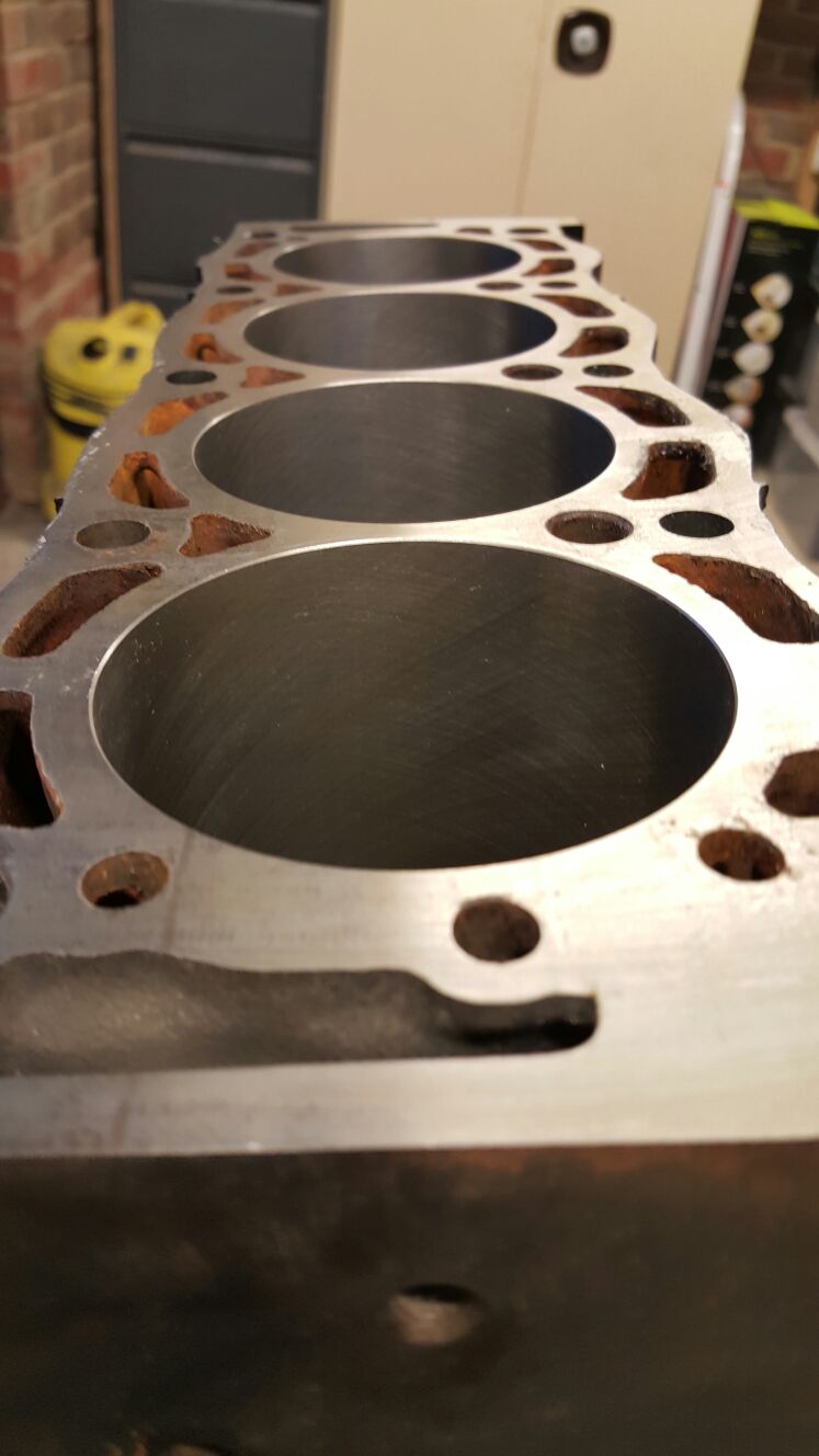

Block bored out , honed and decked
As above

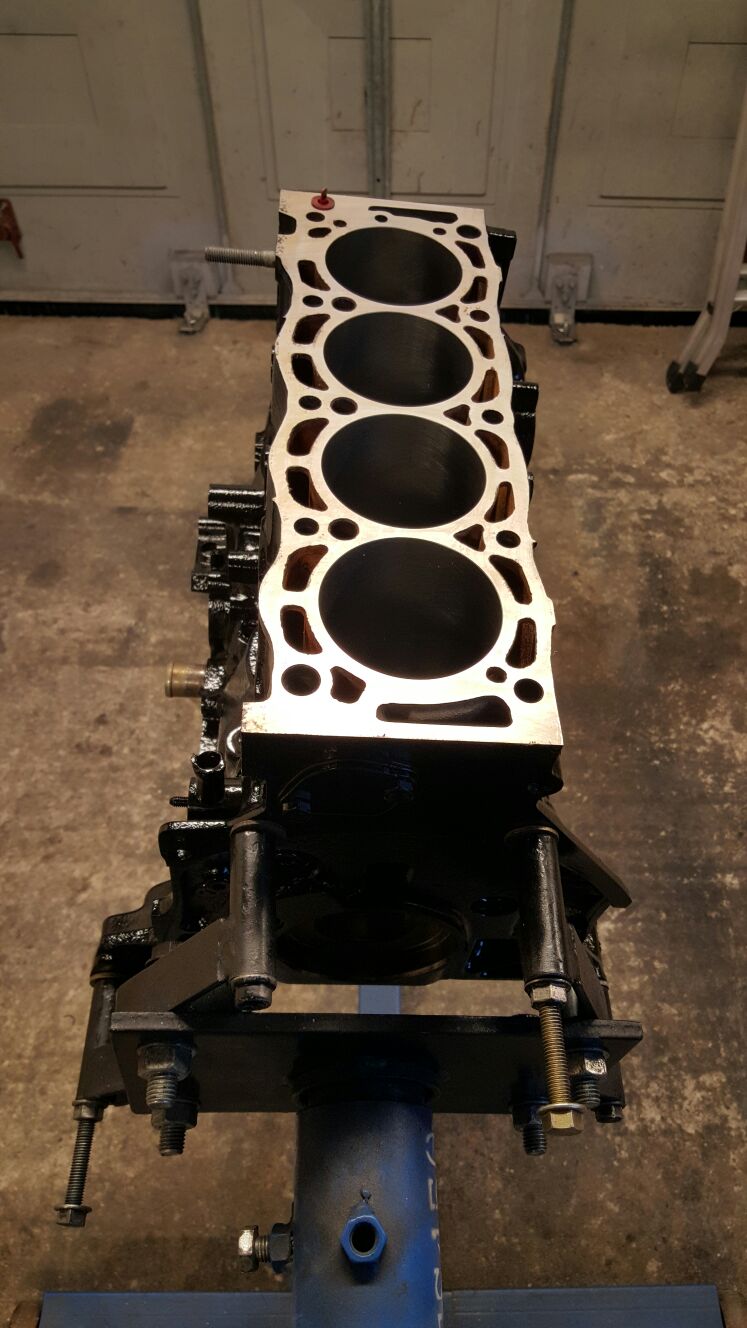

Last one of the block all painted

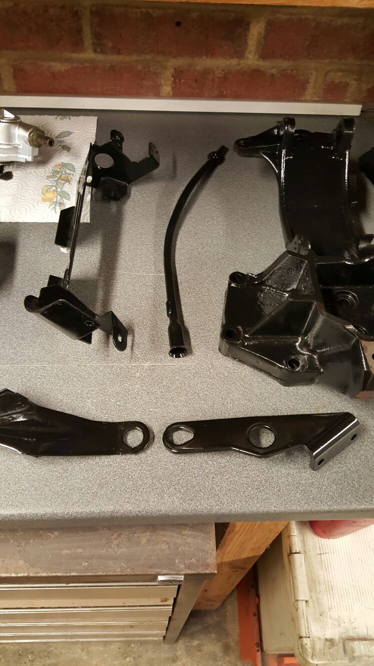

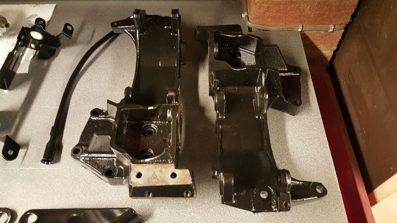

Few other bits that we painted
Few more
And more

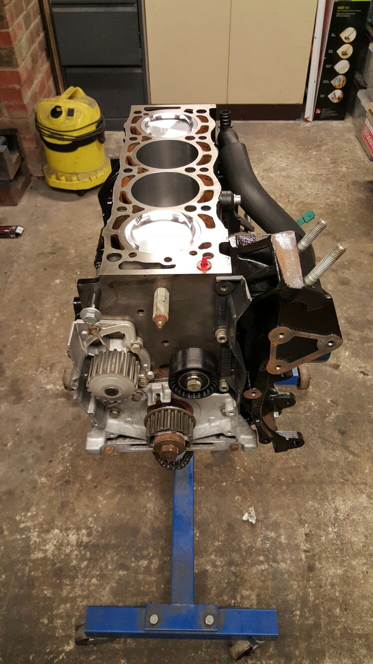

Nearly ready to start the build

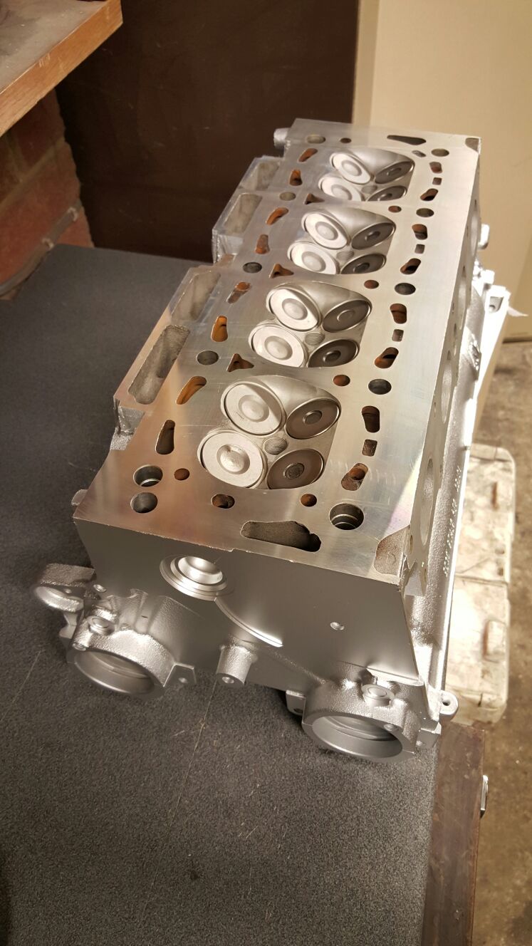

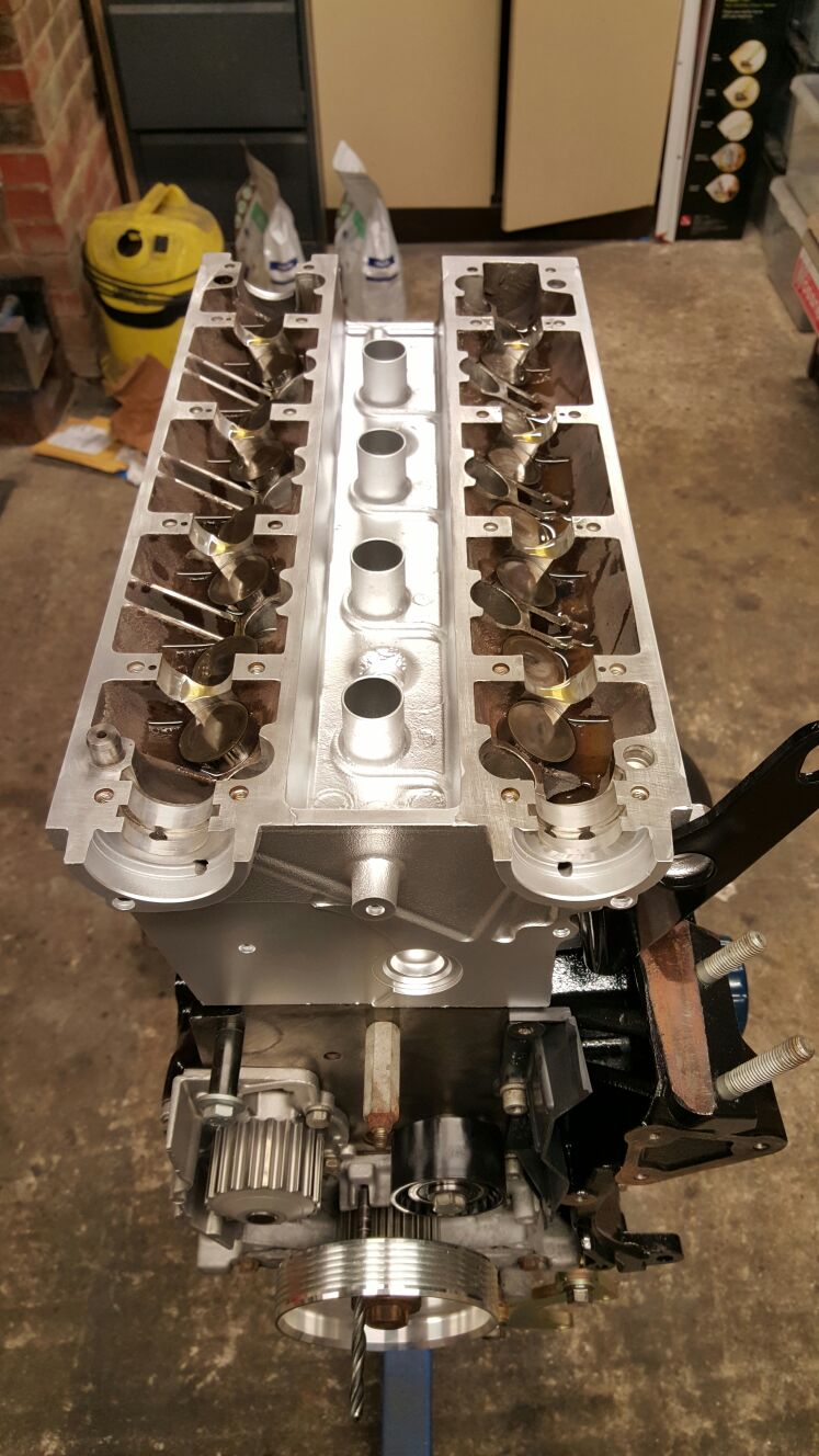

Head is back from machine shop
All painted ready to go

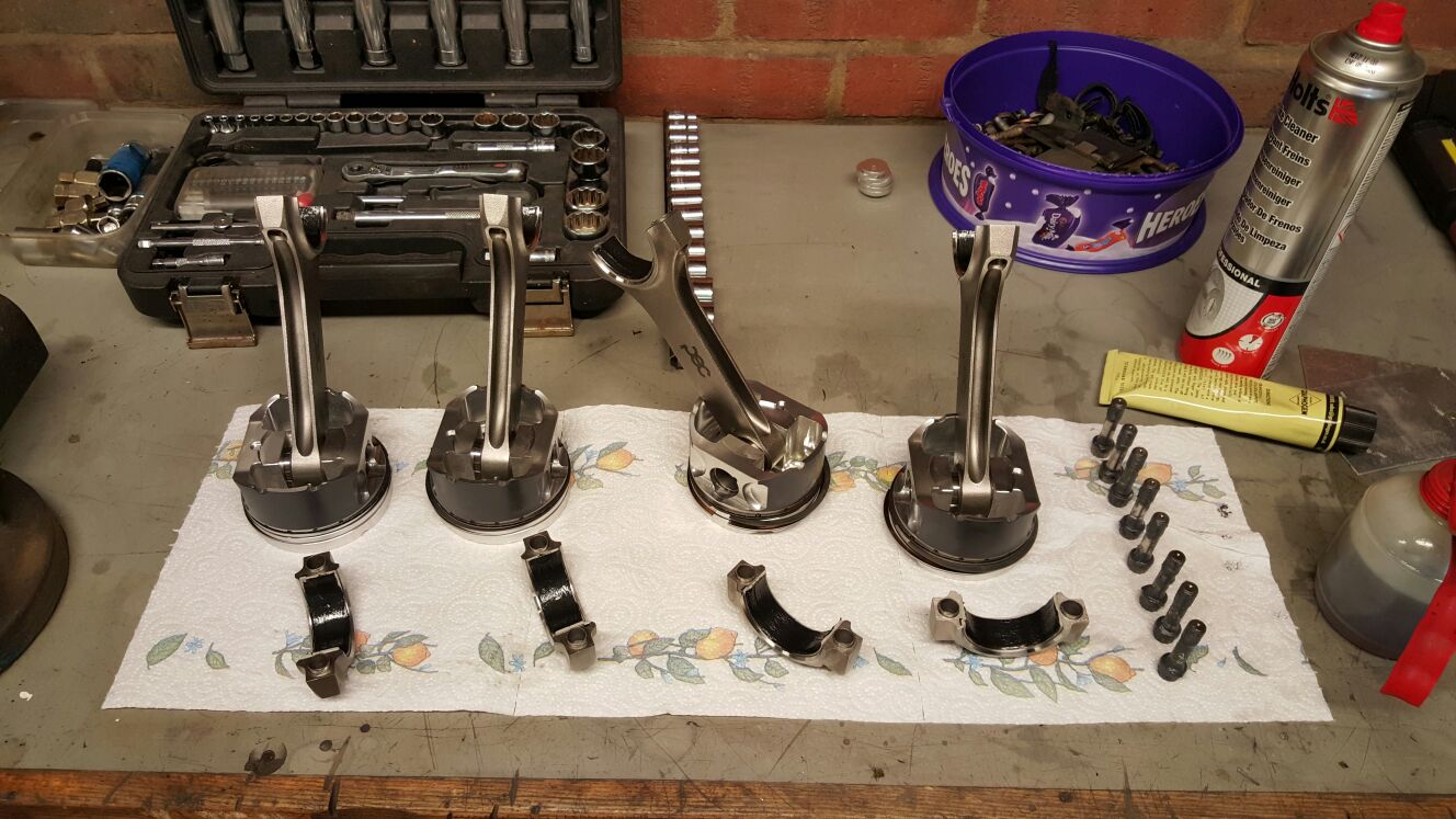

Next step slot them home
Spray bars in

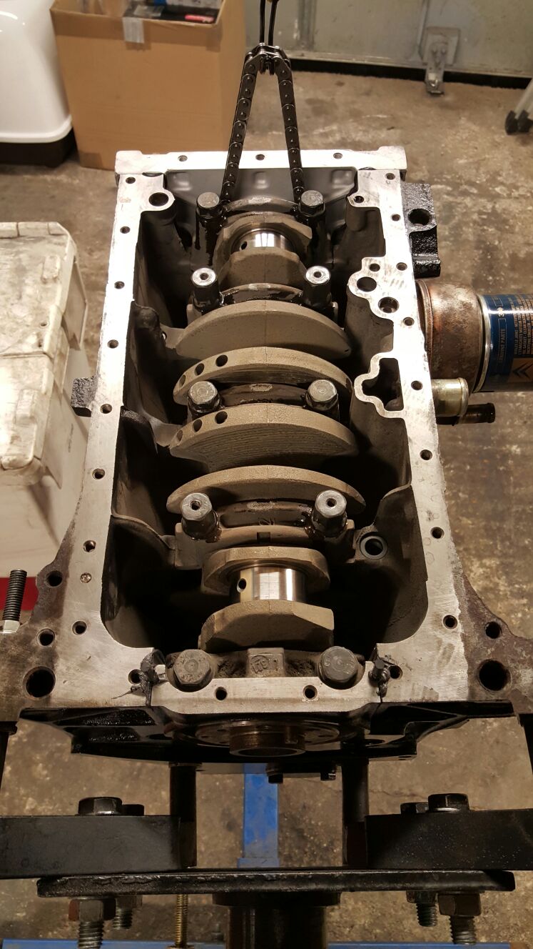

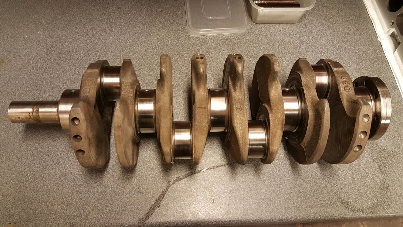

Crank at the ready
Finally getting it together
Bit more done
All looks very shiney
Bottom end is finished waaaaaahey
I have to admit even thou I love cars I didn't play a single part in building the engine. I do do some spannering but on the cleaner bits!! Even the pictures were taken by Rich W

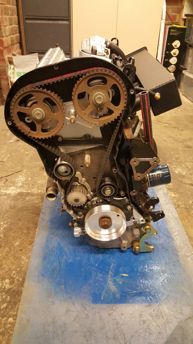

Taking shape

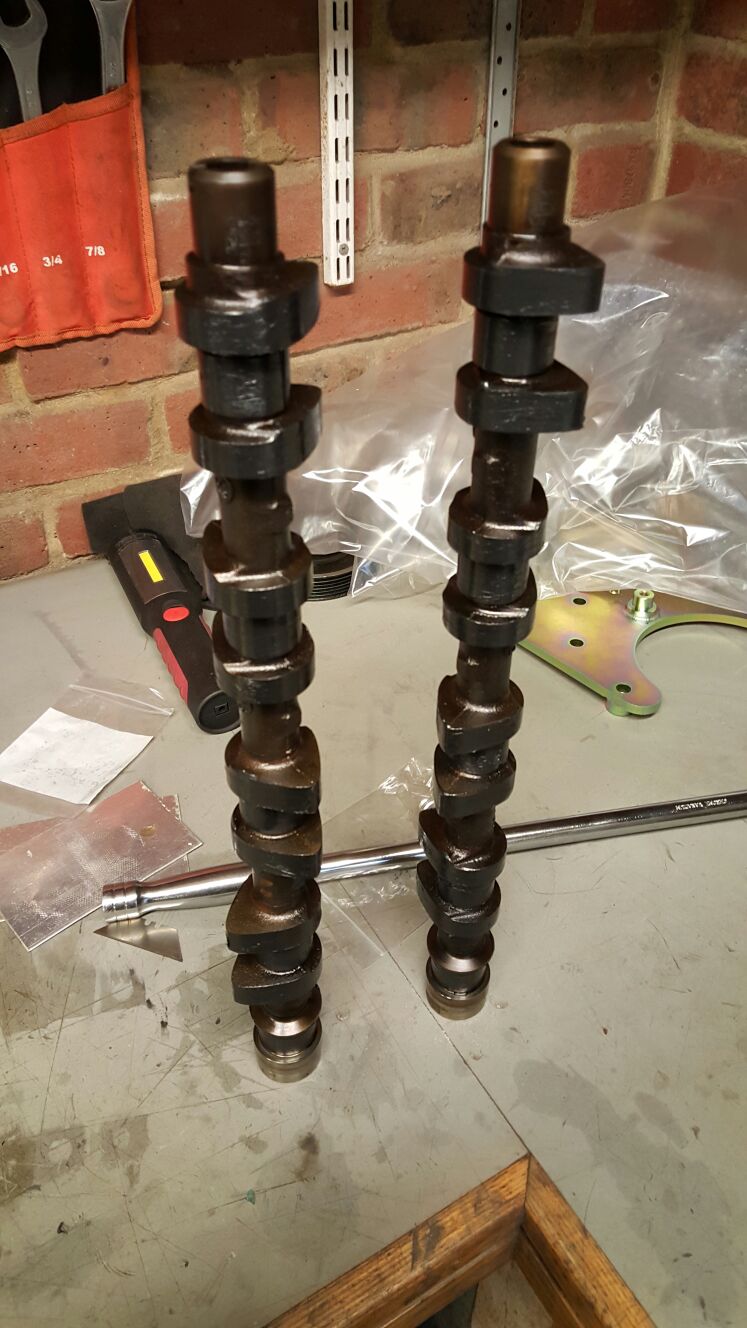

Standard cams
All done
Loving it not long now
Billet wheel is on can't believe how much lighter it is

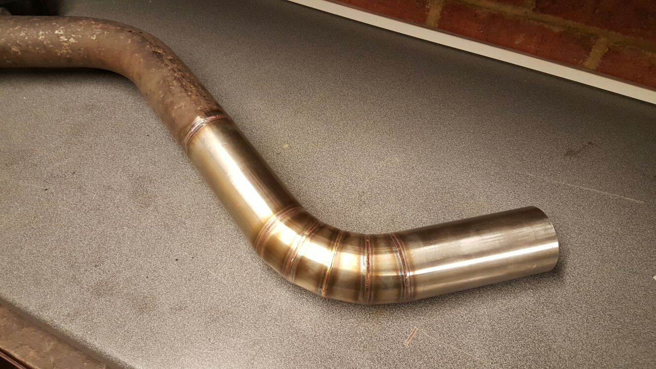

Inlet manifold is a work of art
Can't believe the welds on this

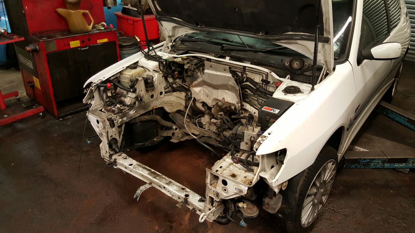

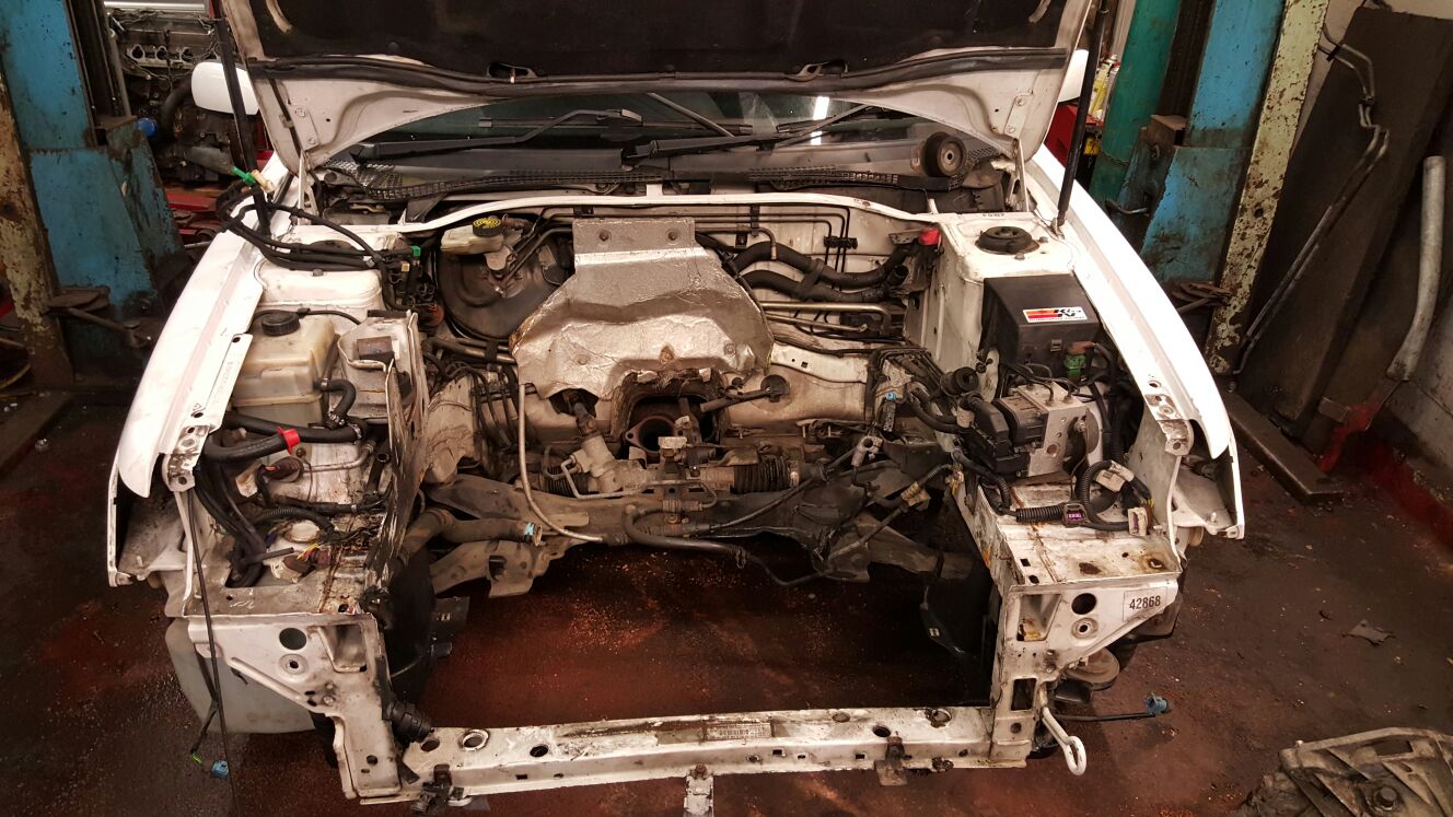

Old engine gone, air gone gone too ready for the new lump to go in
Big hole
And there she is
Snug fit
Used the magnex off the xsi with a few changes- welds were amazin
Old to new
Boost pipes all finished, helix paddle clutch with Valeo pressure plate

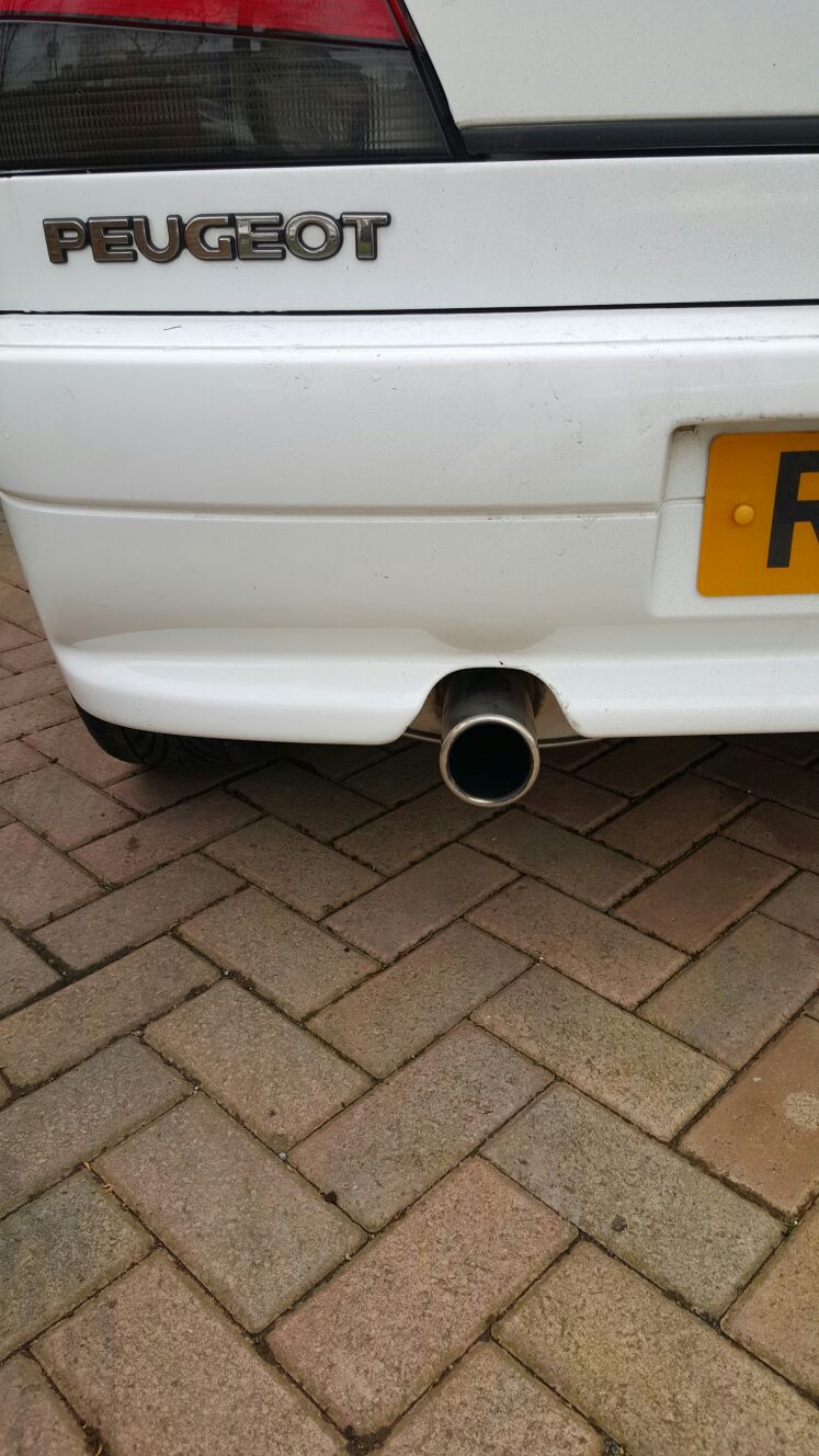

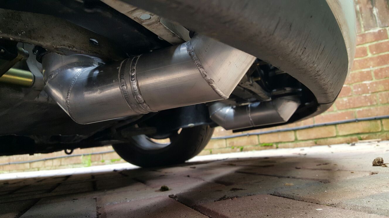

Bit anal about the exhaust being in the middle so with some fettling it's perfect apart from being sooooooo loud
Decat on and this was removed to take any restrictor out from exhaust

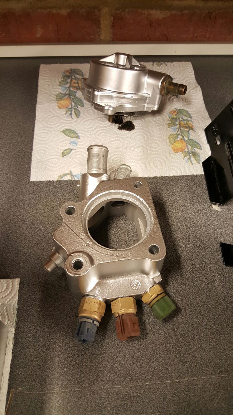

What paint is used on the head and covers??
I used vht silver on my xud one...and it rubbs offSad
(23-04-2016, 08:15 PM)Piggy Wrote: What paint is used on the head and covers??
Think it's simonize engine enamel but etch primer is needed for aluminium bud

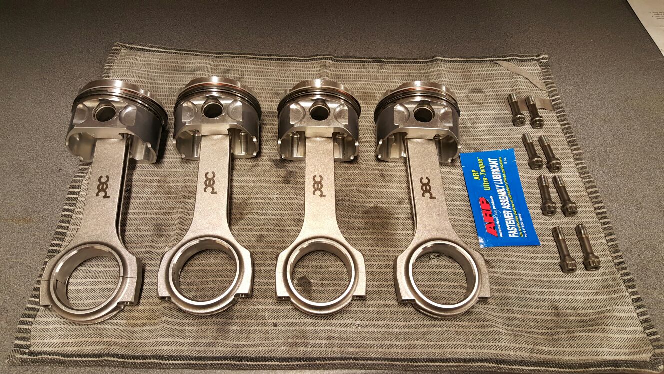

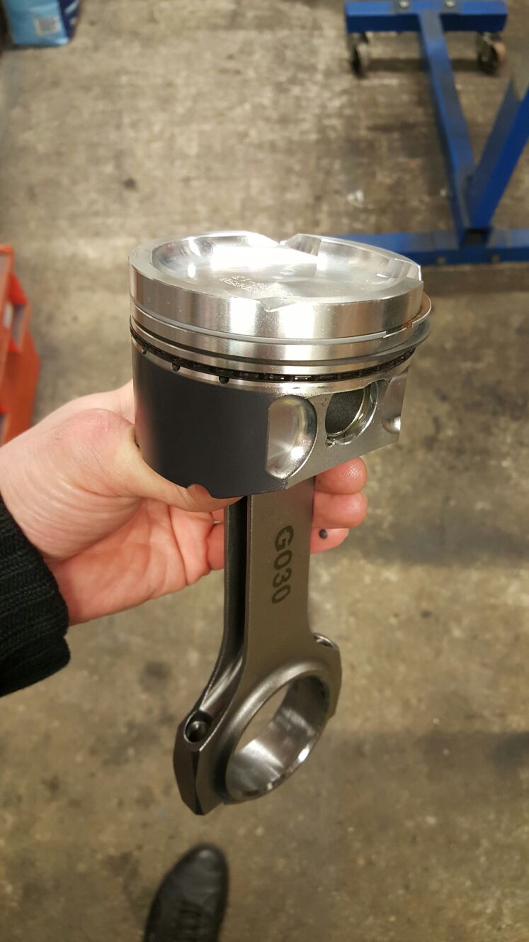

Nice and shiney, everything looks right. Only concerns are the con rods and those God awful tyres.
Please trust what we are saying and get some decent rubber, I had a set around 7-8 years ago and they were dog shit.
Yeah...I duno much(read anything) about high boost 6 setups...
But have heard people using the BE hdi box with more success than the gti6 box. Plus they are cheap right?
And as for rods...again no experience...but anyone has these chinese rods go bang?
T1rs on the other hand...ahhh dood, I missed that! Get some ad08r on them quick! You can get a whole set fot not much more than £225 iirc
You're best off with a diesel box to make use of the power, you'll strip 3rd gear on a 6 box in a matter of weeks.
205 na derv box if you can find one, the uprated diff will fit in
(23-04-2016, 09:36 PM)Eeyore Wrote: so was the block sandblasted? and what have you painted it with? it looks fantastic!
Yes mate sand blasted and Simonize engine enamel
(24-04-2016, 06:14 AM)Paul_13 Wrote: Nice and shiney, everything looks right. Only concerns are the con rods and those God awful tyres.
Not sure on the con rods as they were reccomend by Rich Walker when he built the engine so I went with what he advised really. I'm gonna keep the t1r for the road as they don't get a hammering anyway but I will either get the yokos or triple 8s for the track.
