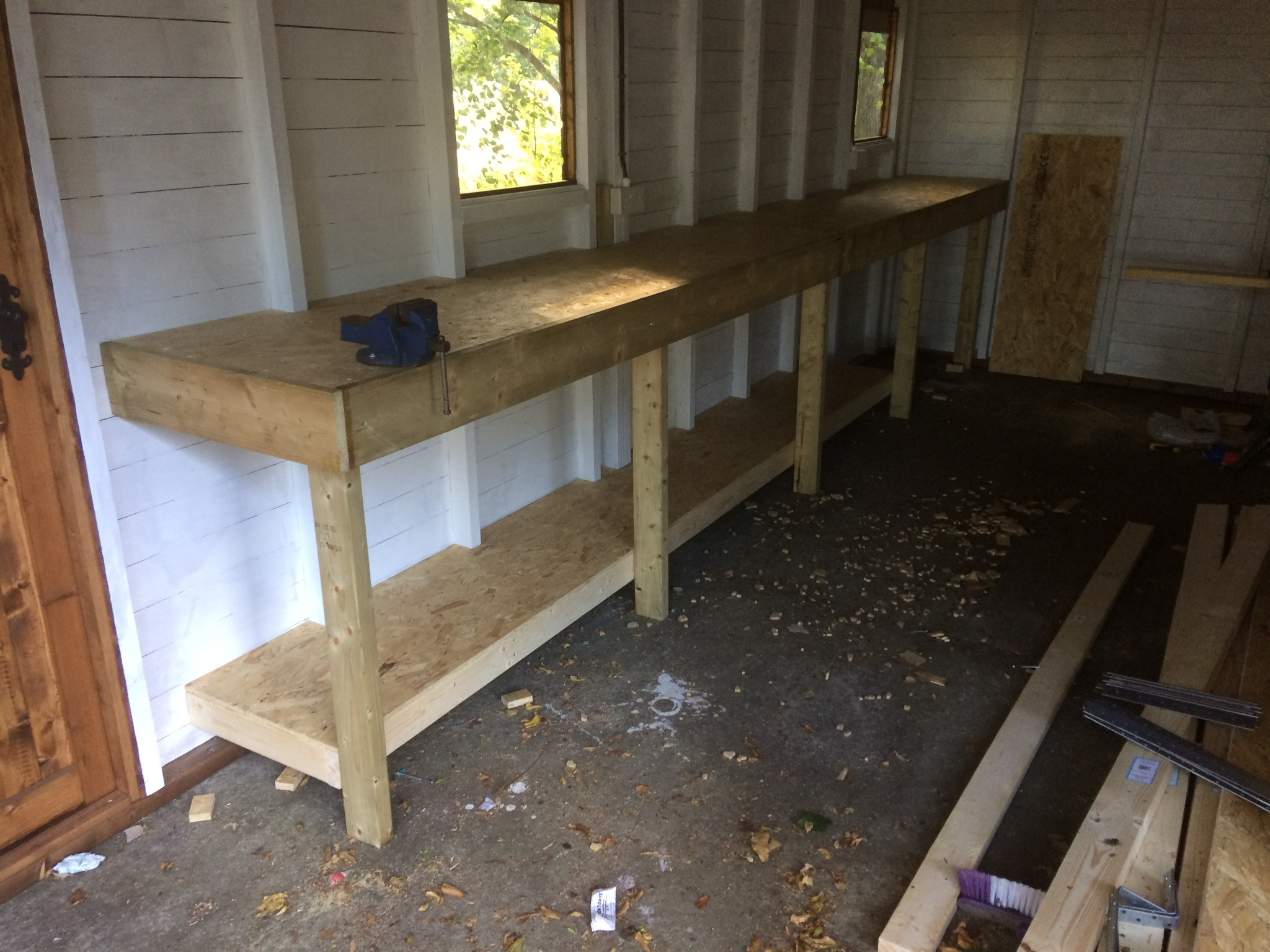

Also built my workbench, went al little OCD and the carpenter in me came out!
Gonna spend some money and kit it out a little after payday, air compressor, grit blaster, parts washer, new welder etc. Also got some heavy duty floor paint to do the floor and the workbench. Hopefully I can actually get on with the cars then!!

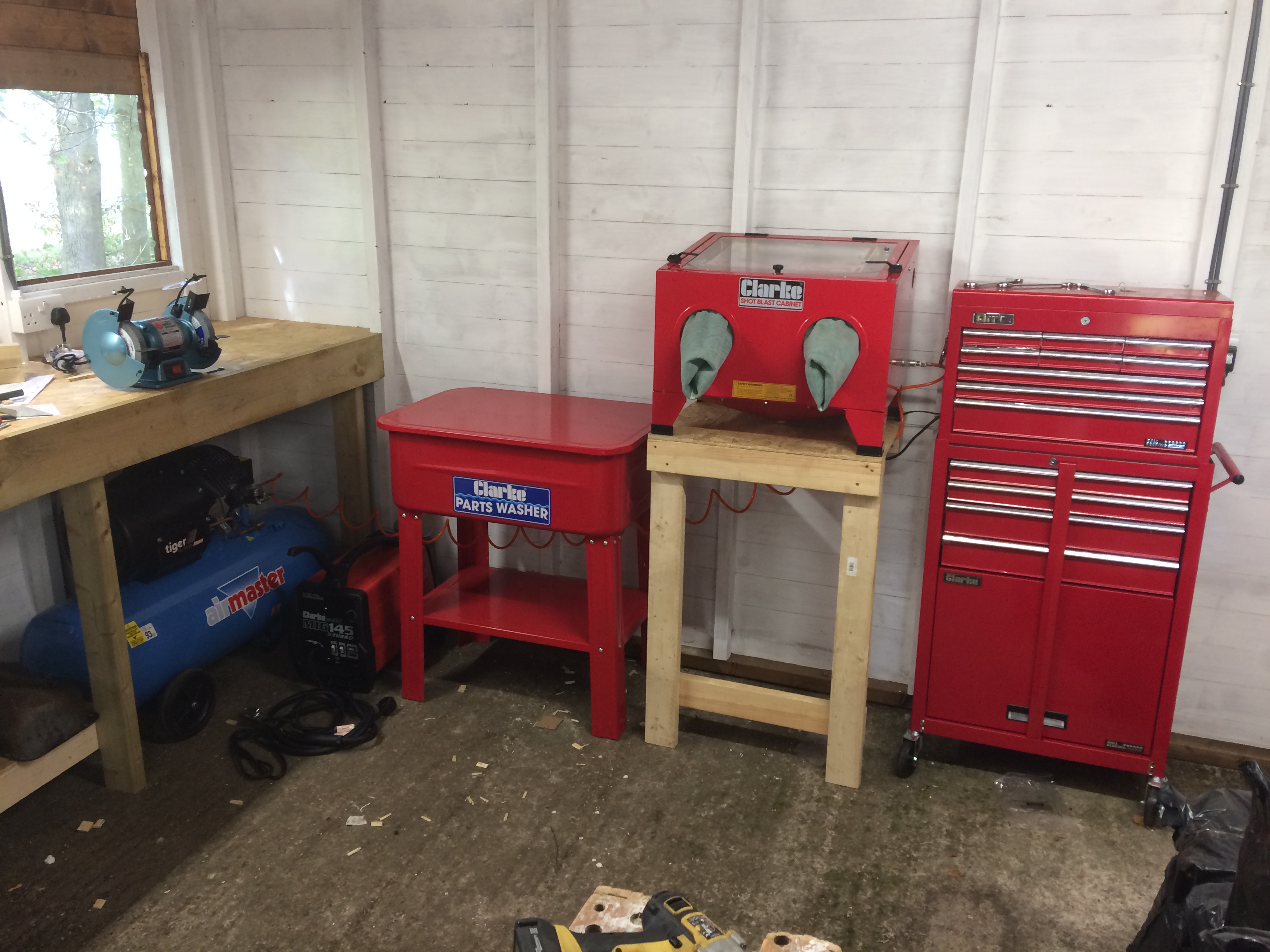

So I spent a bit of money this month...
Nearly setup properly now, XUD is still being worked on for now so not long until the project is rolled in

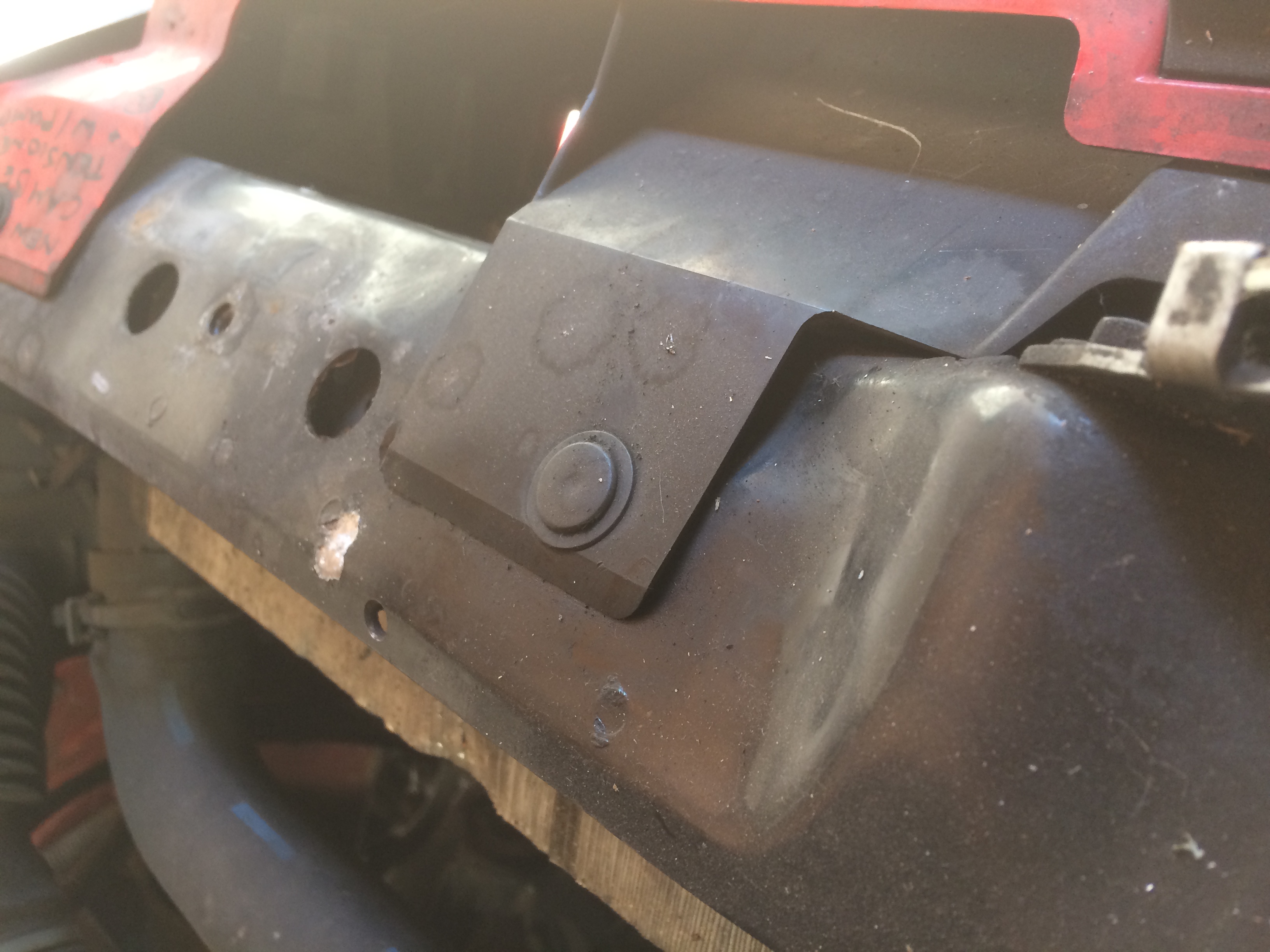

On a side note, how do I get these out without breaking them?’
#84
Gently prise the middle bit upwards with a flat blade screwdriver. That pulls out then the plug part it sits in will come out. The pin in the middle pushes the mounting tabs on the plug outwards (you'll see what I mean when it's out)
#85
Only one of them came out without breaking!
