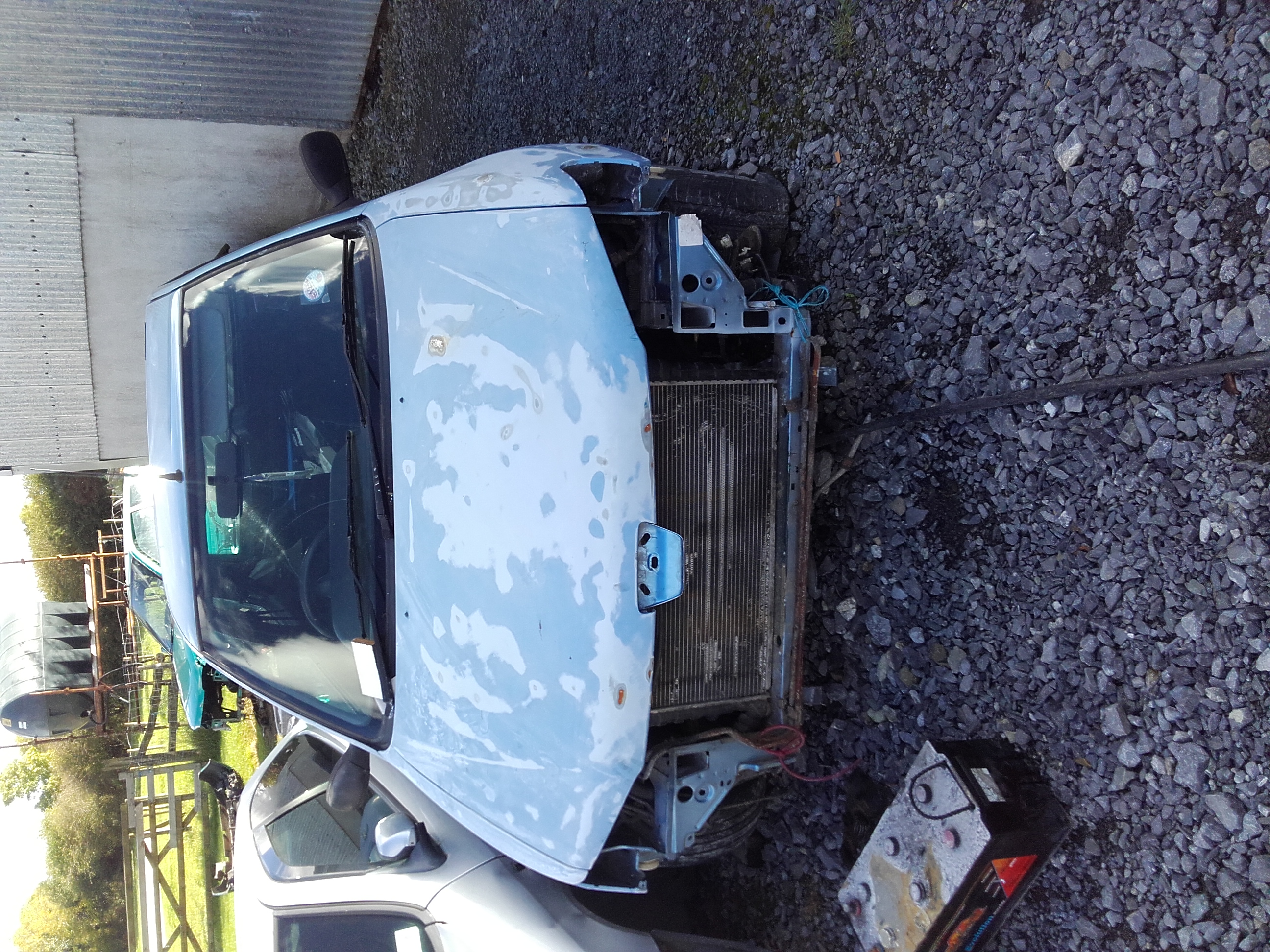

So bought a Phase 2 Dturbo about 6 months back as a project and it got put on hold until now.
The bodywork isnt great but i want to spray it anyway and its in need of a new engine, but it is clean underneath. Basically no rust(small bits of surface rust).

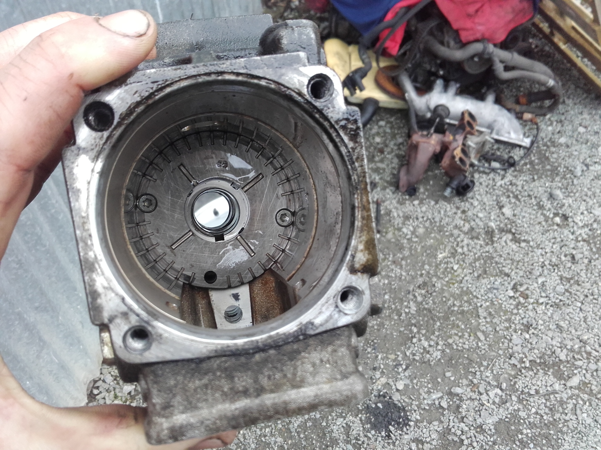

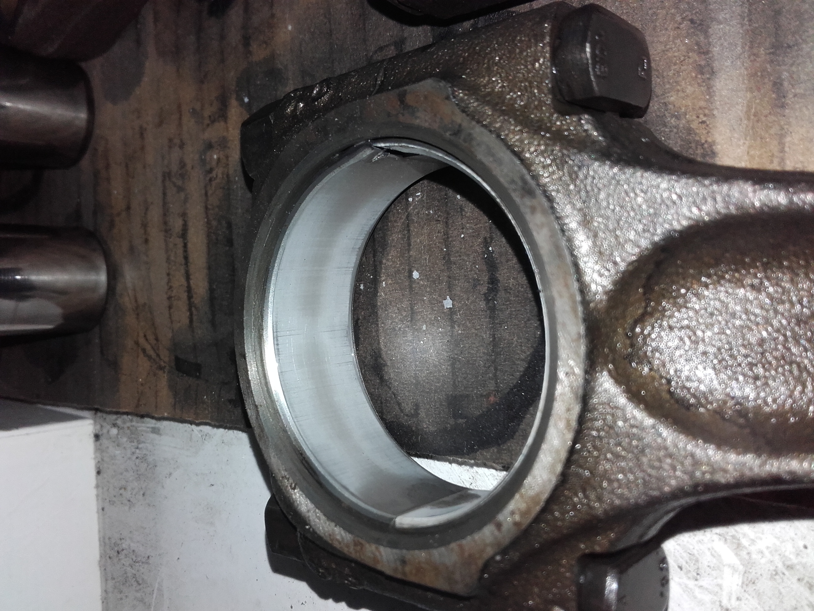

Them bearings look good?

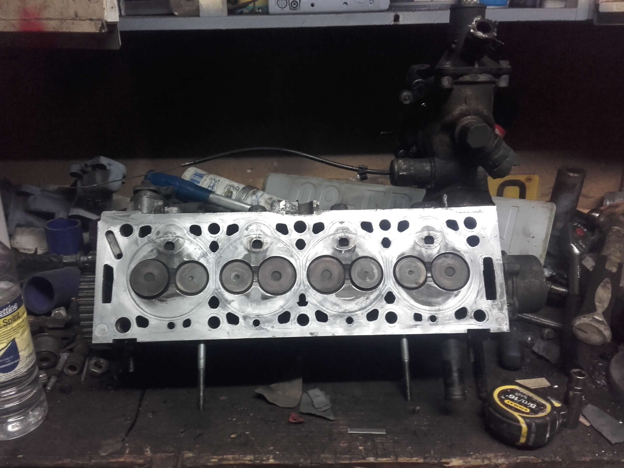

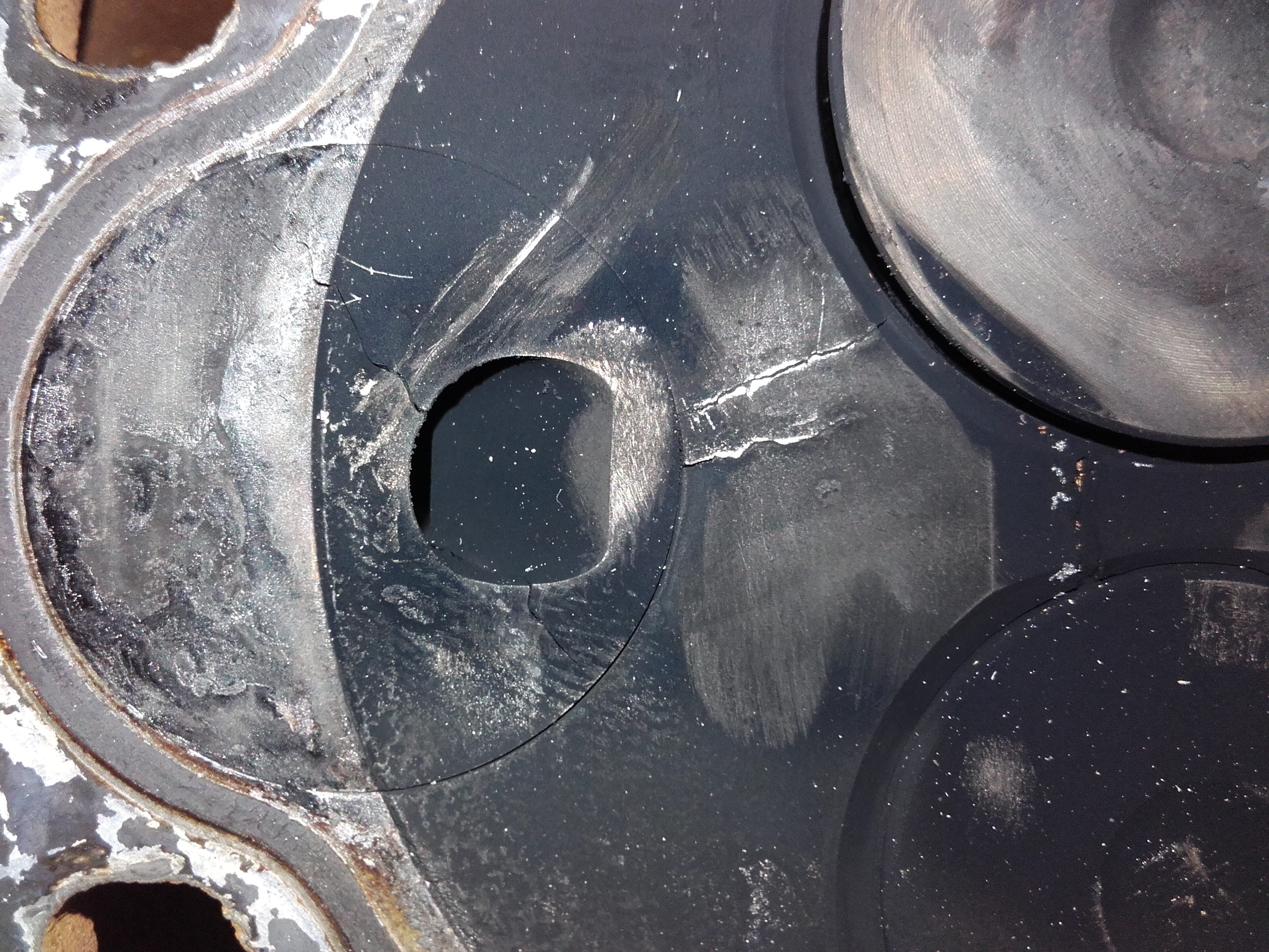

And hers the cracks on the precups and on tge head itself. Dont know if its usable

None of the pictures are working. If there are cracked precups then the head is scrap really.
They can have little cracks in thats usual. Its when they get big and take the head out. Not that i have any experience in precups killing heads......... ......

Seem to be working fine now, perhaps it was my end with the problem. Now i can see the pics i still reckon that's past it.
Yeah i had that feeling. Ill strip my other engine down 2moro and compare heads, hopefully the other one is in better condition.

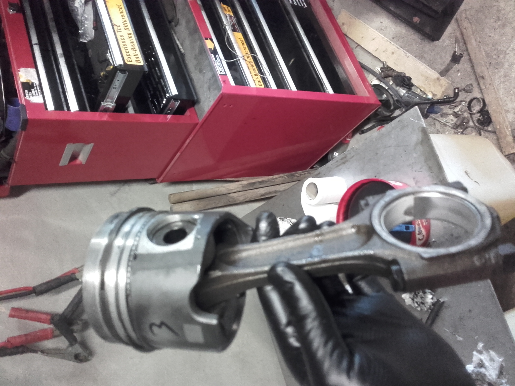

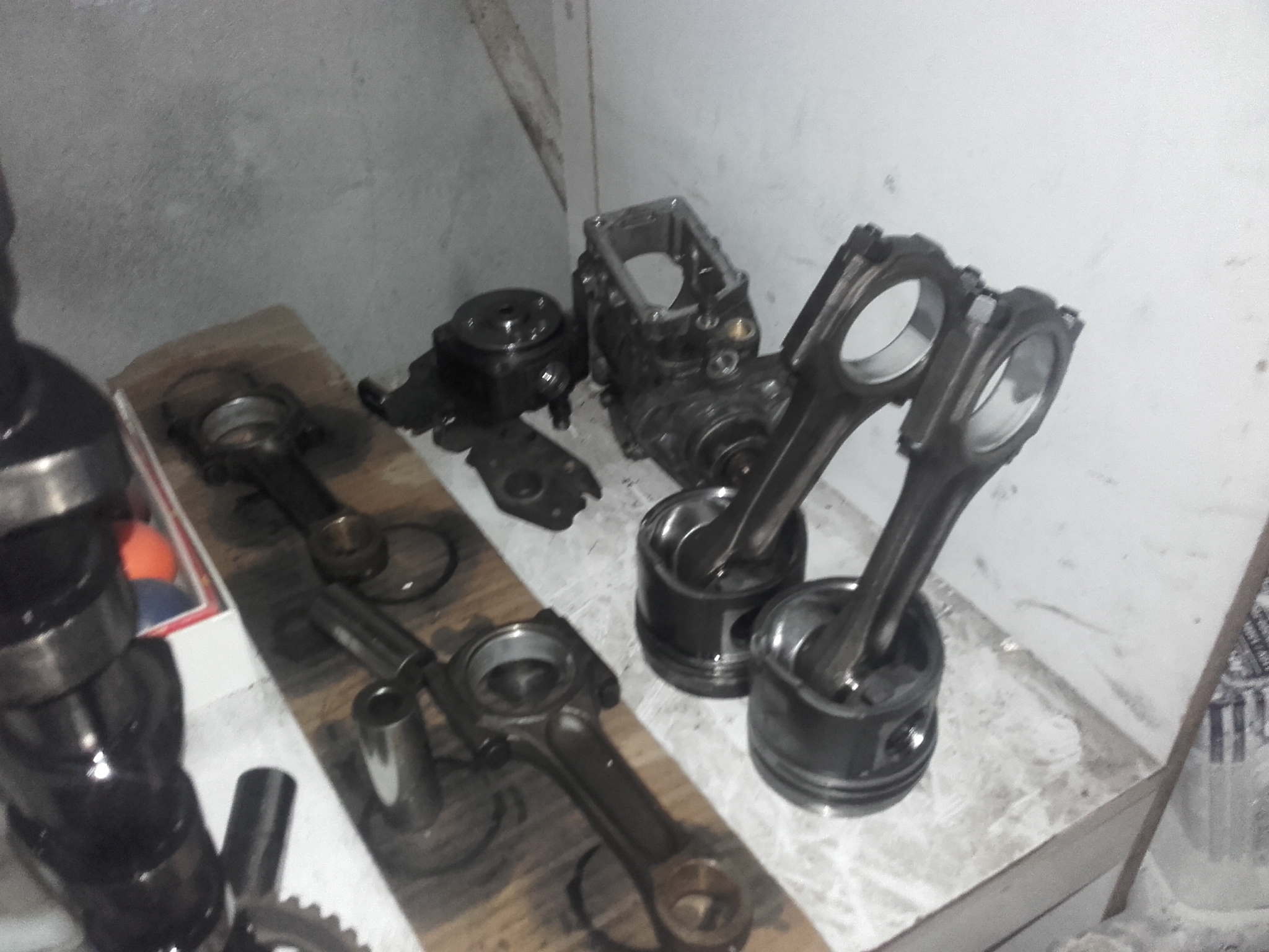

Was out doin some more engine work 2day. Got 2 pistons cleaned up and fitted the hdi rods to them.
                                                      HDI D'Turbo Daily Driver ---- XUD D'Turbo Project
Rods fitted

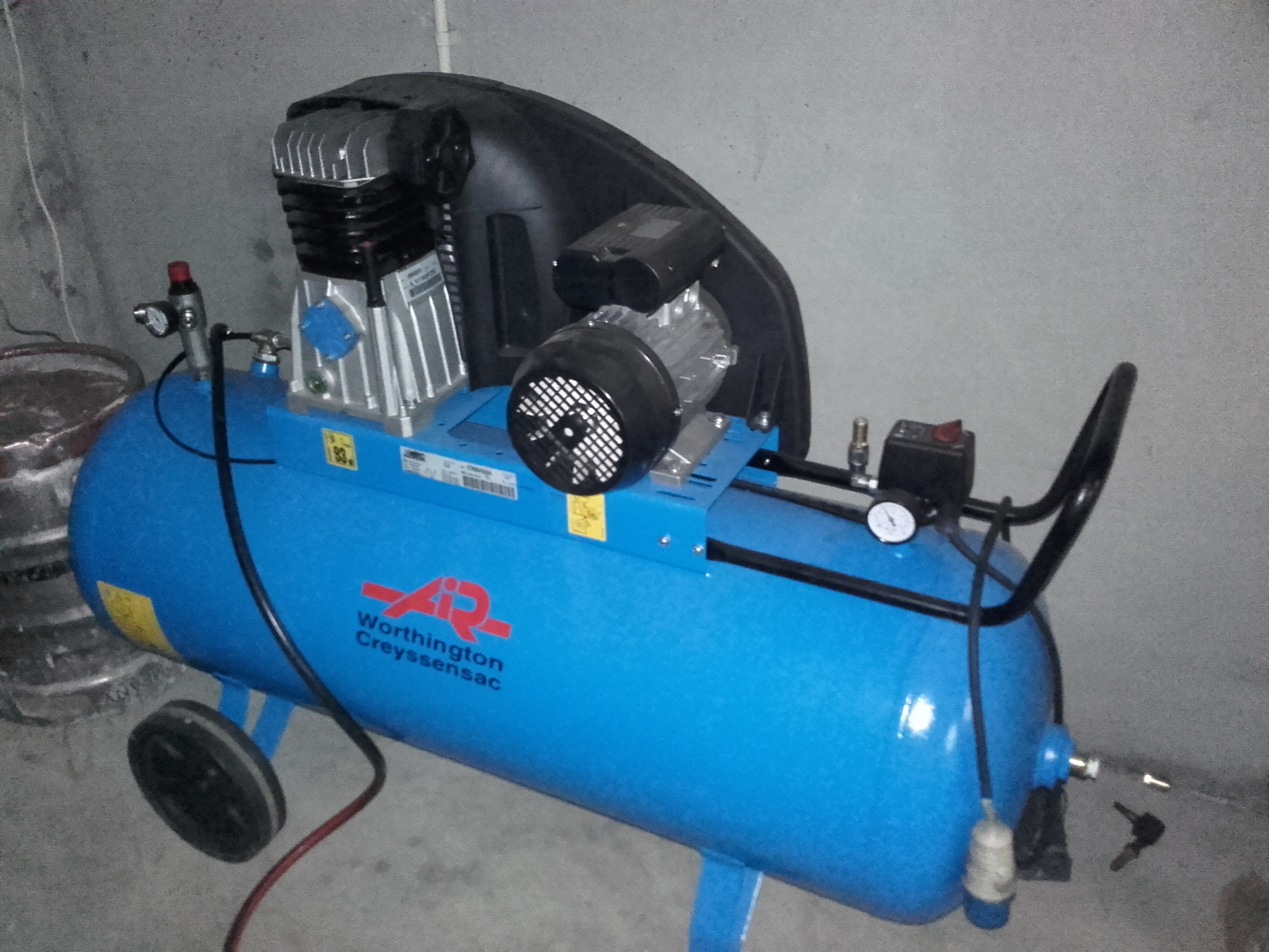

And new compressor Smile

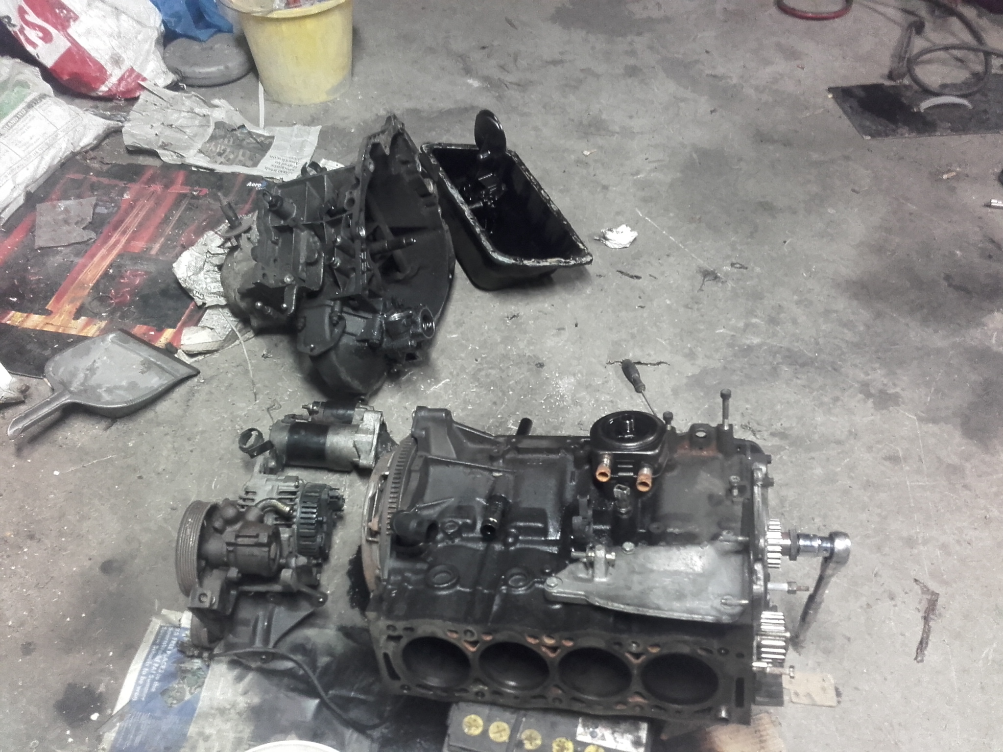

How the block looks now

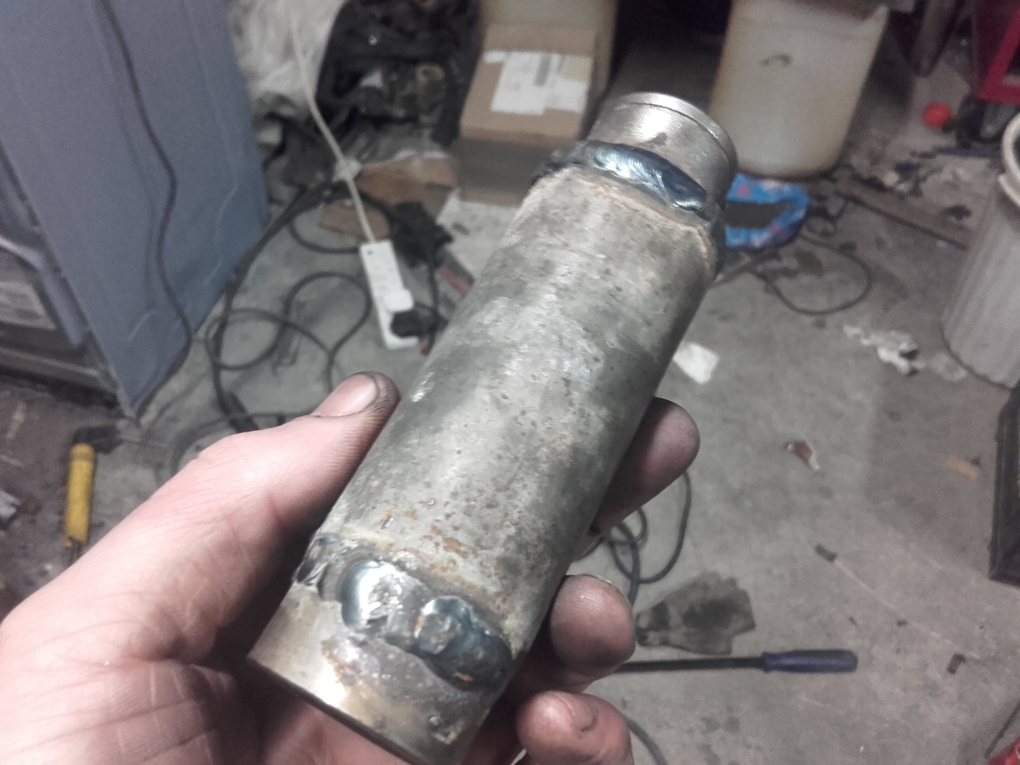

Homemade injector socket FTW Smile
