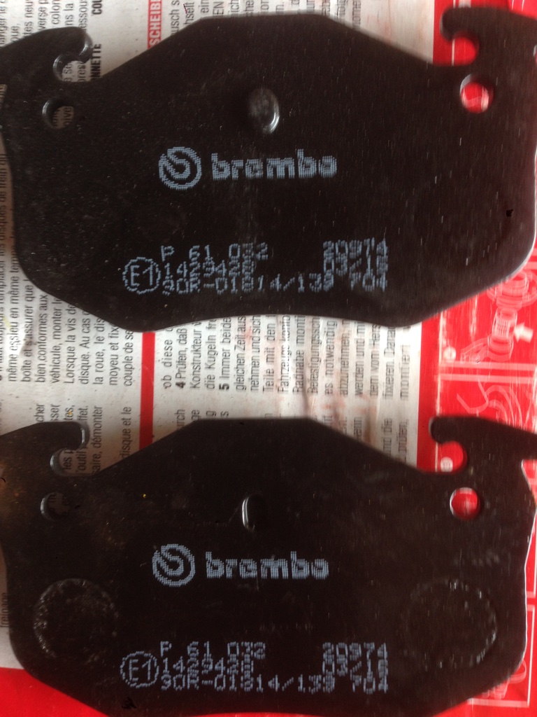

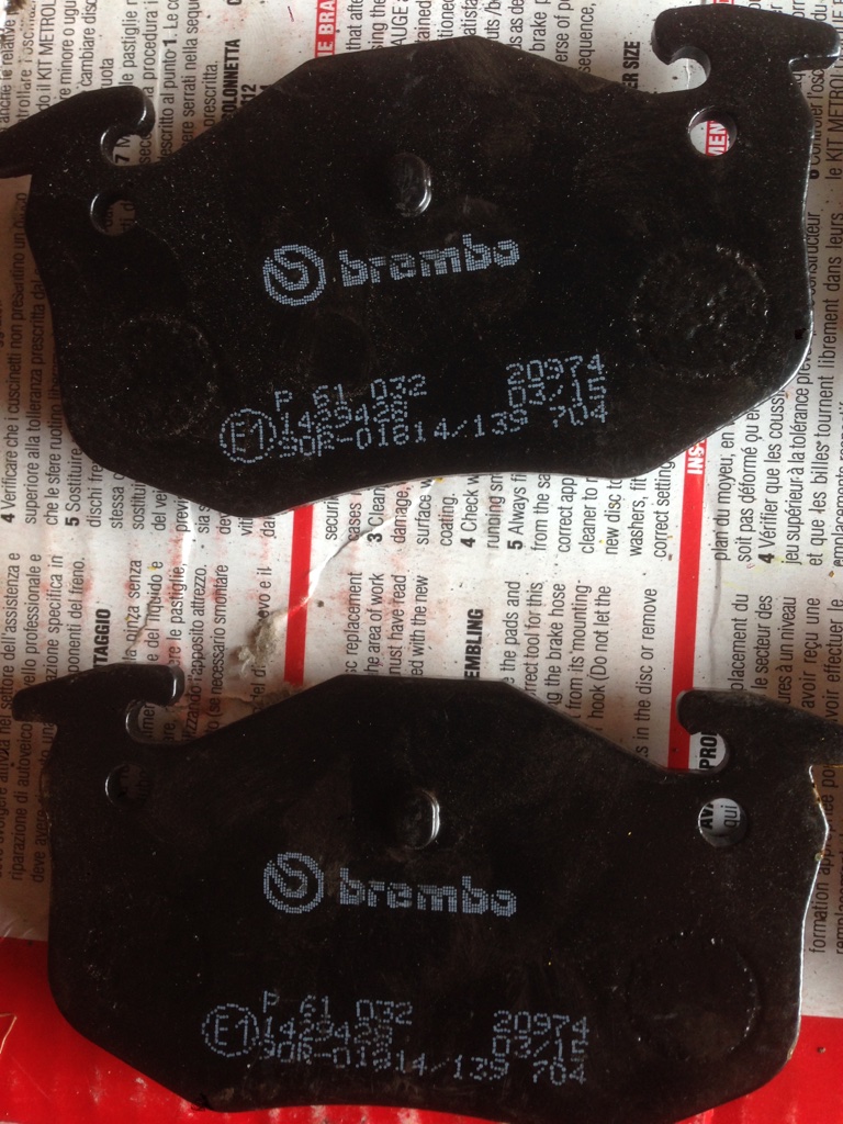

the pads arrived but 3 are the same and 1 is different which seems odd.
3 of the pads have nipples (not the best descriptive word) and the other one has a dimple

Do I need 4 pads with nipples or
2 pads with dimples and 2 with nipples?
I'd say they have given you one wrong one basically.
that's fine, just put it on the outside.
If the ones that came off had a dimple against the piston then they were fitted wrong

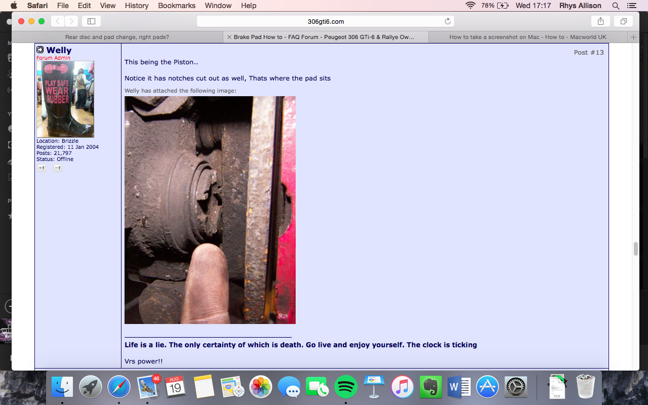

This is what they mean by notches in the piston, the guide on .net also says the bump on the calliper is supposed to slot into here (sorry for the screenshot don't know how to edit pictures yet)

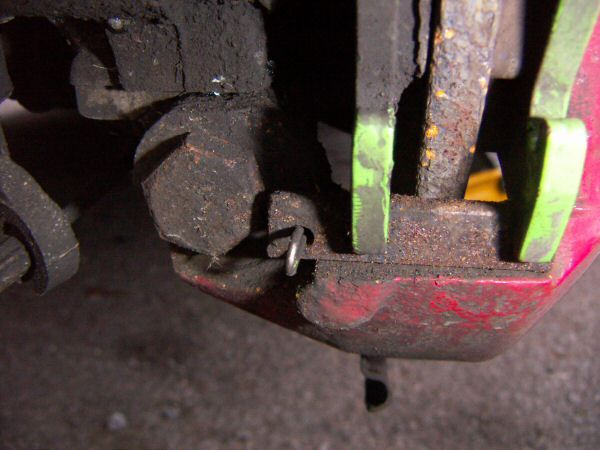

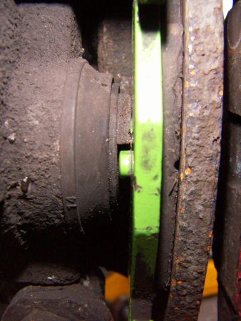

It fits like this
Has anyone got a picture of what this pin looks like on its own?
Only reason I'm asking is because I can't remember taking one out when i removed the pads but I kept everything I removed so if it had one fitted it'll be about somewhere, if not anyone know the part number?
Meh, it's just an R-clip, as long as there's a pin in there it'll stay in (I see loads with split pins in). Just make sure there is something in there, otherwise your pads will go walkies.
