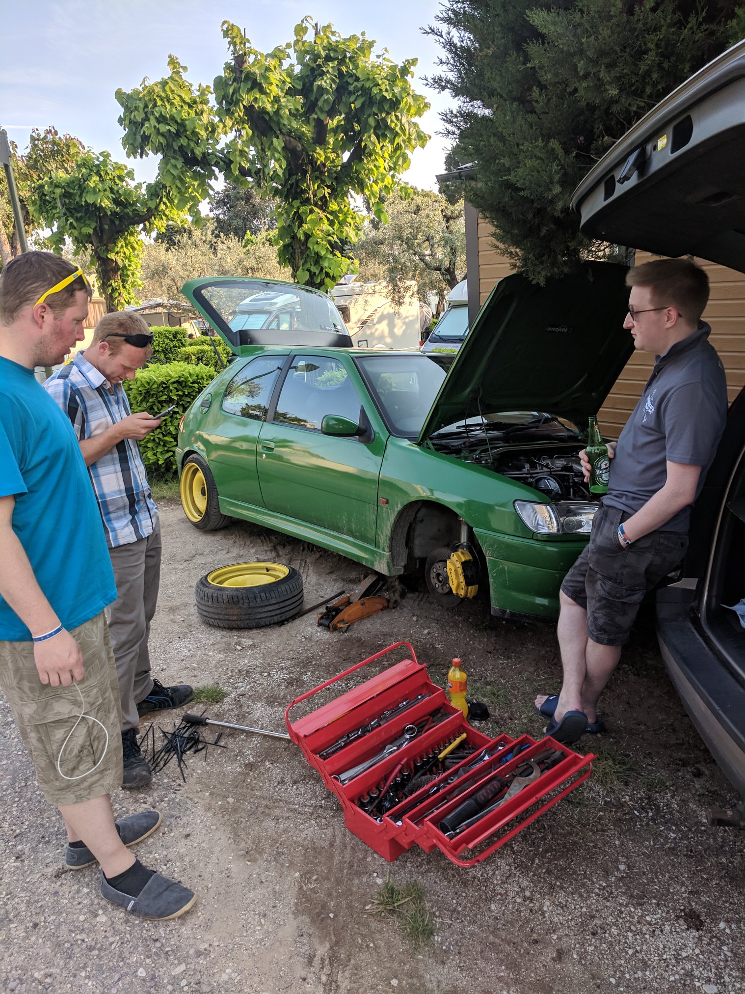

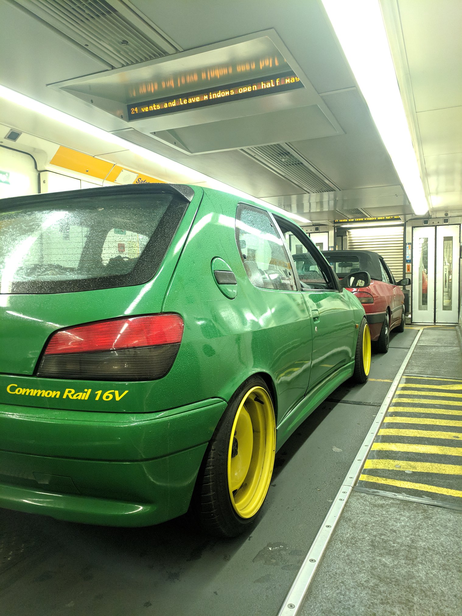

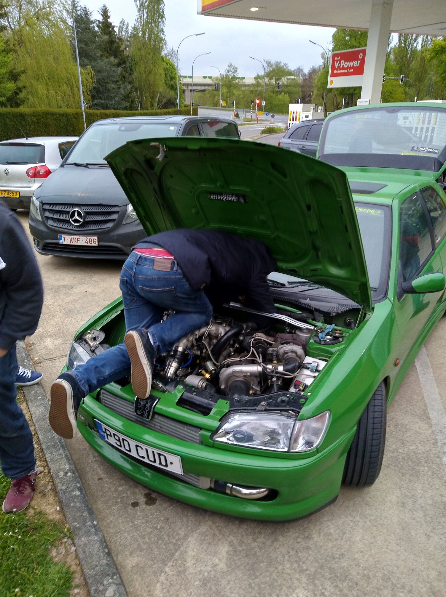

Nothing exciting to report but thought id at least update this thread with some photos from the eurotrip a couple years ago.. (pre covid!!)
Havent been on here in a long while, but just a post to say the green machine is still alive and kicking!
