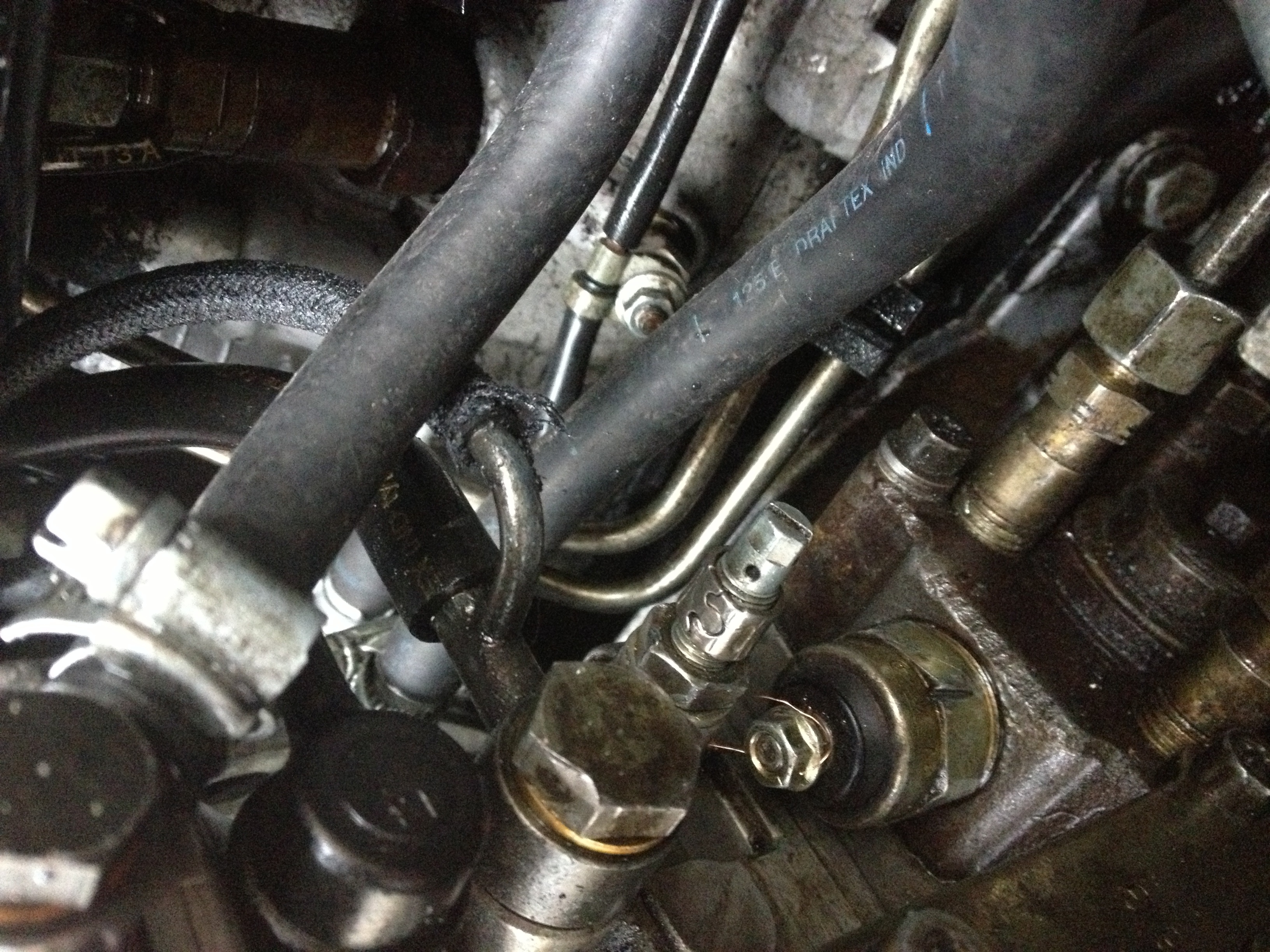

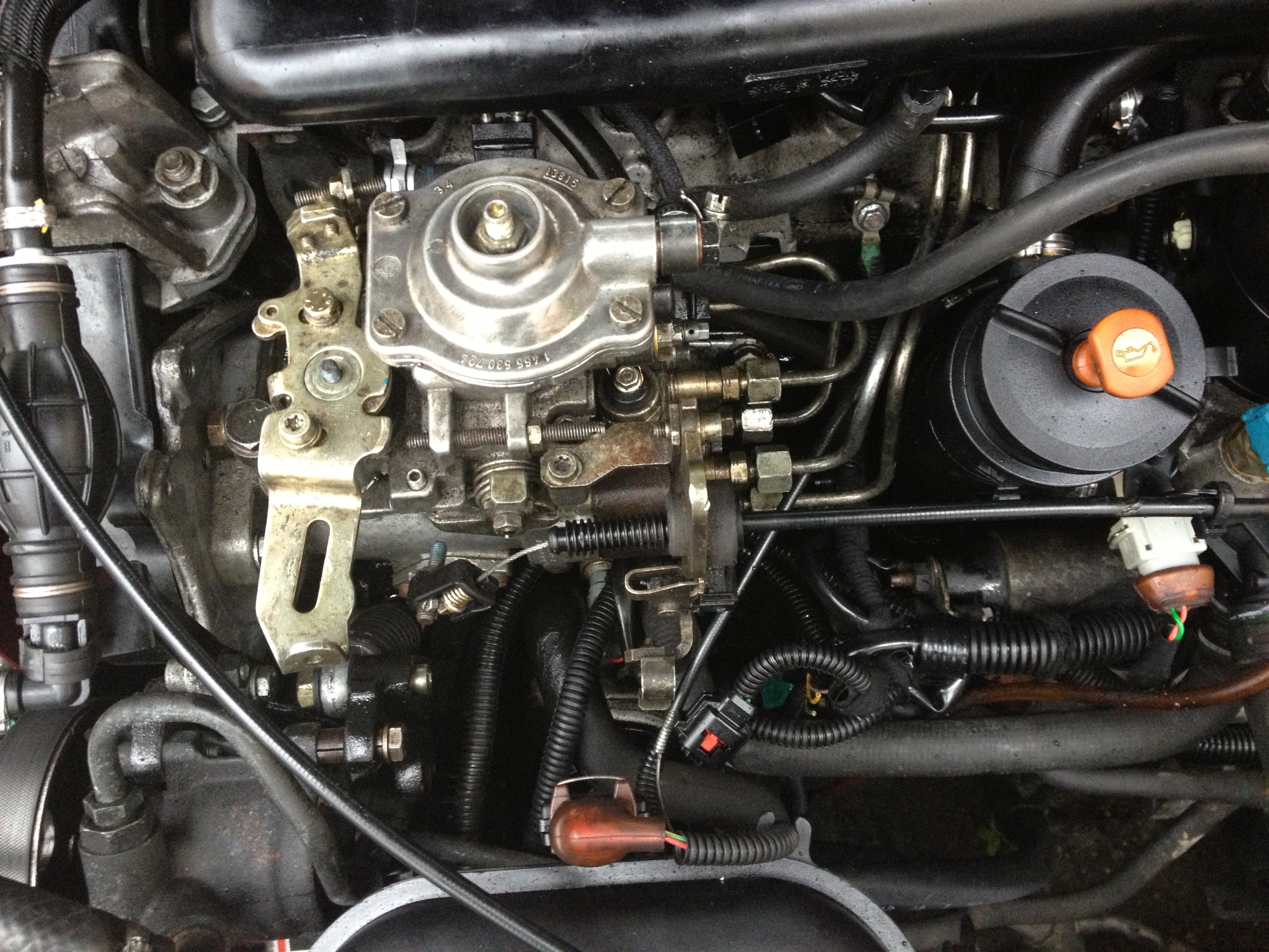

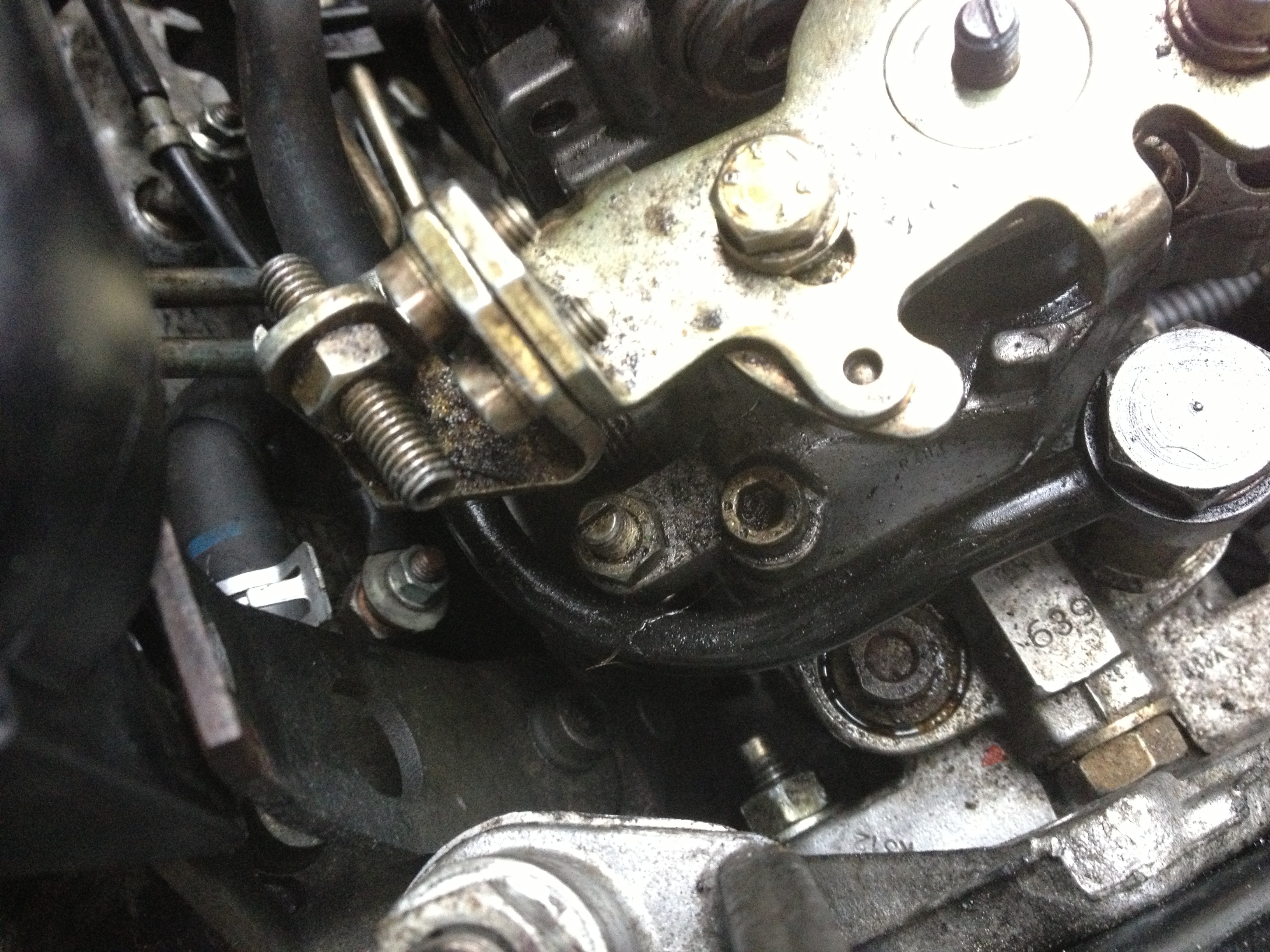

erm....
your throttle cable isnt connected to the throttle arm! lmao
try that!!!!! lmao
AND theres no spring under the throttle arm!!? Huh
and the max fuel screw is not even half way in! The warranty seal is still on it even!!!!
who fitted this??
Puggy306 wearing a blindfold while being attacked by bees?!
AND theres no wire on the stop solenoid...not sure how you even got it started!
The more I look the more silly things arent right with it!
Haha sorry I took these pics half way through putting the throttle arm back on, I was just seeing if it was adjusted properly
that boost compensator hose looks a little weird too.
(15-09-2013, 05:28 PM)Tonibruce Wrote: Haha sorry I took these pics half way through putting the throttle arm back on, I was just seeing if it was adjusted properly
that makes some of the pics a bit useless then really.
so IS there a throttle arm spring?
and where does it rest?
and is that how you have the max screw positioned at the moment?
Lets start again:
that waranty seal needs removing asap from the max fuel screw.
you need to wire in the stop solenoid...not sure how you even started it without it wiring in....I would hazard a guess that THIS IS YOUR ISSUE!
unless its different, the throttle arm spring is needed!
The return fuel pipe needs a hose clip as does the boost compensator pipe on the intercooler end of the pipe.
Right I have put it all back together now and ill get some proper pictures tomorrow for you, and there was a wire to the solenoid but I just removed it
That be cool...if you dont get any replies with new pics, PM me as I be busy this week. We'll figure it out Smile
PS get some pics of the wire you have going to the solenoid, the throttle position at idle, the max fuel screw too
