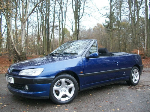

I bought the car on the 3/1/12 for £1400 with 6 months tax because there was one picture on the advert that sold it to me.
[attachment=23]

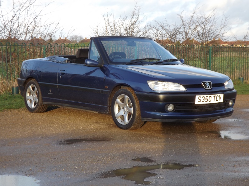

So I got It home and did the typical pug owner thing and took loads of pictures, the china blue is absolutely beautiful in the sunlight.
[attachment=22]
[attachment=21]

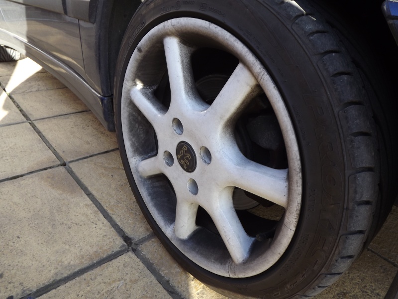

About a week after getting the car I bought JonnyBs SP wheels off him and they look lush on the car.

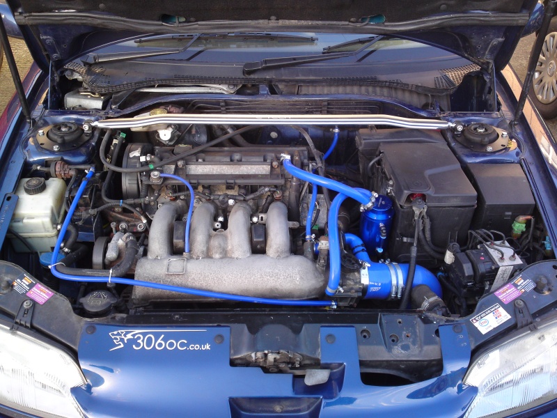

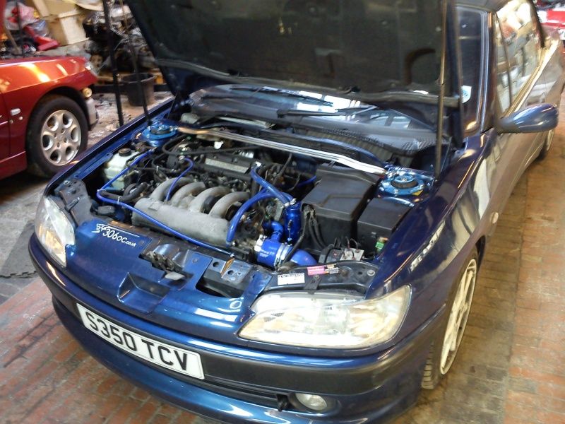

I also Fitted a GTi6 Inlet manifold Id bought before I even got the car, an enclosed induction kit, a strut brace and an oil catch tank. I also serviced the car but the pics of this arent interesting.

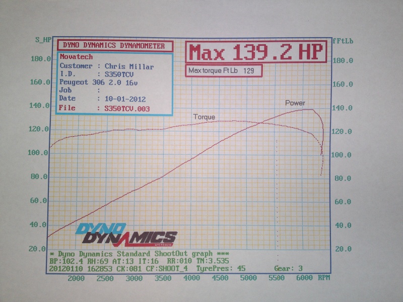

I took it to the dyno Like this and it made just shy of 140bhp.

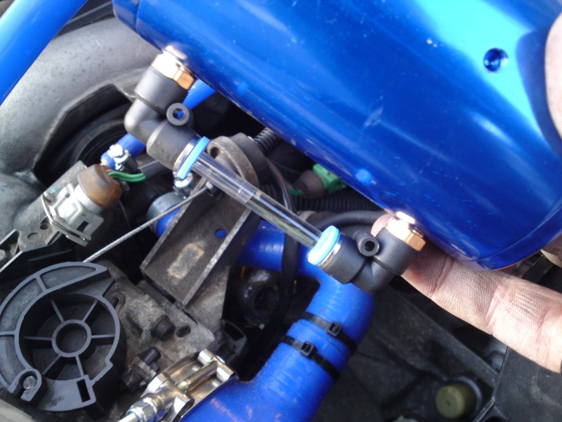

A few days later I noticed the oil catch tank was filling up quite quickly with what looked like very fresh oil but its not, I drained it out and it is in fact condensation (water).

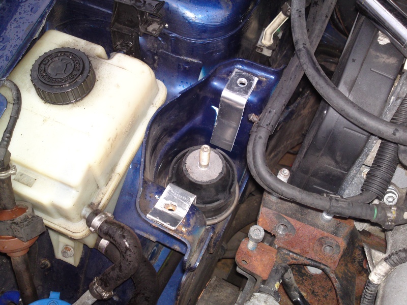

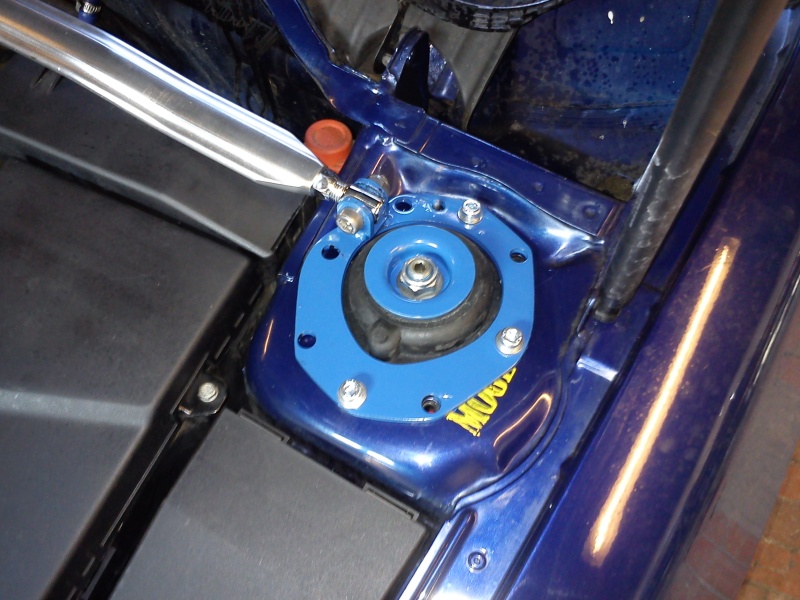

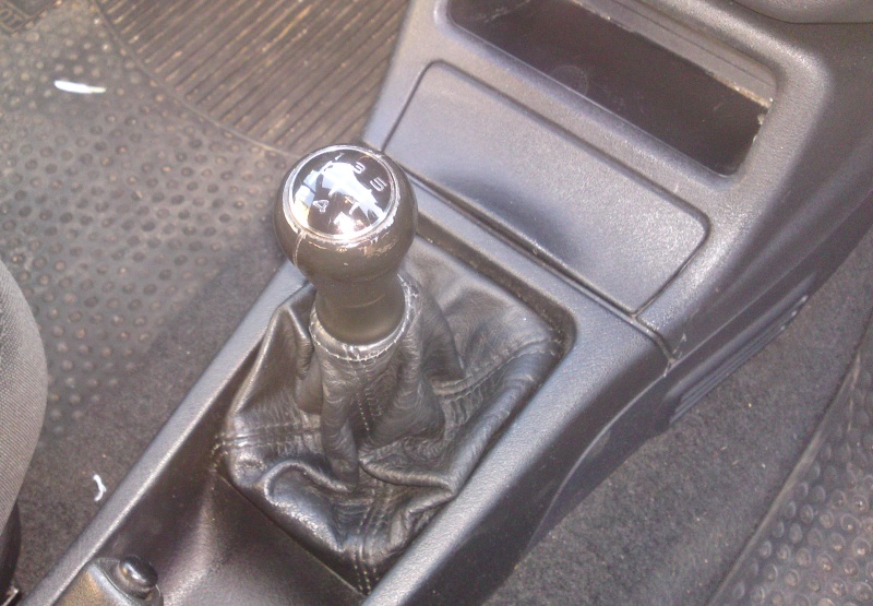

Near the end of January I fitted a set of group N engine mounts and chocked my upper engine mount as it was jumping about a bit on acceleration and deceleration.
This has solved the problem and the car is much nicer to drive with no engine movement, there is a couple of rattles but i can live with them. I also fitted a 406 gear knob at the same time.

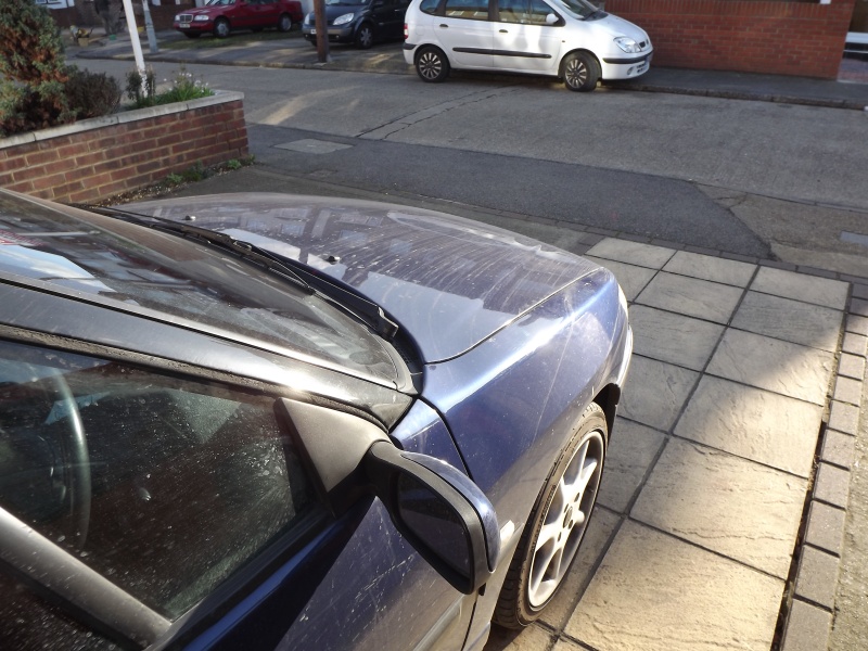

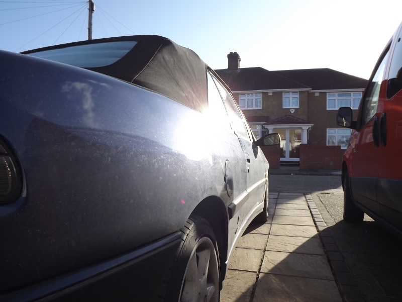

The cabby seems to attract the grime and road salt but it does leave pretty patterns on the bonnet. It only takes about 2 days to get to this state.

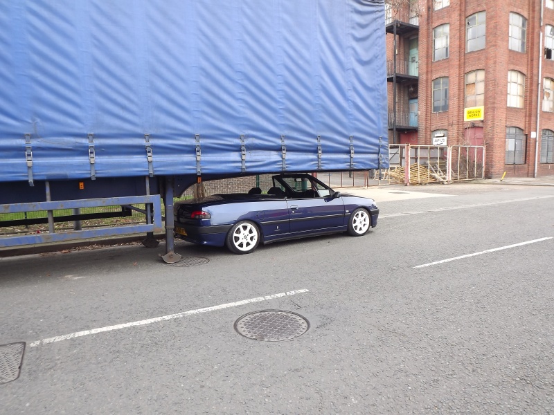

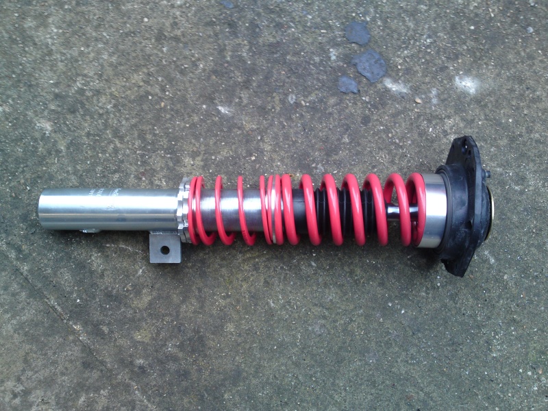

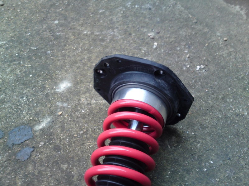

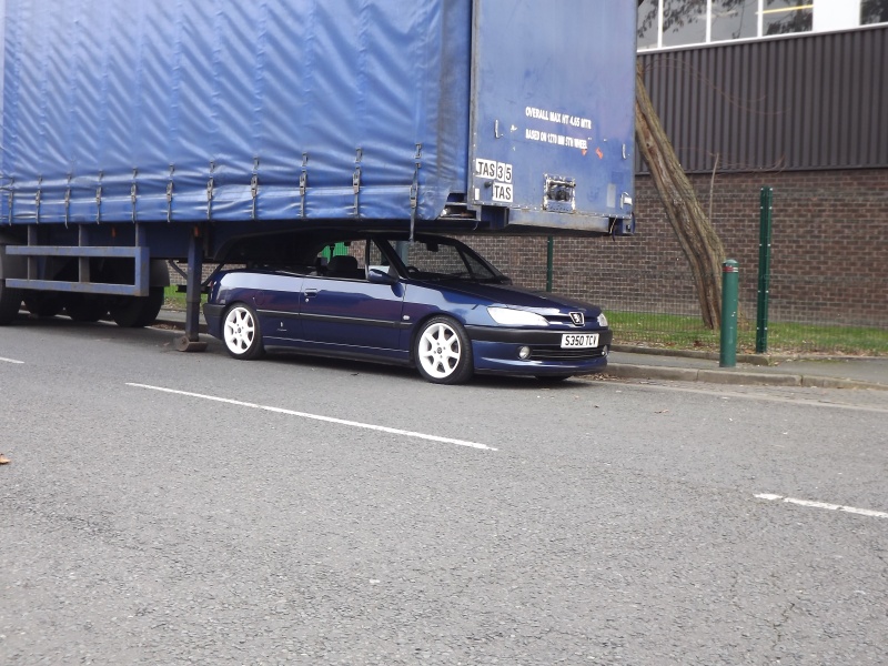

Next on the modifying list was lowering so I fitted cheap ebay coilovers (less than £150 delivered). I fitted these with brand new top mounts from pug so I didnt have to take the old struts apart. Im running with an inch of thread left at the bottom but I desperately need stiffer springs. These were fitted with some new wishbones and drop links too.
[attachment=10]
[attachment=9]

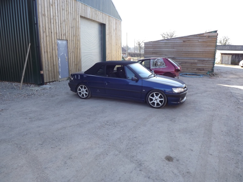

After fitting the front suspension myself I took the car down to <!-- w --><a class="postlink" href="http://www.krisb.co.uk" onclick="window.open(this.href);return false;">www.krisb.co.uk</a><!-- w --> to have my torsion bar lowered. He dropped by the exact amount I wanted in little over an hour. He also helped fit a couple of bits id painted for the engine bay.
[attachment=8]
[attachment=7]
[attachment=6]

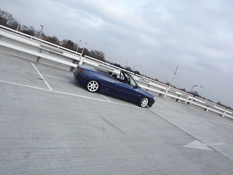

I finally got round to giving the car a proper wash and megs wax so thought id better get some pictures.

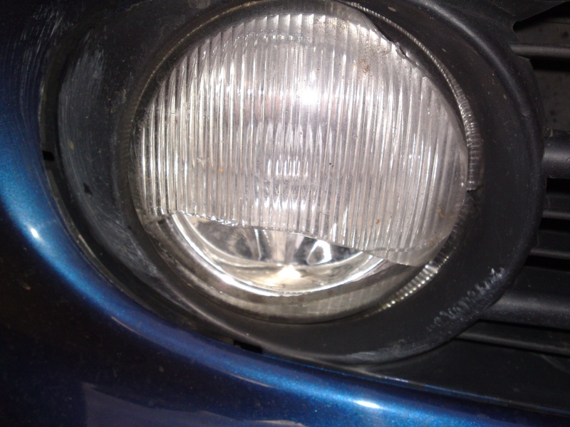

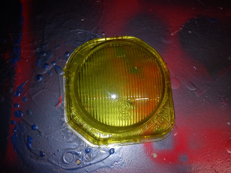

Actually as youve posted you reminded me, I did my first fog light today.
Spent ages after peeling the protective clear film off the yellow film wondering why it wouldnt stick. Turns out it has a protective film both sides.
Its supprisingly thick and I managed to smooth and stretch it over the main bit of the lense with my thumb, the rest of it looks a bit shit but you wont see that.

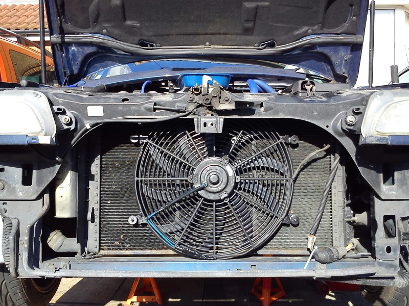

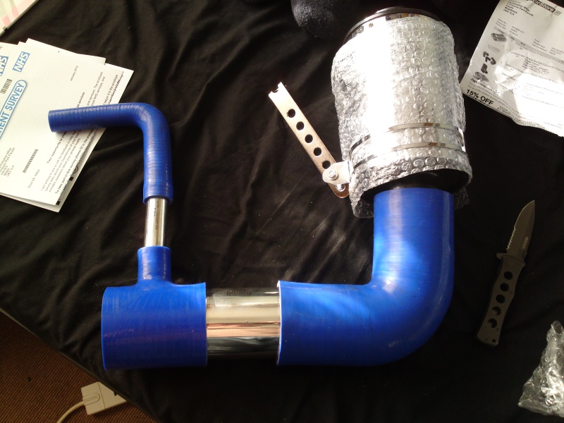

Replaced my crappy little standard 10" fan with a BFO 16" slim line fan off ebay
[attachment=1]

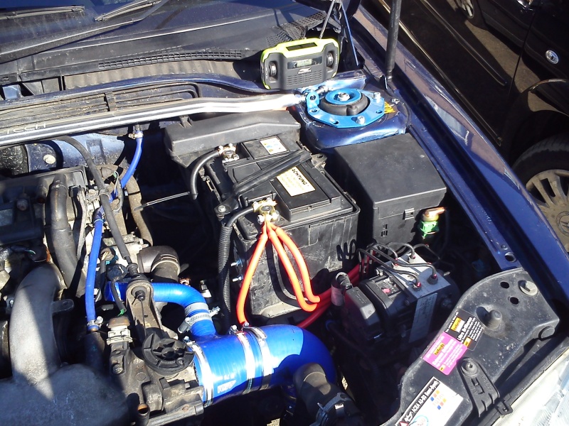

Got round to upgrading all the earths and most of the lives to new thicker cables to try and get better performance out of the electrical system. (also moved the catch tank a little but no pics of that.)
[attachment=2]

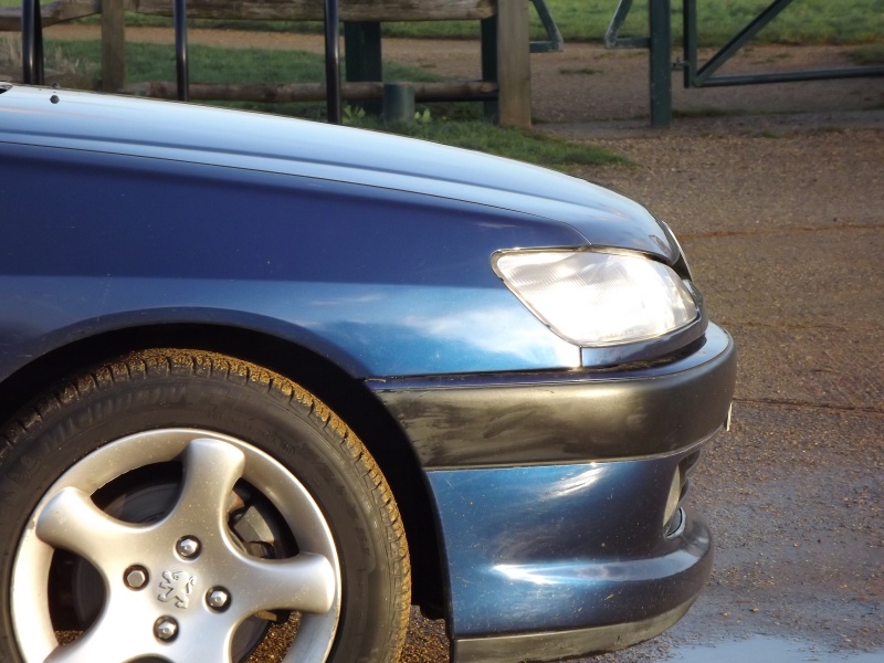

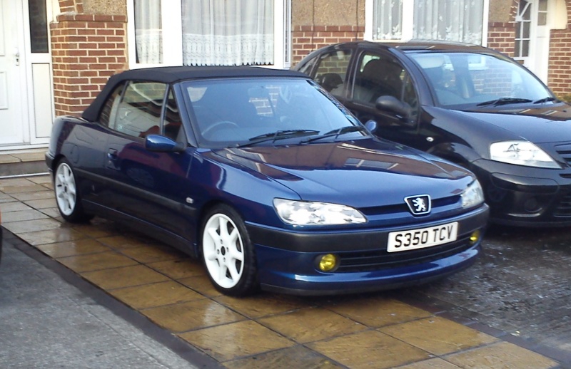

Swapped my crappy broke fogs for shiny yellow ones.
[attachment=3]
[attachment=4]
And just to prove to Jonny I do occasionally clean the wheels
[attachment=0]
Makes me realise I really need a smaller front plate and probably a black badge too.
