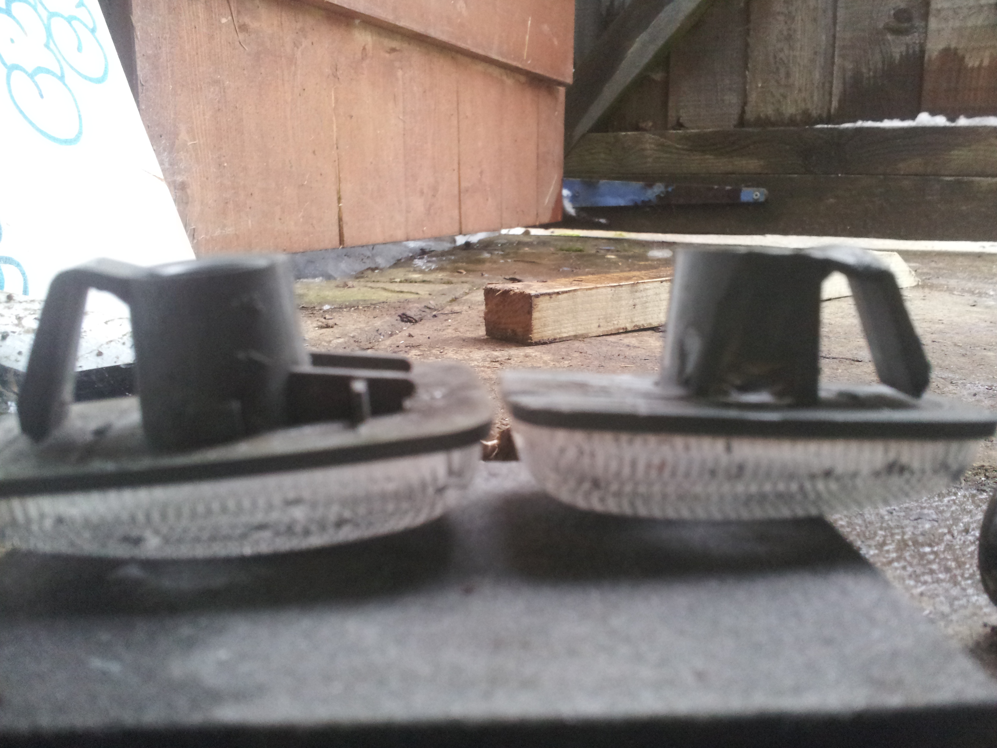

dont mod the wings. file the plastic down on tue repater its self and remove the holding tab on the non springy side. iv got a pic some where.
Attached Files Thumbnail(s)
