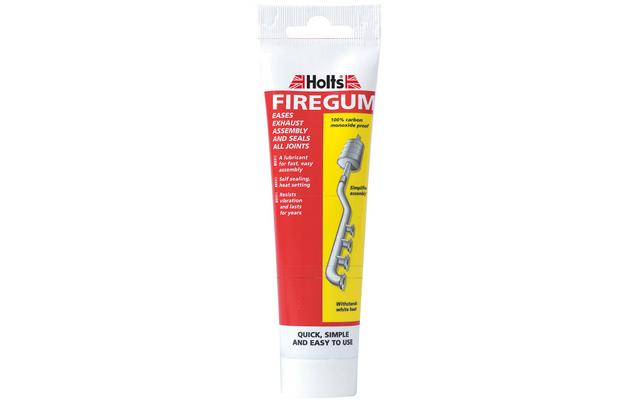

Never had an issue.
defo need gaskets
No gaskets from the factory...
But I just wire wheel the entire lot and give a small smear of firegum - has always worked great for me.

It is temperature and oil resistant. I use it as an exhaust sealant and a gasket maker when necessary, eg. for gti6 cam covers.
Just offering an alternative as I don't like firegum much for exhausts and really, really don't like gun gum at all: it is water soluable....and an exhaust has water flowing through it! I know this is a different application but still.

turbos and exhaust manifolds get to more than 350c so that silicon in useless
Couldnt find no firegum today so just gonna order it offline
*online

Clean (wire wheel...), degrease, use sealant of choice.
I've always used firegum and never had a problem, as long as you don't go mental on the amount you put on - just whatever you do, don't put it together and then start it and rag it up the road, it'll still be wet and it'll just blow out the sides. Leave a few hours and then start and idle for 5 mins and it'll warm up enough, stop and leave for another few hours and it'll be fine.
The way I see it is that the flange isn't moving, once that paste is in there and it's set, it's not gonna get pushed out or anything. I've had some SERIOUSLY warped adapters that I've not even bothered flattening and sealed them fine with firegum. Long as it's set and you don't rag it up the road in the first 30 seconds, it'll be fine. Make sure your fasteners are good and you actually torque them up correctly.
(23-08-2017, 10:57 AM)Ruan Wrote: Clean (wire wheel...), degrease, use sealant of choice.
My biggest worry has been putting to much in and it squeezing out and posing as debris to hit the exhaust wheel.

I've always used firegum and no gasket with no issues.
Would do again as well.

Cheers guys [emoji106] got some ordered
