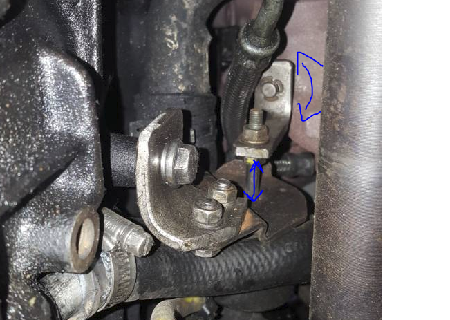

I've just noticed the wastegate actuator angle!! Is that supposed to actually work lol!?
(10-08-2017, 10:54 AM)Ruan Wrote: I've just noticed the wastegate actuator angle!! Is that supposed to actually work lol!?
That was an experimental lash up over a year ago that worked and has actually lasted some how! Always planned to re do it but when i went back to it i just couldnt see how id fit anything else down there! Its opperating on a gt15 actuator as i couldnt fit the 52s one down there. The actuall bracket on the cold side had to be shaven off to clock it correct and miss the bulkhead.
With this dodgey setup it boosts 1bar dead with the mbc shut off
Would be intrested to see how frostys got his to fit. Just struggled to get my head around the limited space.

yeah madness, just need to rotate the wastegate tab 90 degree so it isn't just fighting itself close. or weld another tab on at 90 degree
(10-08-2017, 01:57 PM)zx_volcane Wrote: yeah madness, just need to rotate the wastegate tab 90 degree so it isn't just fighting itself close. or weld another tab on at 90 degree
Dont mean to sound retarded but could you sketch up what you mean? That pics showing the old oil feed but gained some room from the new one
At present, that will be holding it either open or shut to some extent. The wastegate is supposed to move either left/right.. crude paint drawing.. arrow on the actuator is the way it will be moving on/off boost, which as you can see means it won't be opening or closing the wastegate flap atm
Ahhh right im with you. The actuator isnt actually run off axis. The stroke is still almost perfectly linear.
The L bracket you see attatched to the wastegate arm was needed for the additional clearance.
To try prevent it twisting on the wastegate arm it was drilled and ground to as closer tolerance i could without it binding on the arm when moving.
Its actually holding it shut with preload in that picture. Preload is set at max which relates to 1bar of boost pressure
Justin_306DTurbo
306 Ph1 Dturbo Sedan
306 Ph1 Dturbo Estate (VNT)
Partner Ph1 (XUD Swap)
306 HDI Stage 3 Estate (RIP)
you want your actuator arm to be at this angle to the wastegate tab
yours is straight on
be like trying to open a door by pushing along the edge when its closed - rather than on the face of it
(10-08-2017, 02:24 PM)zx_volcane Wrote: you want your actuator arm to be at this angle to the wastegate tab
[Image: 0e012c4897a89656190d41a382cb4cf9.jpg]
Ahh ok think im with you. This prob shows how it sits abit better
reveals all yah, should be fine!
Yeah that makes sense now, oil line was hiding where it connected in the other pic
Lol phew, yeah, OK!
Was going to say!!
