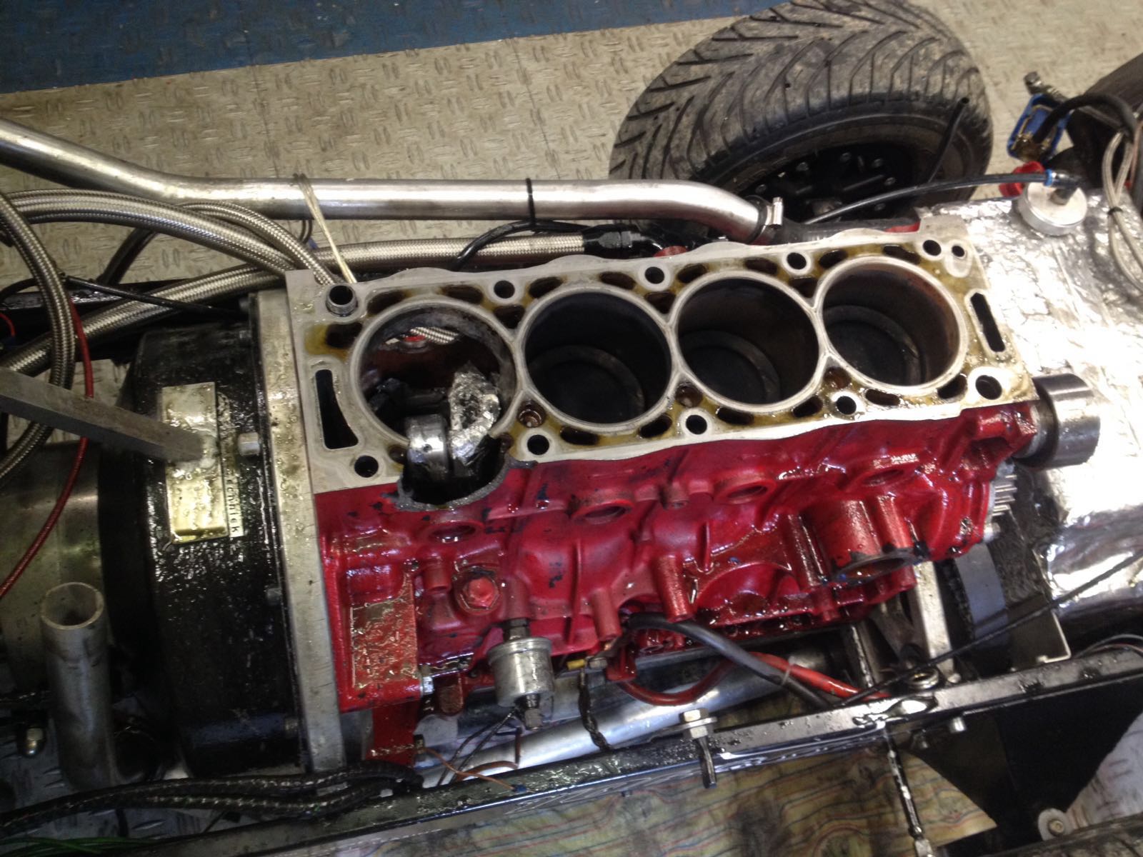

Hmm that previous post of mine now I read it back sounds wrong. The incomplete burn WAS an issue. But not the reason I bent a rod. As quite a few already know on here I may have ran it a "tad" advanced. For a week. Because it was my daily and had no time to swap timing around again. Hey ho. Live and learn I guess.

Before:
[Image: 1z3uko4.jpg]
After:
[Image: 73mkhj.jpg]
[Image: egxp2u.jpg]
merry christmas Wink
If you want extra valve pockets in your piston there are other ways? ;-)

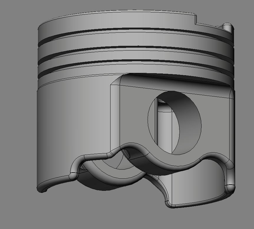

Only for fun my first brakedown, new piston design 86mm bore but skirt broke off:

Started this year with 86mm bore and a DW11 crankshaft but the larger stroke gives more side force on the piston and by scaling from 85 to 86 I made a mistake so the pistons where a lot less strong....
