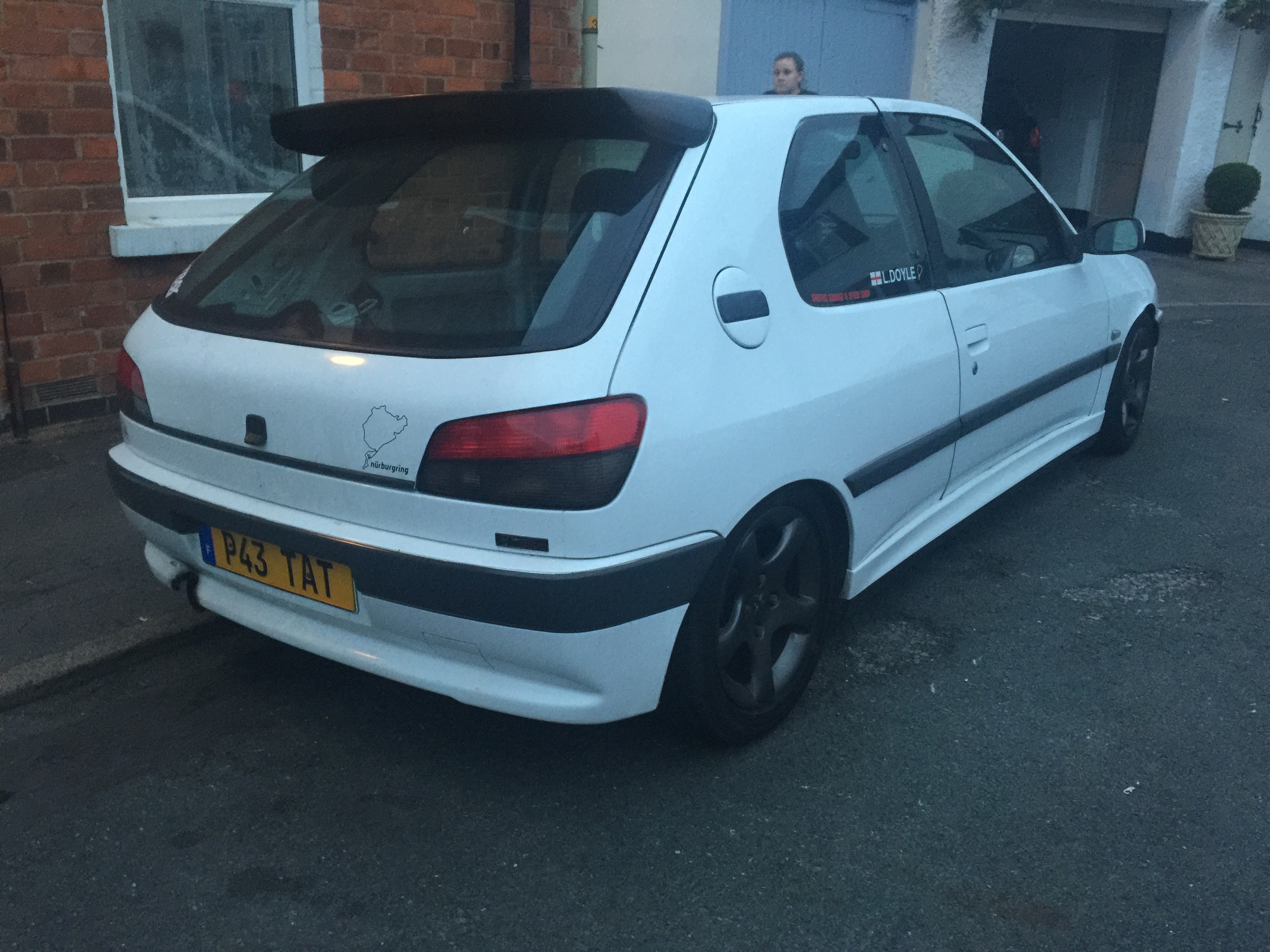

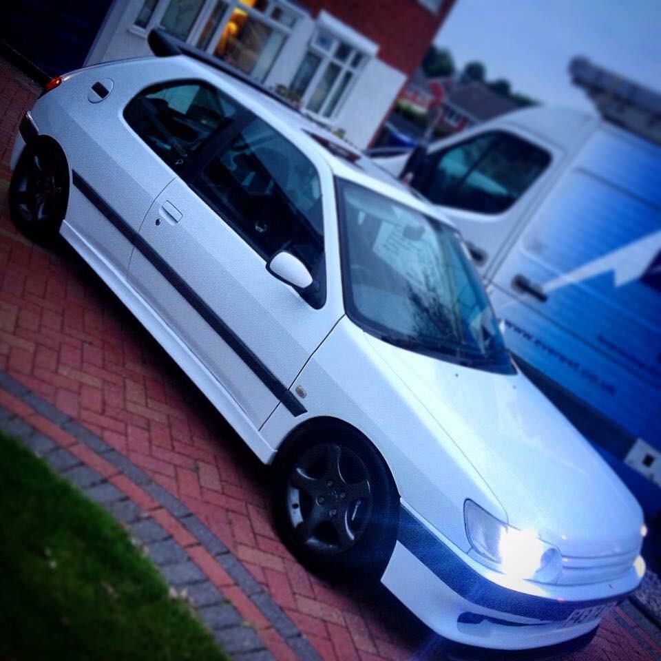

So i kept this quiet but i have traded my 106 GTi for this Ph1 GTi6. Its already had some work done like...
Fast road cams, lightened flywheel, Straight through to back box, braided fuel lines, 1.8 16v gearbox (will put a 6 speed back on, Brembo 4 pots, braided brake lines, Stud conversion, Morette lights, smoothed grill and so on.

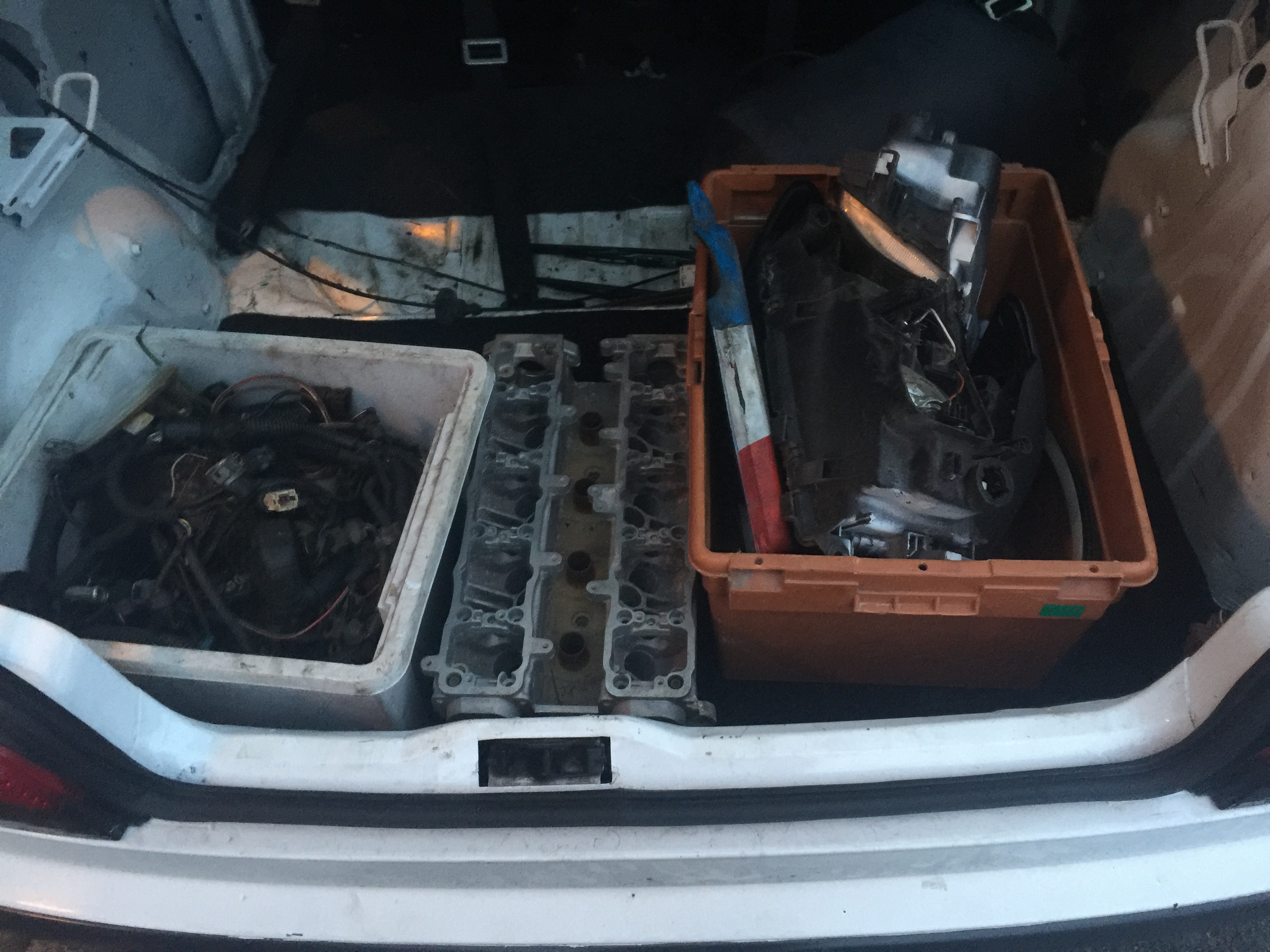

It came with a few spares as well like a head, pas pump, lights and a mix of other things. it needs work but everyone should own a 6' at some point right? so thought it was about time i did :Smile like it and i hope you guys do to.
Get rid of the morrettes and that'll look sweet
Potential there, I'd personally try and return it more to standard/OEM spec... That spoiler looks awful but a white ph1.. Man after my heart there!
Spoilers a bit marmite
Aha I was wandering what happened to this after seeing it advertised. Does it not have that interesting inlet manifold anymore?
Nice buy anyway, you don't see enough ph1 gti6 Smile
yeah spoiler will be changed for a standard gti one Smile i like the Morettes think it sets it off well, I'm going to try source a gti interior so its a bit more standard inside

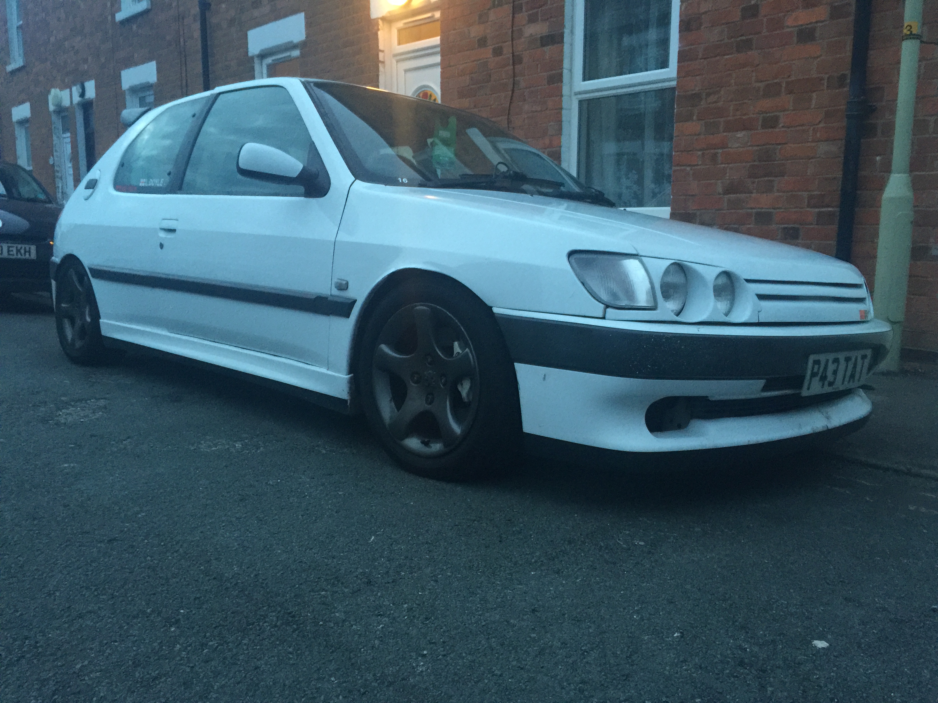

Please put a badged grill on, ph1 look quite mean with morettes but the smooth grill is just horrible imo haha
faaarrr too low !

bin off that spoiler and that's it

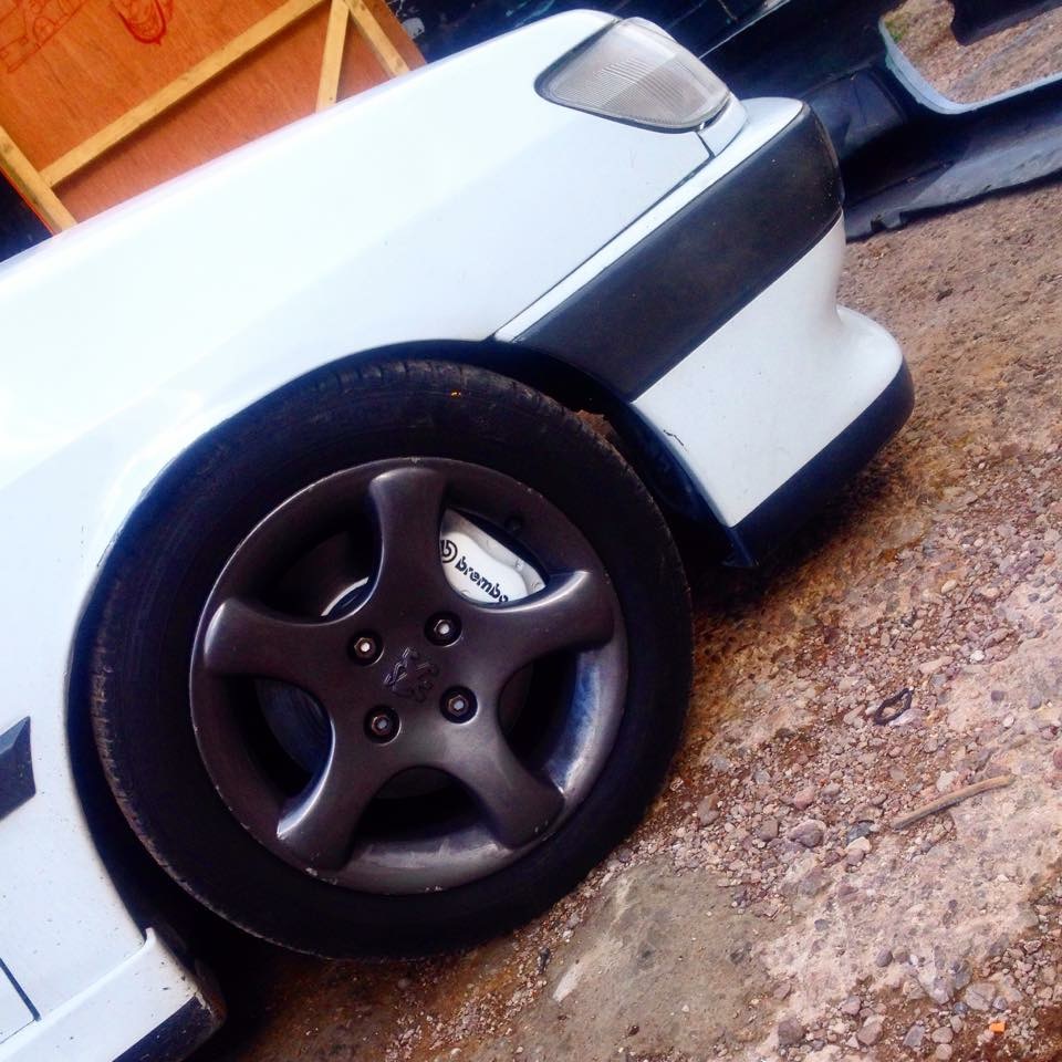

(21-09-2015, 12:28 PM)welshpug Wrote: faaarrr too low !
It is, and it looks like the front arches have been rolled/bashed out slightly?
62k Diablo Phase 1 Gti-6:
Project Thread
Oohh interesting.
Im guessing its heavily rolled wings because the wheels be heavily spaced to allow for brembos
yep, they need a 20mm spacer, effectively making them ET0, that and its fecking low.
Nice car but lose the spoiler!!!!! x
f*cking love it mate! Best colour, and already all the mods you need Wink
Spoiler will be going Smile probably put a GTi one on, it's on coilovers so could adjust if needed and hoping to get a beam built up soon. Need to source an interior for it. Seats, roof liner and all the rear plastics

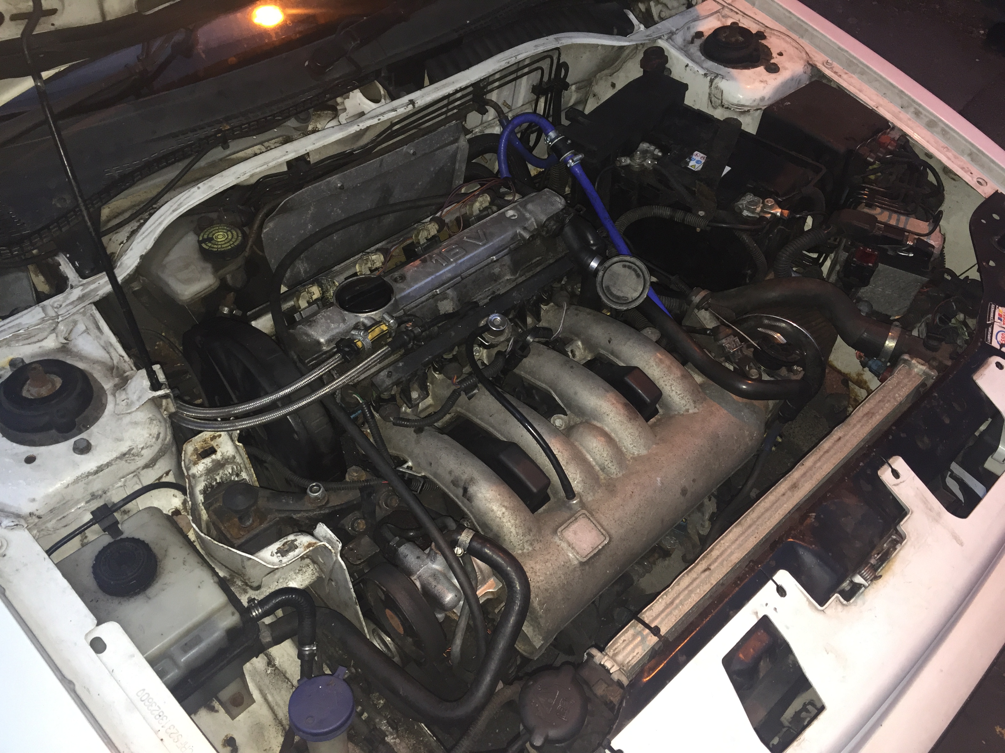

So had a few hours to kill before work so had a look around the car to try sort a few issues. Clutch pedal was feeling horrible. Found out it still had the spring in! So took that straight out and now it's really smooth and light (for a 306)
Next was cleaning up the ICV as far as I'm aware it's helped seems to idle a lot smoother. Found this filter attached to the end of it. Is there suppose to be anything on the end of it like a pipe or is this filter okay?
I've ran it with a similar filter and it's been fine

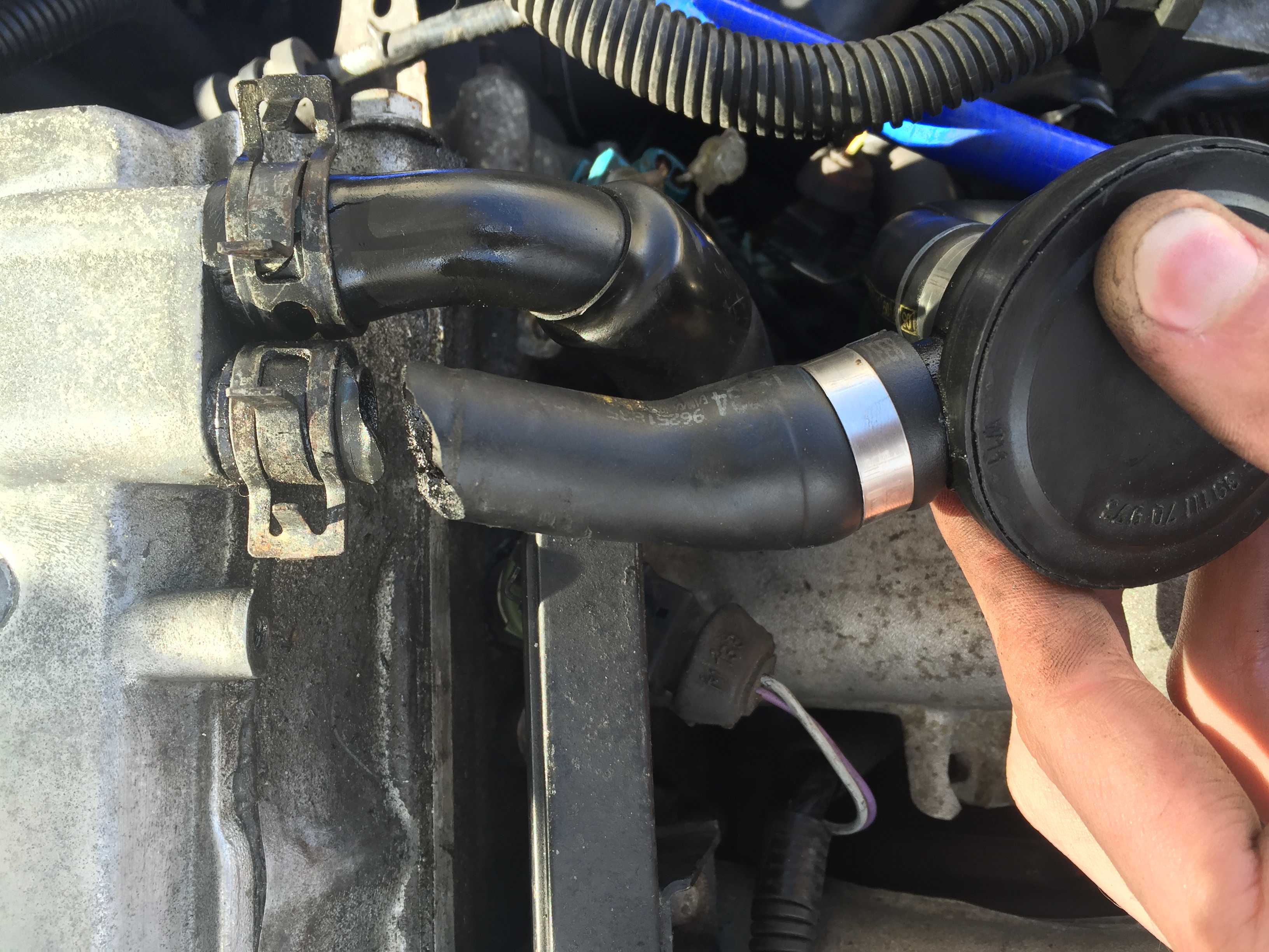

Found this hose think it's a breather? Has split anyone have one lying around? I have hose big enough to go into the cam cover but not wide enough to go into the black thing (don't know what it's called) lol
(22-09-2015, 11:57 AM)Paul_13 Wrote: I've ran it with a similar filter and it's been fine
Ah cool Smile was just curious if it originally had a pipe or something
brass takeoff should have a plastic small bore pipe running back to the vacuum pump.
