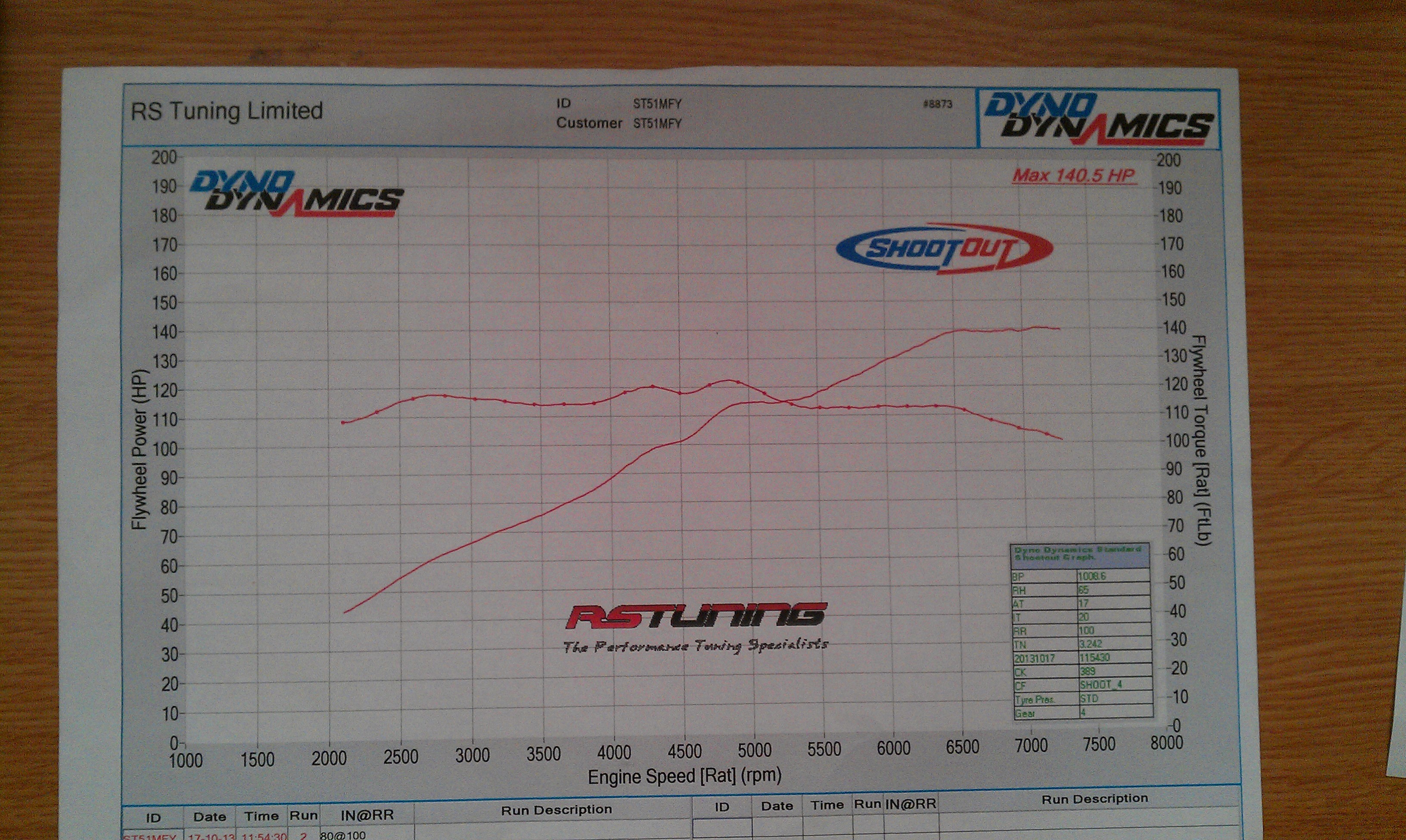

Taken to RStuning today where they did a compression test and 3 runs on the dyno. They got compression values of 220psi across the pistons and after a quick look on some forums they said it was okay
After the rolling road they admitted the timing felt a bit out. They asked what fuel I run to which my reply of "Asda fuel with sometimes some shell" didn't go down well and was told the Asda fuel will be messing the timing slighty.
In fact having another look on the graph now shows a constant torque line but no real growth when the vvc should kick in, instead it starts to drop after a small bump.
[Image: mcetg0.png]
so gunna try running it on some proper fuel then?
I really can't see some higher octane fuel giving it 20hp.. or even 5hp tbh
Think you've got a problem there. wobbley torque and a drop off where the VVC should kick in....
JP
JP
Oh dear, could that be vvc issues..? Fuel will make a difference, especially on an engine that highly tuned from the factory, not 20bhp though as dannys says lol.

The blue line on this, is a stock GTi, with an exhaust and the air filter I gave you....

Yea really don't think fuel will make up 20bhp but I'll start putting it back in, I don't do many miles anyway so the price shouldn't sting for too long.
Really not sure if it's vvc or what, been trying to compare all sorts of graphs. standard and modified
From what I can gather the standard torque is 170nm which converts to 125lb/ft but looking at someone elses dyno results shows they got 149bhp and 135lbft with

So the gti6 without any vvc system doesn't start loosing torque til about 6-6.5k whereas mine is loosing at 5-5.5k and then even before that it hardly went up...Argghh

I'd defo agree with VVC issues. Comparing it to the dyno graphs for my second cabby the AFR is about the same but there is a definite hump in your graph when the VVC should kick in then it carry's on building at the same rate as before.
Id be putting some effort into testing the VVC system before further tuning the car as for the power to be THAT low there is definitely a fault
It sounds like the VVC system is a complicated system from what I've just read, I don't envy you Steve.
http://www.touchepower.talktalk.net/VVC_Timing.htm
Are you able to re-rolling road the car but the only variable change would be putting your old carb back on, from you are saying since the carb change you may have gone smaller
