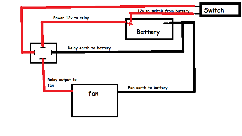

Also wired up a 12" fan when i took the fmic off, as the standard ones had a mind of there own, i used a 4 pin relay, the one out of the standard fans, i presume this is okay? connected it to a switch which i have placed in the small ashtray thing behind the the handbrake, also tried to hide all the wires in the existing looms as best as i could
temporary position for the relay, all wires are now taped up
rough paint diagram of how i wired it up, there is a 15 amp fuse in the wire from the battery to the relay, can anyone tell me if this is correct? Smile
