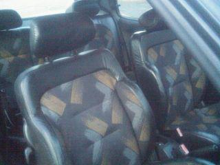

Next thing was to swap the interior! Got hold of some ph2 gti6 interior, complete with door cards etc

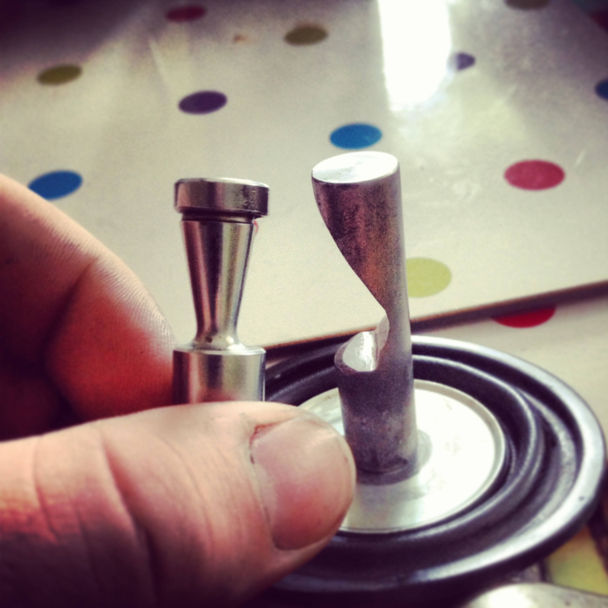

Got hold of a bosch set up off ebay, seller claimed it was gov modded and had a ground lda, which it didnt, fitted it to the car to find it wouldnt rev and it p***ed out diesel from everywhere possible, took the head off the pump to find bits missing and that the majority of the seals were just black sealant. Not best impressed but oh well! he all of sudden was impossible to get hold off!

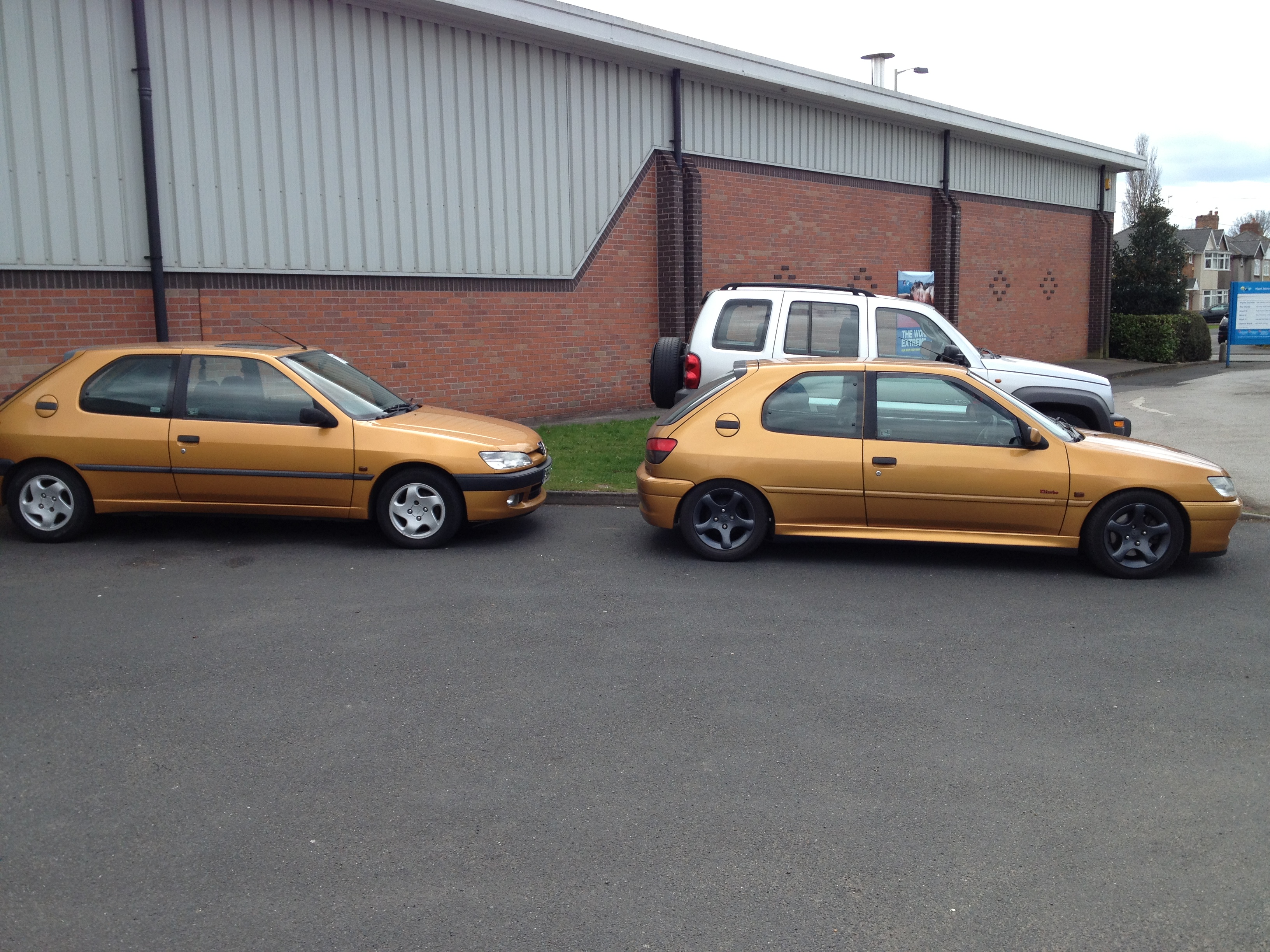

Was time for some lows, got hold of some 40mm spax springs and struts, and a rear beam with spax shocks already lowered by 50mm of my stephen who chucked a rod! Username stephenraymond606.
[attachment=7203]
Changing the beam! Actually all went to plan (which is a rare occasion for me!)
And done, sits just right! exactly how i wanted it!

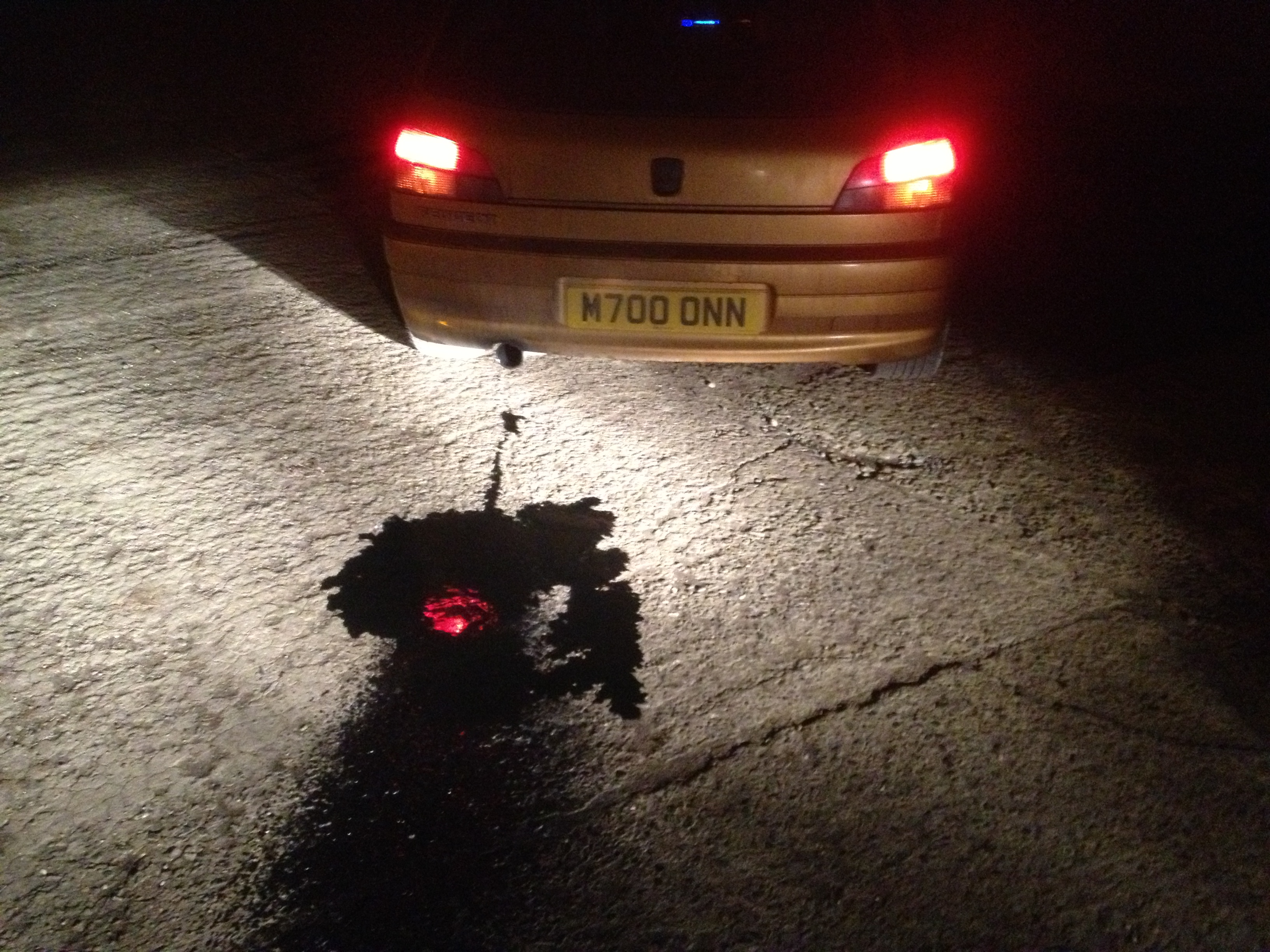

Thanks dude, decat, de mid boxed it earlier this week, which resulted in the workshop being on fire.. ooops. The back box is custom made for a xud, 3 inch, no writing or anything on it so no idea where it originally came from!

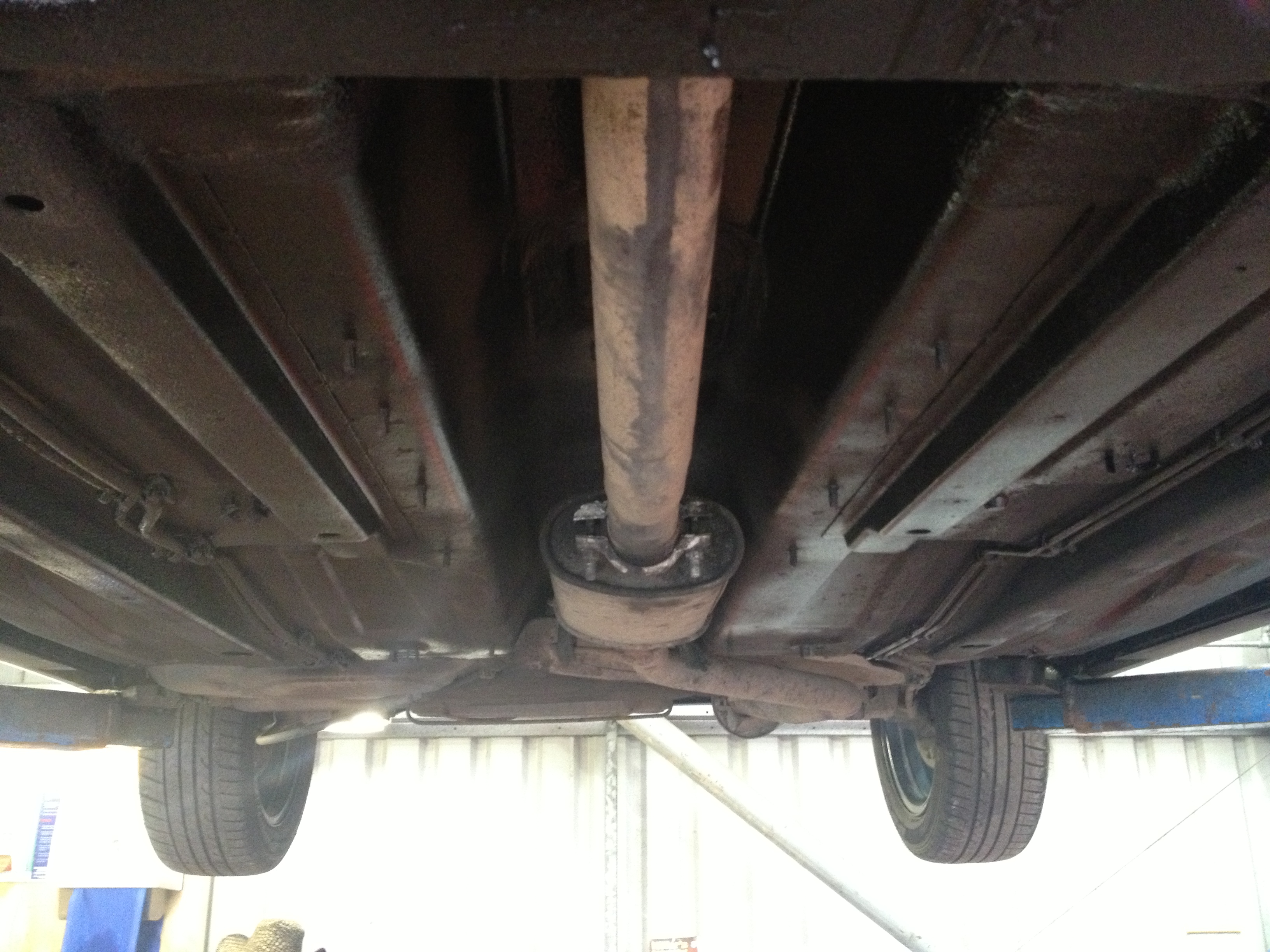

Had some wax oil kicking about for a while so gave it a quick coating whilst on the ramp, such a messy job, my iphone has definitely seen better days anyway!

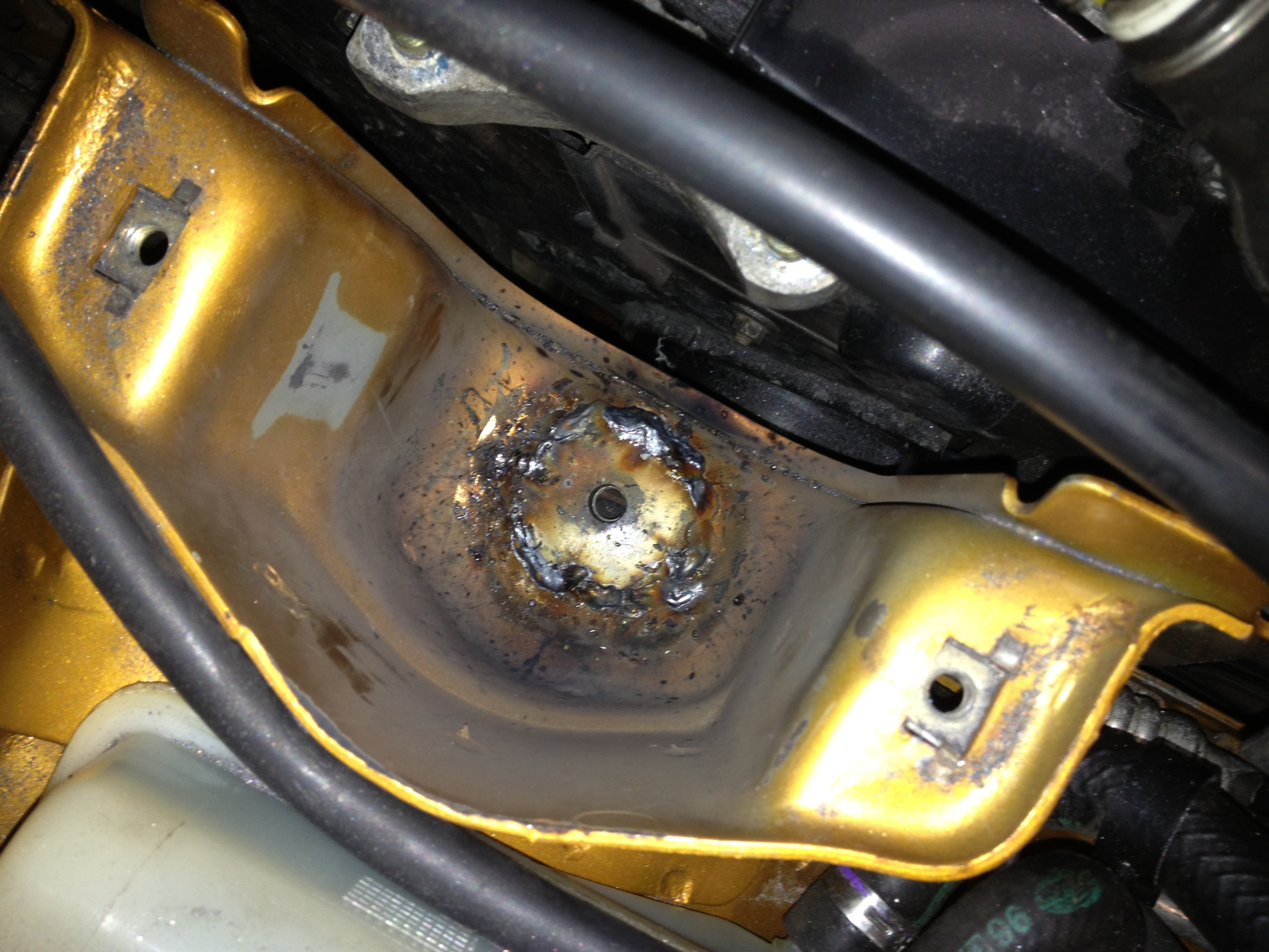

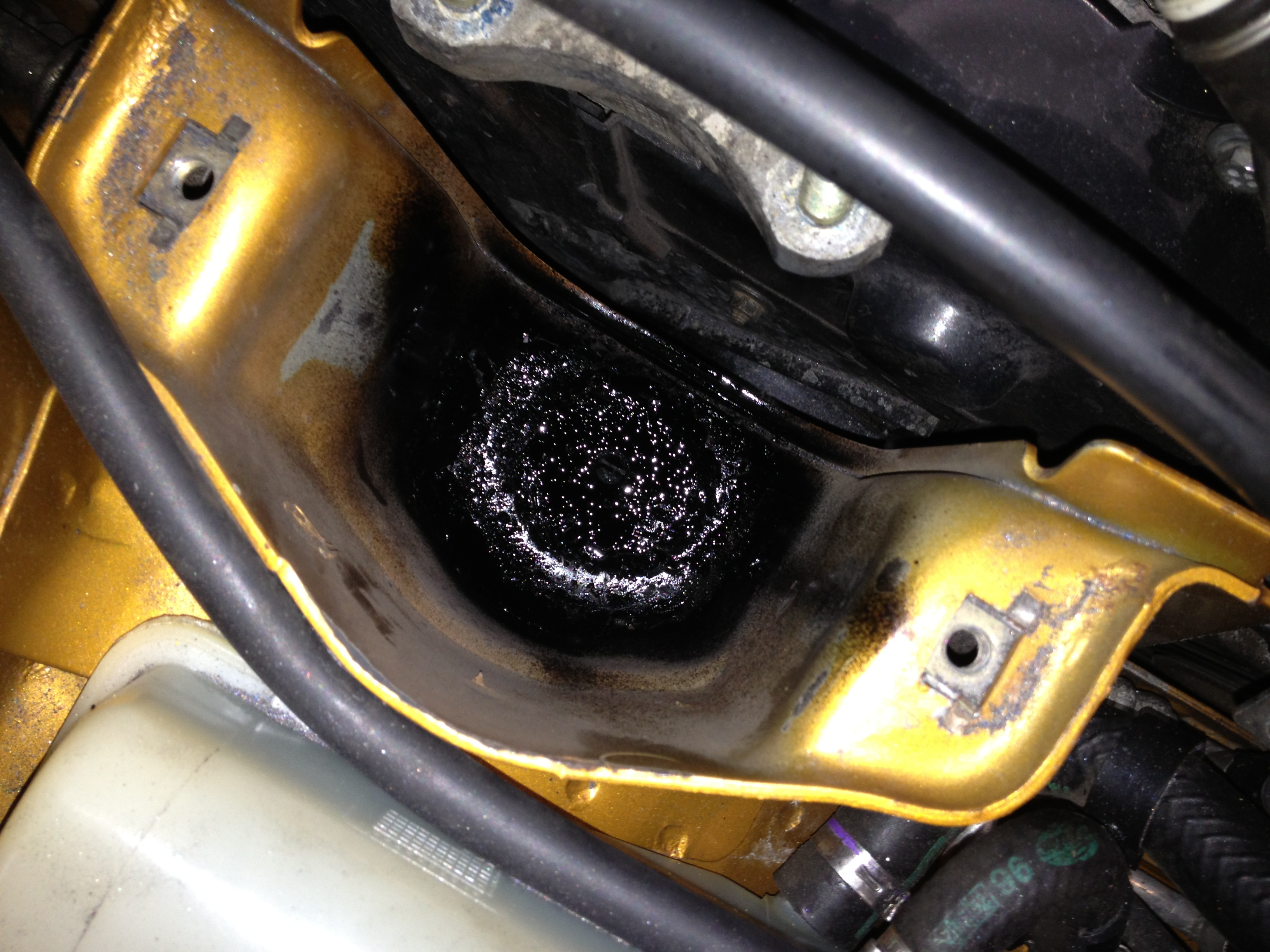

My top engine mount has always knocked and rattled when letting of the throttle, so thought i better go about fixing it Smile not got any pics of before but any way
I placed a washer over the body and put a bolt through to make sure it was kept in the center and then welded around it
Seems to of done the job Smile

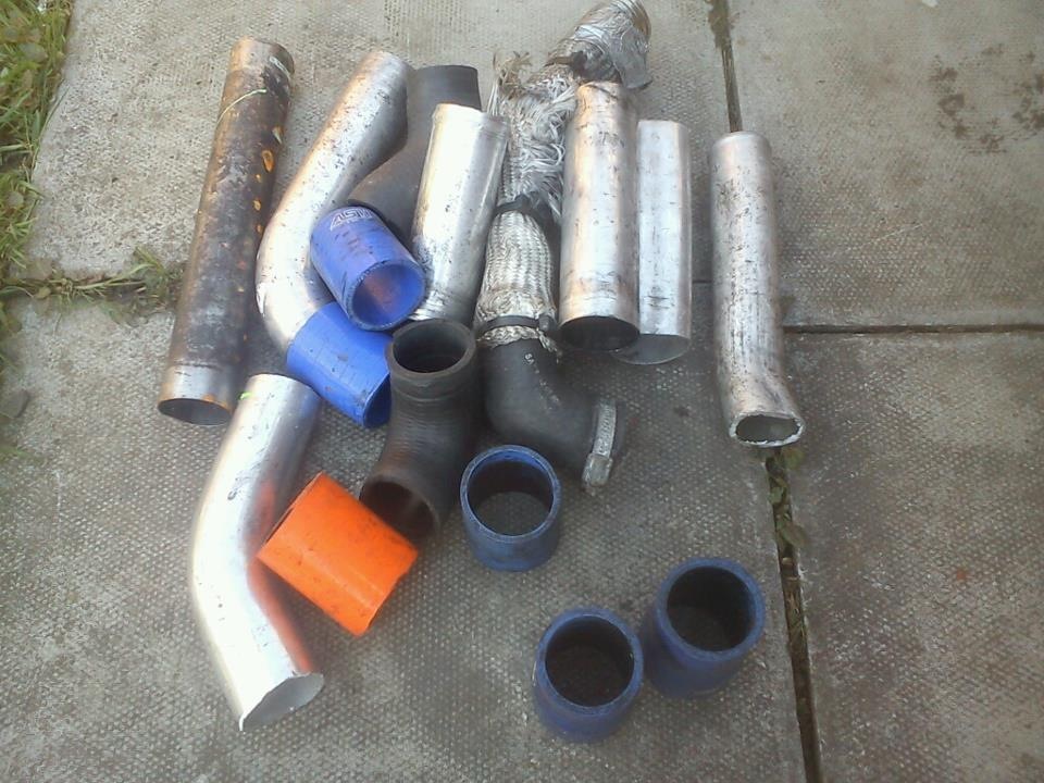

Brought some random pipes ready for when the fmic is on so i can make up a new air intake Smile

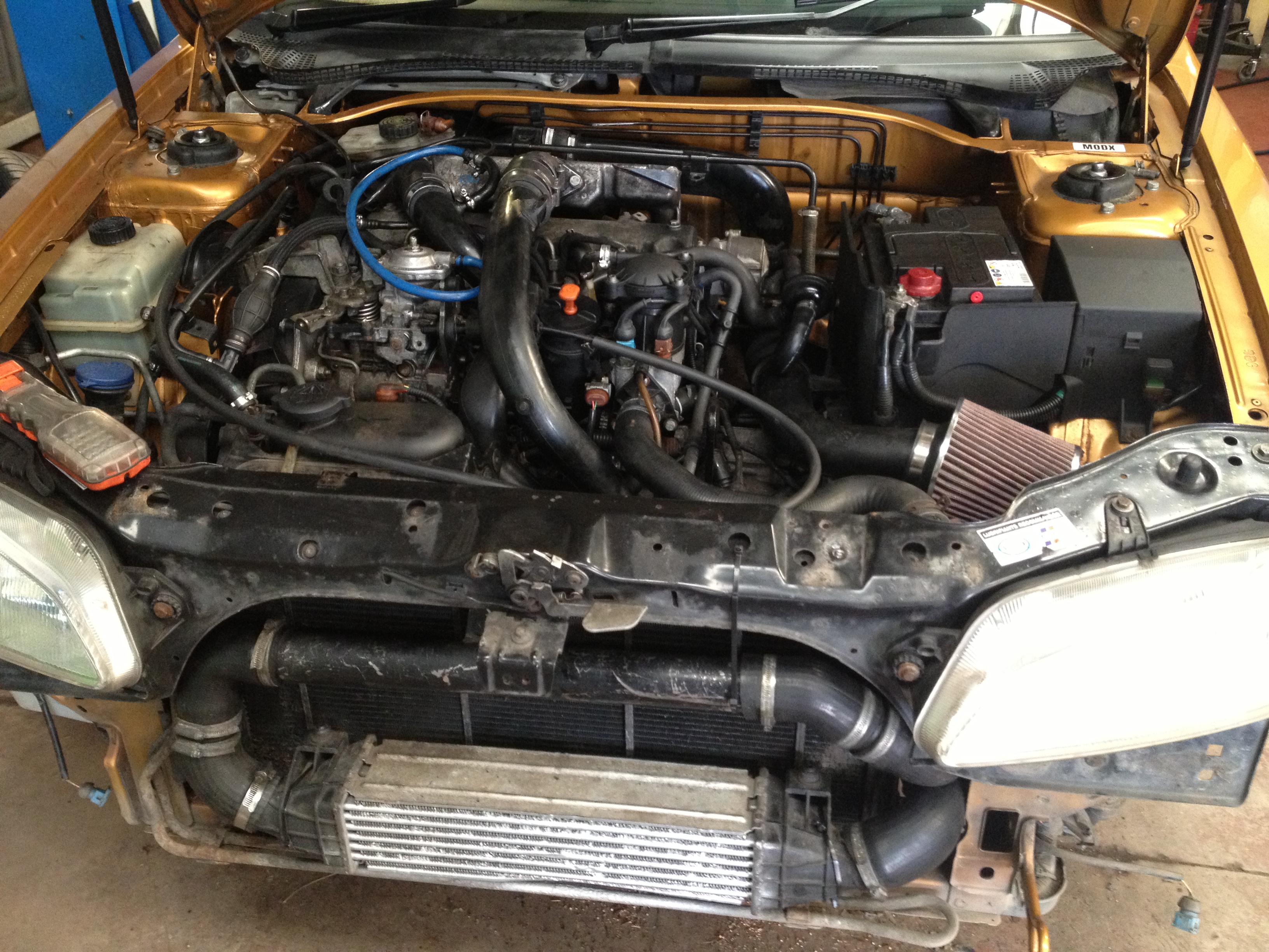

RE: About time i made a project thread! Blaze PH2 XUD project! - Mitch - 02-06-2013

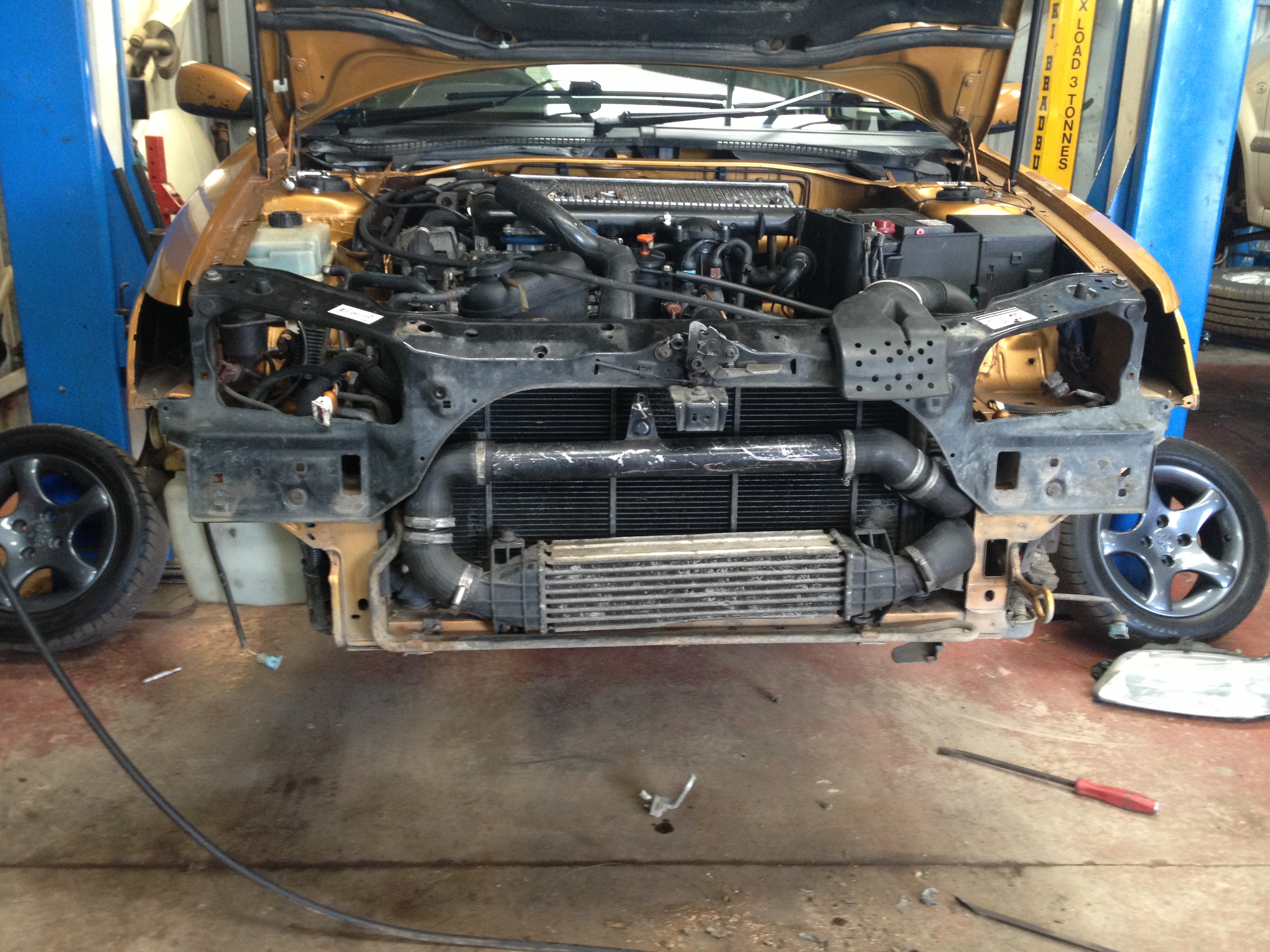

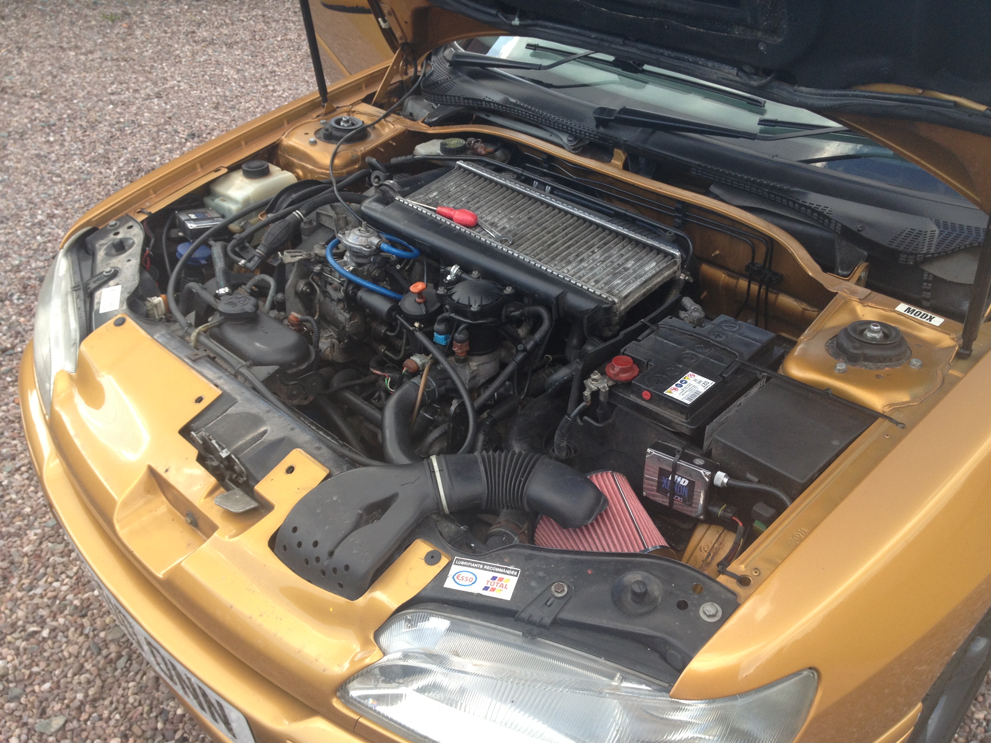

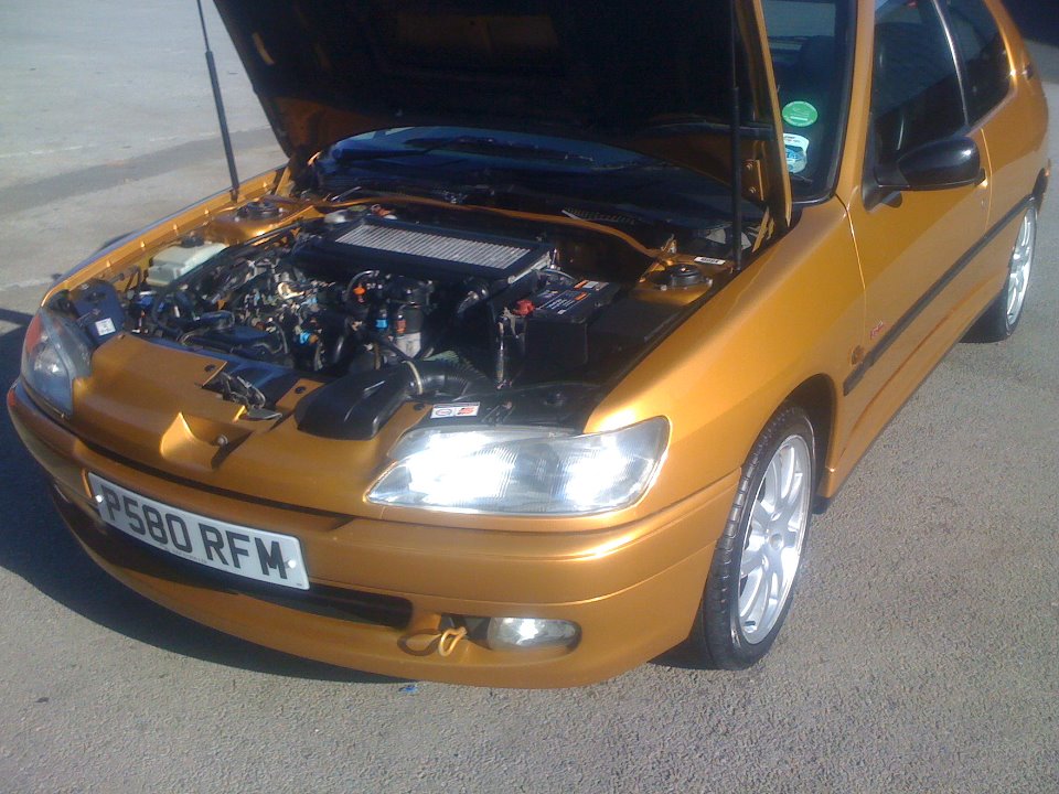

Got the fmic on yesterday, cut the air con rad out and removed the fans

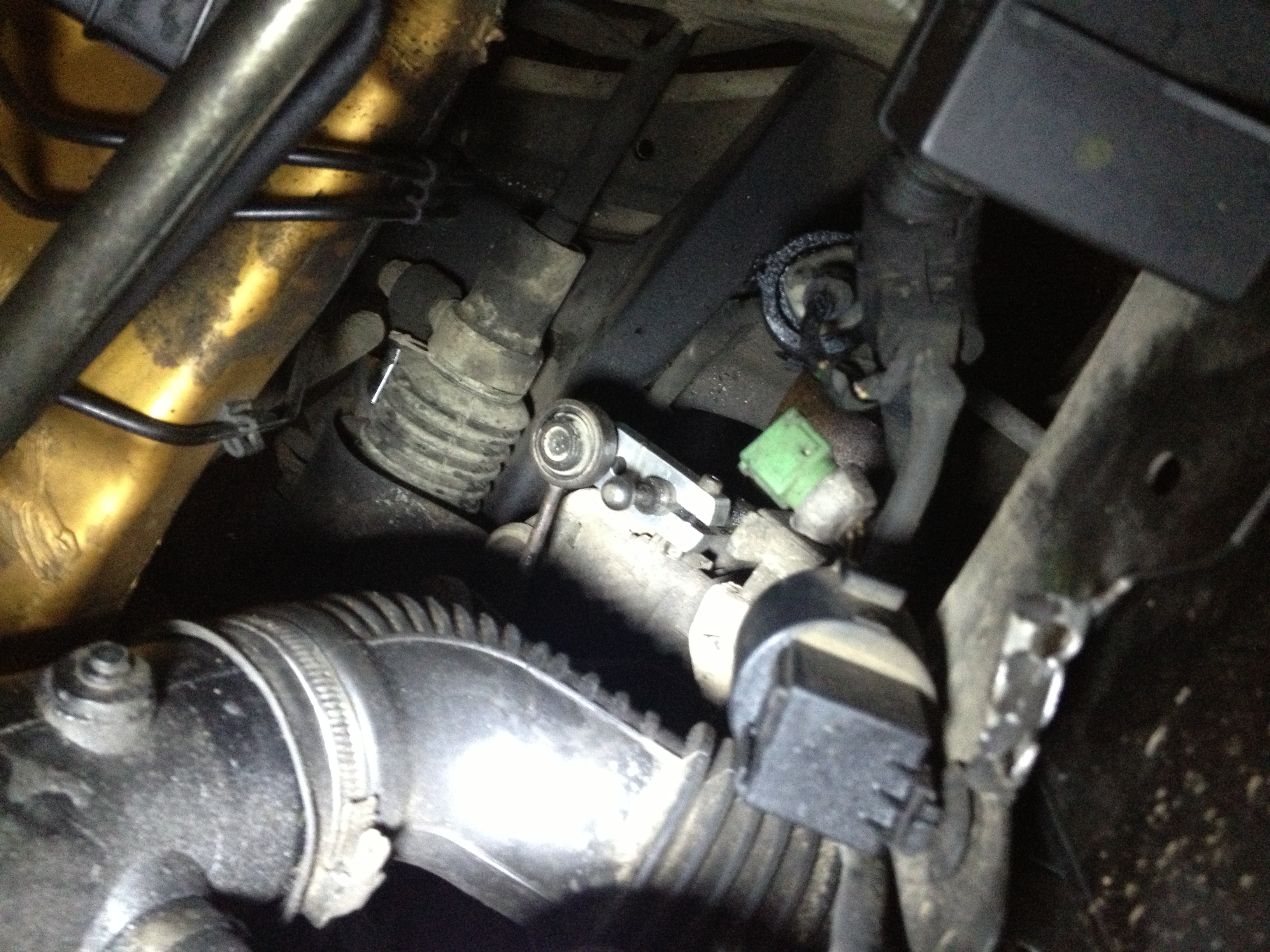

Quick lick of paint Smile seems to fit/work well, definitely more mid range torque, never needed to make up a new air intake, tmic intake pipe fits fine, only problem i have is the outlet pipe is rubbing on the master cylinder now and making the brake pedal vibrate, any one now if there a difference between the pipe on the 406/xantias?, it went in real easy on the tmic manifold but was a pain in the arse with the 406 one!
RE: About time i made a project thread! Blaze PH2 XUD project! Fmic now on! - Mitch - 20-06-2013
Had the car on the dyno again today, made 124bhp and 204 ft/lbs (278nm), its on a standard bosch pump, T2 at 20 psi, decat and i have jenks old fmic set up on, not a bad result i dont think? im happy with it anyway, the torque is there just need to get the bhp up? Smile

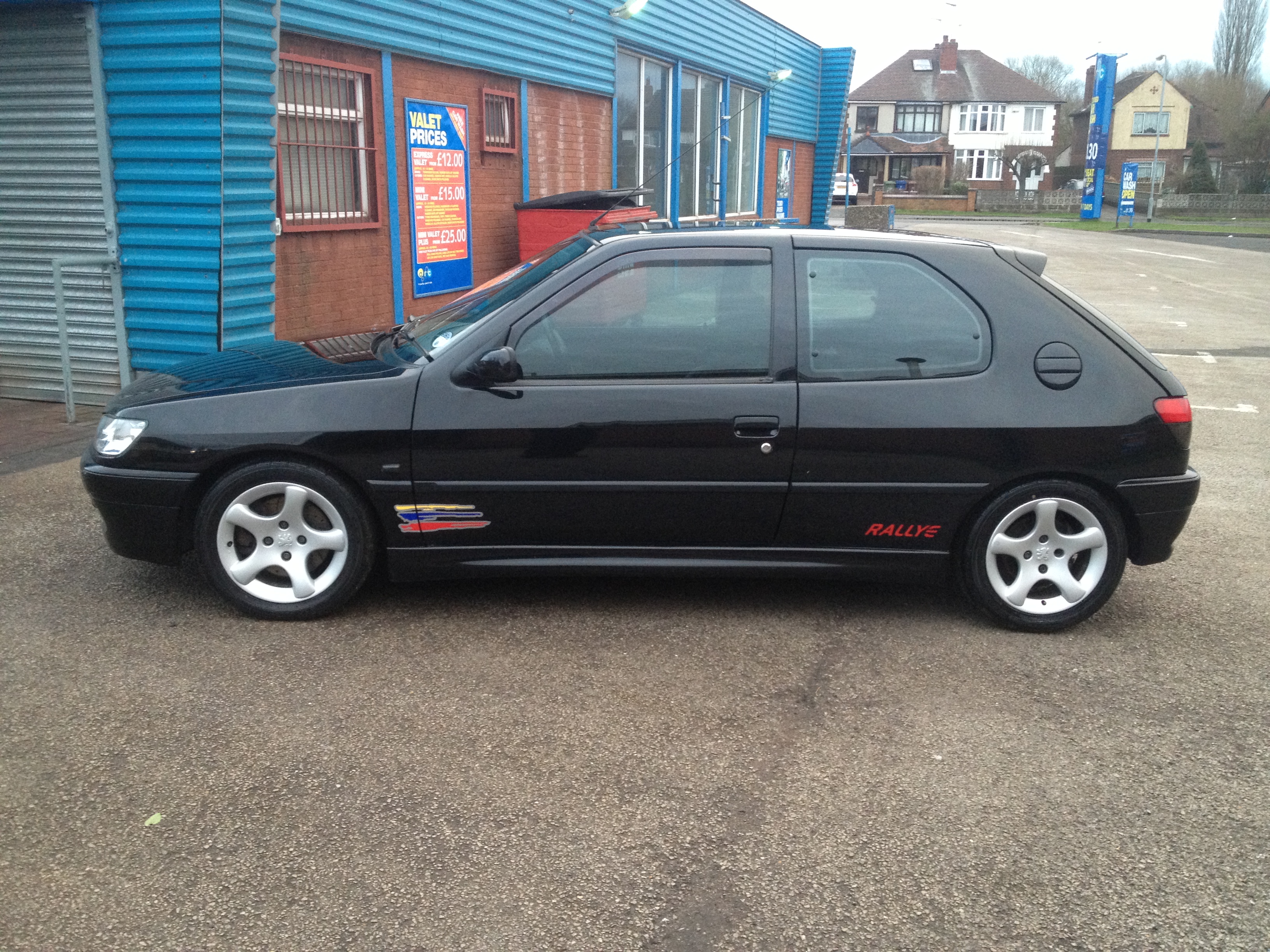

A few recent pics, robbed the crystals out of the rallye whilst its sat doing nothing
Think it looks a lot better with the crystals in
